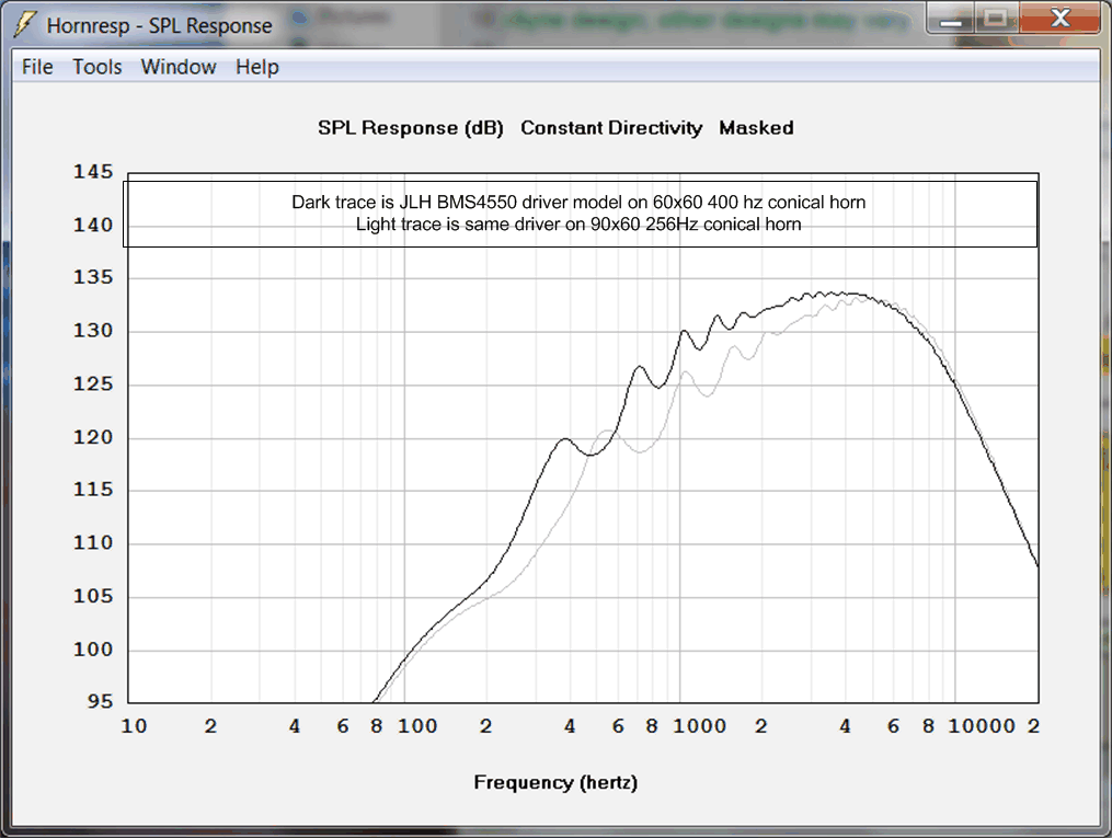

I had to step away from the conversation on the weekend but caught up last night. I ran the 5 to 10 sq. cm. flare rate numbers for a range of horn angles, getting roughly 4 Khz for a 90 degree horn and 2 khz for a 60 degree horn. I found TS parameters for the BMS4550 in an akabak script posted by JLH (thanks) and simulated it on those horns. I did some research and found Bill Waslo's 90x60 Cosyne crossing right around 4 khz. OTOH, several 40 and 60 degree horn threads showed crossovers at/around 1 khz, half the calcuated cutoff.
As you can see in the attached chart and no doubt expected, the cutoff is quite gradual in a conical horn. Its apparent both why Bill pushed his crossover as high as possible and why in a narrower horn you can get away with crossing over under the calculated cutoff frequency. The sim was run at just over 100W into the CD. The driver is at 1 mm excursion at 800 hz or so on the 60 degree horn and 1 khz on the 90 degree horn trace.
I'm now torn between going with the 256x90 horn that fits my intended corner placement better and with a 60x60 which would be an easier design and not suffer from pattern flip.
Thanks to JLH and PB and all for the enlightenment of the last few days.
256x90 horn 😉?
1mm excursion would sound totally gross, the 4550 has around 8% distortion at 111.7 dB (one meter equivalent) with a dual sine wave tone of 1046 &1865 Hz in to a 13 x13 degree conical horn.
The 13 x13 degree Maltese horn has a much lower cutoff frequency and much higher on axis sensitivity (around 115 dB one watt one meter) than your sims.
My measurements suggest Xmax probably on the order of .2 mm or less for the BMS 4550. Nice sounding driver, but it won't sound nice at 100 watts at 800 Hz on a 60 x 60 conical horn!
If you want to actually hear how the driver sounds at high drive levels on a conical horn, check out this thread:

256x90 = typo, horn model was 90x60 big enough to keep pattern control down to 256 hz
I wouldn't dream of listening at that excursion either. It was just wherer I happened to do the simulation. I think I'll be down in the 1-10W region, certainly RMS wise, don't know about the occasional peak. And I'll push the xover up to 1.5 or 2 khz, if I can.
