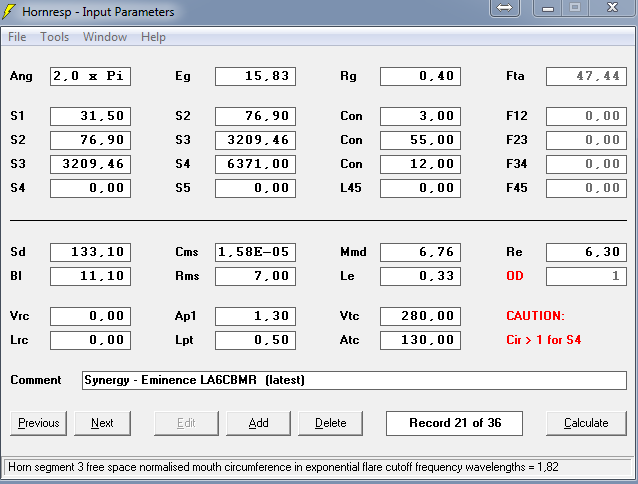

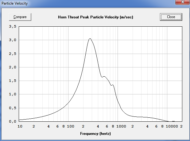

There is something I just don't understand😕
No matter how small I make the entry holes (compression ratio 100:1) the port velocity does not exceed ~3 m/s. What am I missing? Should one multiply m/s by factor 10?
/Thomas
/Thomas

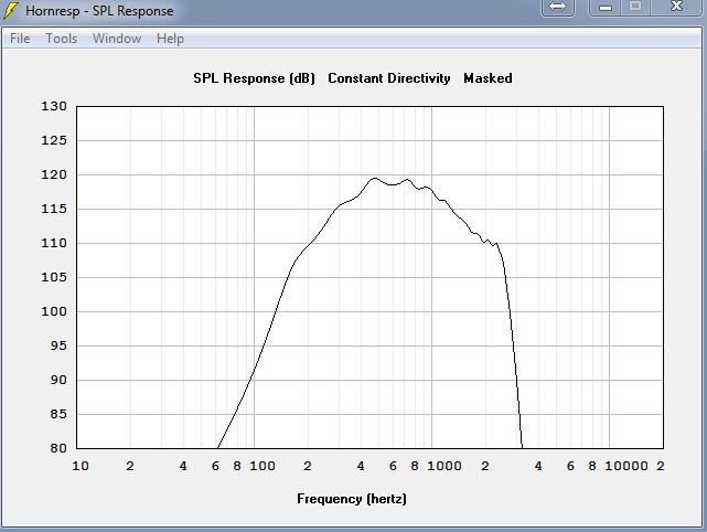

If it's post #785 you're refering to, please disregard the SPL chart, it's just a consequense of the very small port hole/s.

Regarding the velocity, I think hornresp shows the velocity in the throat of the horn, not in the holes. For this you need to use Akabak, which will certainly tell you the velocity will be too high.

no, I was more interested in your chart from #784
but I guess ok if equalised linear down to around 115db
anyway, I thought a smaller port hole would push the rolloff upwards 😕
Like what Kessito said, you need Akabak to view the port velocity. Horn Response can't show you the port velocity.
Thanks kessito and John!
Akabak it is then

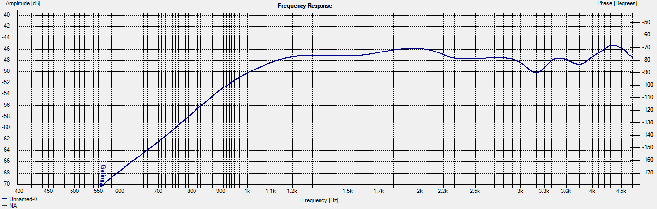

The port length and diameter does not control where the high frequency rolls off. The ports only affect the smoothness of the roll off (i.e. whether the roll off at the shoulder is rounded and smooth or peaking).
The high frequency roll off is controlled by the half wave cancellation distance from the acoustical center of the compression driver to the port and the cross sectional area the port taps into. With an area of 76.9cm^2 you will begin to get roll off at 1100Hz. If you want to reach 1500Hz, then you have to tap into the horn where the area is 41.5cm^2 or less. In addition, the distance from the acoustical center of the compression driver to the port has to be 11.4cm or shorter to reach 1500Hz.
Here is an Akabak script you can study. The model includes all the drivers and the crossover. Simulate the Acoustic Power Response.
