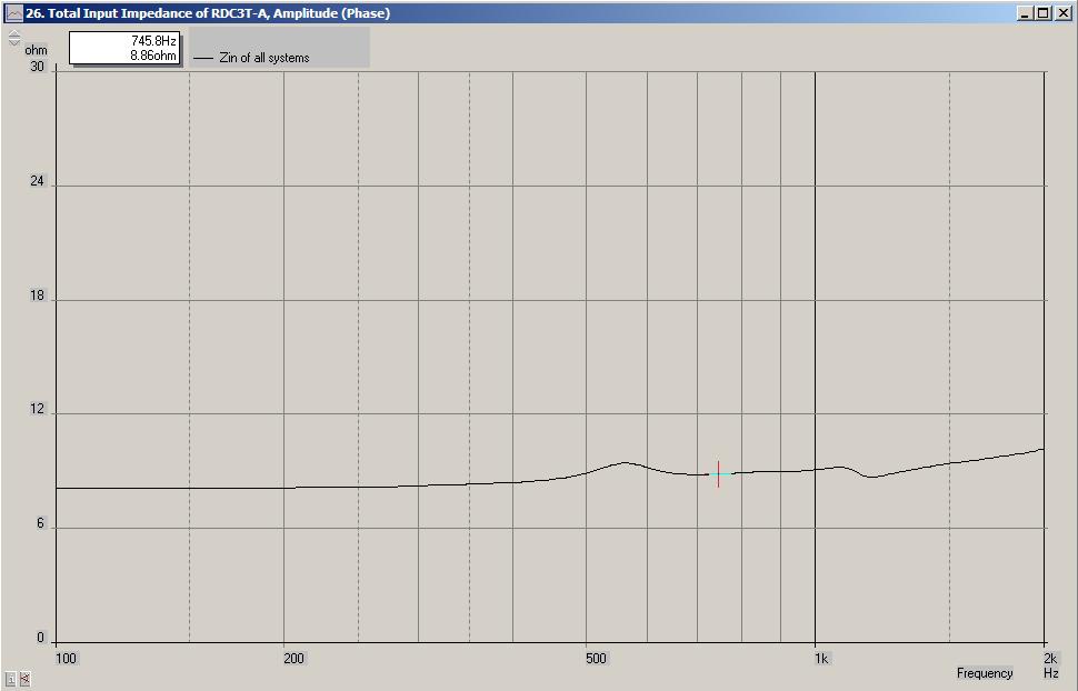

The special thing about the RDC3TA is it behaves in an almost purely resistive manner when horn loaded. There is no resonance peak to mess things up. The response of the RDC3TA takes on whatever the local area of expansion is. If the local area of expansion is 600Hz, then the RDC3TA plays down to 600Hz. I don't know how low it can be loaded, but 4 of them loaded down to 600Hz can drive you out of them room without a hint of audible distortion.

That is kind of the same scenario I'm hoping for with the Ciare. I'm not sure how the horn loading effects the impedance as its almost purely resisitive from specs.

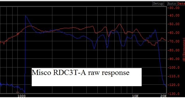

Don't be concerned. The raw response of the RDC3TA looks like crap too. However, it straightens up once horn loaded. Red trace is frequency response, blue is phase.

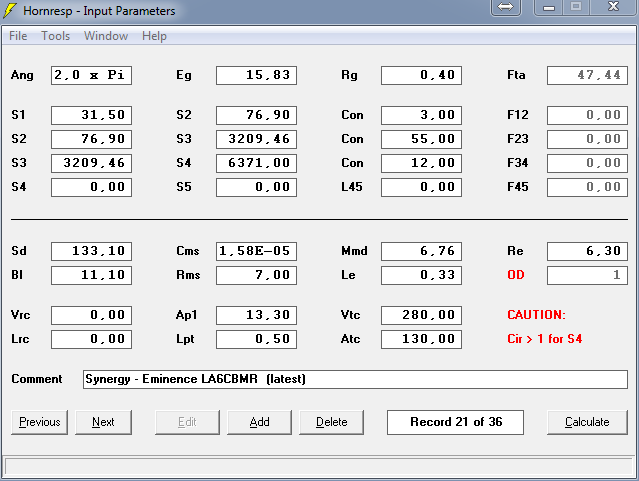

Compression ratio doesn't matter. I size the entry holes to only be big enough to keep the air velocity through the port below 17 m/s at my desired SPL level. If I can achieve this with a 20:1 compression ratio, then that is what I use. Do not get hung up a certain number for your compression ratio.
Thanks again, John!

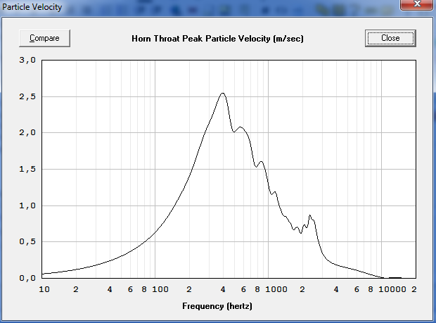

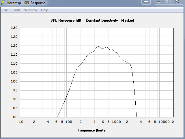

A trial:
I've made a rough HornResp model for the Eminence LA-6 CBMR with a 10:1 compression ratio - just a round number.
I'm aiming just below 120dB (one driver)
From the velocity profile, it seems that the ports can be made even smaller as the velocity does not exceed ~2.5m/s.
Any comments on this?
/Thomas
