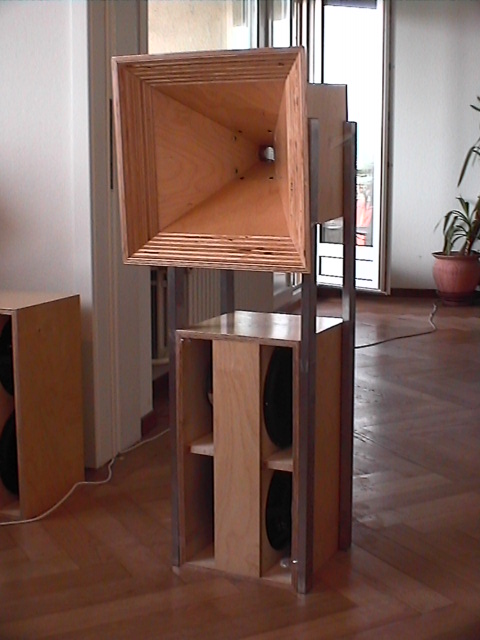

On page 73 I posted some data to illustrate where the midrange taps should go. In that post, I argued that the ideal tap is somewhere between 10cm and 20cm. Additionally, I argued that getting the mids too close to the throat will cause interference with the tweeter.
Also, I believe that narrow angle Unity horns are easier to implement than wide angle Unity horns, and that's it's borderline impossible to get a wide angle Unity horn to work UNLESS you use very small midranges, a very large tweeter, or both. (The Danley SM-96, with a coverage angle of 60x90, uses a coaxial driver at the apex, which gets the mids very close to the compression driver.)
So let's explore these hypotheses.
In the following sims, I will compare two extreme cases. The first case is a 25x25 degree horn, like the Danley SH-25. The second case is a 90x90 degree horn. Both horns use the same compression driver (A B&C DE25), both horns use the same midrange drivers (a quad of Misco JC5RTF-B), both horns have a mouth that is identical in size. Narrow angle horns are deeper than wide angle horns, and due to this the narrow horn is 43 liters versus 12 liters for the wide angle horn.
The 25x25 would look something like this, albeit half the length:
the 90x90 would look something like this, albeit 25% wider, and using a square mouth
In the threee pics above, I've shown the effect of moving the midrange taps on the 25x25 degree horn. In the first pic, the taps are 5cm from the throat. In the second, it's 10cm, and in the third it's 20cm. Nothing else changed; mouth is same, volume is same, compression driver is same, etc...
Some observations:
1) Anything beyond 10cm is fairly ugly
2) In the sims I've placed a red vertical line that indicates where the throat reflection is expected. For instance, it's expected at 850hz with a 10cm 'tap.' In the hornresp sims, we see that the notch occurs higher in frequency than predicted and the location of the notch depends on wall angle.
3) A midrange horn needs a lower flare rate than a treble horn, and I think this is the reason that the 10cm 'tap' has the smoothest response in it's passband. While the 5cm location plays lower, because the mid 'sees' a longer horn than the 10cm location, the 10cm tap is less resonant in the passband. I think this might translate into superior sonics, since response 'blips' in the midrange are so noticeable due to the Fletcher Munson curves.
Here's all three graphs on one page.
One thing that's interesting is that the wattage on the compression driver is a LOT higher than on the mids. 100 watts for the mids, or 25 watts per mid, versus 500 watts for the compression driver. Probably one of the reasons that I've had good luck with very small mids; it doesn't take a lot of power to get the mids loud on the horn, but the compression driver takes some serious power to get going.
In my next post, I'll run the same sims for a 90x90 instead of a 25x25 horn.

First off, I hope the information that I posted about the relationship between the coverage angle of the horn and the crossover point of the compression driver is useful. I've always struggled to get that transition right in my Unity horns.
I believe these sims are helping to illustrate my hypothesis, which is that a narrow angle horn allows for a lower xover point, which in turn makes it possible to use some drivers which are very attractive, such as 6.5" or even 8" mids.
I'm not going through all this for academic reasons; I have four compression drivers scheduled to arrive on Monday and I'm trying to decide if I want to use one per side or two.
Your first question is in regards to 'shelving' of the compression driver. Yes, we *do* use a shelving filter. And yes, the additional gain of a narrow angle horn will make a big difference.
My sims, using the B&C DE25 indicated that it would take a thousand watts to get the DE25 to 115dB at 1khz on a ninety degree horn. Reduce the coverage angle down to 25x25, and the power required drops tenfold; from a thousand watts to one hundred watts. The sim above shows the DE25 with one hundred and one thousand watts.
Your second question was, does it really take a thousand watts to get a DE25 to 120dB?
At 1khz, it takes about FOUR THOUSAND WATTS if you use a 90 degree horn. Narrow that down to 25 degrees and it'll require about four hundred.
Now the obvious question, is "who cares? No ones listening at 120dB at home."
In regards to that, I'm exploring this because I'm trying to figure out how to get the xover point down. I'm not trying to generate 120dB at 1khz; I'm trying to see if we can do 104dB at 500hz.
To get that crossover point down to 500hz, we need three things:
Displacement, power handling, and efficiency.
My hypothesis is that narrowing the angles of the walls will get us enough efficiency that the first two requirements aren't 'deal breakers' anymore. The graph above shows the displacement of the B&C DE25 on the 90x90 horn with a thousand watts, and the 25x25 horn with a hundred watts. In the sim, we see that the DE25 is hitting a wall at about 1khz on a 90x90 horn. This is consistent with my 'real world' experience. My Gedlee Summas use a DE250, a 90x90 waveguide, and an xover point of 900hz. But narrow that horn down to 25x25 and 'the wall' drops to about 500hz. That opens up a whole slew of driver options; the possibility of doing a two way synergy horn with hundreds of drivers that are 6.5" or even 8" in diameter.
The downside to all of this is that a 25x25 horn will 'illuminate' the listening room in a way that's quite unusual. Based on what I've read I think there's a strong case to be made for speakers with a coverage of 90x90 or even wider. But the cool thing about the Unity horns is that they can be arrayed, and that's the direction I'm leaning towards. Instead of a 90x90 horn picture two 90x45 horns that yield a combined pattern of 90x90.

So you're saying that on a 90x90 horn the DE25 needs 1kW to reach 115dBSPL @ 1m?
Which means its sensitivity at 1W in is just 115-30= 85 dBSPL/m @ 1W? Doesn't seem right.
I found where the error is. It's because I'm using hornresp to simulate the compression driver, and the value of VAS is at the limit of what hornresp allows. (0.01 liters)
Running sims on high frequency drivers is a p.i.t.a., and these parameters are the closest I could get to a working model*. IIRC, LeCleach has posted a model of a TAD driver, and Geddes has posted a model of the B&C.
Anyways, long story short, it appears that my model of the DE25 is off by an order of magnitude. To get proper numbers, one would have to add 10dB to all the curves, or multiply the wattage by 10. (I prefer the former, as the latter would screw up the excursion curves.)
If someone knows a way to get around this without using Akabak, please let me know.
