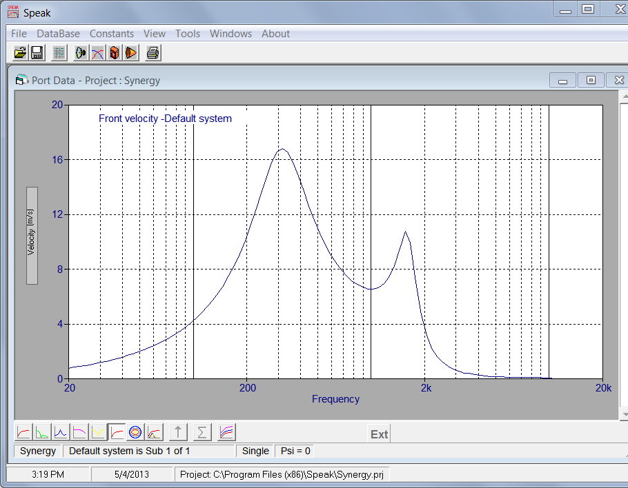

Your "port velocity" simulation is not what you think it is. Horn Response cannot calculate the midrange entry port velocity. What your simulation shows is the velocity of the air in the body of the horn at the point the mid ranges tap into the horn. This is not the same as the velocity inside the entry ports. You need to use Akabak to view the actual port velocity.
I'm no expert on Hornresp but I did notice that the Offset Driver model did exactly what you state. That is why I made the end entry models of a truncated horn (see part 3 post). That is what I used to calculate port velocity. I matched the driver displacement to my offset driver model with high pass crossover filter.

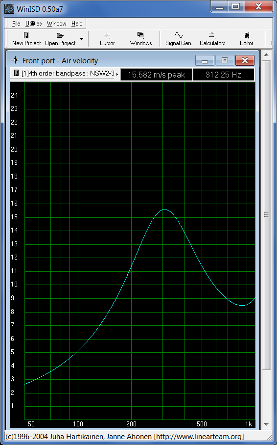

I was concerned about the answer so I also duplicated the design in a 4th order bandpass model in WinISD Pro. The answer is only 8% different than the Hornresp result.
Modeling the mids as a ported enclosure is a good way to find your answer if your not good with Akabak. From what you have done, I would feel you have the bases covered. Just didn't want you get "bad" information from a simulation program.

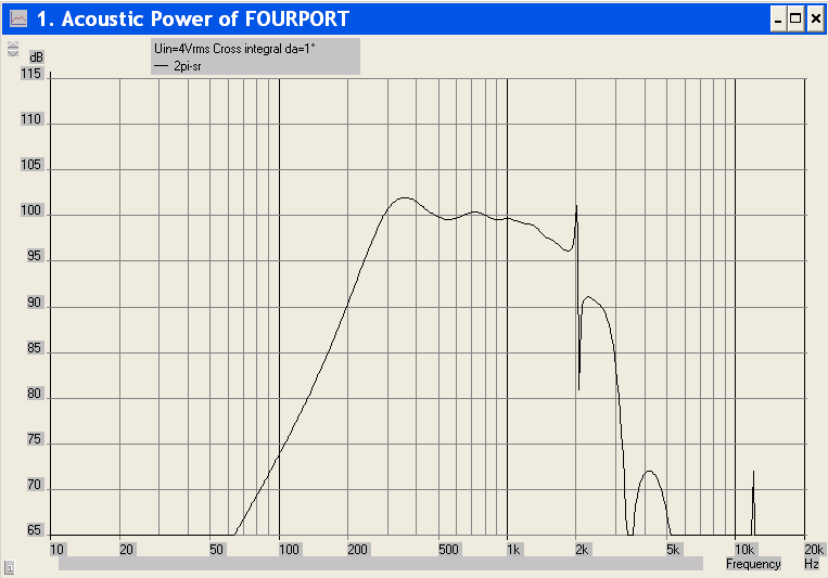

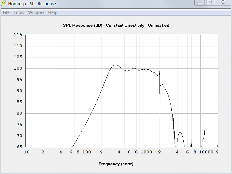

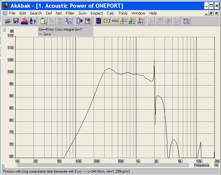

I had to slightly modify my Hornresp model to 2*Pi space and turn off resonance masking. This is the last model I posted with the tweaks to simulate a compression driver throat adapter. Here is the SPL analysis:
Now here is an Akabak simulation with the compression driver conical throat adapter and four midrange drivers on one big midrange port like Hornresp models it. I've attached the Akabak script and Hornresp inputs. When you export this model from Hornresp to Akabak you need to shift the midrange port over to node 10. That puts it at S3 where it belongs (that can not be done in Hornresp, offset drivers can only enter the horn at S2).
Wow, really really close to the same answer as Hornresp, however, I was still concerned about a difference with four separate smaller ports (1 per driver) like the real horn so I modeled that too:
Hmmm... not much if any difference so nothing to be concerned about. I'll work on getting some more results out of Akabak for the final design iteration.
