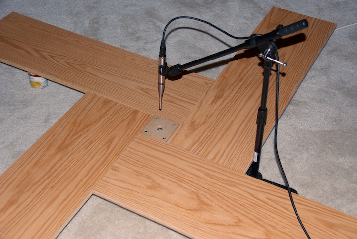

Test Of AuraSound 2" Driver As Synergy Midrange

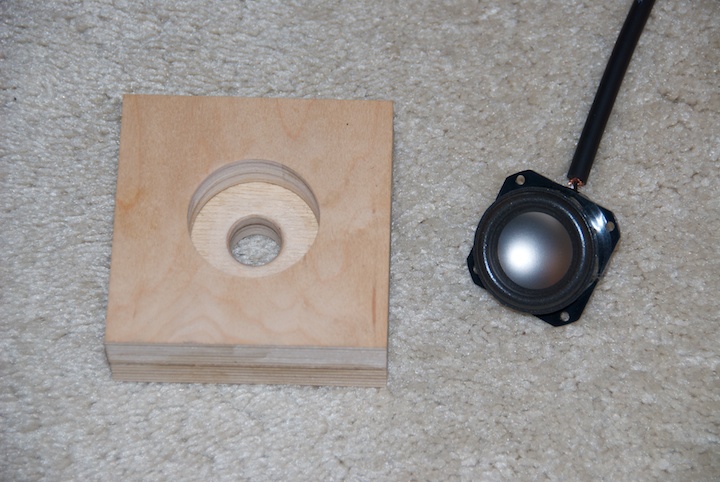

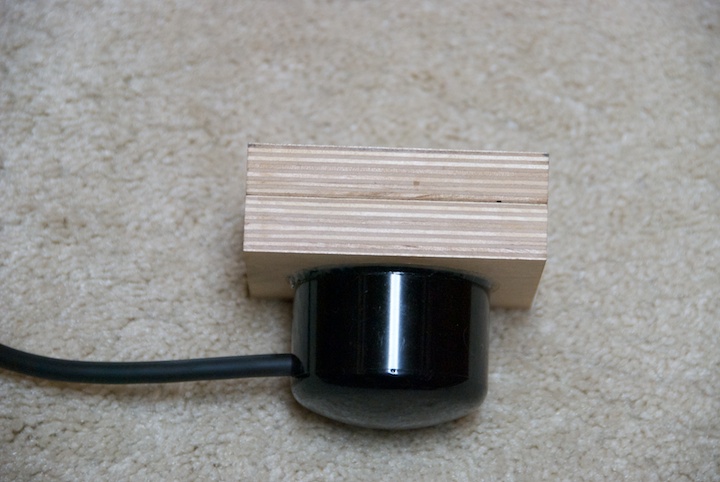

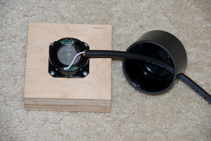

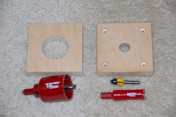

I put together a small test of the AuraSound 2" driver for use in a Synergy Horn. After some trial and error I ended up with a 12mm thick port baffle and an 18mm thick driver mounting baffle. These are common thicknesses for baltic birch plywood. The port length and chamber volume had to be a little smaller than predicted to get the desired response. The hole saws are 1-7/8" (48mm) and 3/4" (19mm) diameter. The roundover bit is 1/8" radius (3mm). I sealed around the driver and the cap with hot melt glue. Silicone RTV gives off acid when it cures and solvent based glue vapors may affect the driver adhesives.
Here's a series of photos of the build and measurement:
attachment.php
attachment.php
attachment.php
attachment.php
attachment.php

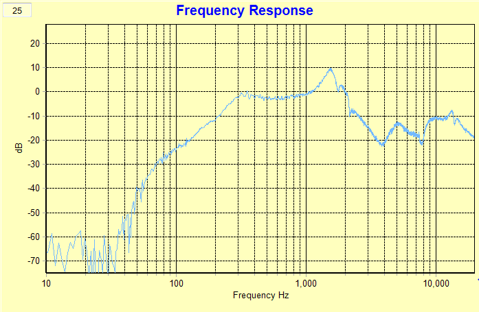

Here's the frequency response measurement. It is pretty much what is needed to compensate for the beginning portion of the 1/4 wave horn throat reflection notch and extend the upper midrange frequency response.
attachment.php

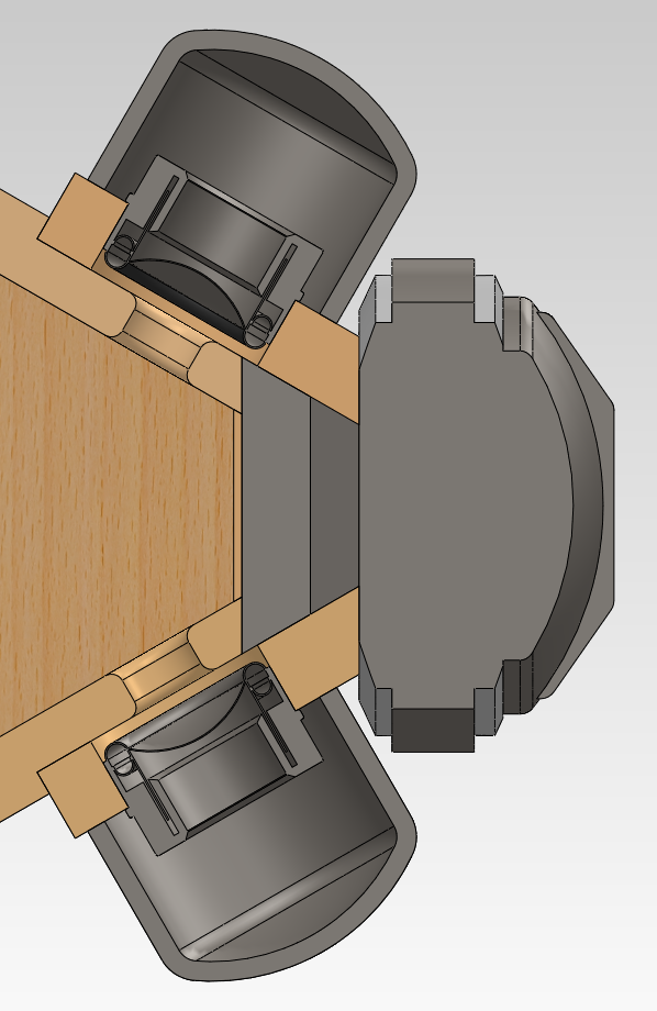

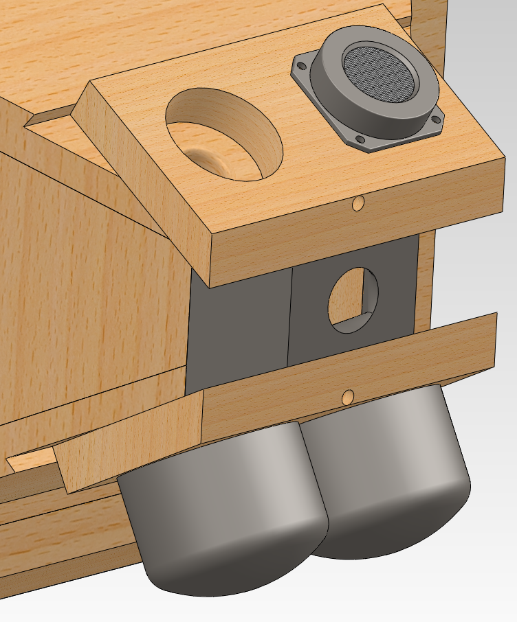

Here is what the design looks like now in a cross section through two of the drivers.

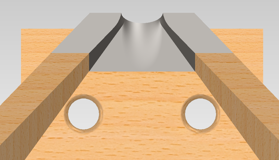

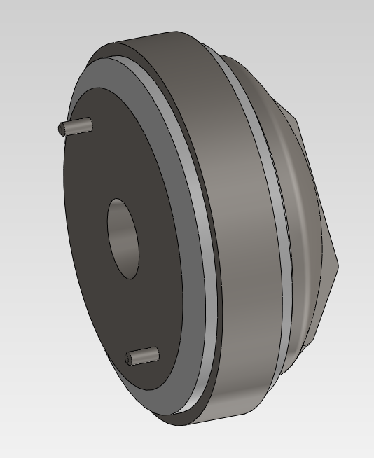

AuraSound Synergy Throat Adapter
Mounting the compression driver in close is difficult. I finally figured out an easy way to do it. After installing two smooth threaded 6mm studs into the driver mounting holes, just slide it into place with guide holes on the horn assembly. The studs will support the driver weight. Double stick foam permanent mounting tape will provide the seal and hold the driver in place (scrape the foam gasket off the driver face first). Removing the driver should never be necessary as the driver diaphragm is replaceable from the rear. I'm sure I can get it off with a thin sharp putty knife if I ever need to.
attachment.php
attachment.php
The critically shaped throat adapter (Quadratic Waveguide Profile) is intended to be made in a 3D printer. I've attached a zipped .stl file that anyone can use to have them made. With a wall thickness of a few millimeters the part can be fabricated with a honeycomb core to save time, material and cost. The part is 29 x 72 x 112 mm overall.
attachment.php
I guess I'm ready to have the throat adapters made now.

Any reason the throat adapter cant be omitted? I was thinking the walls of the horn could just continue down and be shaped later on by hand.
I'm just using a 3D printer because it is easy for me. You can try it by hand. The inside surface contour looks like this:
Just be sure to "focus" the horizontal and vertical walls of the horn on the inside to a point. Then truncate the horn at the same place I did (see earlier posts). Do not make a 0.7" square opening and try to "round" it to this shape, it won't work. Before hand finishing, the throat should have the same proportions as the horn mouth, just smaller.
Huh? This is how I've made all my horn throats. For a 1" driver I build my conical horn shell with a 0.7" square throat and then open it up with a 7/8" Forstner bit on a drill press. Final shaping is done with a 1/2" dowel rod wrapped with sandpaper. This method has worked everytime for me.

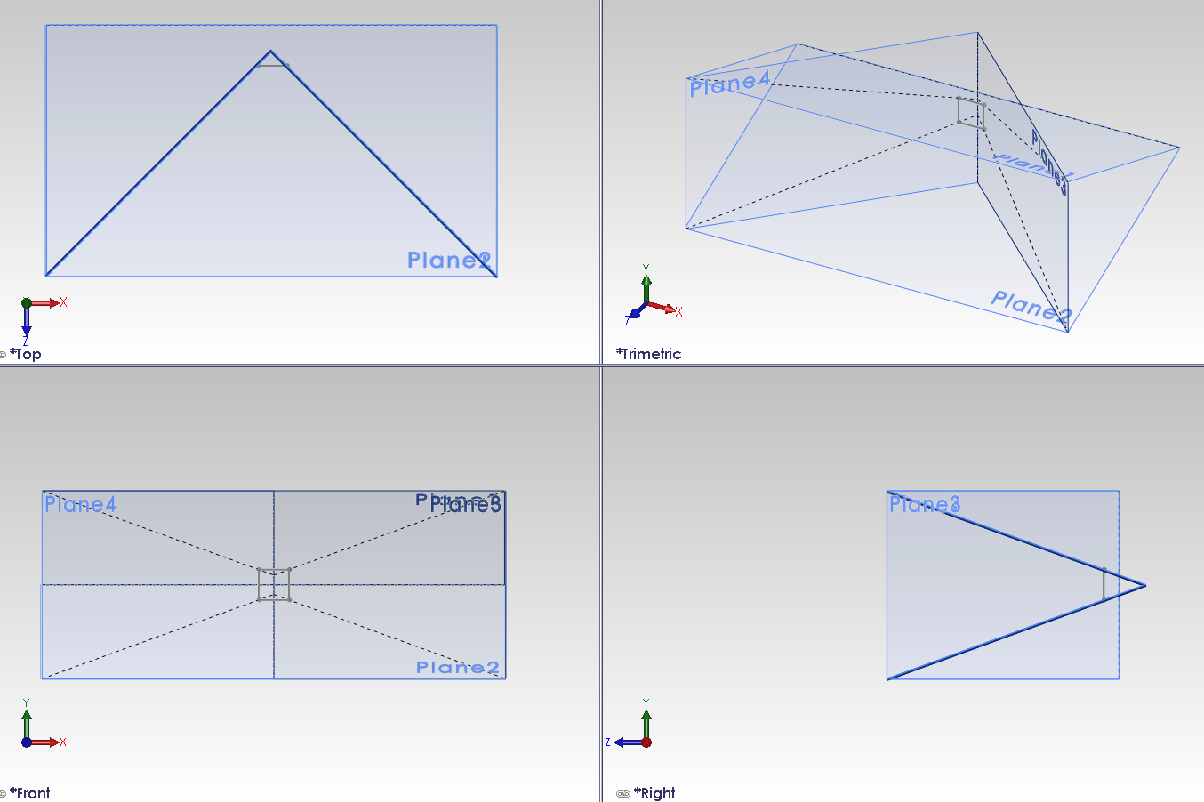

The astigmatism is not caused by the slot loading, it is per Hughes, "caused by different horizontal and vertical apparent apices". This does occur in slot loaded horns and others.
Here is an illustration of the problem:
attachment.php
It is easy to see in this 90 x 40 conical horn image that the side and top walls have different apices which will cause astigmatism in the radiated wave pattern of the horn. This happens because the walls are shifted along the horn axis to make a square throat. If the horn walls make a rectangular throat like the horn mouth, they meet at the same point with no astigmatism in the horn.
In my case, the Quadratic Throat is a transition from a rectangular horn to a round compression driver. Square throats are correct when the horn mouth is square.
Can you hear the benefits of a Quadratic Throat Waveguide?
From testing by Hughes: "Where the Quadratic-Throat Waveguide® really outperformed the standard constant-beamwidth coverage horn was in harmonic distortion. At several power levels and across all frequencies, the 2nd harmonic distortion level was almost uniformly 3 to 4 dB better. And finally, the 3rd harmonic distortion, the most irritating for the listener, averaged about 9 dB better than the conventional design. This is an easily discernable sound quality difference over the older designs."
That is enough of a potential benefit to me to be careful to produce accurate horn wall and throat geometry designed to generate a spherical wave front with minimal distortion.
attachment.php
attachment.php
attachment.php
attachment.php
attachment.php
