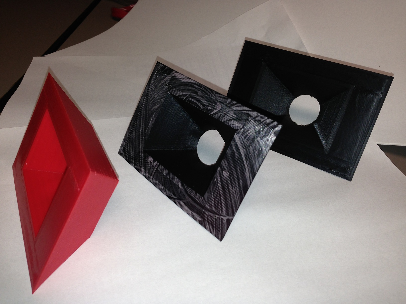

Horn Throat Adapter Test Parts

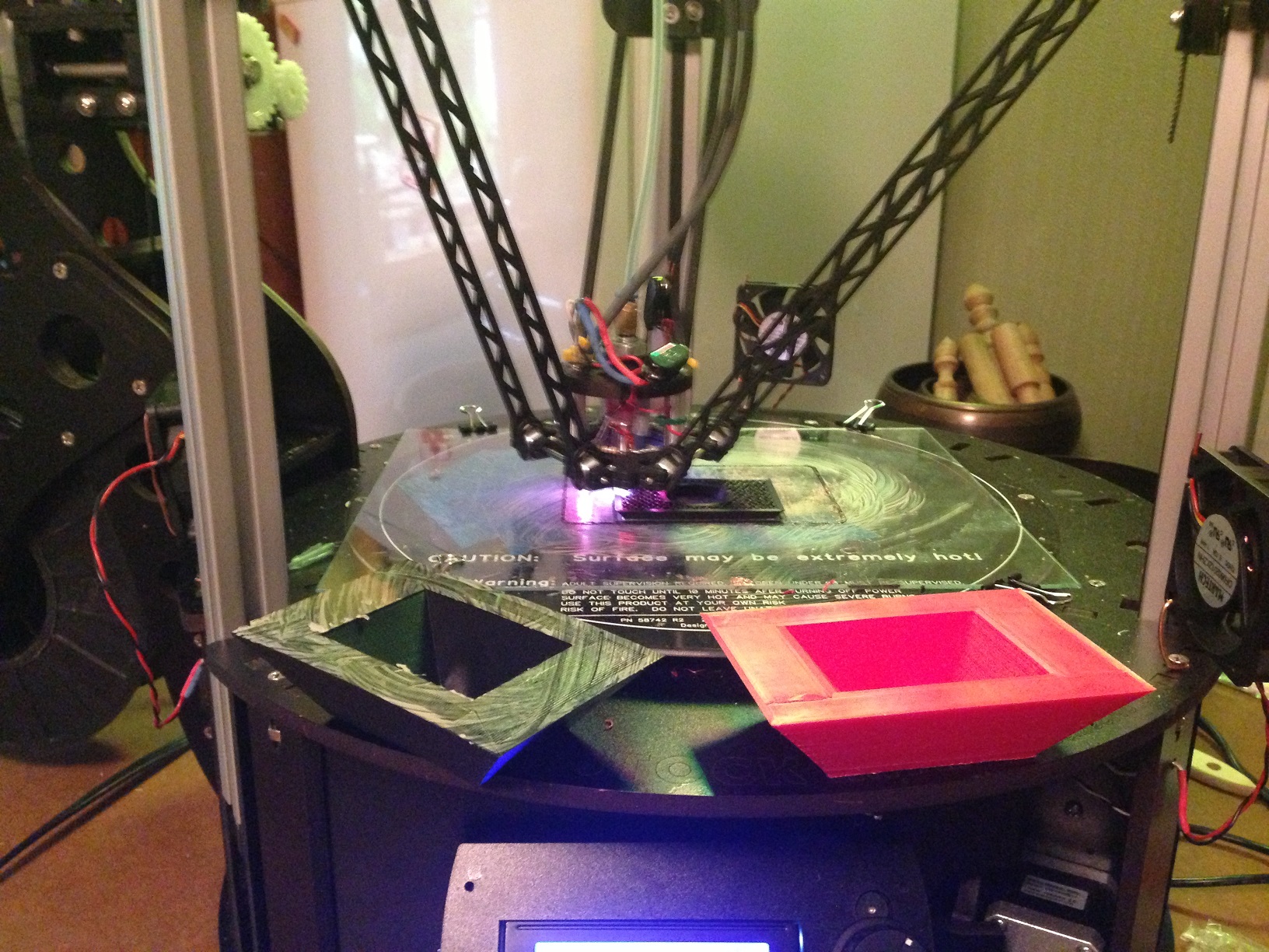

A friend of mine built a rapid prototyping machine: Rostock MAX
It pumps hot molten ABS plastic out of a tiny nozzle to make parts. His test parts are looking good. You can see the interior of the throat adapter is honeycomb in the machine photo.

Next I'll get some of that material I'm planning to use to reduce horn mouth diffraction. I need to determine if I can fit it to the horn OK and check the actual dimensions.

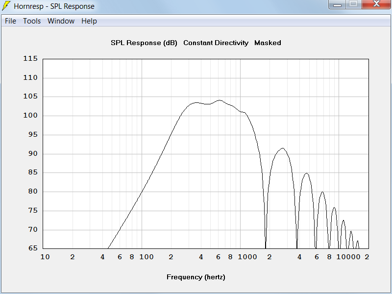

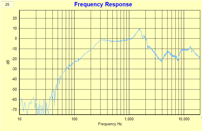

Could you walk me through your thinking on why you went through what seems to be a great deal of trouble to extend the mid range response to 2 Khz when you crossover way down at 1200 Hz? Would that discontinuity at 2Khz be there if you hadn't put that peak on top of the reflection null? I recall Tom Danley himself recommending placing the reflection null right at crossover or vice versa to get the most acoustic filtering. You aren't doing that and I'd like to understand why. My guess would be that you feel that using DSP for crossover and equalization gives you the freedom not to.
Thanks,
Jack
I noticed in many web postings of Synergy horns, the difficulty of getting decent midrange bandwidth. As I posted earlier, I now have an actual measurement of the ported midrange speaker:
The response of the horn when excited directly by an offset driver (no front chamber or port to form a 4th order bandpass enclosure) looks like this:
attachment.php
Now if you add these two responses together, you get those plots showing extended midrange bandwidth. In reality it is a combination of two bad responses: one with a big resonant peak and the other with massively bad comb filtering.
I'm hoping the midrange sounds good up to my goal of 1200 Hz. Any more will be a bonus.

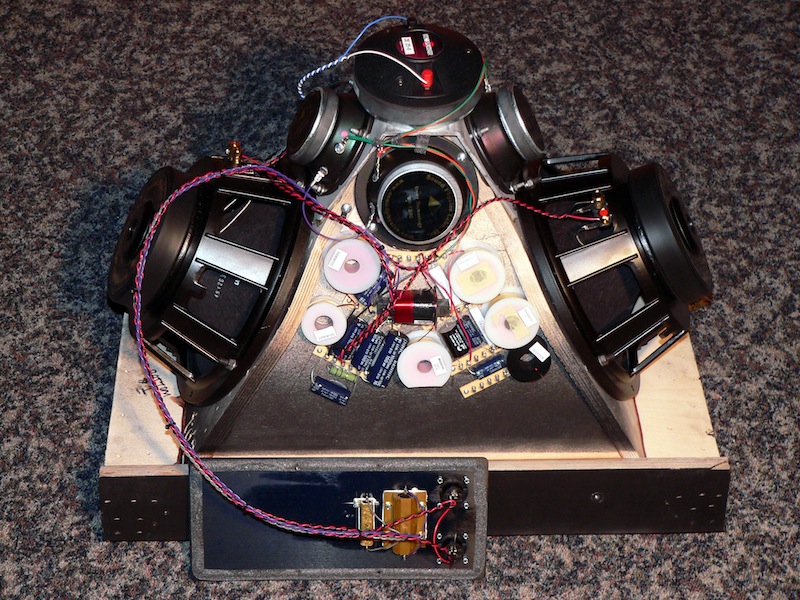

Here's a speaker I bought from Sound Physics Labs when Tom Danley worked there. I disconnected the crossover and tri-amped them with digital XO. The midranges just made it to a crossover point of 900 Hz.
attachment.php

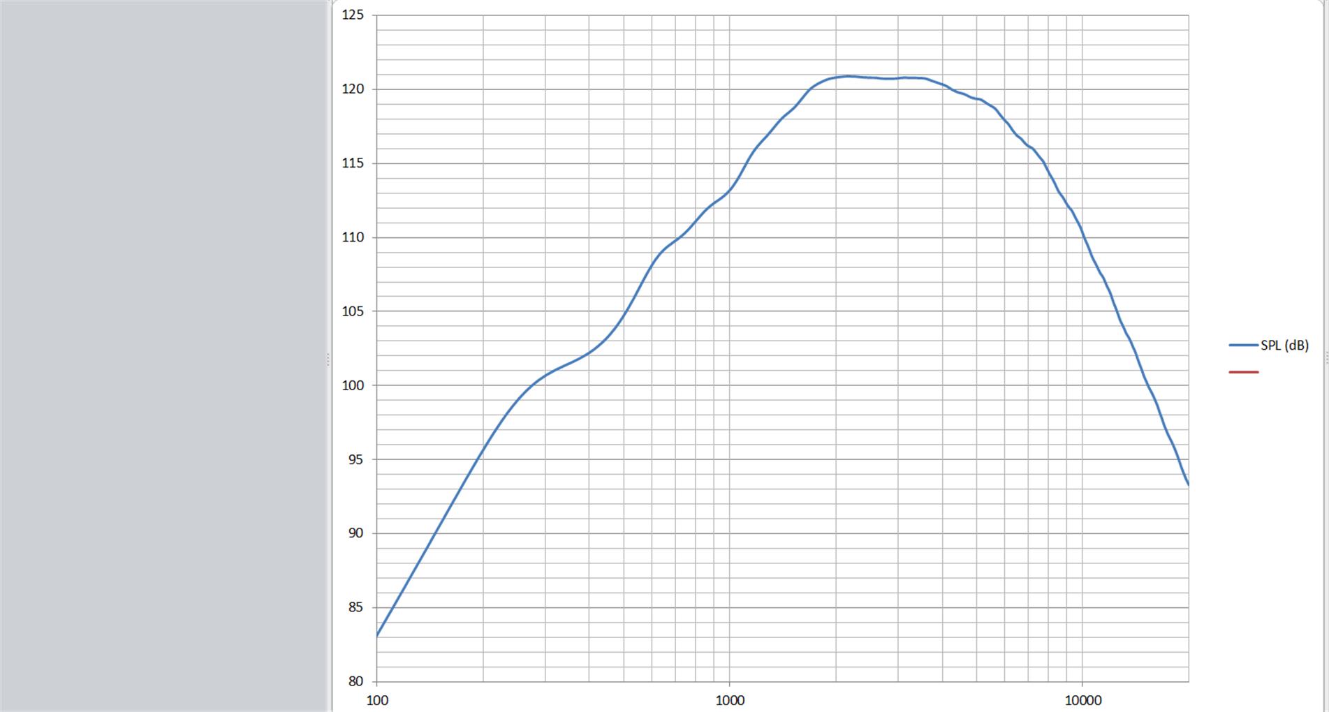

Hi Hulk:
If the mids in that pictured horn didn't make it past 900 Hz, I understand why you are concerned, unless, of course, the designer didn't want them to go higher. Did you model that horn to find the reason? You've certainly done very detailed simulations and correlation so I think you should have more confidence.
The other side of the question is whether the CD will play as low as 1200 hz in your horn. Your flare rate calculation says it does. After the flare rate discussion with JLH a few pages back, I took the BMS4550 T/S parameters and used them for driver parameters in your posted horn resp model, changing it from offset driver to front loaded horn. For what its worth, that sim (attached) shows the driver down 4.5 db at 1200 hz.

The limitation on the Danley horn appeared to be the midrange reflection from the horn throat.

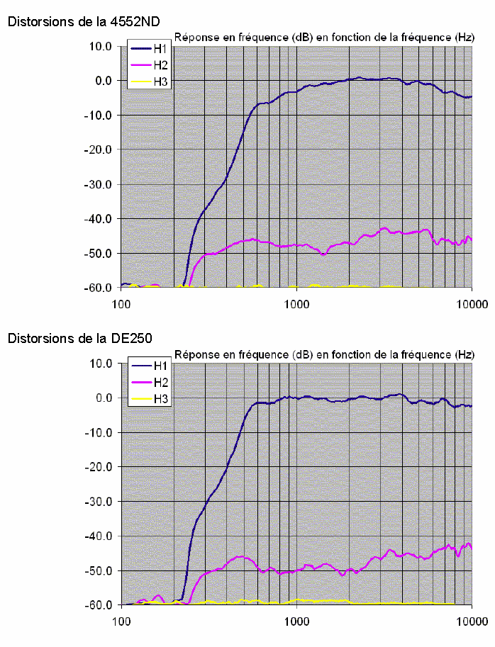

Here's a comparison of a nearly identical BMS driver (4552) to the B&C driver I am using. The B&C reaches lower. In any case, I'll be controlling the drivers to -6 dB at the crossover point.

I've seen those before. I believe they were taken on a LeCleach profile horn with an Fc of 500Hz and therefore may not speak to how low the CD will play on your profile horn. I don't know how to relate low frequency extension of lecleach to conical quantitatively but its clear the conical won't go as low. And then your conical has that initial quadratic expansion which should improve low end. So it remains unclear. Maybe JLH can shed some light - both on my use of his driver model and LeCleach vs Conical w Q-Throat
That is correct.
I was just trying to point out that the B&C driver will go lower than the BMS under similar conditions. I'm also fairly confident that my mids will go higher than 1200 hz.
