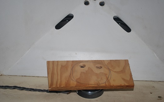

Sergey are you on the DIY soundgroup forum?
Just wondering as I saw someone posting questions on Bwaslo's design. I looked at getting the Celestion mid you mentioned but they are not available. Might have to just try the 5" Mid from Celestion TF0510. Still have to decide on the CD also. Due to outrageous shipping charges I am limited to Beyma and 18 Sound CD's for value.
All in all this should be a fun journey.

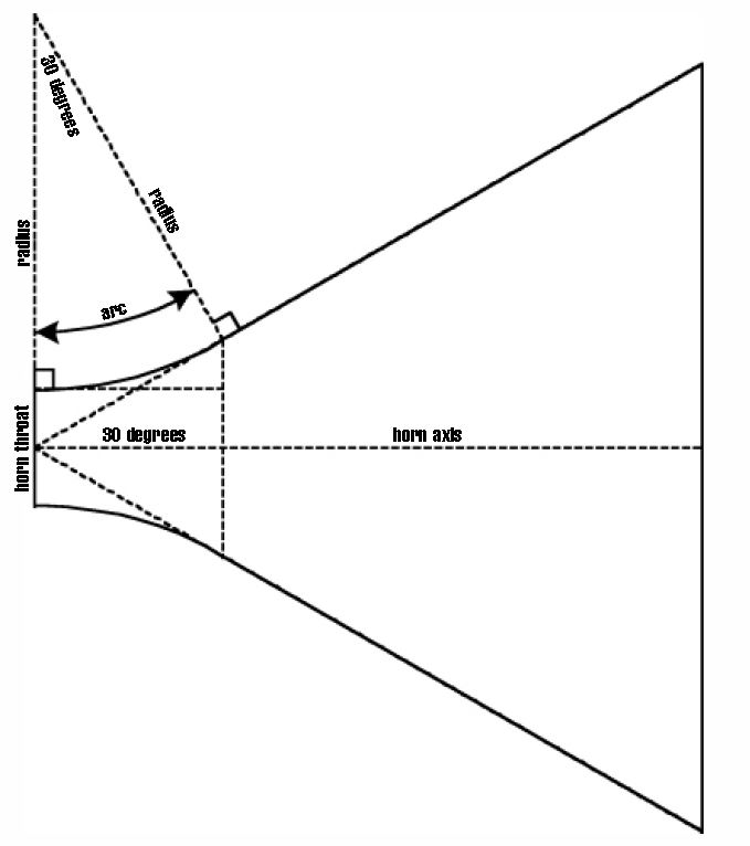

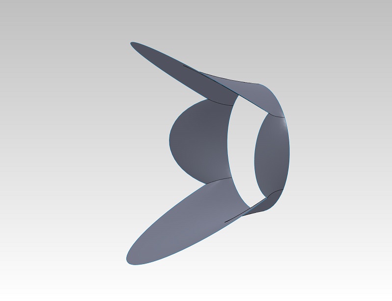

I'm just wondering how you came to your hood lens shape without the rounded corners?
Good question.
Here is a sketch from the Hughes paper. It shows that the horn throat radius (arc) should be tangent to the horn surface and normal to the driver exit. There is only one unique radius that satisfies those conditions in any plane drawn through the horn central axis.
attachment.php

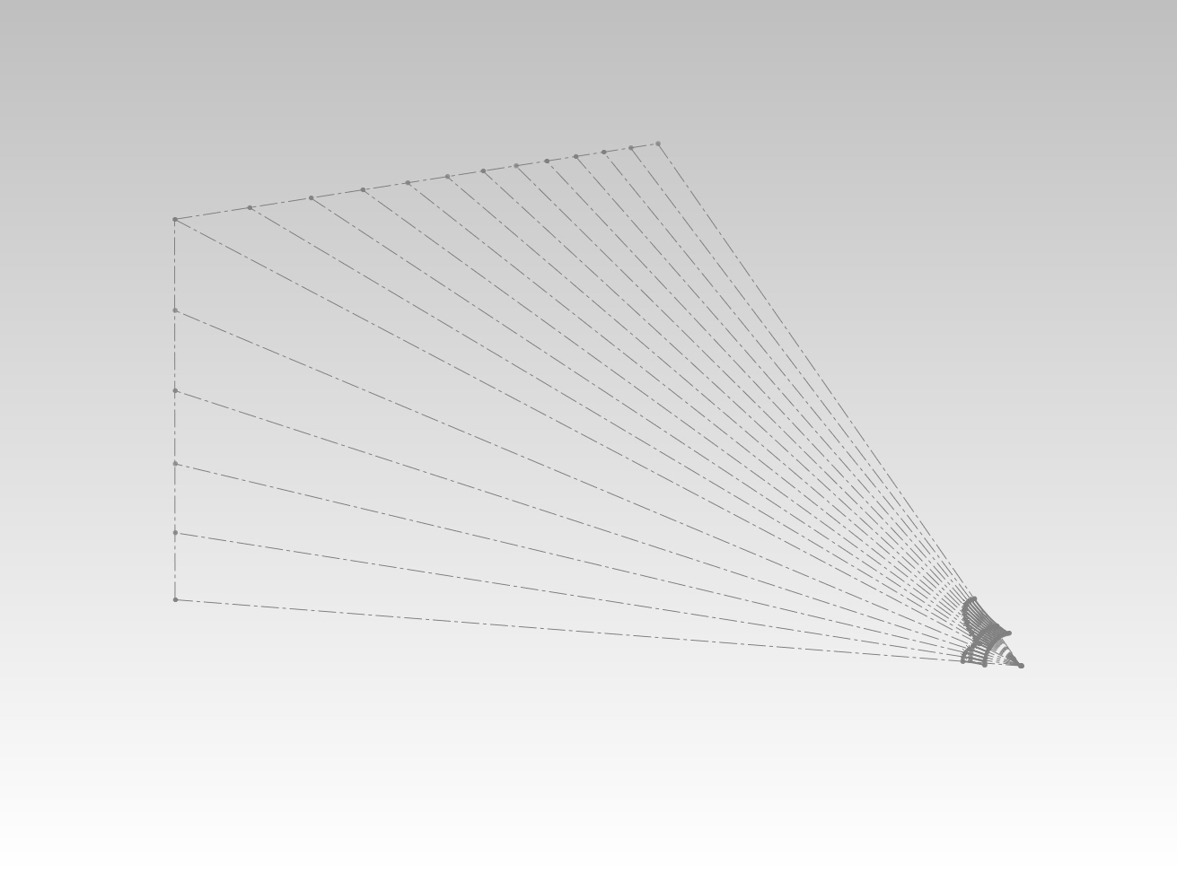

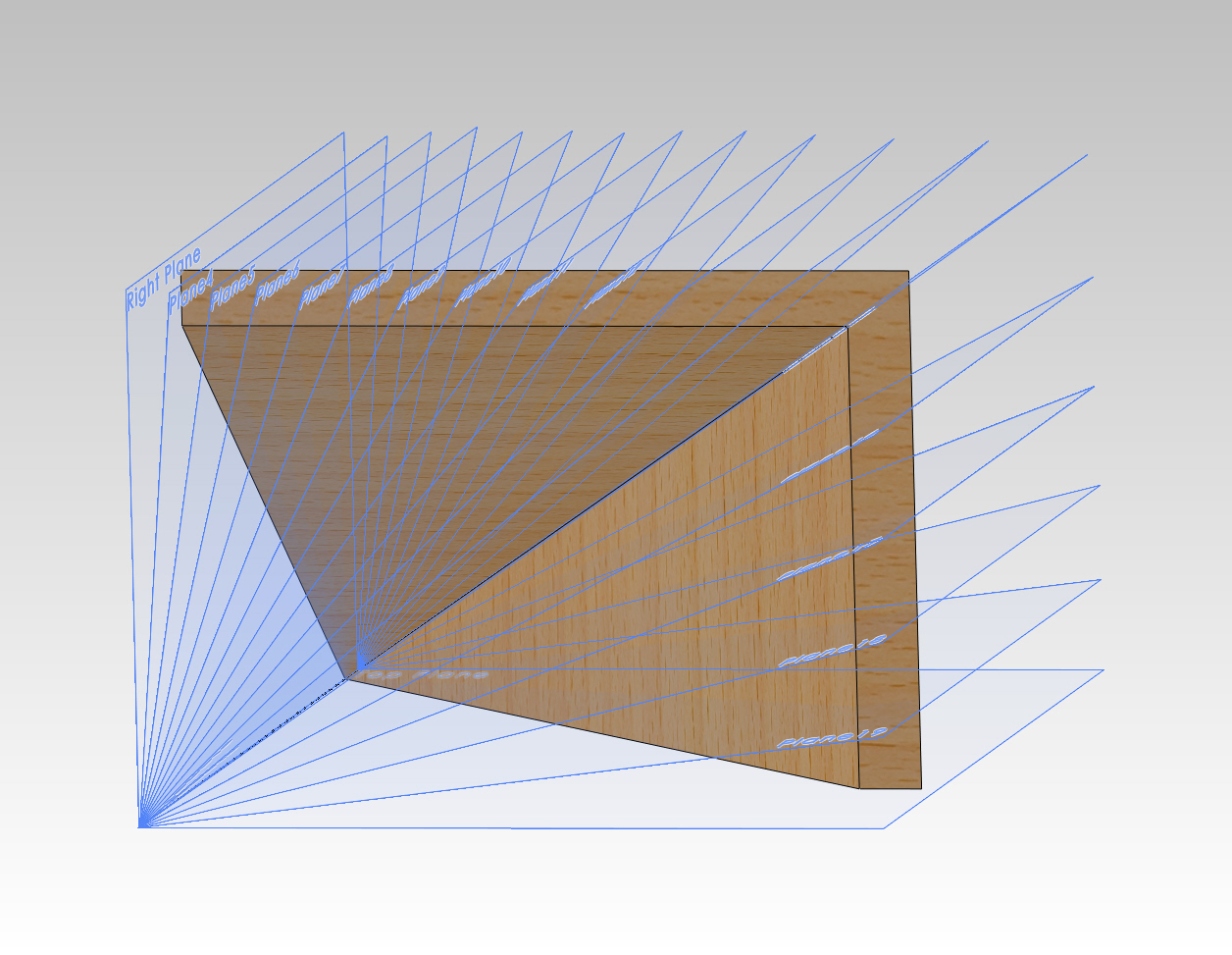

Here is a set of construction planes drawn through the horn central axis. I only used 1/4 of the horn to take advantage of symmetry.
attachment.php

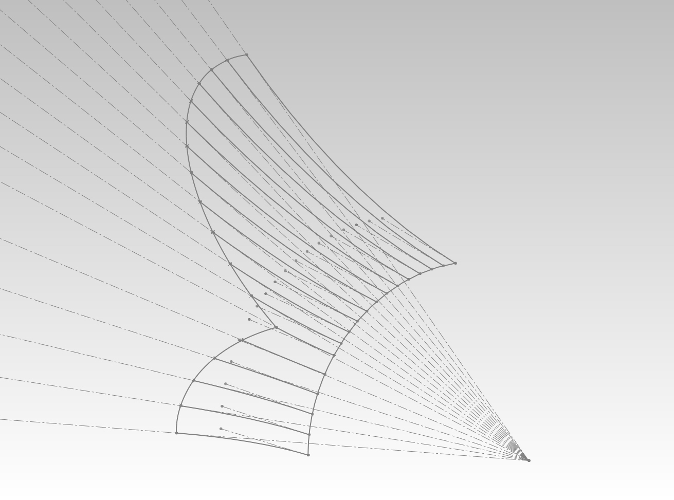

Working in each plane I constructed the "arcs" shown in the Hughes sketch. I matched the compression driver exit angle (7 degrees single sided). I also located the horn apex 10 mm into the driver throat to get the driver closer to the midrange ports. The ports can not move further into the horn. There must be sufficient horn area where they are located to not interfere with the compression driver output.
attachment.php

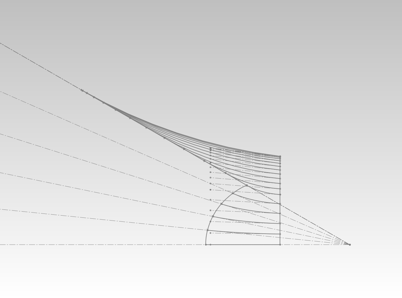

Here you can see more detail. The short construction lines match the driver exit angle. In each construction plane only one "arc" fits that is tangent to the horn and normal to the driver exit cone.
attachment.php
attachment.php
After lofting the surfaces along the "Hughes arcs" this is what results:
