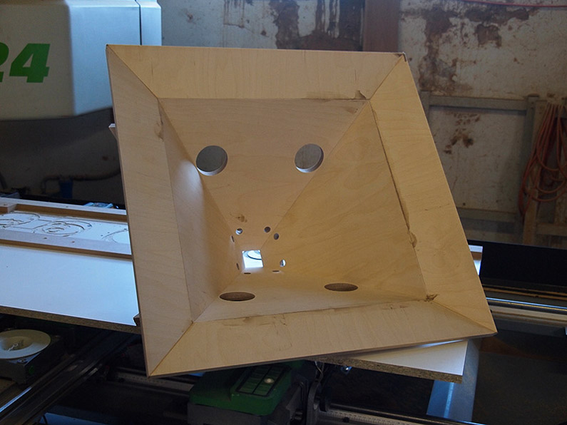

Keep in mind when you mount any offset driver on the side of a horn the response will be comb filtered by the throat reflection. The response of a driver with piston behavior and normal mass roll-off on the side of a constant directivity horn will look like this (centered about 2 inches from the throat end of the horn).
You only get useable response below the first notch. There is no magic to avoid this limitation.

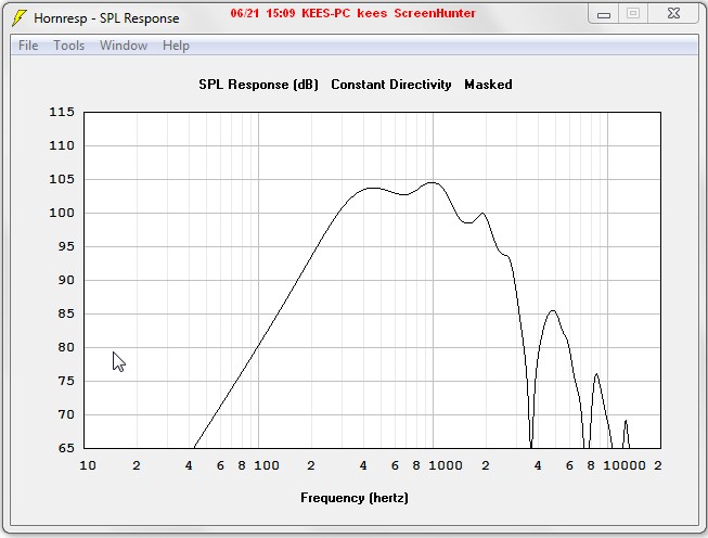

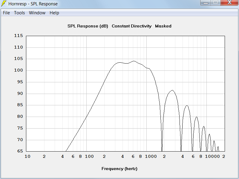

Hi All
I have search some for a midrange for the synergy, I did find a visaton who has open back.
To get a better view what happens when close that back with a tube I get maybe interesting spec,s.
Visaton Full-Range FRS8-4Ohm - ElektronicaWereld.nl - Goedkoopste van Nederland
here I did calc a little closed box behind the speaker, then I get an Fs of 243 hz, so 2 x Fs / qes (if I did now the new Qes) can possible make a nice cheap mid speaker for the europian guys here.
