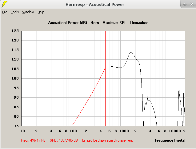

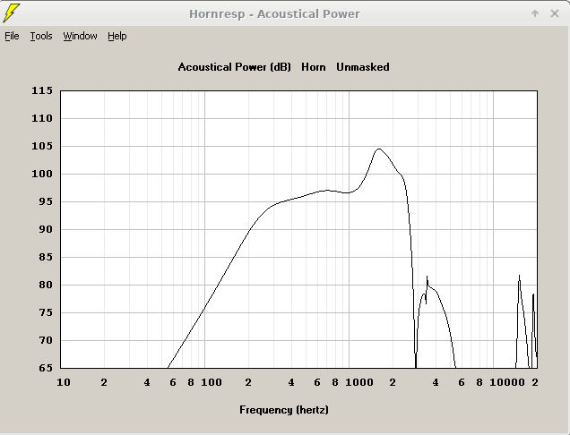

I also notice that the TC5FC07-04 has 2mm xmax and the TC5FC00-04 has only 0.6mm. My speaker is just a low cost desktop speaker though so I will go with the cheaper TC5FC00-04 (thanks for the offer). I think I will cross over to my woofers ~400Hz so the lower xmax isn't that big a limitation. The speaker is still coming out at >100dB/1m and listening distance will be less than this.
2.83V on my horn:
max SPL (0.6mm/5W 2P2S):

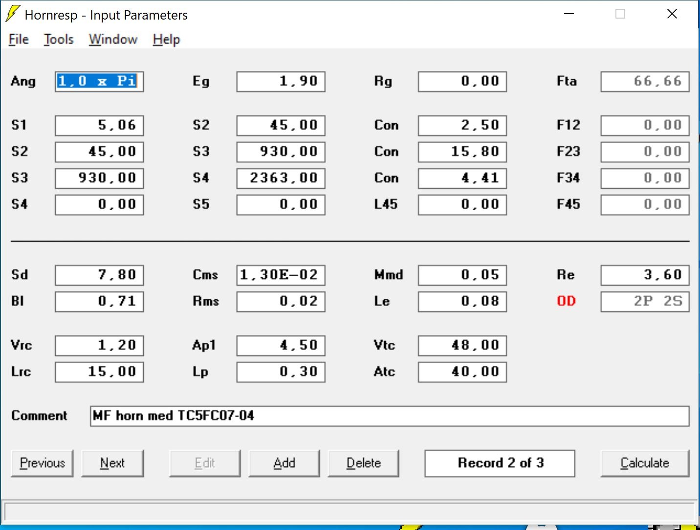

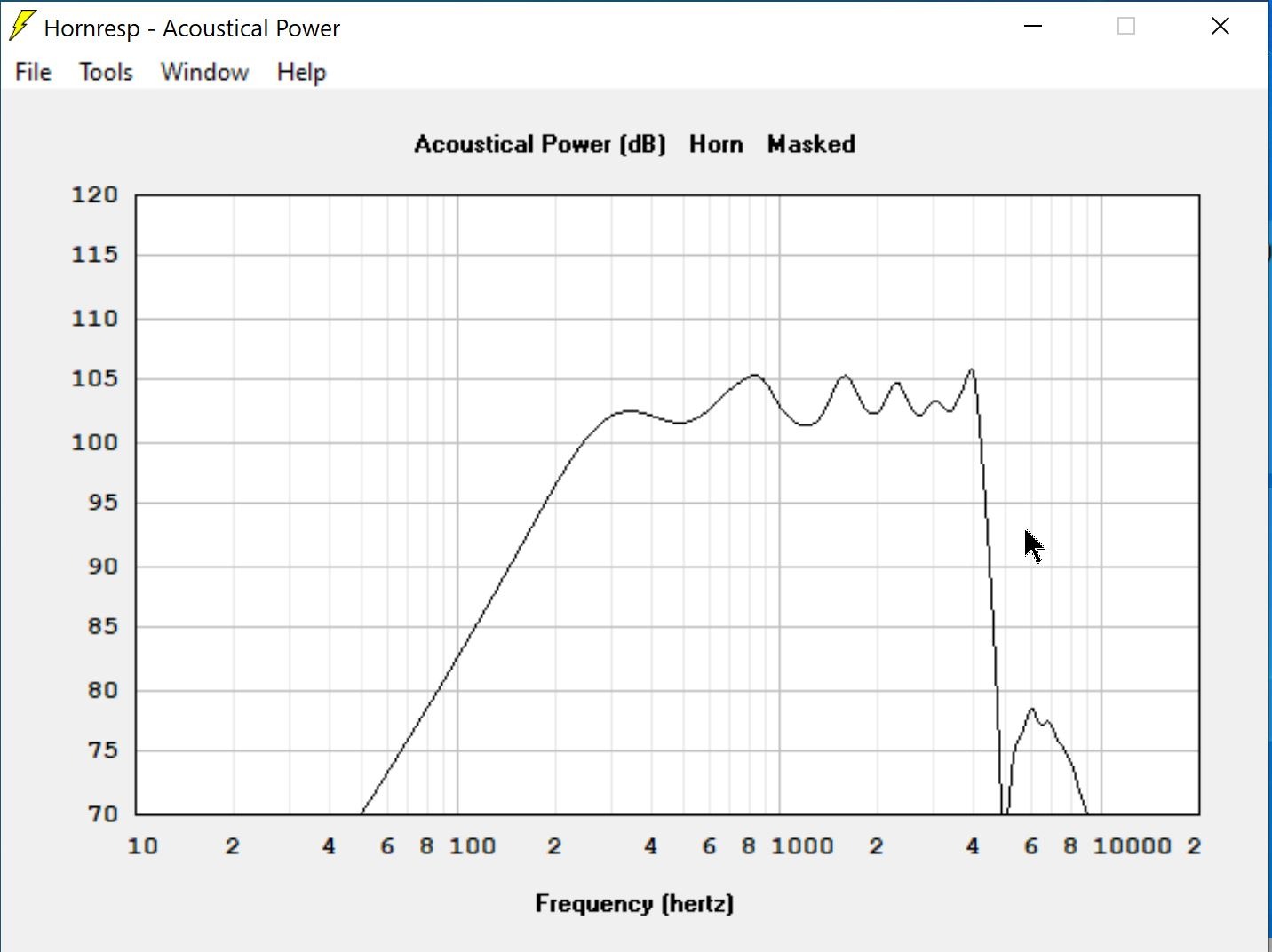

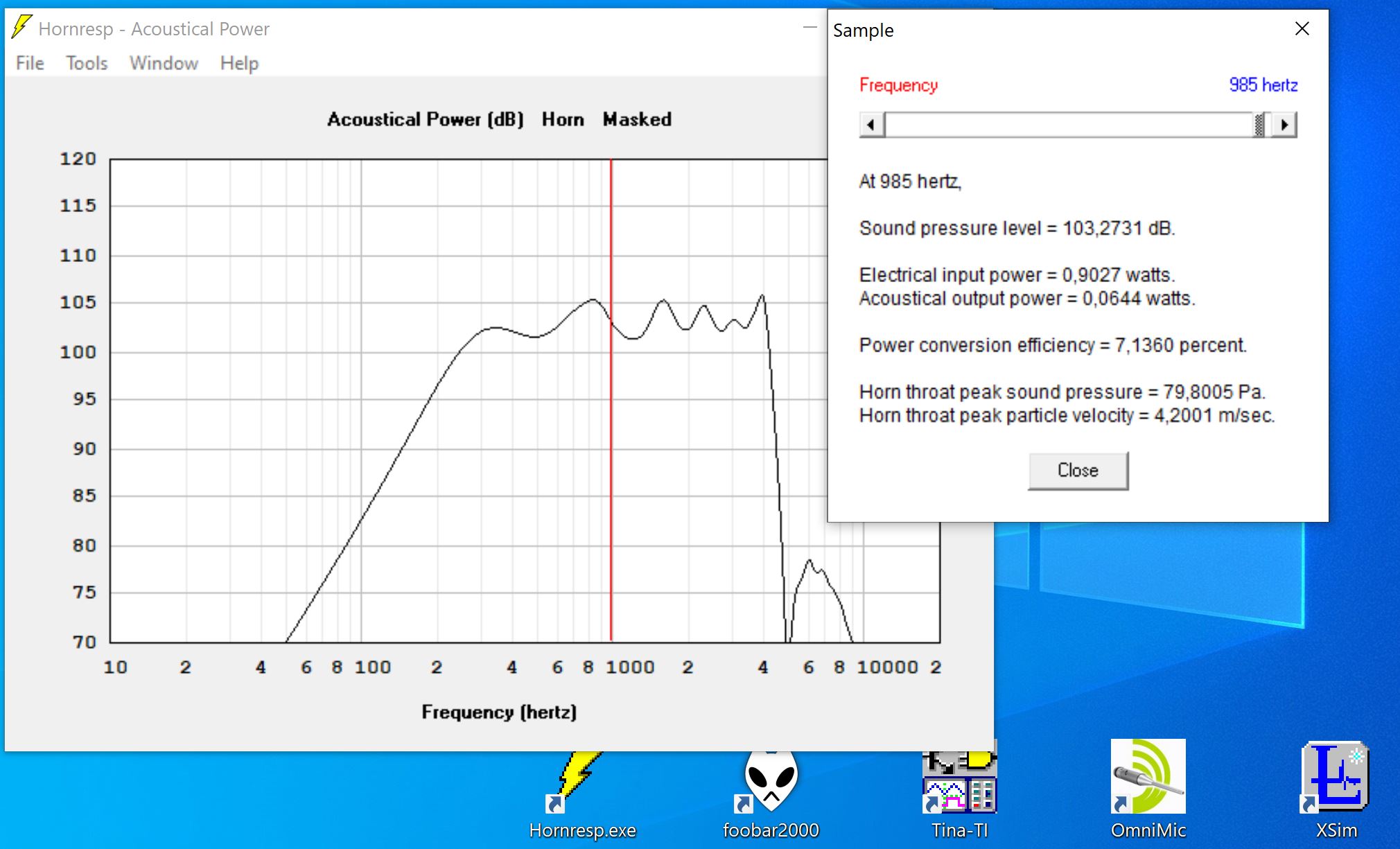

But for HiFi, I gave Petter Perssons suggestion for MF driver in post 2410, Peerless TC5FC07-04, a few minutes in Hornresp, below.
As you can see, a good wide bandwidth which will give you some leverage to do a proper CO, considering phase response, in the 2-3 KH region and thus relieving the HF driver so that a dome tweeter can be used, for instance. Port dia's only 12mm.
Still, these drivers are not "lame" at all. A good 103db/W, displacement limited at 400 Hz/2mm (which will be mitigated by the HP section in the BP filter), plus an electrical limit (5W/unit) at 115db !
I think our spouses will have left long before that 🙂

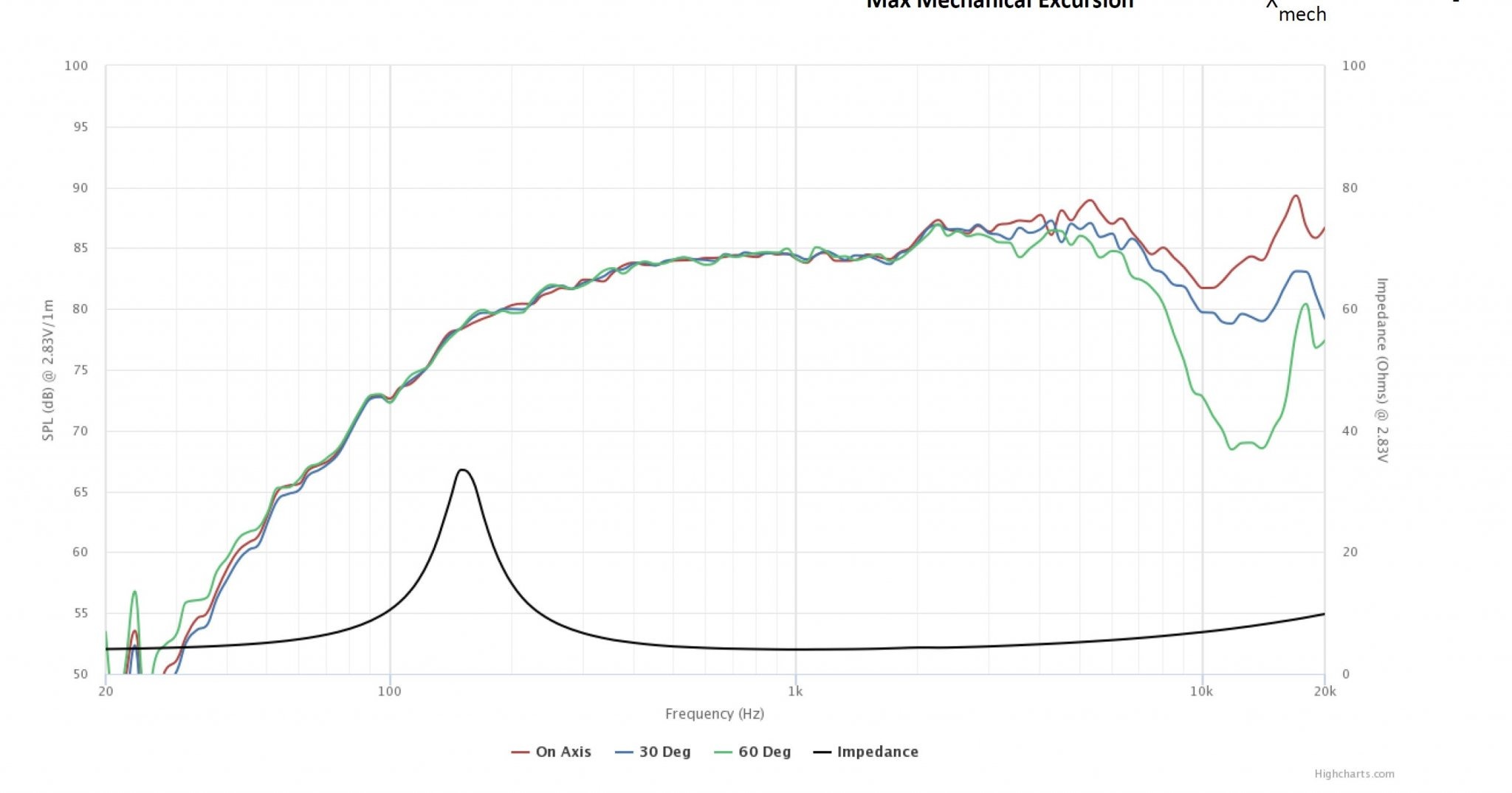

Indeed it does ! But there is more !
Have a look at the frequency-response in the Data sheet, below.
There is a level increase above 2KHz, right up there where we need it.

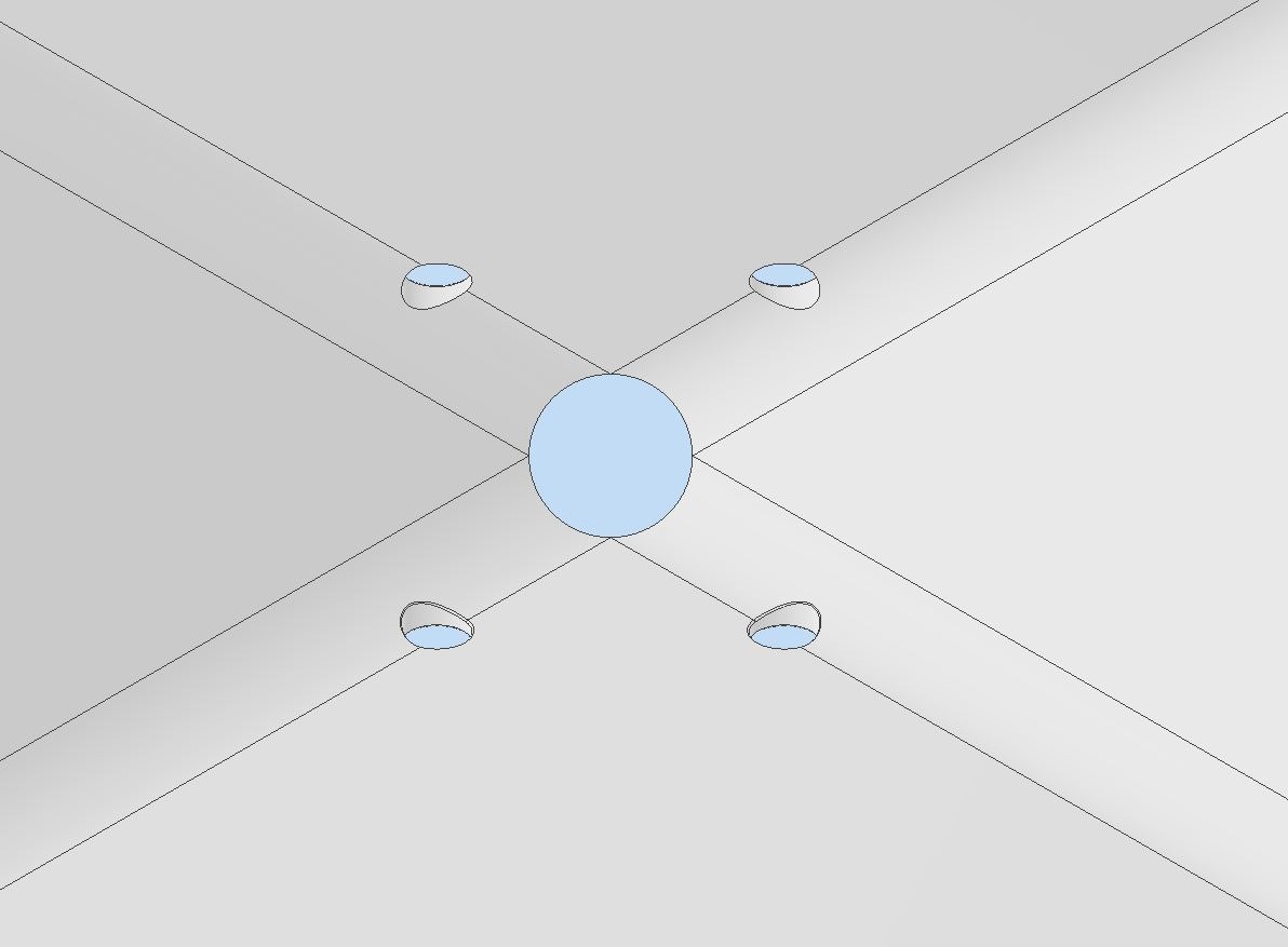

I have now ordered the drivers and is already on the way of modelling 3D, sneak previews below.
I guess it should be possible to 3D print the first section and have a look-see of MF-HF interaction.

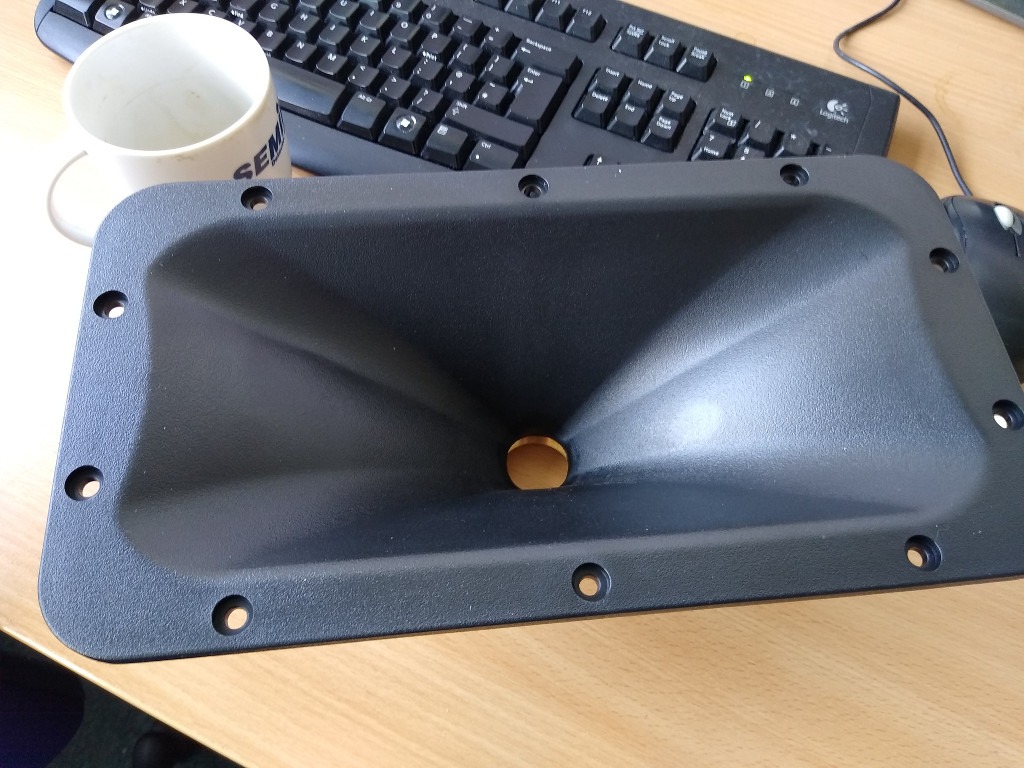

My H6512 waveguides arrived:
I think I can get the injection ports at closest 4cm from the compresion driver but will have to have the mids on hand to work this out.

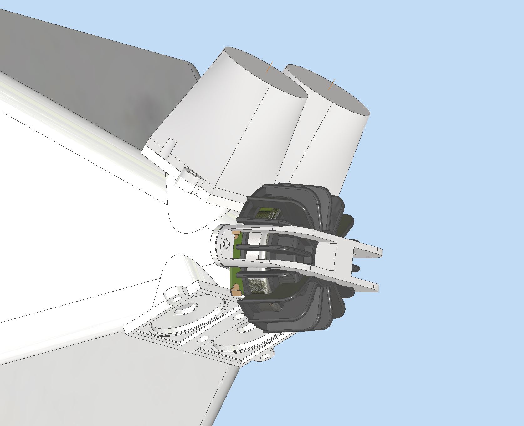

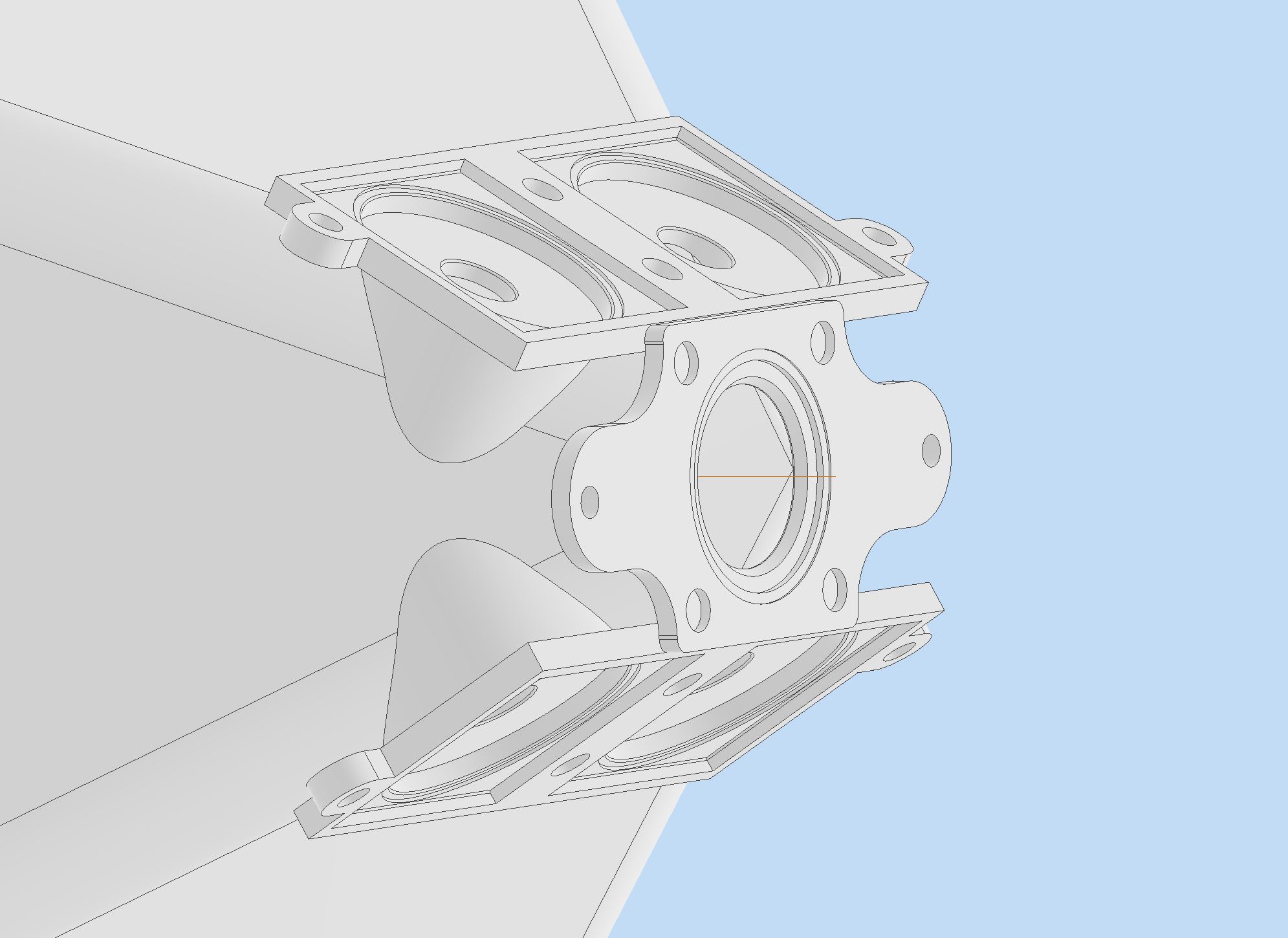

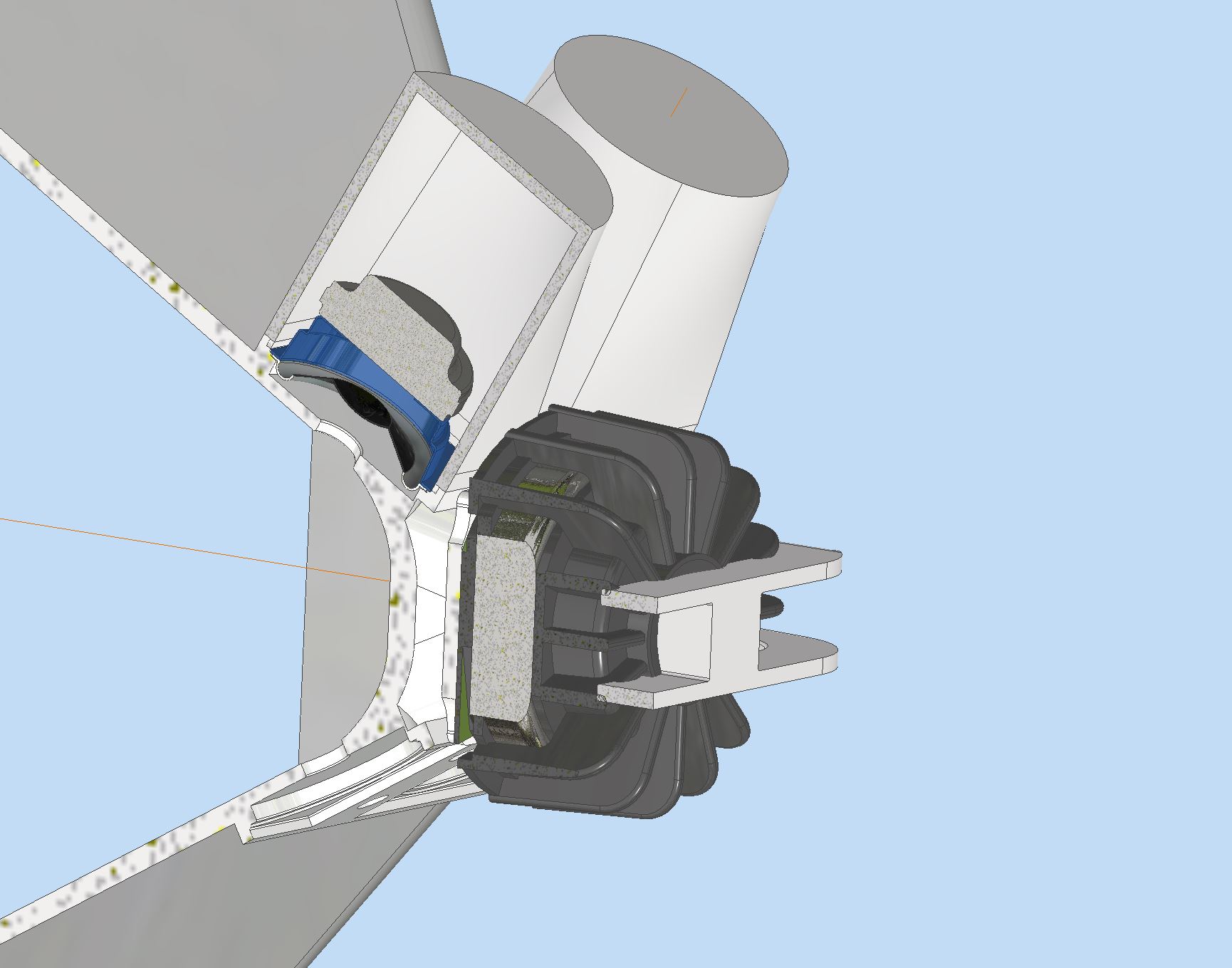

In reply to Kipman, post 2451, and in a way also to Petter Persson, post 2417 (reg. using a dome):
Yes, well spotted. It IS a close fitting indeed, but as you see from the modelling I showed in post 2449 it can be done due to the small size of the Peerless TC5FC07-04 driver. Best I think by 3D printing.
But still, the area at S2 (~40 cm2) corresponds to a circular circumference giving upper horn loading freqency of only ~1600 Hz... bah ! The rest relies on controlling the upper Vtc resonance.
But why ? you may ask.
Well, you see: Studies made for Rashorn1 (my link post 2420) showed that the relative delay between the HF and the MF (B&C DE250 comp driver and 4 x Visatons FRS5 X respectively), was 63mm, the MF's in advance and thus in need of delay.
Replacing the B&C 250 DE with a dome tweeter, Audax TW025A26, this delay was brought down to about 18mm, a 45mm reduction, which is very plausible just by looking at how much further back a compression driver is.
Using a 2KHz cross-over frequency, 18mm is only 1/10 the wavelength and probably OK to be called "in-phase".
However, we are purist or what ? The MEH I suggest above in post 2446 and 2449 using Peerless TC5FC07-04 and Audax TW025A26 will bring S2 10mm further back, and S1 3mm further forward, thus reducing the relative delay to only 5mm.
The 3mm is due to incorporating the throat adaptor (the disassembled front plate of the dome tweeter) into the horn itself, see illustration preview assy 2 in post 2449.
Rashorn1 used a 3mm 3D printed adaptor in place of the front plate. But in this case there is no place for screws in the flange due to the tight S1/S2 fitting and so I suggest a yoke behind the driver which the Audax is very well suited for.
All of this means that such horn, dare we call it Rashorn2, is a "sweet-spot" design that offer drivers in-phase AS IS.
No delays in the CO network are required, just plain and simple BW2 and reverse the wiring to one of the drivers to get back in-phase, as discussed in more detail above.
