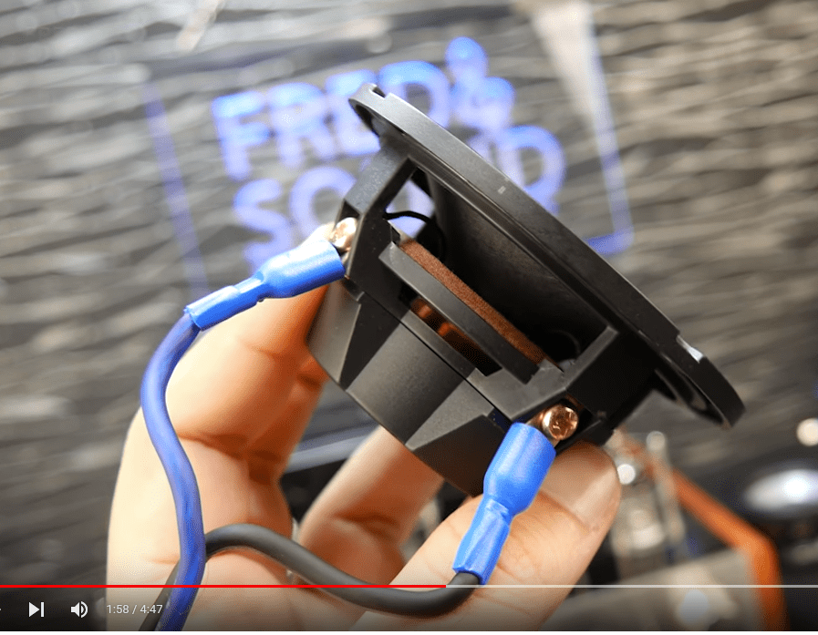

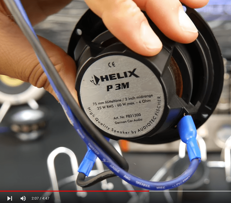

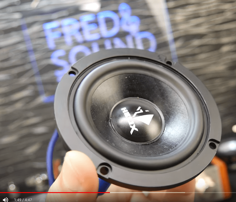

25mm voice coil.
approx £150 a pair - video shots from Fred & Sound channel.
Suitable DIY candidate?

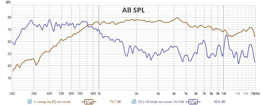

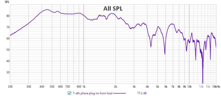

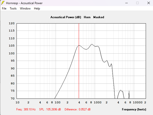

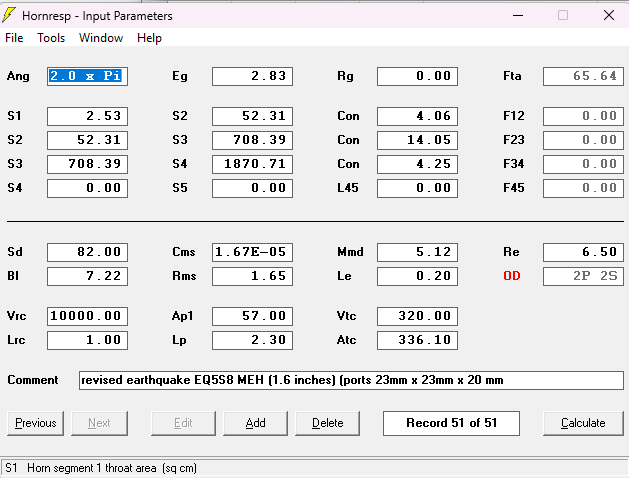

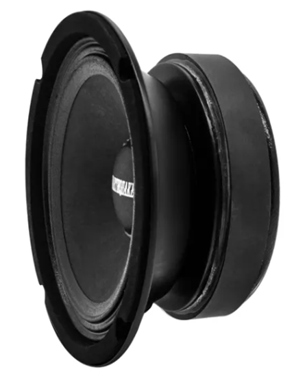

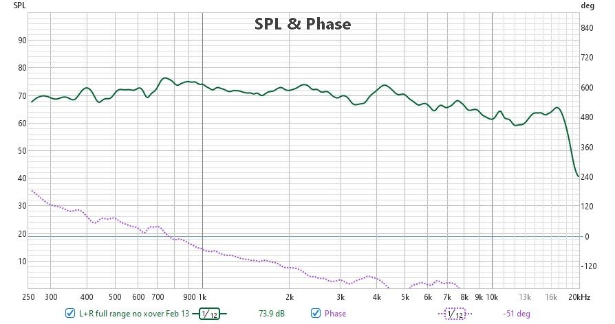

I’ve been experimenting lately with a 5” sealed back midrange from Earthquake, the EQ5S8. It doesn't seem to be a common choice for a MEH build so I thought I’d give it a go and share some preliminary results. I'm still on a journey of discovery in terms of the complicated MEH juggle but I thought the driver had some qualities that maybe ticks a few boxes (FS around 500hz, BL of 8.4, pleated surround etc).
Despite printing and testing a slew of different ports, cone fillers and slots to push the response higher, the best compromise I seem to be able to achieve with 4 EQ5s8s in my small prototype horn (thanks Bwaslo for SynergyCalc!) is attached (note no electrical filters are applied). I can’t quite push up to 1khz to meet the DE250 as high as I’d hoped which is a little bit of a dissapointment. My Hornresp sim is roughly the right shape but the high and low corners are much lower in reality. Not sure why I’m not closer to the sim (assume I messed up the model somewhere) but it looks like a somewhat promising bandpass and acoustic rolloff can be achieved on these mids? I might just have to live with a crossover around 900hz if I want to use these 5” drivers. The MEH horn design was intended to sit above a direct radiating or horn loaded kick, but it needs a lot more work (and possibly a BMS 4550 or a 1.4 inch comp).

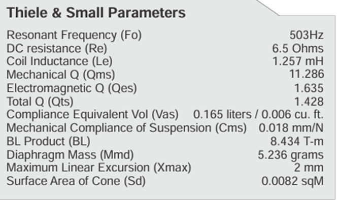

If your ports are 23x23x20mm as noted in your Hornresp screen shot, your length is 2.3cm and you have one port per driver as your cad shows, how do you get 57cm^2 for port area? I would think 18.4cm^2. Did you include the DE250 throat and phase plug length in your model? If you simulate a shorter distance between the midrange entry points to the back of the horn than exists in reality, that will make the notch in the response from the reflection move up in frequency. Your driver inductance is much lower than the inductance given in the driver specs which would also make the sim show more HF output. I would also probably simulate this in 4pi, not 2. However even changing all this it still doesn't do a great job matching your measurements. It still has a HF corner around 1.5kHz as compared to your measurement which looks like more like 1k. You might look at your front chamber volume to verify that's correct.
  • Thank You
Reactions: rrobot
Hmm, your Cms based on published specs s/b 1.77
Per this post and using the VC dia. = ~34400/pi/3 cm = ~3650 Hz, then tune the chamber to (503*3650)^0.5 = ~1355 Hz upper limit, which requires Vtc = ~180, reducing passband eff. to ~100 dB or if flat to 1 kHz @ 100 dB, then need to at least double your 320 Vtc.
Couple of clangers there, oops! Thanks for picking those up! :blush: Clearly my Vtc needs attention also ...thanks @GM for the calculations 🙂 I'll review and revise the model.
At the moment, no I haven't included the DE250 phase plug length in my modelled distance from throat. The reflection notch is high enough i think to not be causing my early rolloff which is present even when I measure at the port exit with the baffle inset removed from the horn or on a separate baffle. My ports are angled through the 3d printed horn and the port taps are just over 4cm from the compression driver bug screen. This is probably too close in reality (the mid ports do seem to significantly impact the HF response) but I've stuck it that close in order to preserve the horizontal port to port 1/4 wavelength distance. Currently they're nearly 9cm apart which I calculate is bordering on too distal if I'm looking for them to play up to 1khz (and beyond). I'm considering moving them out of the corners just to bring them closer together. I think Bill discussed doing this on one of his MEHs.
To be honest I haven't really looked at my hornresp model in a while but instead have been printing and testing ports and phase plugs, partly because it's given me a good sense of the impact of port length, size and Vtc. It's been a bit unscientific but I don't really see it as wasted effort, just learning. I can actually push the response from the bandpass ports higher, but the response isn't pretty after 900hz (I'm guessing I'm getting cancellations across the cone?) so I went back to a flat baffle. The attached measurement is taken outside the horn.

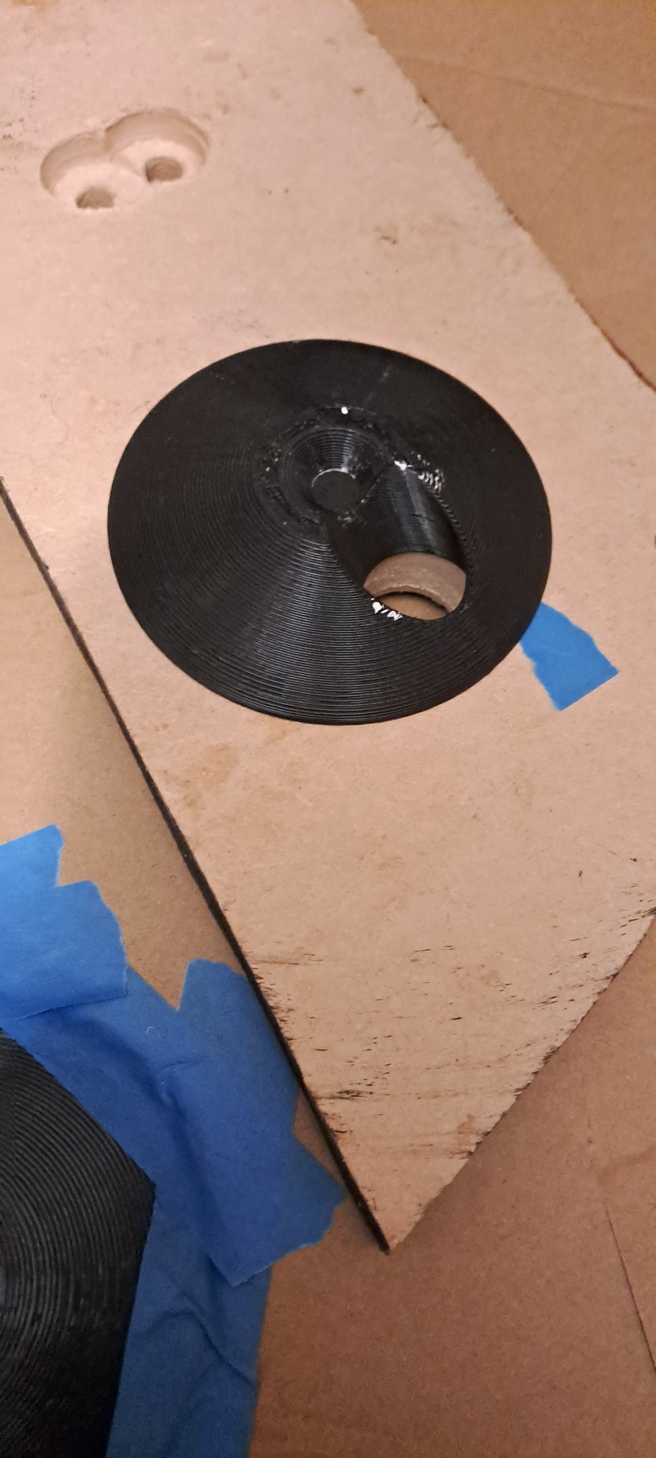

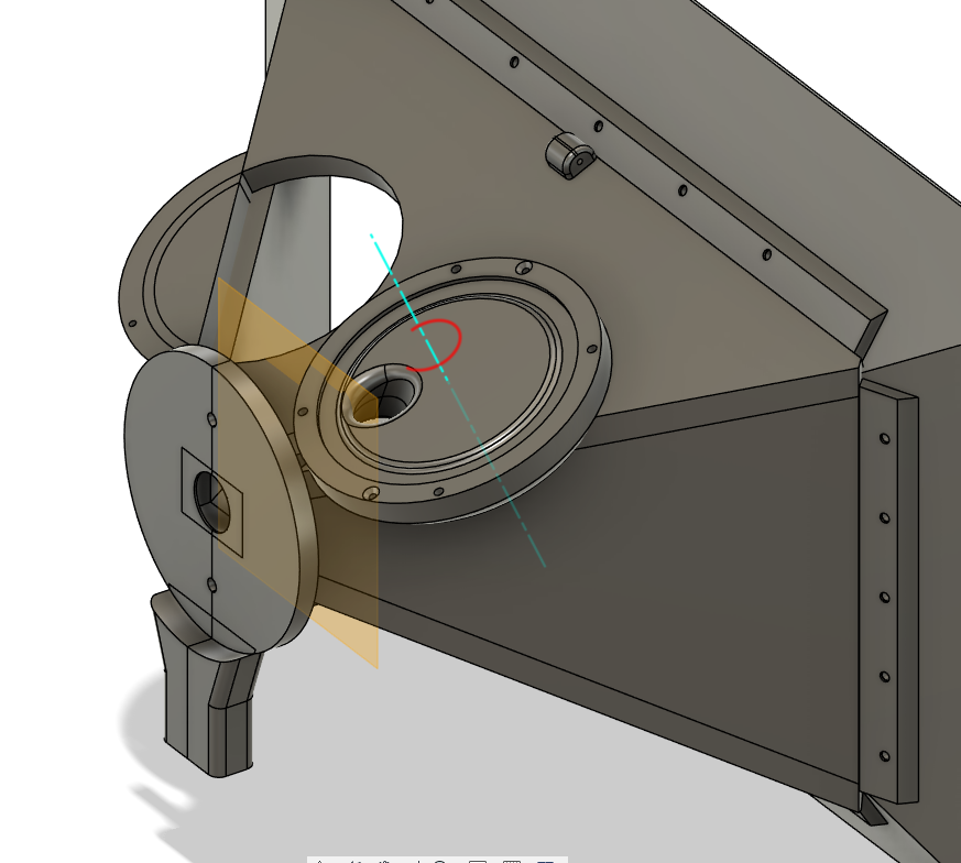

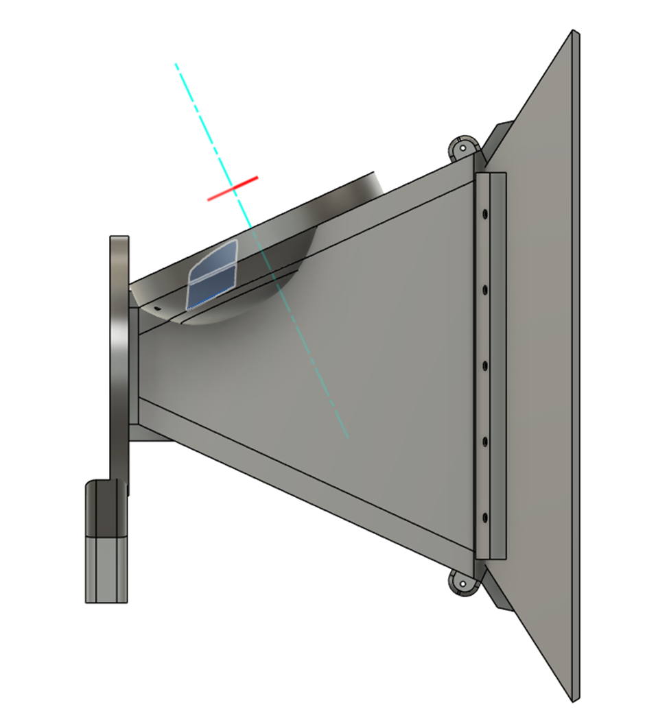

there is another mechanism by which the upper limit is limited, so to speak - cancellation from sound arriving at the hole into the horn flare from most distant parts of the cone out of phase with that from nearby portions of the cone.
As frequency rises, there will be cancellation as the distance approaches half a wavelength. I've seen the problem myself with 8" driver. I wouldn't expect it with a 5" driver but your cone filler may increase the travel distance enough to make it a problem. If the Vtc isn't the limiting factor, then removing the cone filler might extend your upper limit.
What I did with my 8" driver was make an angled tunnel in the cone filler so it collected sound from the center of the cone and tunneled it over to the edge for penetration through the cone flare..
Reactions: rrobot, GM and grec
... was make an angled tunnel in the cone filler so it collected sound from the center of the cone and tunneled it over to the edge
This is a great suggestion! I was actually looking at Patrick Bateman's metlako port design where he has a port opening at the vertex of the filler roughly the size of the dustcap expanding to a long, thin slot in the horn wall. This might address both the port tap disruption of the HF response and block any cancellations from the edge of the cone. The worst dip when I try to extend the upper corner seems to be at about 1.3 khz, the half wavelength of which is just over 5" so the out of phase cancellation you describe seems quite plausible here - since the ports are near one edge of the cone, the distance from the most distal side of the cone through the port could very easily equal about 5 inches. Since it's quite a broad dip, I'm wondering if that's cancellations from different parts of the cone which are different distances from the port exit?
