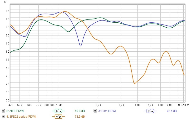

Here is a measurement of my AMT-1 + 2x 3FE22 MEH with both mid and HF in parallel.

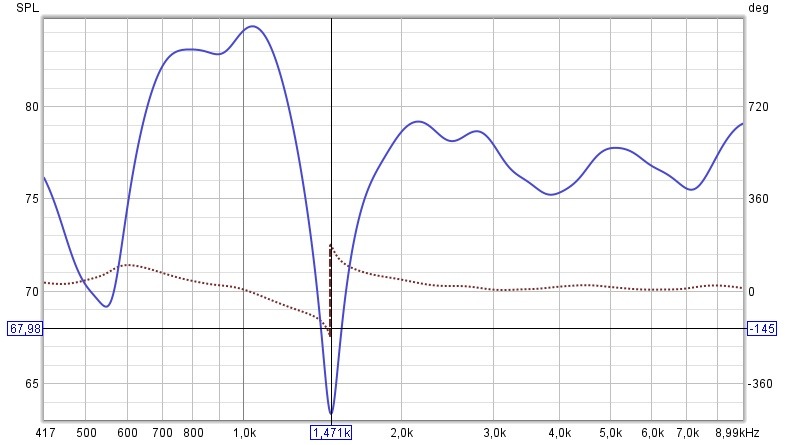

So what you say above is to use 2nd order BW at 1468 Hz (the cursor is a bit off at the export, idk why) and that should give me perfect phase alignment? I need to try that.
Yes, in theory you should see a "phase restablishment" at the XO frequency 1471 Hz above.
However, I think you should "level" HF and MF responses prior to the above measurement. That may shift your notch frequency a little bit.
Also, after levelling. make two measurements, one for each driver individually. Just to see the extent of overlap.
If the overlaps are substantial, the above should hold fairly well.
However, if not. e.g. each driver slopes at 1471 Hz already, there are "other filters" in there, and you should not expect much.

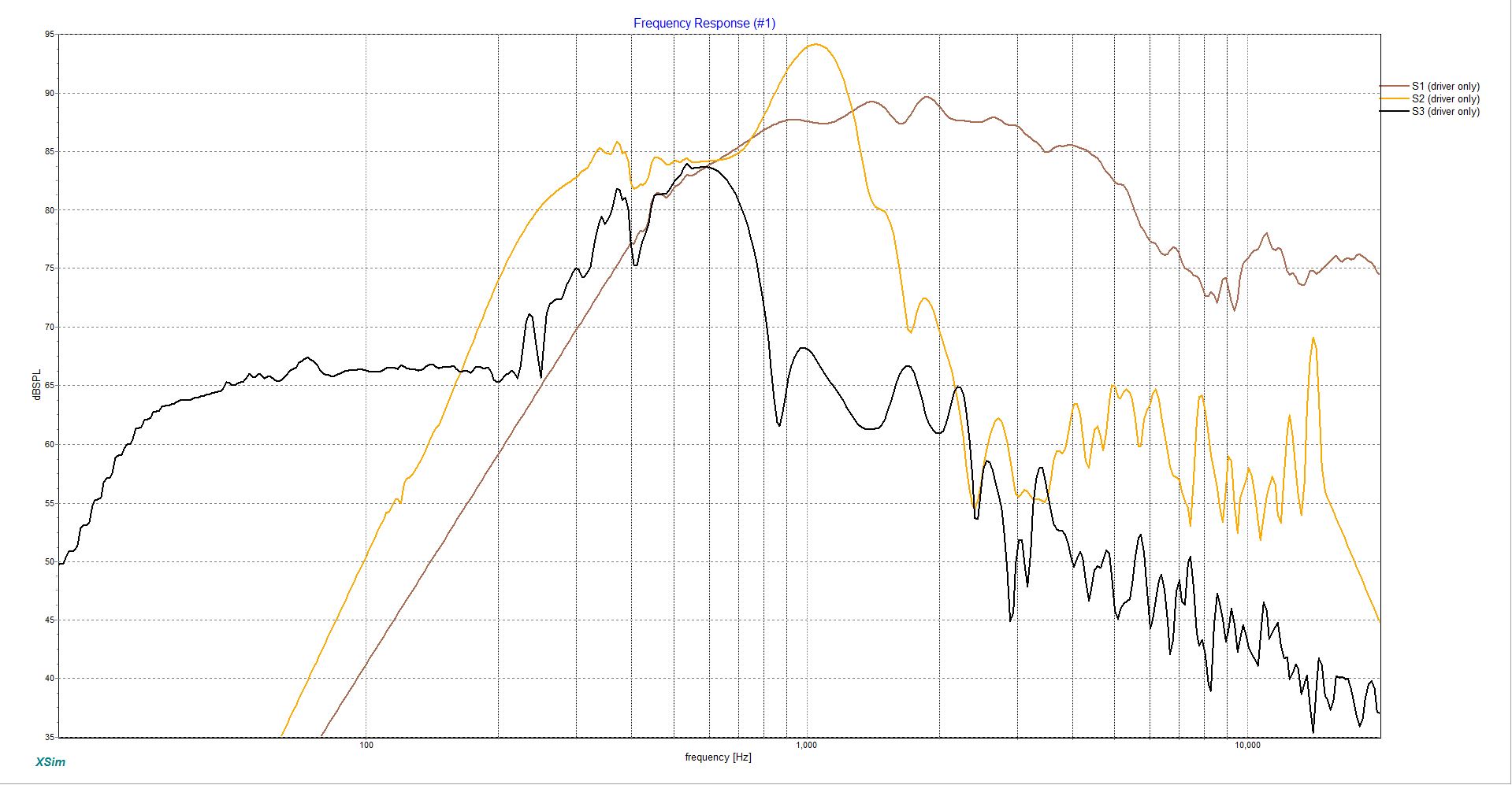

Yes, I think it needs a bit more attention, this is all three plots in one chart. I tried to make the crossover in XSIM and it makes some nice on axis summation. My first DSP crossover for this was at 1 kHz and a little delay compensation - worked fine as well (on axis). There is quite a nice overlap ca 700 - 1400 Hz available, that gives some freedom with DSP and might work also as passive.

Thanks for posting the frequency response chart.
It is clearly seen, that the large diaphragm volume of the Faital 3FE22's is shunting output to S2, decay is from about 1 KHz.
With your midrange already in decay at the XO frequency "other filters" are in there and the "BW2 trick" will be more subtle.
In your post 2425 you used the words "....should give me perfect phase alignment".
Well, needless to say, I hope, the "BW2 trick" will only do that "perfectly" if both speakers have infinite and equal f-responses.
That will probably never happen, we have to be pragmatic about the issue, but still, the "BW2 trick" can bring us a long way and is, I believe, sound engineering.... ahem 🙂
But just as interesting is that the chart in post 2429 shows both drive units largely within the minimum-phase regions.
That means that prudent use of parametric equalising (e.g. starting with reducing the yellow curve about 5 db) to equalise the amplitude responses
will, also equalise the phase responses and thus get us a little bit closer to your "perfect phase alignment", using BW2.
In the case above, however, I am not convinced that "prudent equalising" will be to lift the yellow curve 20 db at 2 KHz.
But perhaps dumping the Faitals and use 4 pcs. 2" units could do something ? Depends on the size/position of S2 as well, of course.
Digital delays will probably upset the minimum-phase property, though. I am not sure about that.

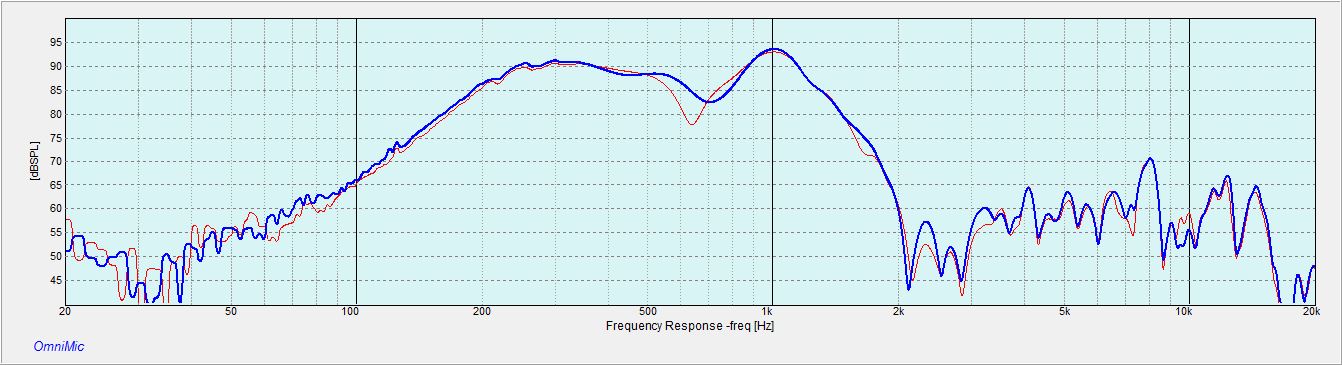

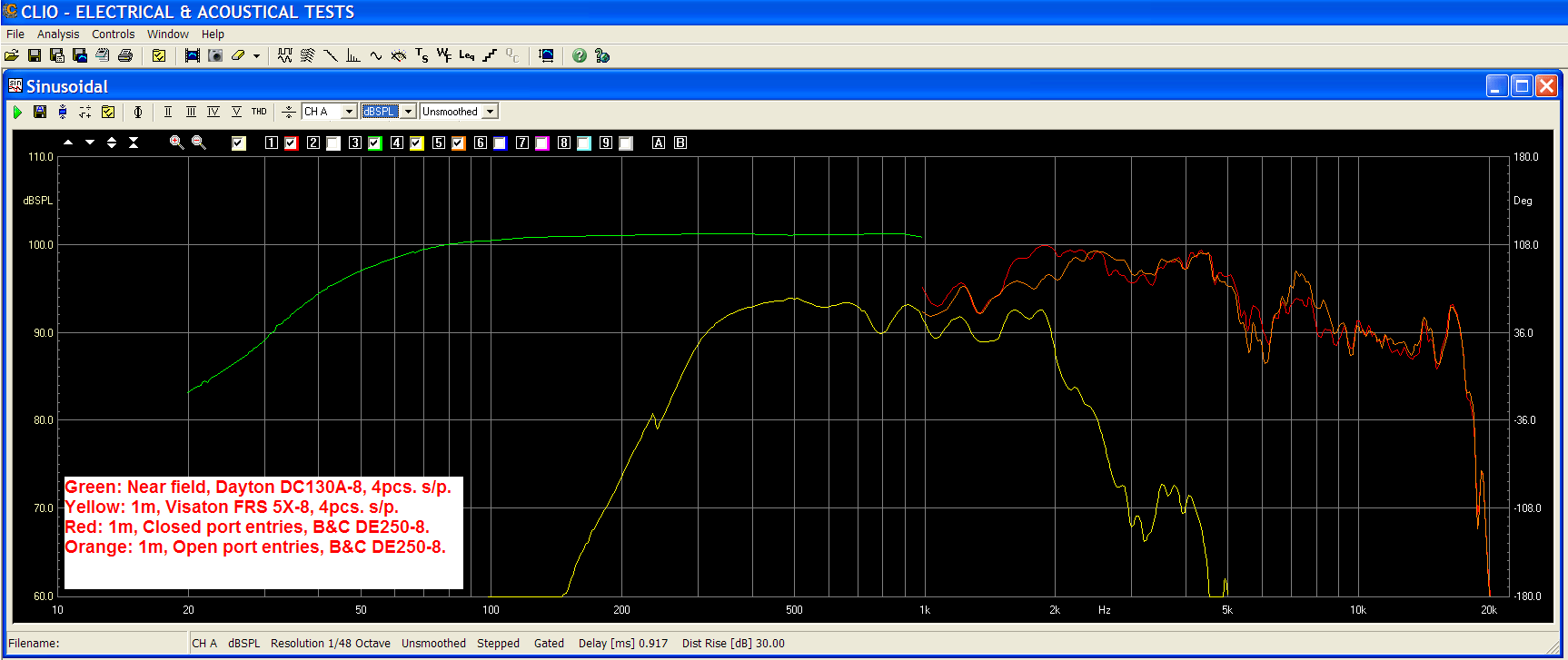

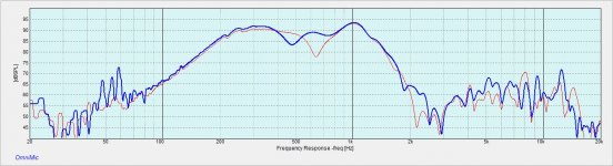

In follow-up to my post 2430 "Ad. Empirically..." :
Gee, I managed to find a measurement from long ago of the raw responses.
The red and orange curves show the HF response with masked and open ports, drivers fitted.
It must have been ALL ports I did, but I made no note of just that.
As one can see, there IS a difference, but not much.
Could be interesting to do it again to see if the MF or the LF ports dominates.
(the "notch" at 6KHz is driver-related, perhaps a defect, but it is there on other measurements I did.)
The yellow curve seems to indicate "there could have been more" and I torture myself by thinking that concentric ports could have brought a little bit ekstra output between 2 and 3 KHz. But then again, even with just 2" drivers it IS hard to make room close to S1. (1,5" drivers maybee...).
The green nearfield curve shows just a closed-box response (this meas. is including the rear cabinet). So the horn does'nt do much, only making drivers concentric. In my next horn, if ever, I would put S3 outside the main horn, perhaps as slots in the final flares.

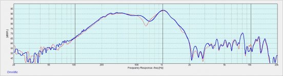

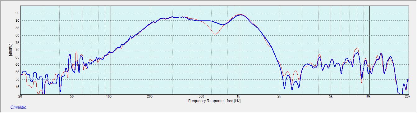

I don't think the tap hole frequency dips matter much as the driver responses fill in the holes. Attached is the tweeter response with the mid hole covered and the tweeter response with the woofer holes covered

So, there is quite a tweeter-dip from the S3 taps at ~650 Hz and a smaller from the S2 tap (you have only one ?) at ~1100 Hz.
Thats very interesting. Maybe I should do my measurements again, and give it more attention.
Surprising to see such S3-dip when these taps are quite far from the S1 tweeter.
This strengthens my belief, that my next MEH, if ever, should have S3 out of the main horn (but stil concentric).

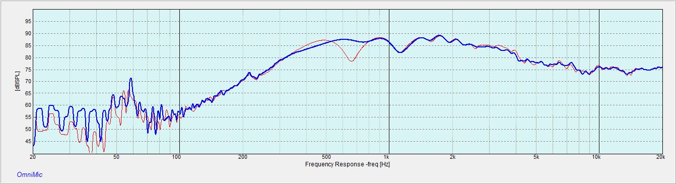

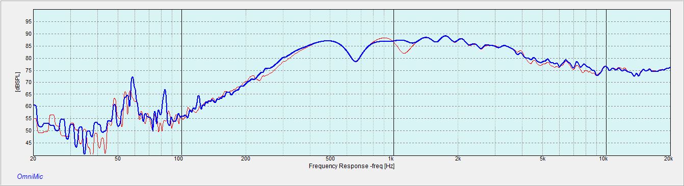

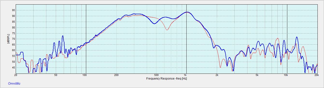

The measurements are at the horn mouth (nearfield) except for the last picture (this is the final horn) which is at 1 meter. There is a dip in the mid response. I also found I could change the dip by moving the S3 taps. The dips are a function of the chamber volume, location and maybe tuning (not tested) by reducing the volume between the driver and the tap I could reduce the magnitude, last picture.
