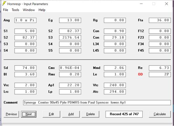

For the record, here are the Pyle params that I snooped from Paul's blog. There is more and good history on the 4" Celestion sealed back mids, if you can find them albeit higher cost. their TSP's from BWaslo attached. the sim vs measured picture I also poached from the Internet on the pyles (middle attachment) looks pretty good. 5" vs 4" might make a difference
Interesting! Here's the Pyle's specs from fluid's link: Red Spade Audio: Point source horn driver selection

The response shape is largely determined by the bandpass chamber and port. What matters is smoothness and headroom within that shape

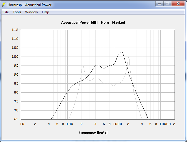

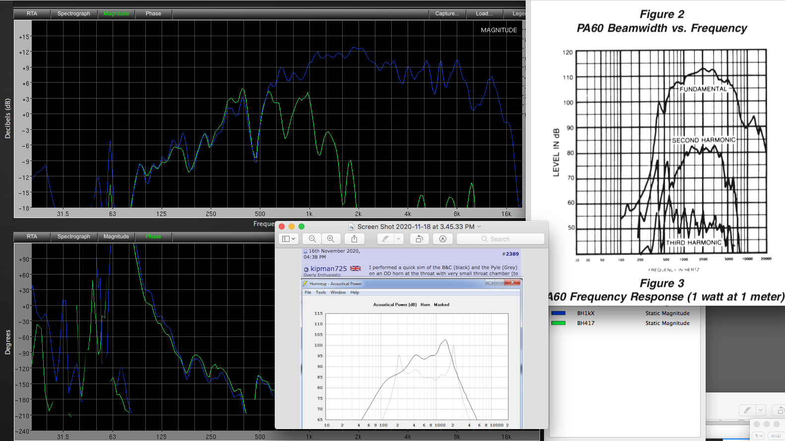

I performed a quick sim of the B&C (black) and the Pyle (Grey) on an OD horn at the throat with very small throat chamber (to try and maximize bandwidth). This kind of exaggerated the trends that I saw with actually realizable designs where the B&C had more high frequency sensitivity (upto 4 dB) and a smoother response. As the rear chamber can be larger on the B&C it also looks possible to go lower.

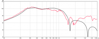

Here's a sim I made, of the B52 waveguide with four of the Fountek FE85. The Fountek's parameters are just about perfect for a Unity horn.
There are a bunch of 3" drivers out there, but most of them don't have a lot of motor strength, and so they wind up having an FS that's too low and a QES that's too high.
The Fountek is basically ALL MOTOR. The diaphragm is about the thinnest aluminum I've seen on a loudspeaker. So these leads to a unusually high FS and low QES for a woofer of this size. SB Audience sells some drivers that are even better, but they's 15X as expensive.
The graph that I've posted shows two traces. The black trace is unfiltered. In this configuration, you would need to keep the power very low, because the midranges will exceed xmax with more than about 10 watts. But you could probably squeeze about 200Hz to 20khz out of this setup.
The red trace is with a simple second order high pass. In this configuration, you could easily hit 115dB as long as the voice coils don't go up in smoke. The posted graph is with 100 watts, but once you add a filter you can pour even more power than that. (This is because the 'knee' of the filter is quite high, because the low frequency response is rising.)
Either one is viable, just depends on if you want a REALLY loud speaker with a complex crossover, or a low power speaker that won't be as bulletproof, due to the higher excursion.

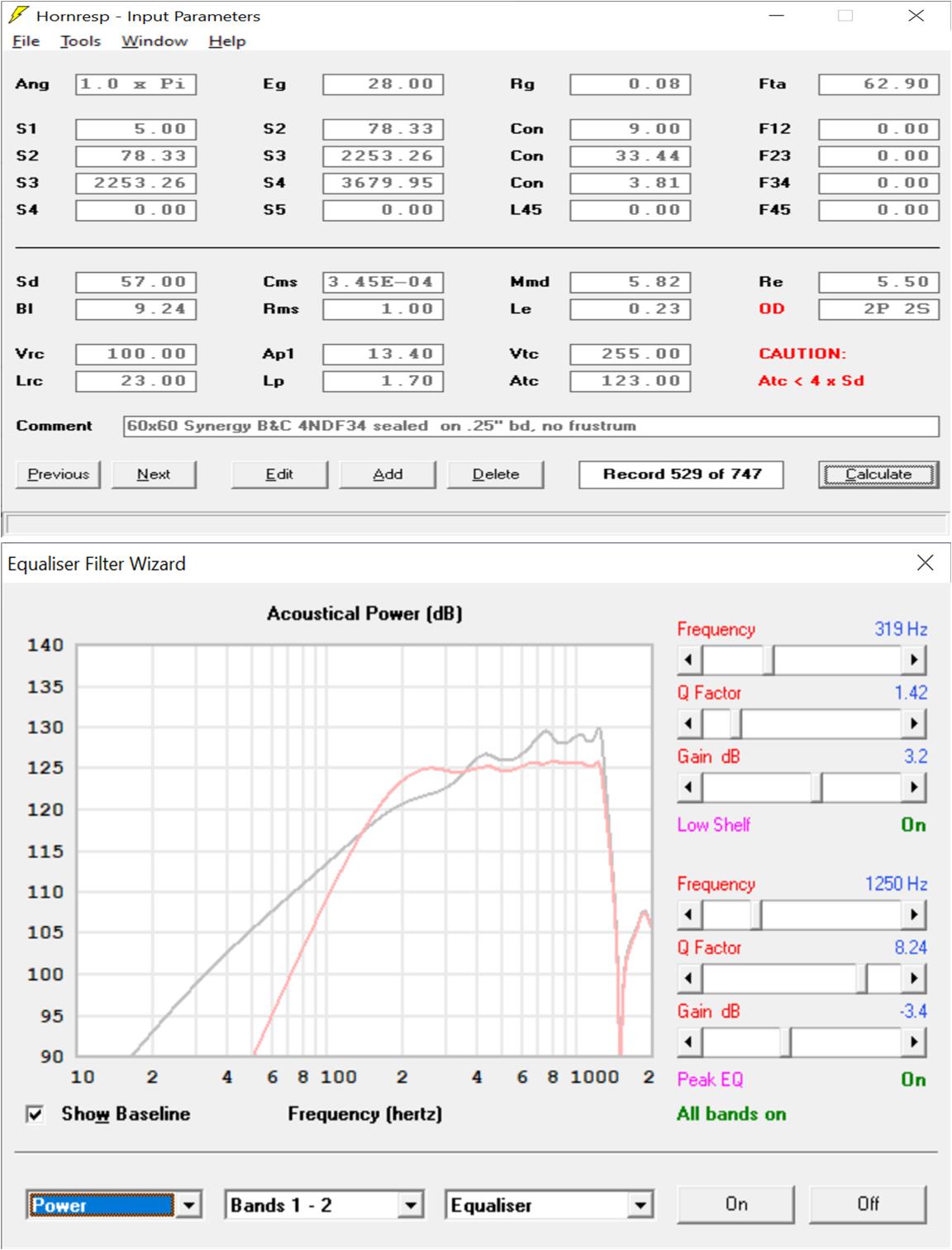

The specs on this driver are so far out, it almost seems too good to be true. I've seen lots of 8" and 12" drivers with this kind of motor strength, but nothing like this in a driver this size.
2 * FS / QES is the magic number, and for the 4NDF34 that's 786Hz. Just unbelievably high.
I took four of these and I simulated it on that B52 waveguide. But I added two inches to the depth. So instead of being 5.5" deep, the waveguide is 7.5" deep. Which is still very VERY compact. The mouth measured 18" x 13". We're talking about a footprint that's about as large as a JBL M2.
When I did that, the efficiency was a hundred and five dB!!! To put that in perspective, the JBL M2 has an efficiency of 92dB and the Danley SH-50 has an efficiency of 100dB. Of course, I'm not sure where you'll find a tweeter that could keep up with that. My Eminence N151Ms are the loudest tweeters I own, and they can produce 127dB at 5khz.
In a nutshell, the 4NDF34 is a beast, but I'm not 100% convinced that it's specs are even possible! If one built a Unity horn with that midrange, the tweeter would become the weak link in a hurry.

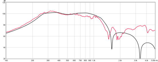

Using four of them driving a dual EV PA60 horn, with a LeSon piezo tweeter to sizzle above 6kHz, the exterior box size is a cube a fraction over one foot about 28 liters. The measurement below shows the response with a passive crossover in blue, the 4NDF34 only in green. I'd estimate the "0" line to be around 100 dB one watt one meter, not too different from your sim.
I had planned to cross over in the 450-500 Hz range, but ended up moving the crossover to just under 1kHz, as even when driven hard in the 100 Hz range, the 4NDF34 sounded much cleaner in the 500 Hz to 1kHz octave than the PA60.
Still have yet to crank the cabinet up outside, but I'd expect it to be able to swing an easy 130dB in the speech range.
Art
Art put me on to the 4nDF34 a while ago with a post about it. I simmed it on the Synergy I had already built and it made me regret having chosen 4FE35s instead. These are clearly more robust but 4 of either of them were way overkill for home use so the choice really didn't matter.
The sim below has a 150 Hz highpass for XO to a woofer and hits the SPL at 2.2 mm excursion. At more reasonable output level it could go a bit lower.

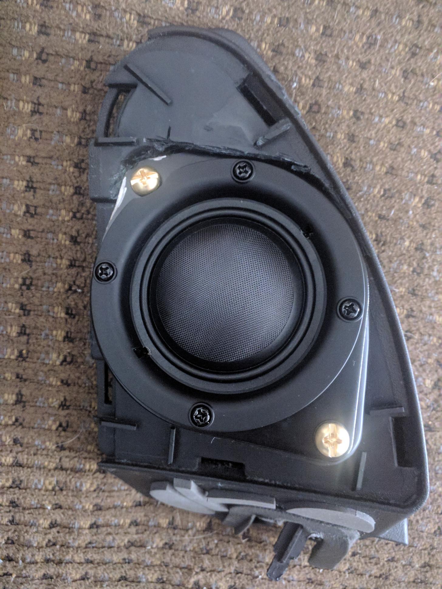

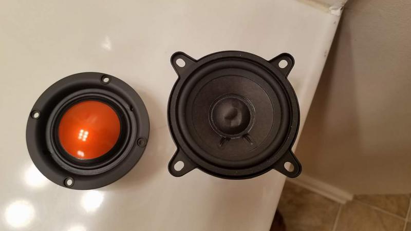

For years, Parts Express has sold a dome midrange that's a nice match for a Unity horn.
Unfortunately, the PE midrange really needs some mods to make it work. In particular, the back chamber is too big, and this limits your output on a Unity horn.
Basically, if you're willing to cut the driver in half with a hacksaw, you can raise your efficiency (and output) a few dB.
Which is all well and good, but most people don't want to do this:

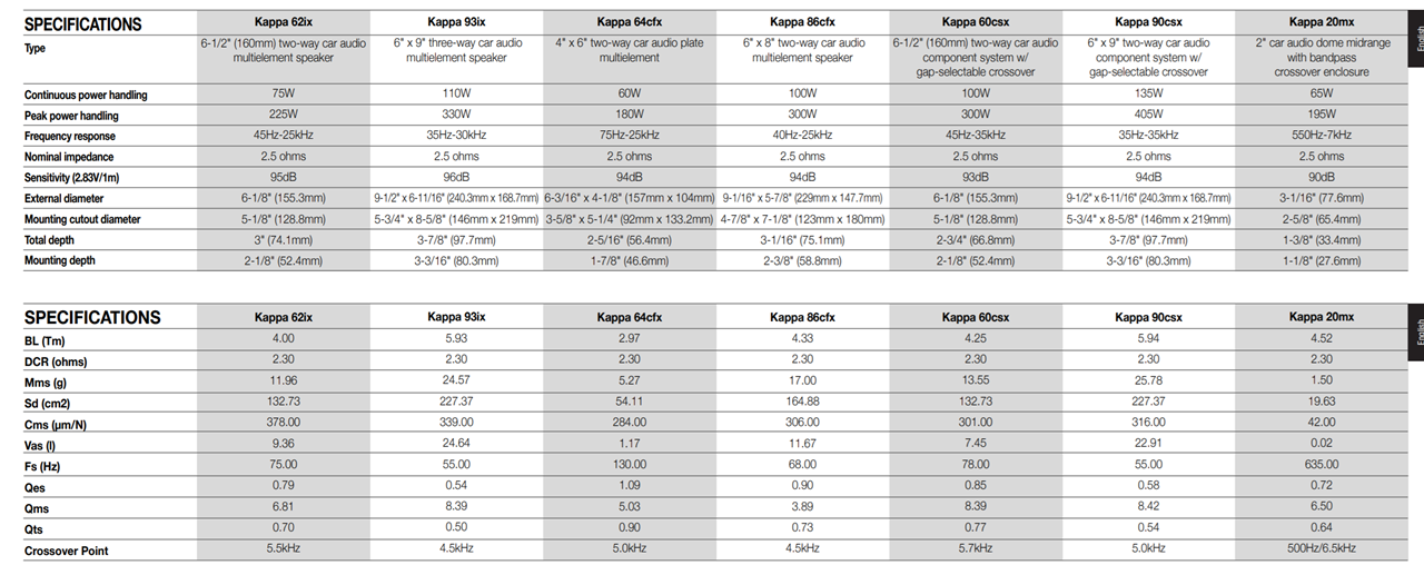

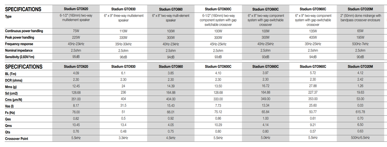

So it came as a pleasant surprise when I stumbled across a dome midrange from Samsung that JBL and Infinity are selling for car audio.
I've attached some pics. I hate to be hyperbolic, but this thing is REALLY hard to beat:
1) It is much more readily available than the Celestion or Misco midranges. Misco doesn't even list the JC5RTF-B on their website any longer. You can get the JBL and the Infinity from Amazon or eBay.
2) A Unity horn typically "wants" a midrange with an Fb of about 500Hz or a little higher. The JBL and Infinity mids fit the bill.
3) The JBL and Infinity mids may have higher output, because their power handling is higher, due to a larger voice coil. The Celestion TF0410MR has 30 watts of power handling, the Infinity has 65W.
4) For a Unity horn, you really want a rigid cone. The high compression of horn loading can destroy a soft dome midrange or tweeter.
5) One issue with a lot of small midranges is that the surround can get trashed from horn loading. Basically if you don't leave enough space, the surround will crack. (Ask me how I know...) But the JBL and Infinity have a fairly modest surround, which is GOOD for this application.
Anyways, have fun with this. You can find them on eBay as the JBL Stadium GTO 20M ($160) and on Amazon as the Infinity Kappa-20MX ($120.)
2021-02-03 01_21_19-jbl-stadium-gto-20m _ Студия а
2021-02-03 01_43_31-TR04192_JBL Stadium Speaker_OM_Global_B_V13_LD.pdf.png215.2 KB · Views: 248
2021-02-03 01_43_09-TR04087_Infinity_Kappa_Speaker_OM_F_V8_BW_LD.pdf.png256.2 KB · Views: 207
