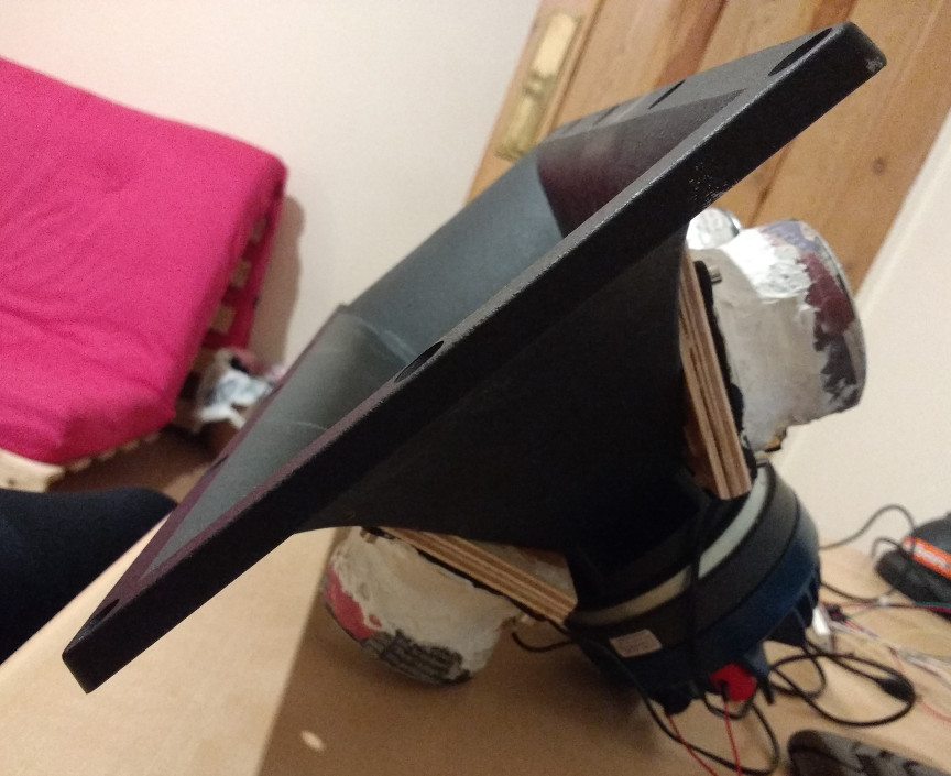

my solution to sealing the back of my mids was paper mache which I then coated with a layer of 'liquid nails'. It was very easy to see if the mids where properly sealed from the impedance plot of each driver. However this took a long time due to needing to layer the paper and is messy.

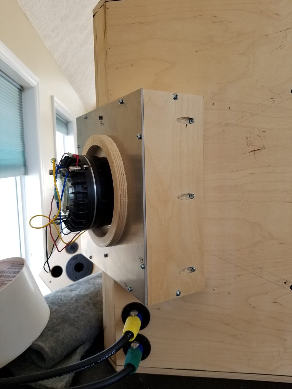

Here's another vote for the 4NDF34,
and what i came up with to enclose them.
Not exactly a 'sealed-back' solution, but the enclosure volume is right at 1L per driver. (Two drivers per each side enclosure.)
Using four of them with port centers 3.5" from throat, I get the raw response below.
The other 4" i played with was the 4FE35. Very nice too, a bit better low end response....just a lot less efficiency.

Mark, this is a very neat solution. I am better at 3D printing than wood working, so I will just print some back covers, the 3FE22s need slightly larger volume than fully closed basket for optimal response. The 4NDF34s are on my wish list, which may turn into shopping list one day🙂

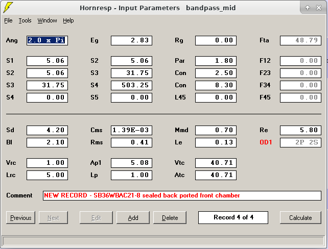

I'm looking to go higher than the usual ~1kHz, thoughts on SB36WBAC21-8. I would use 4 for a low SPL bookshelf style speaker in 3 way. It would cover (Idealy) 400 - 2000 Hz.

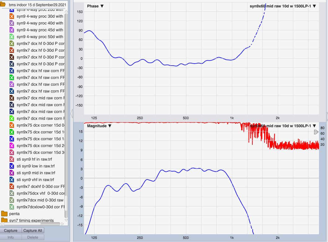

based on the math from page one in this thread, getting that driver to do 1khz will be difficultI'm looking to go higher than the usual ~1kHz, thoughts on SB36WBAC21-8. I would use 4 for a low SPL bookshelf style speaker in 3 way. It would cover (Idealy) 400 - 2000 Hz.
I've been able to get drivers to play higher than you would expect, but the key seems to be to use a driver where you can leverage the high frequency resonance, particularly from the dust cap
This requires trial and error unfortunately, there's no easy way to predict if some drivers will "ring" to play higher
I like the Dayton ND64-16 because it was explicitly designed to ring (Keele says so, he designed it)
It was used in his CBT, and he had some mods done so that it would decouple at high frequency, to exaggerate the output above 1khz

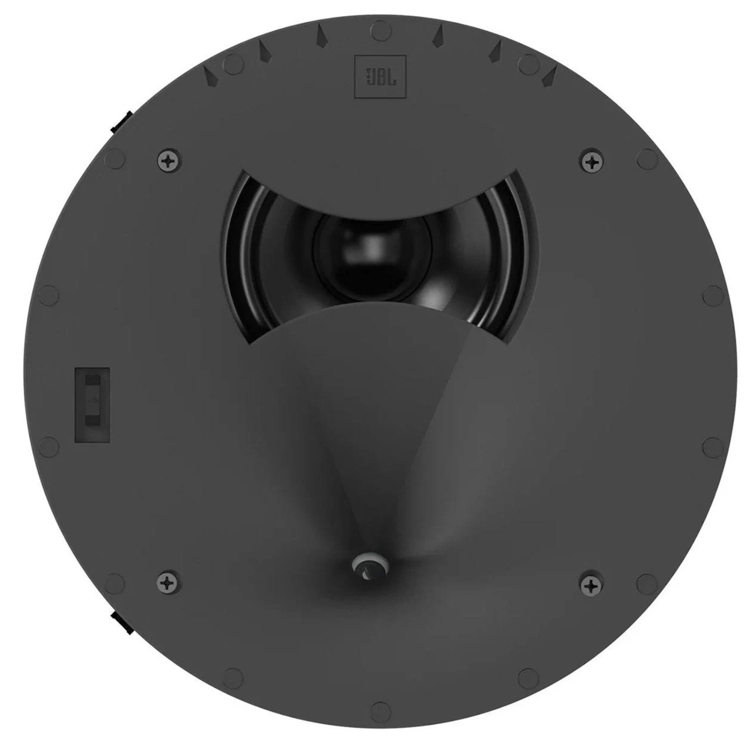

Here's an example of JBL using a fairly simple phase plug design on the midbass, so that output from the dust cap can extend the high frequencies beyond what would be possible if the majority of the cone was masked off.
So by positioning my mid driver dust cap over the tap I might be able to extend the mid high frequency response?

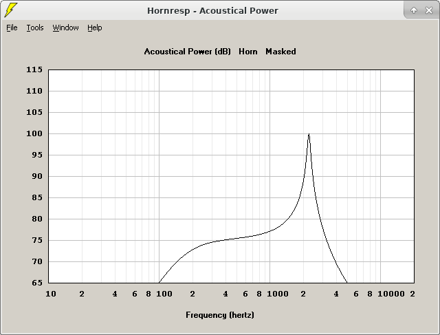

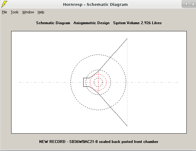

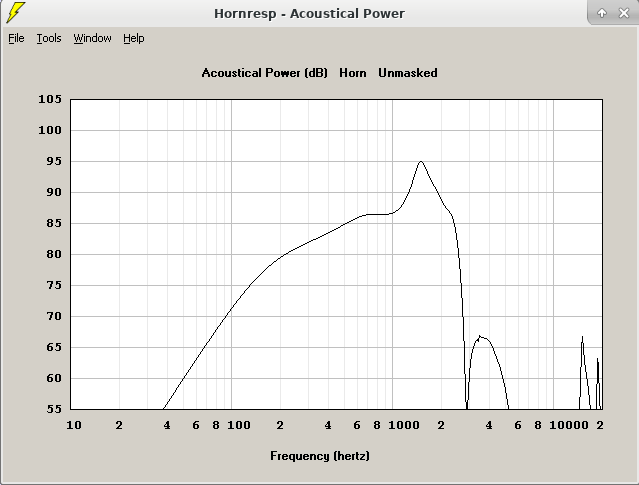

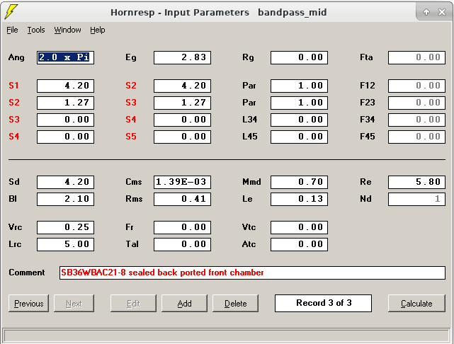

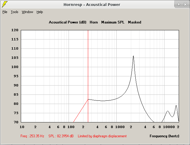

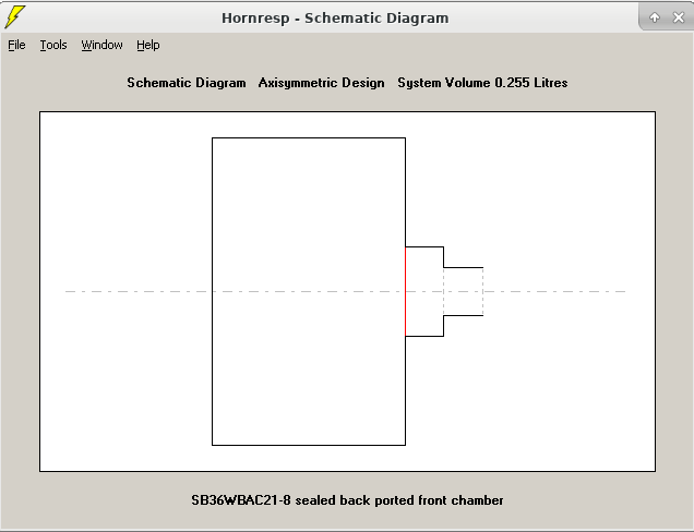

Ok but if I model the SB36WBAC21-8 in a tiny bandpasss chamber I easily get over 2 kHz, maximum SPL graph indicates perhaps a crossover as low as 300 Hz would be possible also. For a 2kHz notch caused by the throat reflection the injection port would be 4.3cm from the compresion driver diaphragm (I don't have the parts on hand but I think this might be possible).
the negatives are 75 db sensitivity and only 5W power handling but other than that looks good
I modeled 4 of them on an approximation to the Dayton Audio H6512 6-1/2" x 12" Waveguide 1-3/8"- 18 TPI distance from the throat is a bit of a guess. If I increase the front chamber volume significantly or increase the tap to throat distance (2.5cm from end of compresion driver thread) I won't hit a 2kHz crossover so I think for this application I will have to use the 1" drivers. Without directivity effects of the horn max SPL is 95dB using 4 drivers which should be fine for desktop application. As an indication speakers like the Kali Audio IN-8V2 have limiters engaging around this level.
