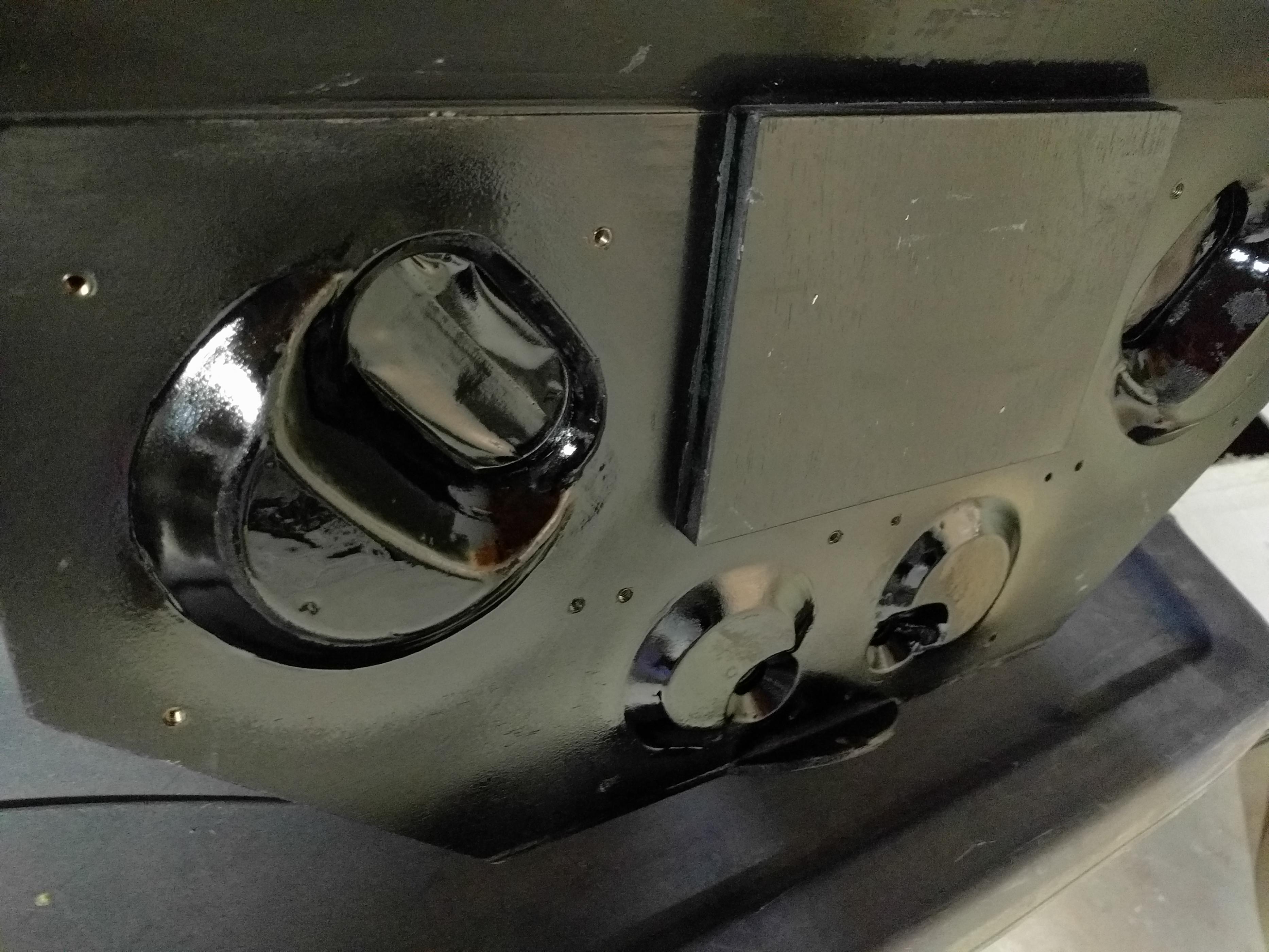

Modified ports with volume reducers
I'm stuck with the port locations at this point due to physical mounting limitations. I got them as close in as possible while still allowing a gap between the frustrum port near the edge of the mid cone/surround. I ended up settling with 5/8" ports, as I have tried 3/4" as well as 1/2" and this seems to be a happy medium.
For the woofer ports I chose 1-1/2" slot port, 2-5/8" length (with a frustrum, so actual port depth is 1/4") This size ends up being 20% of the cone area so a 5:1 compression ratio. The 3/4"x4" slot ports worked ok but the frequency response was peaky so hoping this works better.
I'll post a pic later showing the port modification and filler "phase plugs".
Sprayed the back side to protect from wet sanding. It was quite a bit of work to add the filler circles but hopefully results in smoother response with more extension.

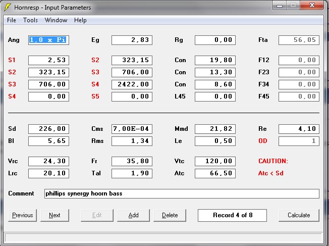

I think I did post earlier but have a question, because I want to use the synergy in a home size matters, I have sim with just one bass speaker and one mid, is this possible and where I have to place the port then? bassrereflex pipe can replace the other speaker?, normally there are two speakers and 4 mids, but maybe one bass and two mid is a better option for me.
I have seen unity's who has a wideband speaker of 3 inch in stead of the compression driver with only a bass, the wideband does all from 400 a 600 hz or so and higher, but I think it will fall off 6 dB octave I can correct that but loose a lot of efficienty.
The old phillips woofer of 42 years old do quite well here.

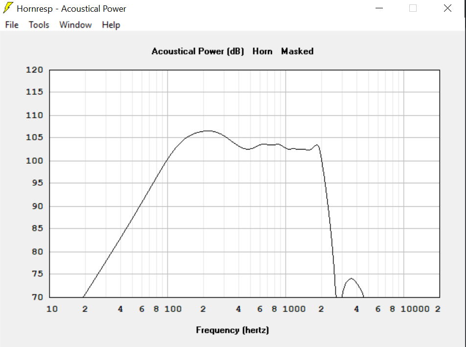

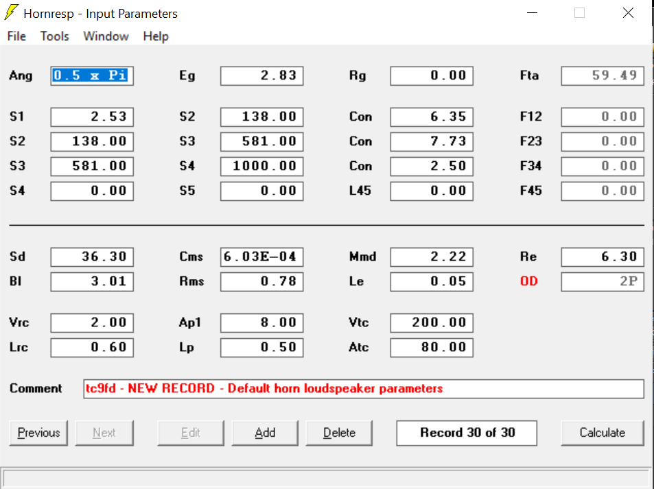

I just did a quick sim in HR. I copied the horn dimensions of Bwalso in post #2195 for the sim he did for a tekton driver. I get nearly the exact same result but with about 8 dB more output. Looks like a crossover @1500Hz is possible? That would pair nicely with the XT25 tweeter....but maybe 4 mids is too sensitive for the XT25BG60-04 tweeter. Should I use only two mids in series?

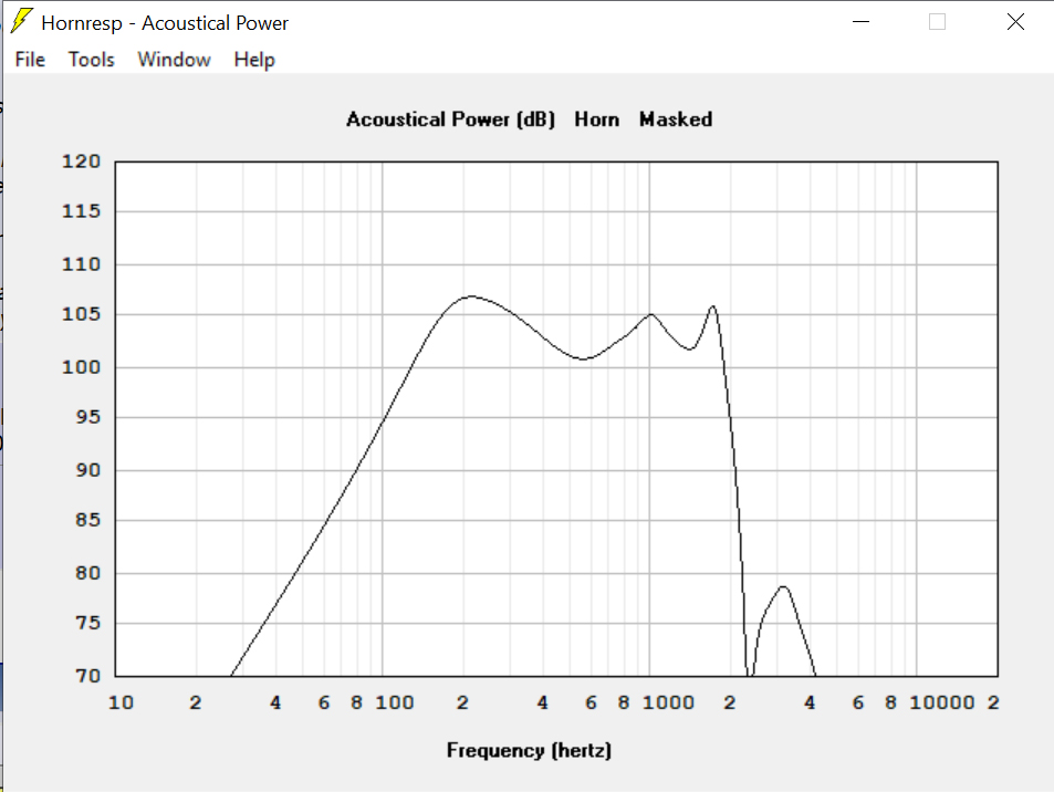

After simming the TC7FD I thought I try the TC9FD. I had actually already written these off since the FS is way too low @125Hz if you subscribe to the 2xFs/Qes formula. But to my surprise it looked very good in my non expert eyes. On paper the TC7FD should be way better but in my sims the TC9FD looks better.
What do you guys think about this sim? There are still 5dB wiggles in the response. Is there a way to smooth this further or will these variations in SPL be less pronounced in reality?

I've found that the 2xFs/Qes rule can be disregarded. It will never point to an unsuitable driver but it will cause you to disregard many that will work. OTOH, you can believe HornResp.
Those wiggles in the response are typical of horn mouth reflections. Different horn mouth terminations will give you different shape ripples. Look at the acoustic impedance graphs and see if you see are resemblance. With DSP, these can be equalized away.
The other thing that affects the shape of the mid's response, especially its rolloff, are the diamenter, location, and length ratio of the mid ports.
Regarding your earlier question about 2 mids vs 4, believe the HR simulation but know your actual listening level and be cautious about excursion. Those Peerless drivers had limited Xmax and you don't want to be listening near the linear excursion limits. The extra mids can buy you headroom which translates to sound quality but if you are truly listening at 80 or 90 db and not THX reference level, you don't need them
