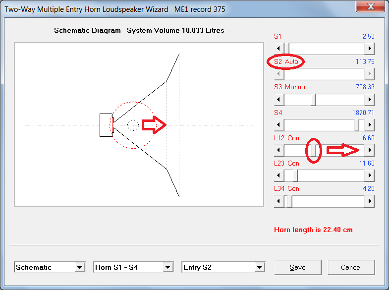

I am waiting for my drivers from Digikey so I can make a test horn and play around with the model and port locations, sizes & shapes.
As far as simulating the system is concerned, to determine the optimum axial distance from the compression driver diaphragm to the mid-range port opening, set S2 to Auto by double-clicking on the 'S2 Manual' label above the S2 slider, and then adjust the L12 slider to obtain the best overall response. Because S2 has been set to Auto, the flare rate and overall horn length will not change as L12 is adjusted.

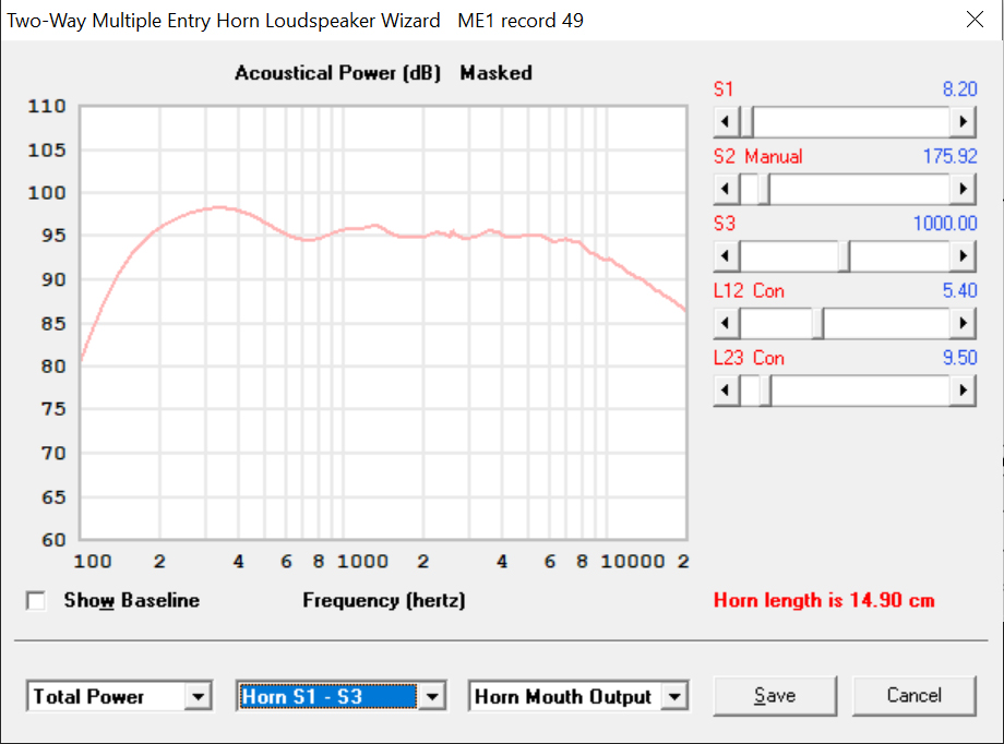

Here is the best I got so far for the XT25BG60 and 4xTC9FD. This sim includes a 2nd order 1200Hz lowpass on the mids and a 3rd order highpass on the tweeter.
I am quite a noob so I would appreciate some feedback on this sim.
One thing of concern is that according to the theory the mids should enter the horn where the circumference is one wavelength of the crossover frequency. I cross over @1200Hz so it should enter where the horn is 50cm2 but the sim works best entering where the horn cross section is 175cm2.
Should I not worry too much about the theory and go with my sim?
Mr. Danley and many seasoned DIY builders use a horn with 2nd flare to improve dispersion and lower diffraction. Whenever I try to model a changing flare I get substantial ripples over the entire frequency range. When I play around with the length and cross section sizes to get rid of the ripples I always end up with a horn with straight walls from apex to mouth. As soon as the wall are straight I get a razor flat frequency response....
Why is this so?
