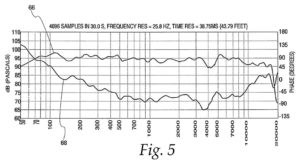

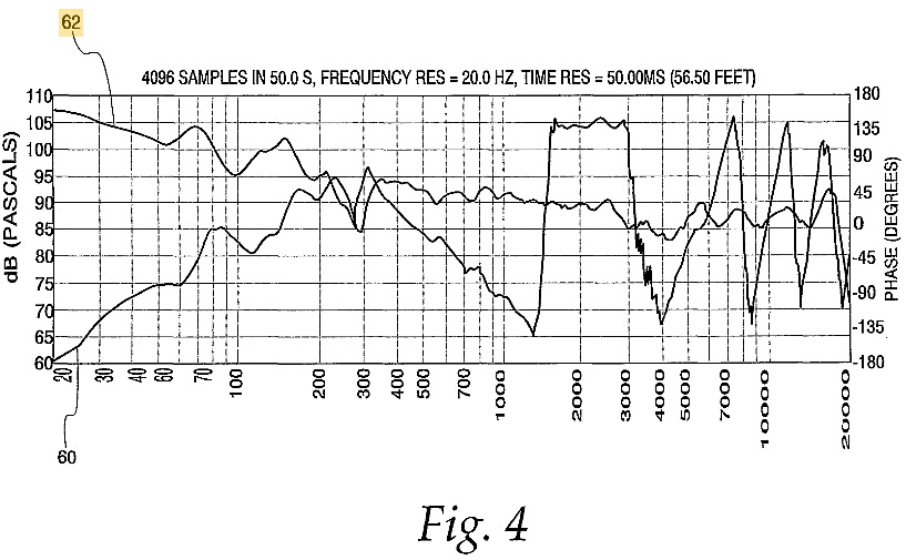

Here is an excerpt from the DSL patent (US8284976B2) that illustrates what the difference is:
For comparison purposes, and to illustrate advantages attainable with the present invention, a prior art horn/driver sound reproduction system was modified according to aspects of the present invention. A three-way sound reproduction system, Model Number td-1, commercially available from Sound Physics Labs, Inc. of Glenview Ill., was tested for both frequency and phase response characteristics. The system employs a straight conical horn having a pyramidal shape. Referring now to FIG. 4, the frequency response curve 60 and phase response curve 62 are shown for the unmodified system. The system was then modified to relocate the drivers with respect to the horn and to replace the crossover with new electronics, in accordance with principles of the present invention and was tested under circumstances similar to the test shown in FIG. 4, with the result illustrated in FIG. 5. The frequency response curve 66 and the phase response curve 68 of FIG. 5 shows substantial improvement over the performance of the unmodified system indicated in FIG. 4.
attachment.php
758935d1558814233-suitable-midrange-cone-bandpass-mid-unity-horn-screenshot_2019-05-25-us8284976b2-figure-5-jpg
With the sound reproduction system according to principles of the present invention the phase shift indicated by curve 66 is much closer to 0 degrees. Also, in addition to the reduction in phase shift throughout the pass band, the amplitude curve 66 is smoother than the corresponding amplitude curve 60 for the unmodified system response indicated in FIG. 4. Thus, the modified according to principles of the present invention has much less group delay than the original, unmodified system, even though the same drivers and the same physical shell were used in both systems.
So if you want to do a Synergy (rather than a Unity), you flatten the overall phase/group delay. How do you do that? The patent doesn't say, but Danley himself does in another forum:

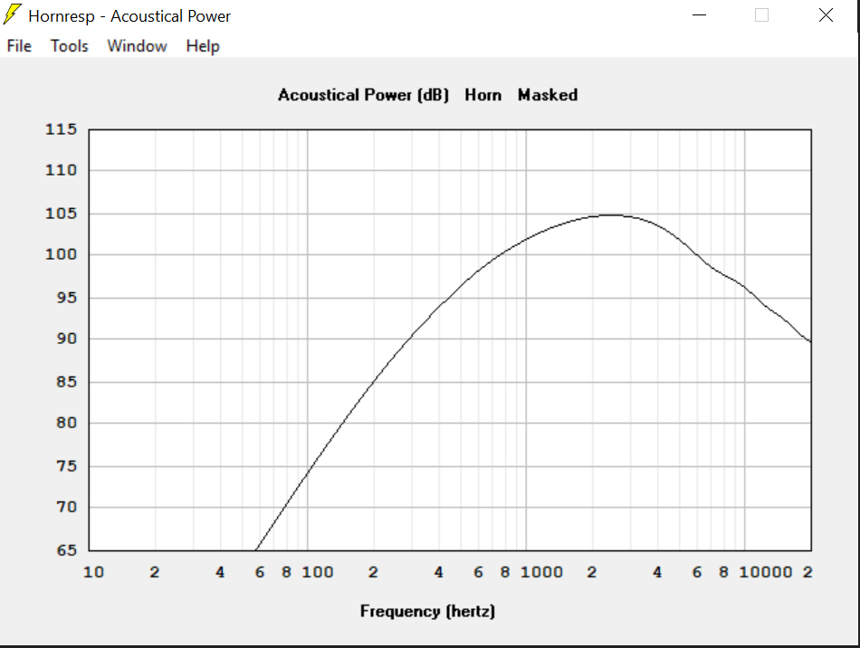

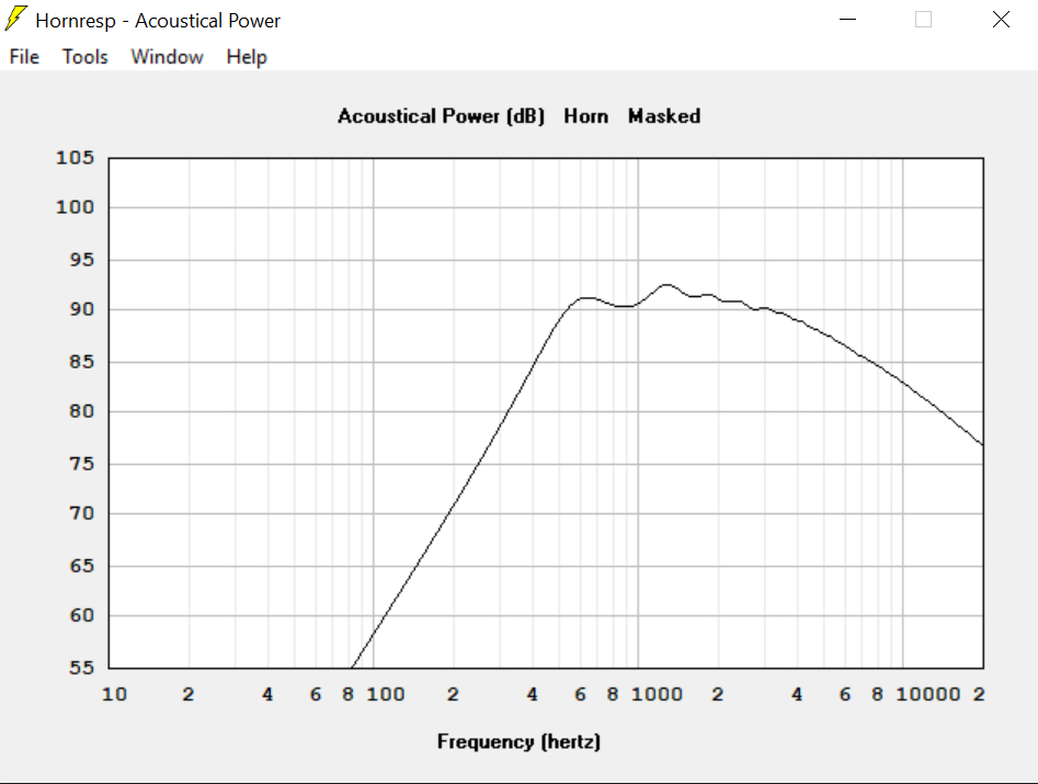

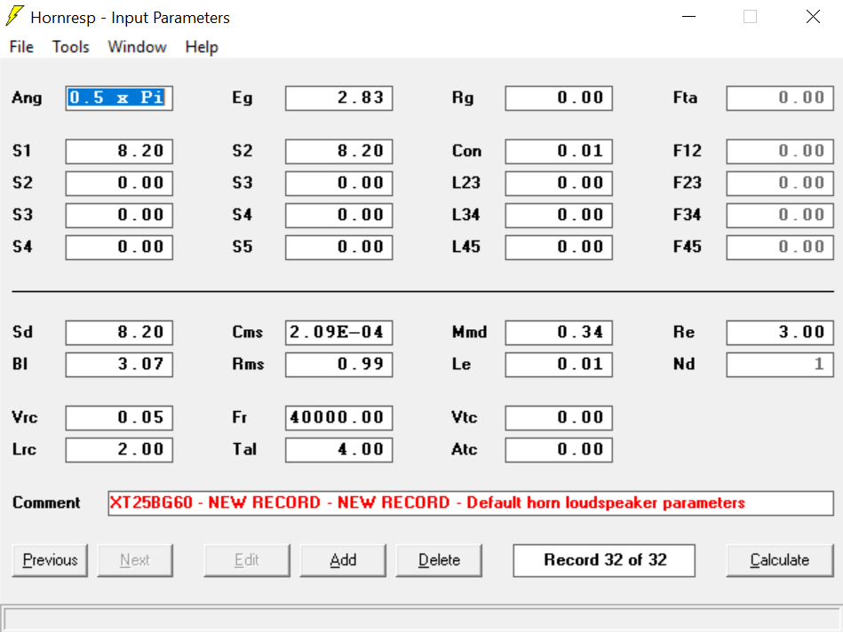

I tried to model a ring radiator tweeter in hornresp and wonder if hornresp is accurate at high frequencies. Whatever horn I sim I get a falling response with almost no high frequency output. Then I tried a 1mm deep horn with area of SD. And I still get no HF output! What is going on?
Is hornresp useless for the higher frequencies?
I believe I correctly entered the parameters for the XT25BG60 and a 1mm deep horn should have a minimal effect.
I didn't know I was talking to the man who created Hornresp. David, thank you sir for making this great tool for us to use. I am sorry to have used the word useless in my previous post. But I was just getting frustrated that the HF was drooping whatever parameters I entered. But it is very likely that I am the useless one here 😀

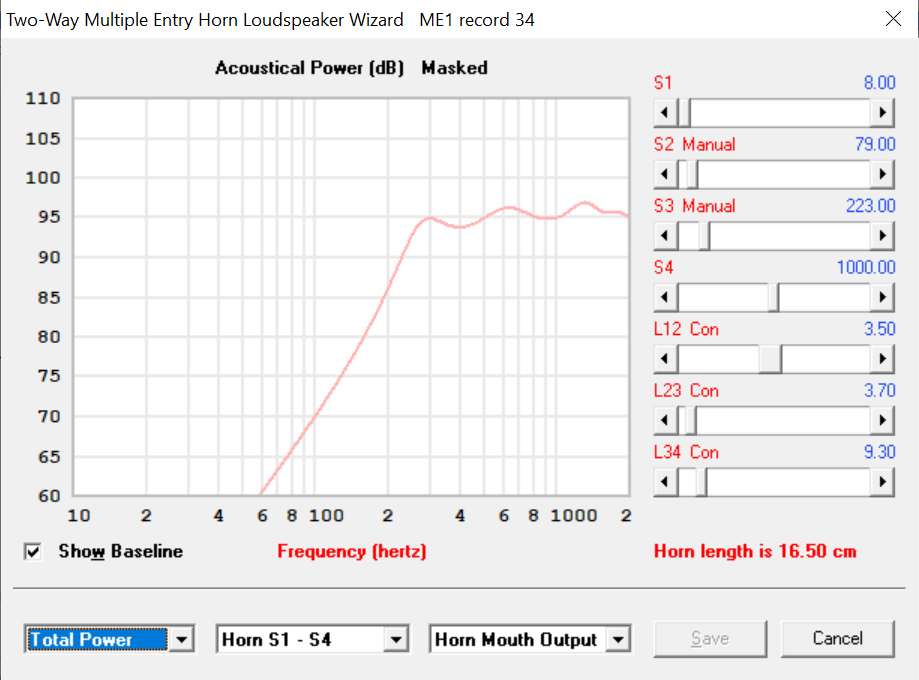

I followed your advice and learned how to model a ME horn. Does this sim look decent for a Synergy with Peerless XT25 and 4x Peerless TC9FD?
So now I have 3 Hornresp questions regarding Synergy sims:
1. Is the drooping HF expected and to be ignored?
2. I simmed with 4 mids series parallel. Does it sim them as one driver? I mean APT1 is one large port for 4 drivers so when building the horn I make 4 ports sized APT1 / 4. In my sim APT1 is 36 cm2 so i make 4x 9cm2 ports?
3. The SPL response I get in the ME wizard is different then when I use the calculate button. The wizard sims the horn is good from 400Hz up, calculated response says 600Hz and up....see attached images. Should I go with 400Hz?

The power response of a speaker is the acoustic power that it radiates. The pressure response is the pressure it produces at some specific point in space, but the pressure response at a different point might be different. If you have a truly omnidirectional speaker, it has the same pressure response everywhere, and the power response and pressure response are the same. If you have a driver with a polar pattern that becomes increasingly narrow as frequency rises like a driver in a horn (very broadly speaking), then if you have flat pressure response on-axis, the power response will fall as frequency rises. Additionally, most drivers have a falling power response as frequency increases. So the on-axis pressure response is then a result of how the acoustic power produced is distributed in space. If you have a horn that distributes sound evenly, even if only across some limited angle, the power response of the system will fall.
So yes, it's normal that you're seeing a falling power response.
Not a problem 🙂.
The HF power response roll-off is to be expected. The pressure response takes directivity effects into account and is likely to hold up better at higher frequencies.
When you click the Calculate button on the Nd record, only the system specified by the Nd record itself is simulated - the ME1 record is not taken into account. If you check the schematic diagram you will notice that the ME1 drivers are not present.

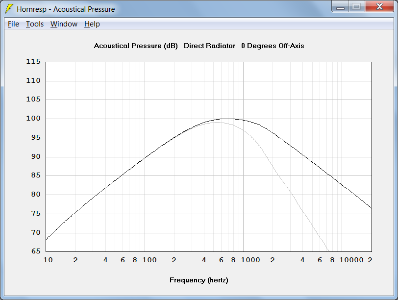

To illustrate, the grey trace in the attached chart shows the acoustical power response of the Hornresp default driver in an infinite baffle. The black trace shows the on-axis pressure response for the same system.
