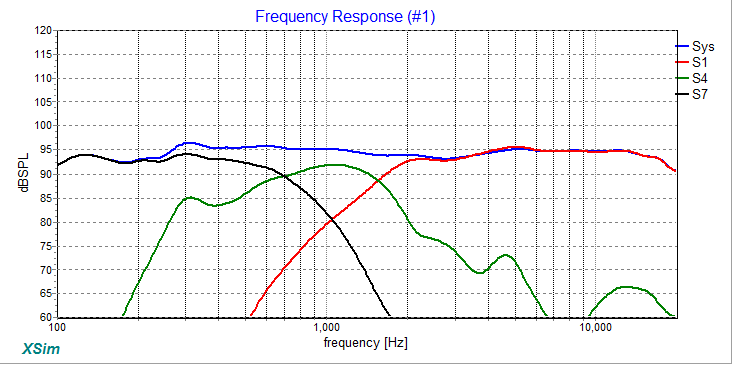

This is from an early version of the crossover, but pretty similar to the final --

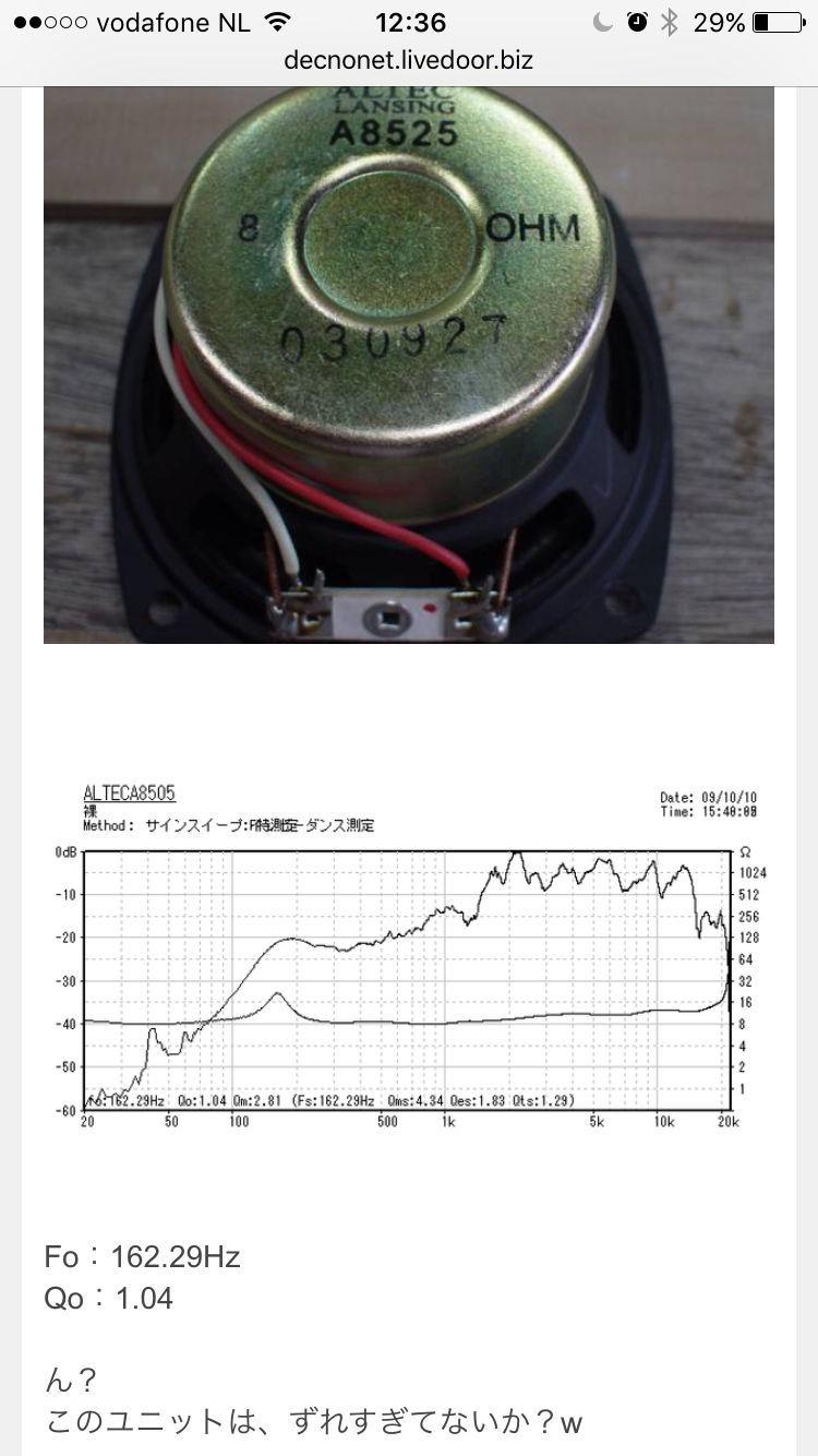

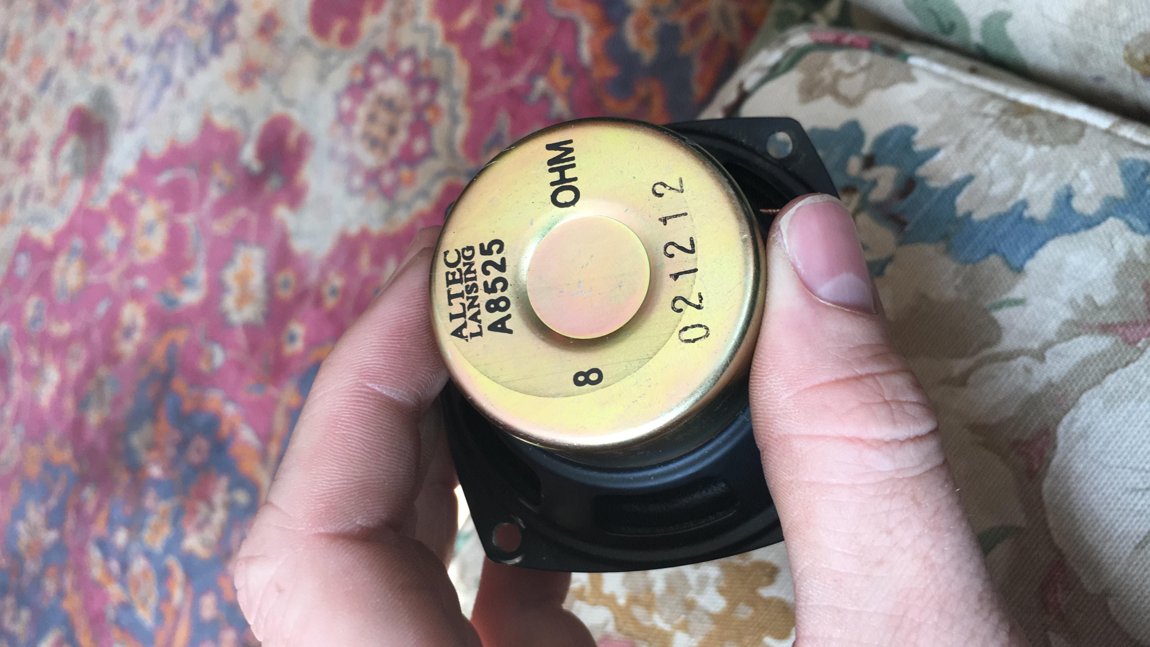

I found some Altec Lansing full range drivers (4 total) that are used in computer speakers. I was always really fond about them and since I got for I will lasercut a adaptor to fit one of my synergy pairs to see how they sound.
I'm hoping they will play way lower than the celestion tf0410mr.
One thing I dislike is the surrounding of the cone which is not paper.
