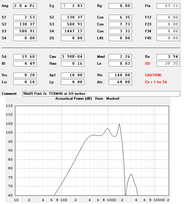

Patrick, I do not understand your pain;
Faital 3FE22 4 ohm version scores 550
and this 3" scores 723
Tectonic Elements TEBM46C20N-4B BMR 3" Full Range Speaker 4 Ohm
I'm morally opposed to the Beyma and Faital drivers because the cost is silly. $32 for a 3" driver? Tymphany sells comparable drivers for less than half the price. Admittedly, the Tymphany drivers are a crapshoot because their QES is too high, and arguably the Beyma and Faital cost a lot because of that.
But that Tectonic Elements! That's a great find, I hadn't noticed that one.
One 'cool' thing about the Tectonic Element drivers is that the cone is basically Nomex. I measured the 2" TE driver on a waveguide and a horn, and it seemed to withstand a fairly high compression ratio.
The compression ratio has been a real challenge with a lot of these small drivers. I've noticed that their distortion levels will sometimes go UP on a horn, and my hunch is that this is due to the compression. Basically those tiny motors and flimsy cones aren't built to withstand a high compression ratio at the throat. They can still be used on horns, but you have to be careful about pushing the compression ratio IMHO

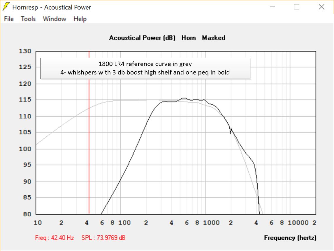

Hi Patrick:
It looks like you found the combination of chamber, port diameter and port length that best hides the reflection null and gives you the shallowest roll off and leads to the highest XO.
The 6 db down point is just about out to 2 khz and so you ought to be able to implement a ~2 Khz LRx crossover with what you have by equalizing to a LRx low pass filter target curve. You could also equalize it flat with a high shelf filter and then implement a textbook LRx LPF.
In fact, I just happened to have a whisper HR simulation hanging around and I tweaked it to do just that. It turned that using 3 db of boost on a high shelf was the quickest way to hit the target. You see a near miss in the simulation but I didn't want to obscure the target (which I generated and captured in another record). Fine tuning the first PEQ and adding another would have gotten me right on. I used an 1800 Hz target curve thinking no reason to go higher.
http://www.diyaudio.com/forums/attachment.php?attachmentid=654648&d=1515091393

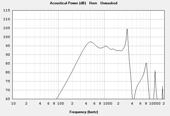

I've been on the search for the midrange that models in HR above 2K to give me more tweeter options.
While it may not be cost effective for some the Dayton DC50FA dome midrange modeled to 3K with a small throat chamber.
