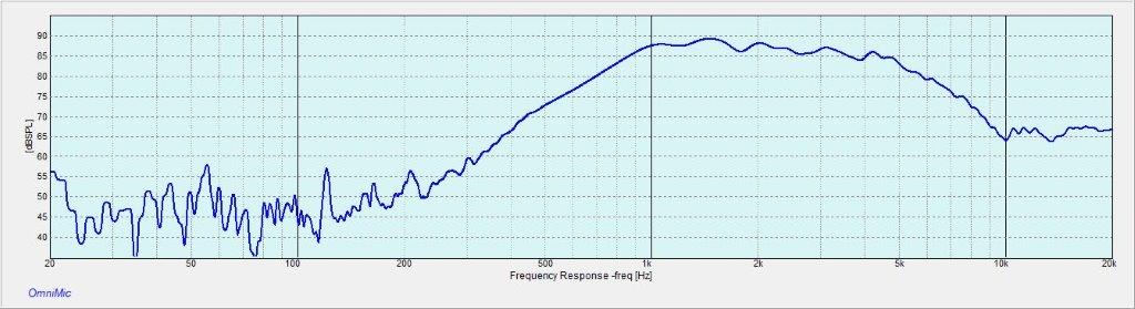

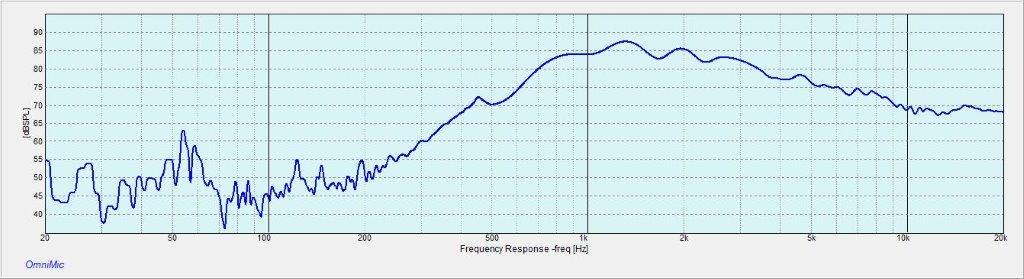

I think the key learning for me was to not force a smooth transition from the tweeter opening to the horn
Have you played around with play-doh/modeling clay to fillet the corners closest to the tweeter? I'm thinking just the first inch or so of the throat. Cannot remember who played around with this and saw some benefits. (Earl Geddes?)
Attached are the FR graphs with fillet corners vs. square opening. The graphs are not SPL matched. This is a 60 x 90 degree horn.
I guess benefit is subjective here. I like the slope and less work.

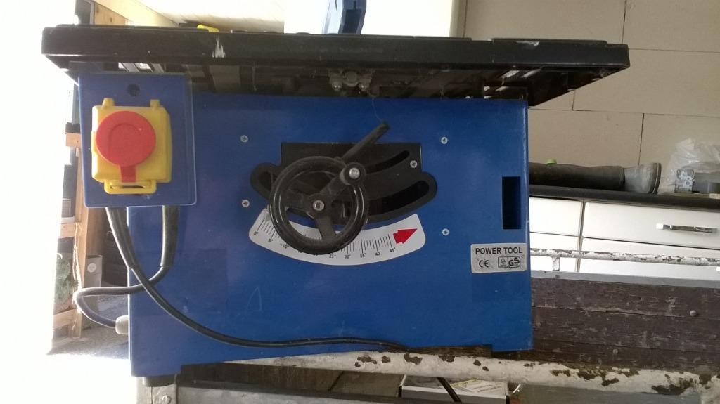

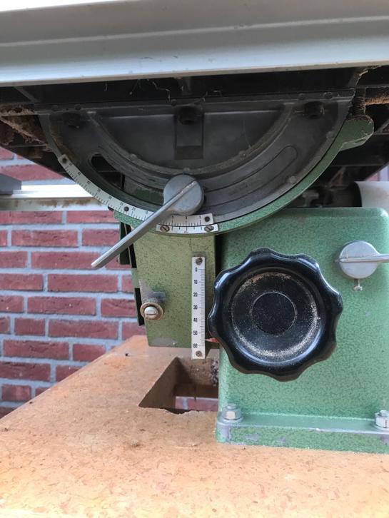

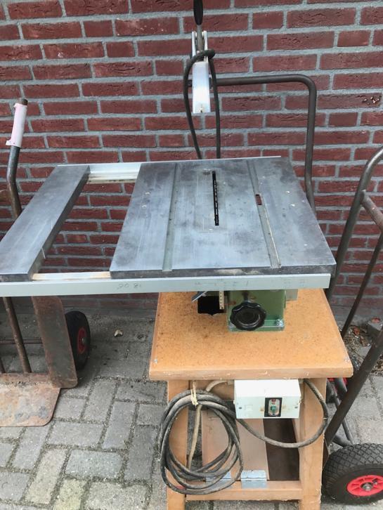

Hi all, it is a little oftopic but need a table saw, I have seen these for 125 euros it is a precision table for cabinet maker who can go - to + 50 degree, only the table do move not the saw itselfs, that is better and more precise.
Can I use such moving table one for synergy, and afcouse more things. It do not eat bread.

I would think twice before getting a moving table kind of table saw. I wasn't able to cut precise angles on my fixed table table saw until I constructed an out feed table for it. The piece being cut gets unstable as it starts to fall off the end of the table. I think its a lot more difficult to rig an outfeed table if the table is moving. The moving table would be fine for pieces smaller than the distance it is able to move; for larger pieces you might find it hard to hold a straight line at the end of the cut.

Check up if the shaft diameter is standard, like Ø30,0 Ø25,4 or Ø20,0 mm. If it is 7/8", it is not easy to find new saw blades, nor inserts between Ø 30,0 => 7/8".
As the table top is so small, I would make a fairly large "sled" of 19 mm plywood or MDF, so it will be easier to cut also "larger pieces". Fit 2 long bars under the sled versus the 2 tracks in the table. Check the width of those tracks as well before bying. Finding a bar width of 3/4" may be troublesome in Europe. With a sled it will be very easy and safe to cut precise 90 or 45 degrees (or whatever you decide if you put an angle jig on top of the sled.)
You say that I have to find a saw who do only saw blade do move for angle? like picture.
thanks for advice.

Hi Kees:
I didn't say you had to but I did give that advice. The reason is that unless you get a very large table saw you have to add support behind the blade to support the cut piece after it passes the blade. Without that support, a long piece will get unstable when its mid point is past the edge of the table. With a tilting table saw, that support would also have to tilt. When the table stays level and just the blade tilts, then your support table can also stay level. What one does if he has the room is build a table level with the top of the saw and then route channels into the extension table behind the saw to extend the grooves that your crosscut or angle jig will slide in. You may also need support on the sides so you can make that extension table "L" or "U" shaped and you may also put the whole assembly up on casters so you can roll it out of the way when not using it.
Jack
Hi Kees:
Jack
Hi Jack
Yes now I got the drift, indeed with long peaces I need to extent it to keep save I understand. the extension needs also to tilt with the table itselfs, also this is true, I do keep that in mind, the saw in first post is a precision one, I can make sleds to get things done, there are sleves for this in the table saw bed aready.
Thanks again, closed.
