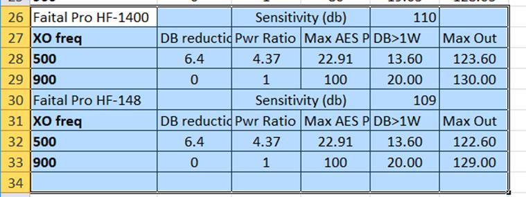

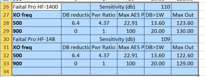

to complete the comparison:
The bottom line of the table is from the data sheet. The DB reduction is from the roll off of the 12 db/octave high pass for which a 900 Hz XO is specified. At that reduction, the power applied to the CD with a 500 Hz XO is <= to that with a 900 Hz XO.
Faital Pro HF-148 Sensitivity (db) 109
XO freq DB reduction Pwr Ratio Max AES Pwr DB>1W Max Out
500 6.4 4.37 22.91 13.60 122.60
900 0 1 100 20.00 129.00
Chances are in home , even in a home theater, you will operate at least 12 db below the 122.6 db maximum and at that level you will have acceptably low distortion and have > 10 db advantage over the SB65. I think I would want the HF-148 or similar in my HT but the the SB65 would do well in a system for my home office.
Sorry the table formatting gets lost in posting/transtaltion

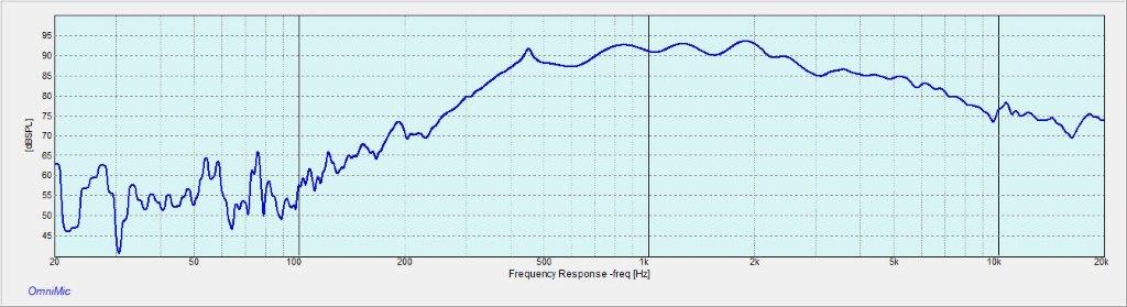

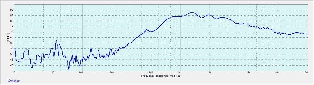

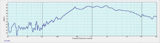

Tweeter measurements
Here are a few tweeter measurements in a synergy horn foam core model. My plan was to use the RS28A until it went NLA. I'm currently using the XT25TG30.
