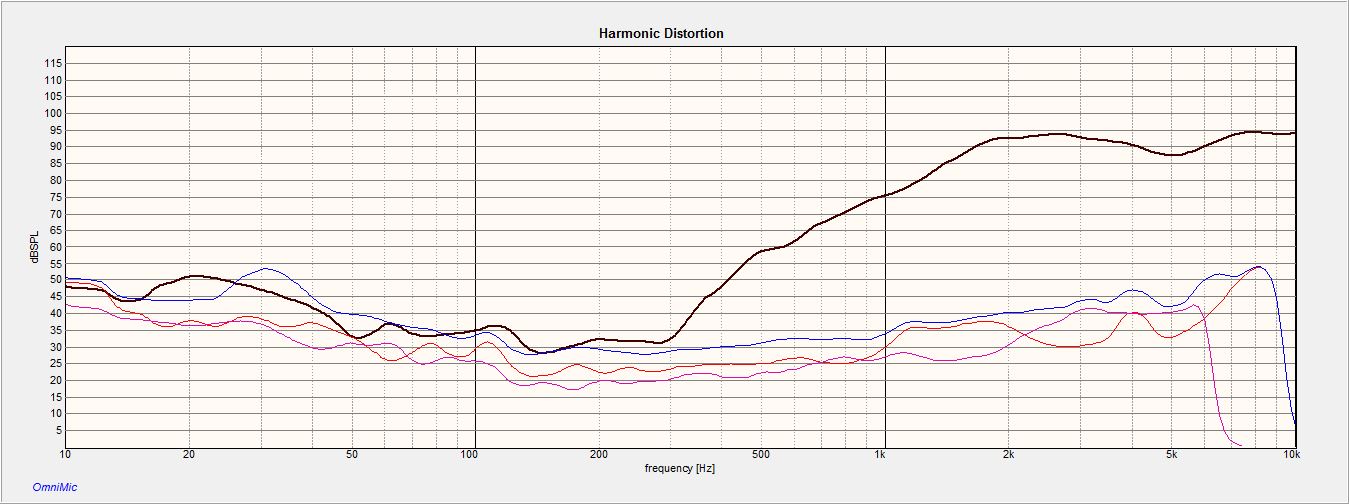

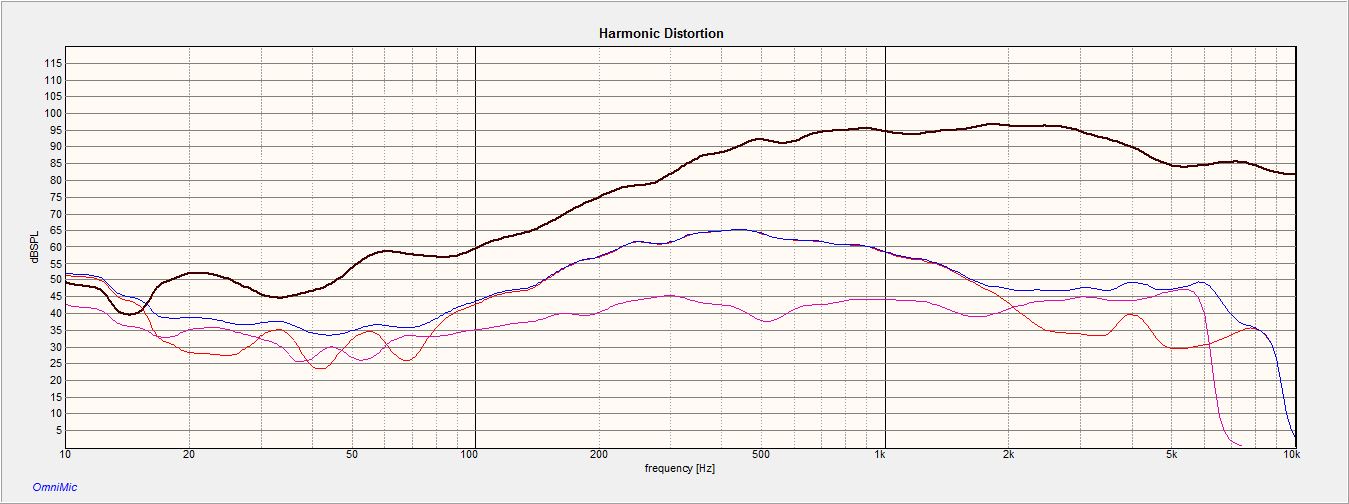

The THD graphs from BMS are quite hard to read in that they do not have a vertical scale listed so you have to guess. The level has also been raised by 10 or 20dB as indicated on the graph which isn't so helpful either. The thing that is good on those is how much lower the 3rd order THD is compared to the 2nd.
Yes, it is really strange that they don't give you the vertical scale. I assumed 10dB for all graphs.. Who knows if that is correct. The 3rd order thing is also strange, since most of the time they don't even show up.. which is good I suppose 😉

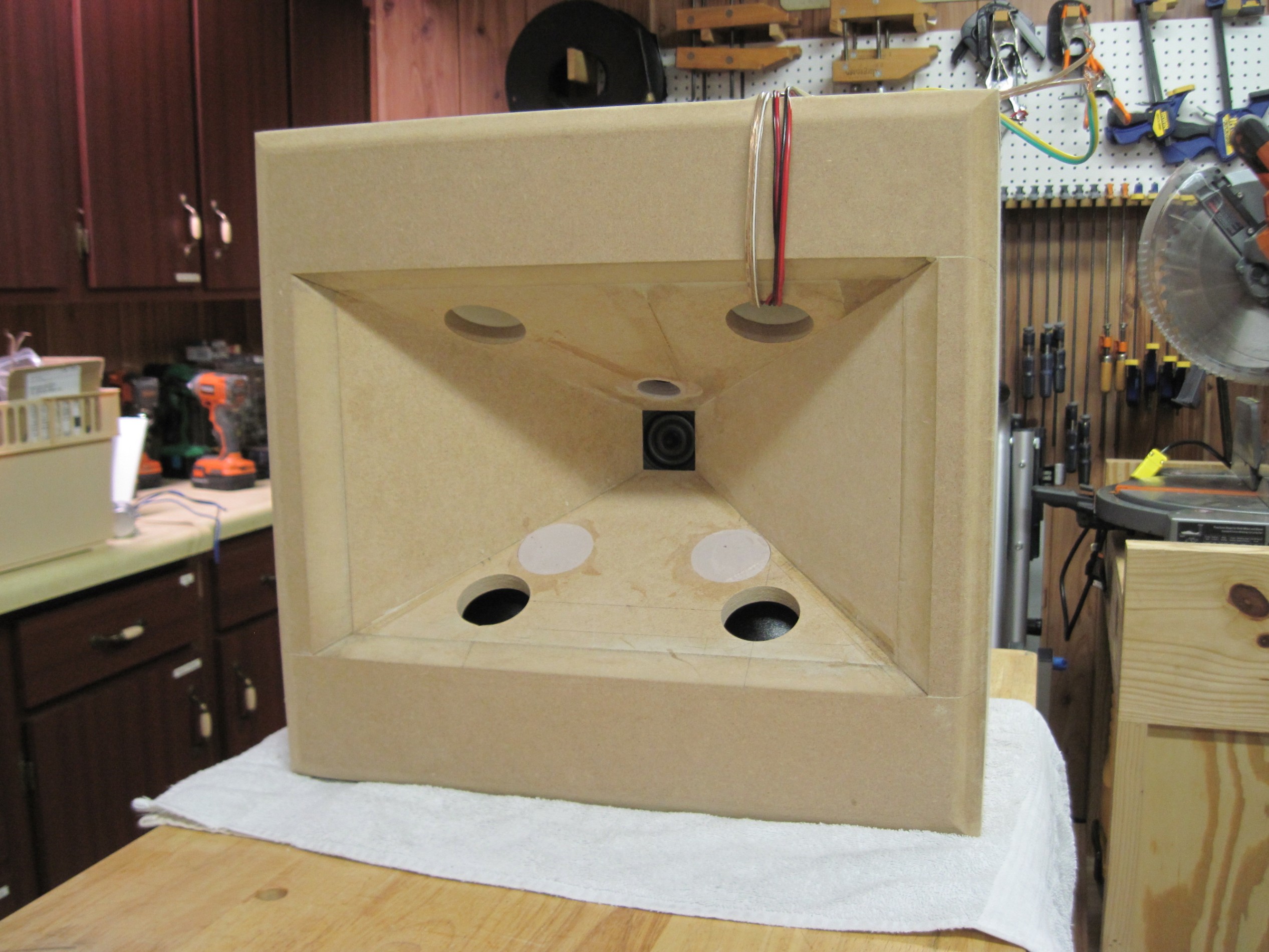

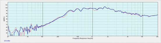

The attachments are the xt in horn with the mid hole covered and a picture of the prototype.
I'm working on a preliminary passive x-o for the prototype. I'm expecting to cross near 1,500 hz.

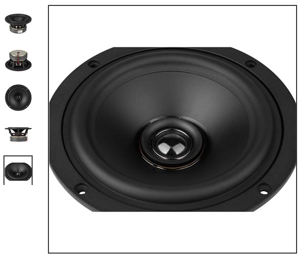

https://www.parts-express.com/dayton-audio-cx150-8-5-1-4-coaxial-driver-with-1-silk-dome-tweeter-8-ohm--295-386
I wonder how this one would do in a Synergy (the ones like Danley does with a single coax driver, tweeter coupled to the throat, woofer output entering up further toward the mouth)?
It doesn't model well. Looks like PE will be pulling back as the former has vent holes. thread here Dayton Coaxial w/Silk Dome - Techtalk Speaker Building, Audio, Video Discussion Forum

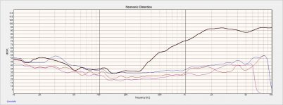

Distortion measurements of the xt25tg30 in the horn. One with the x-o and one without the x-o.
Thanks for posting, distortion rising quite a lot below 2K. Looks well controlled with your crossover what crossover are you using?
I saw that by putting a Zobel on the XT it reduced the lower frequency distortion. Not sure if that would help you or not.
The x-o is L-R 4th order with L-pad. I'm working on adding some shaping to the response before I call it done (passive x-o).
