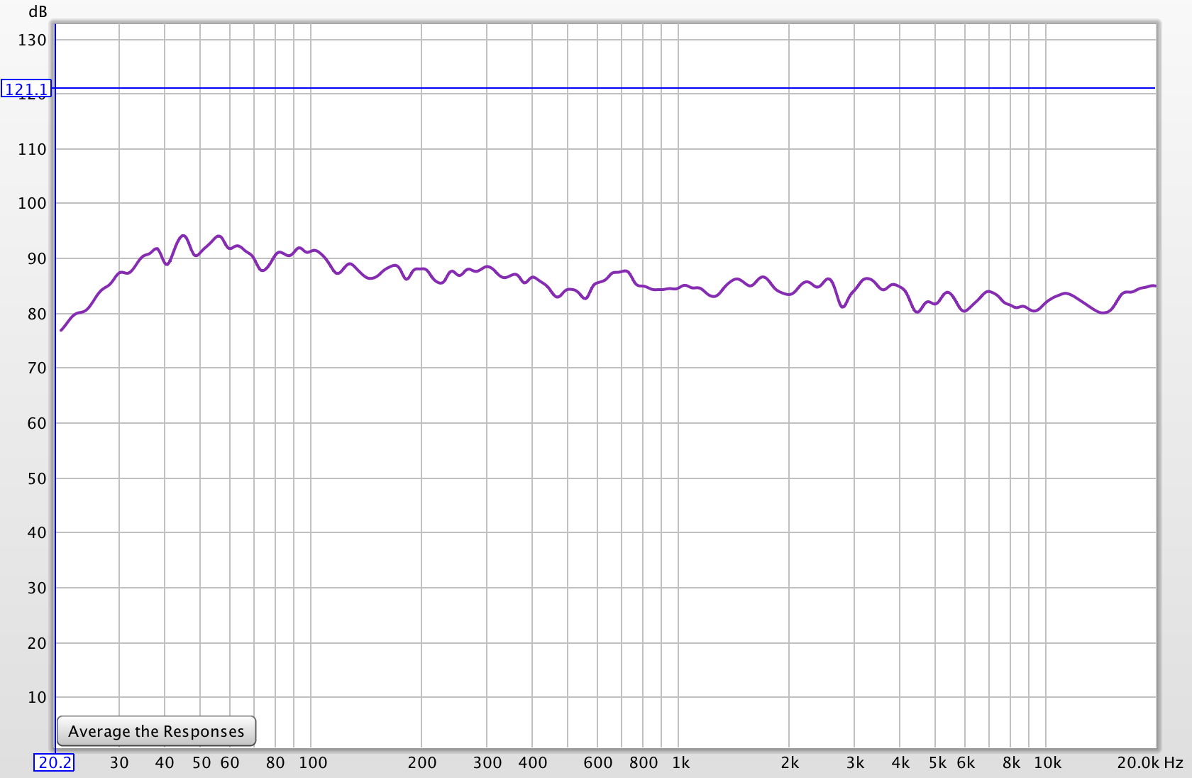

I've build a pair of unity horns, with the Celestion tf0410 and bms4550. The bass is handles from 300 down by a H frame with a Eminence alpha 15. It actually sounds great, but I'm kind of missing just a few more notes down from the horn actually. That made me thing about maybe using other mid driver for the horn.

TF0410 and BMS4550 is a good choice, that will cover 250Hz-20Khz nicely.
Eminence Alpha 15 is a relatively cheap driver and it's inductance might be limiting you. What do the measurements look like?

The measurement looks like this, I crossed the mids at 300 but maybe they can go a bit lower.

That is a beautifull respons

Quite happy with it. Must say that there's a lot of eq'ing going on, but I really like how they sound, I'll try crossing the mids at 250 today and see if I like it.
I just really like the unity sound an hoped I could get that same sound a bit lower.

Nice response but where/what distance was the measurement taken?
Your XO to the separate woofer will affect the response at the LP, where the room intrudes. Assuming the woofer is mounted below the horn, then the lower you XO, the more floor bounce you will see from what comes out of the horn. Move the XO up and you will get less floor reflection but perhaps more sidewall reflection.

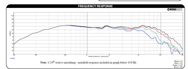

What about the SICA 2,5 H 0,8 SL?
Datasheet: http://www.sica.it/media/Z000855.pdf
It's got a treated cloth surround, vented neodymium magnet and "damping cone treatment" for around 15$ over here in europe.

The tough part with a lot of potential drivers is cleanly sealing the back with a small enough volume. You can do it with pieces of plastic, glue, and caulk, but it can get to be a mess and hard to do repeatably.
