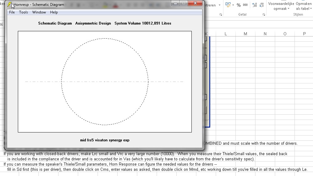

I have look at the Synergy calc, nice software, make it more easy when I have look through it. However, when using midranges with closed back I need to do lrc
small and vrc a large number, I did that and see a big circle and no horn, this is because of the uge vrc, but can I use the setup that way>, little confusion.
I go to use the visaton frs8-m 30 watts version, do close the back with peace of pipe and cover and refit the connections.
