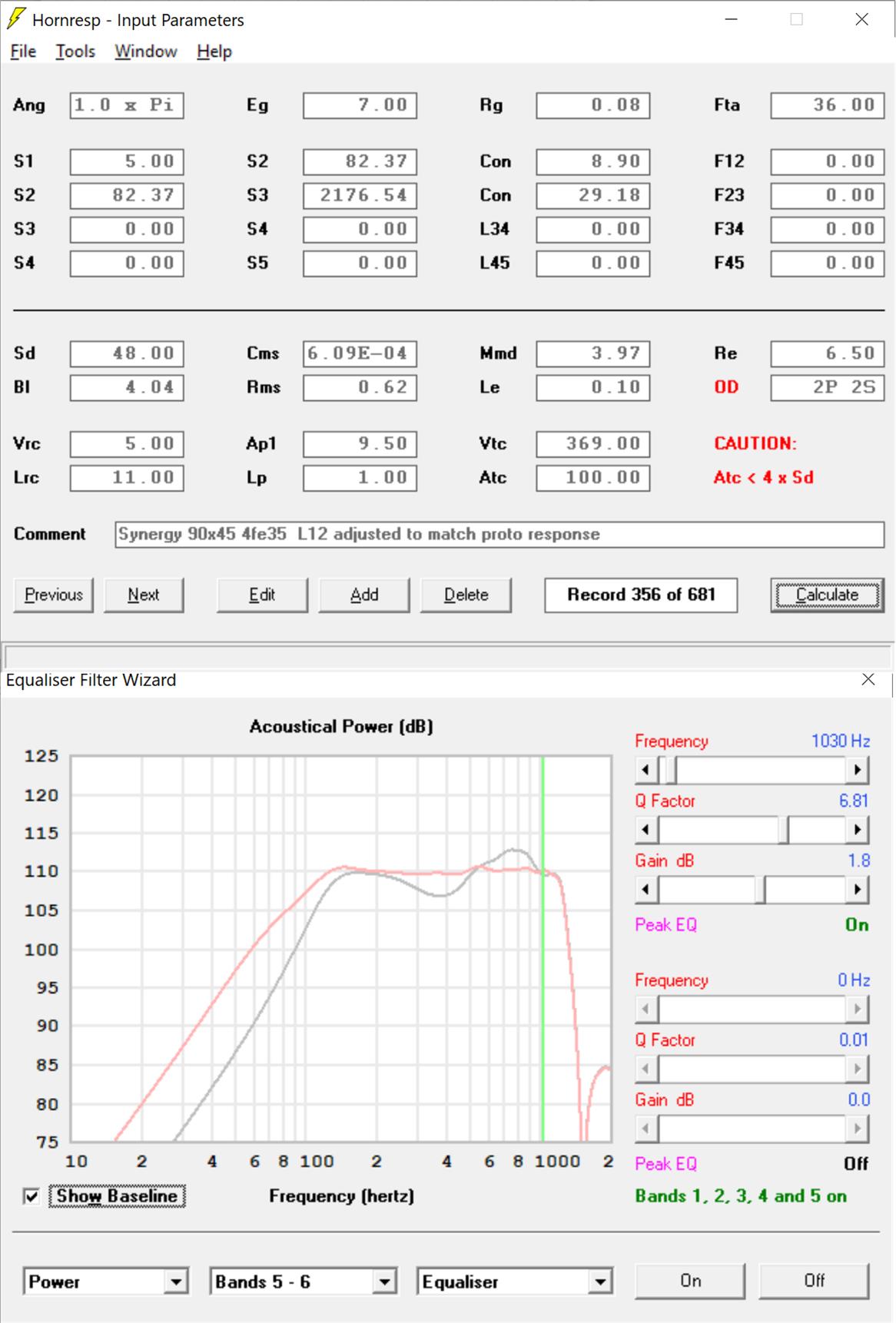

I don't know about Keele's classic analysis but I do know about my own results
attachment.php
grey is the raw result, red is equalized with 4 peqs, and a low shelf, no low pass filtering

I will have to think about how this would cut the distortion, since it's just a notch.
Best wishes
David

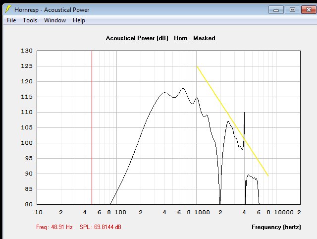

I'm not an expert by no means but I thought the mid 'ports' acted similar to 4th order bandpass systems so you get a natural roll off as well as the 1/4 wave notch ?
Here's a sim of my celestion mids in a MEH. I've drawn a line in yellow to approximate a 12dB roll off as expected in a 4th order bandpass type setup.
Rob.
