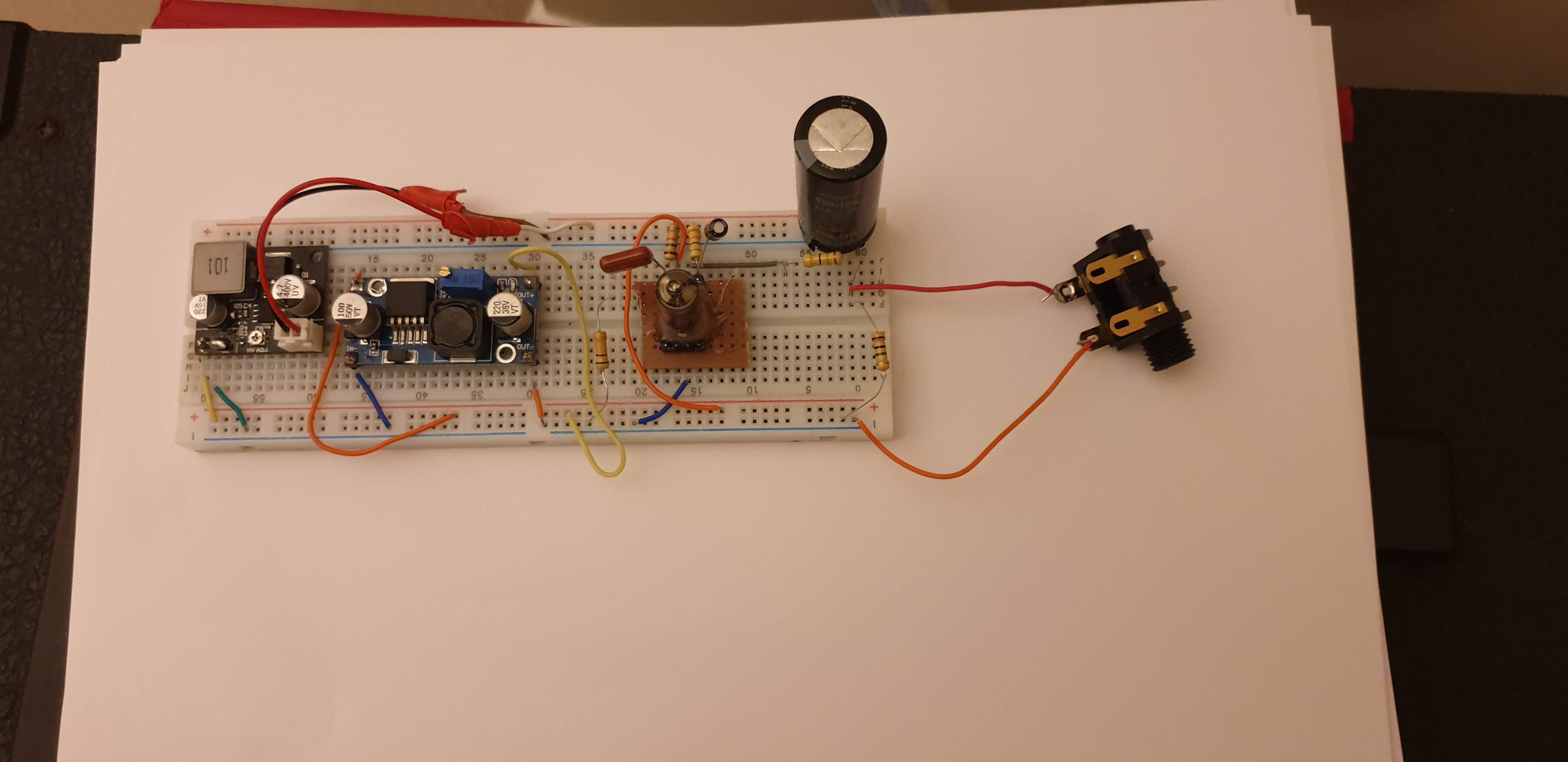

Hi guys,
I've started doing my amp. Finally !! 🙂
So I can get the sound I want, I started putting everything into a breadboard.
As a first step, I've wired the first stage of the pre-amp and used a class D 3W power amp module, which I bought off eBay, to drive the speaker.
If I connect my smartphone to the class D amp, the sound is very good.
However, when I connect the valve pre-amp to it has loads of noise, as it was statics from a TV or similar sound to heavy rain.
The guitar is working and the sound is not bad at all.
When I power off the amplifier, then it sounds very well. As I have a "big" cap on the supply, I still have good 30seconds before it really turns off.
I am using 2 SMPS, one is a boost (180 V) and another is a buck, to set the heater voltage to 6.3V.
The noise is pretty loud, but when the heater turns on, it gets even louder.
So, I've decided to put a cap on the 180V power rail, which was removed from a power supply from an iMac. It is a Rubycon 180uF and 450V.
Causes for this?

Hi, nice to see that you went on with this build.
My first question would be, which kind of input the 3W class D amp expects? Do you have to separate grounds for each input (if it is stereo)?
Since turning it off works, it is probably one of the SMPS that introduces a lot of noise. I guess it gets louder when you power the heaters because the noise of the preamp adds up to the noise in the power amp.
Some test I would do:
- With the 180V SMPS on and heater off ground the input of the power amp. Any noise? Probably not.
- With the 180V SMPS on and heater off ground the input of the last stage in the preamp. The cable between preamp and power amp could act as an antenna and introduce some noise, but it should be way less than what the power amp expects, thus not as loud.
- With heaters on and 180V SMPS off check noise. Is it louder with the heaters on, without plate voltage or the other way around?
About filtering. You can filter the B+ and the 6.3v with some RC or RL filters, but since both SMPS are working at high frequencies they will also emanate noise. Part of the circuit acts as an antenna and will pic it up. This gives me the idea...
- Check the noise if both SMPS are on, but not connected to the preamp (without load). If there is noise, then the SMPS are emanating it. You can try wrapping them in aluminium foil and grounding the foil. First make sure that the foil won't touch the circuit by using some plastic foil. This way you can make a small cage that will contain some of the noise. It needs to be grounded, otherwise it will act like an antenna and make things worse by increasing the emanated noise.
Later, when you put your circuit in a box, if you position the SMPS closer to the walls, and the walls are made of metal, and grounded, they will shield part of the noise, reducing the electric field and the noise emission.
If you have a transformer, try powering the preamp with it. The noise should be reduced, and you can check if the circuit is working as intended (no missing ground). Later you can add the SMPSs and try to handle the noise they produce.
Using shielded wire for the inputs or sensitive nodes in the circuit also helps.

Hi Thomas,
Thanks for the detailed answer.
Regarding ground, I don't have a "real" ground, since I am using an old transformer to power both SMPS (please check the pictures attached).
I've attached a video just for you to hear the noise and a picture of the breadboard.
Pedro

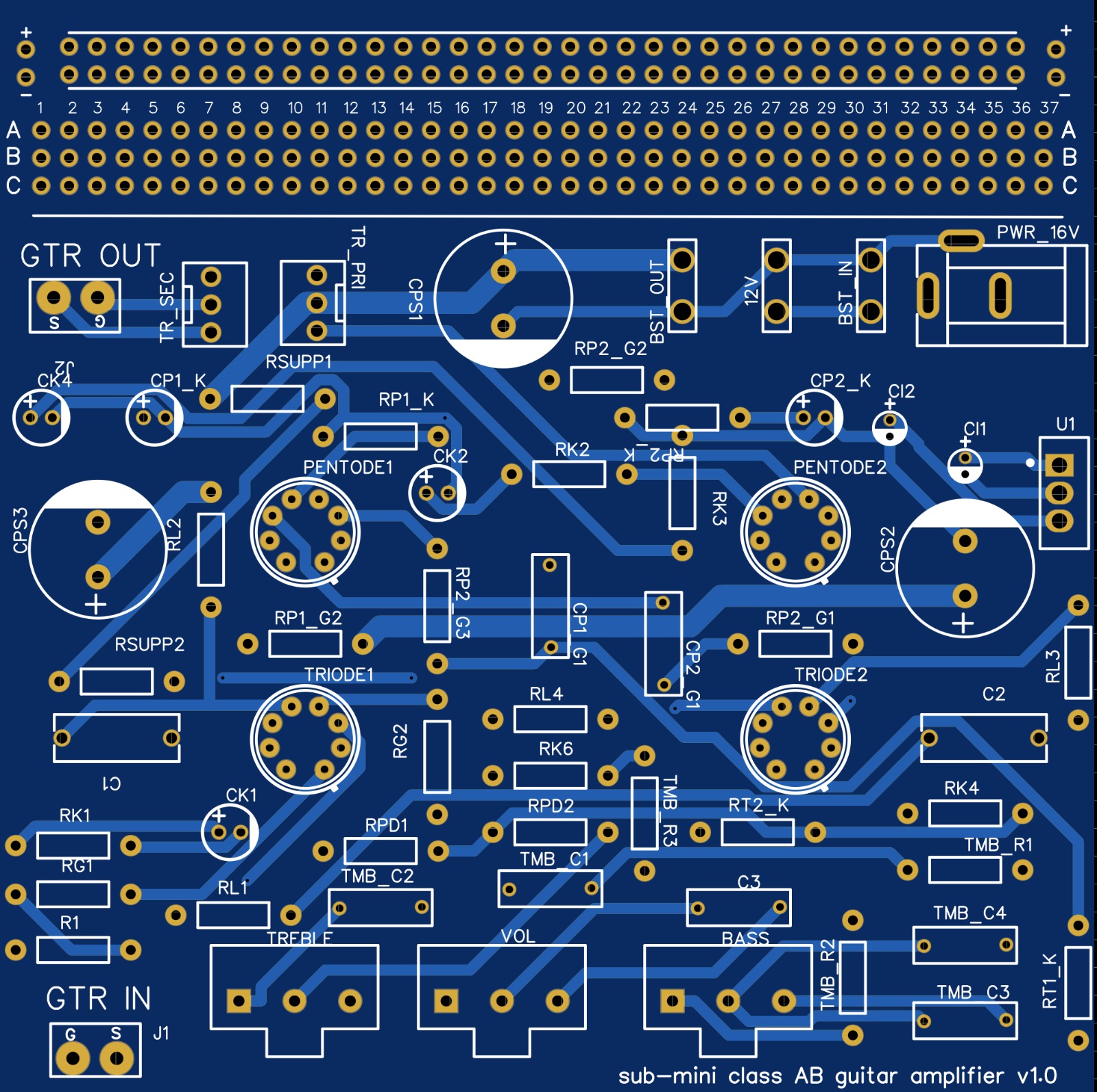

Hello guys,
I am making some progress with the amplifier.
The power stage is now a pp stage.
I did the PCB on EasyEda, but I have some doubts regarding grounding and track width.
Grounding:
1 - is it better to have a ground plane or star-connect all grounds?
2 - in case of using a ground plane, should I use one or separate planes for power and signal?
Track width:
What should be the with of the power tracks for a supply of 180V (I am using 3mm )?
The anode current of the 6P30B-R is around 50mA and the heater 400mA !
Any suggestions please?
Attached there is a screenshot of the PCCB on Easyeda. I've added a small area for prototyping on the top.

Current in audio circuits moves in circles. Route and ground accordingly.
Digital bits benefit from ground and power planes (yes, there are exceptions) but keep these separate from the rest of the circuit as far as possible.
50mA is find for standard tracks. 1/2A needs a little more thought (as you will get some voltage drop) and needs to be isolated from the audio bits (see the 1st sentence).

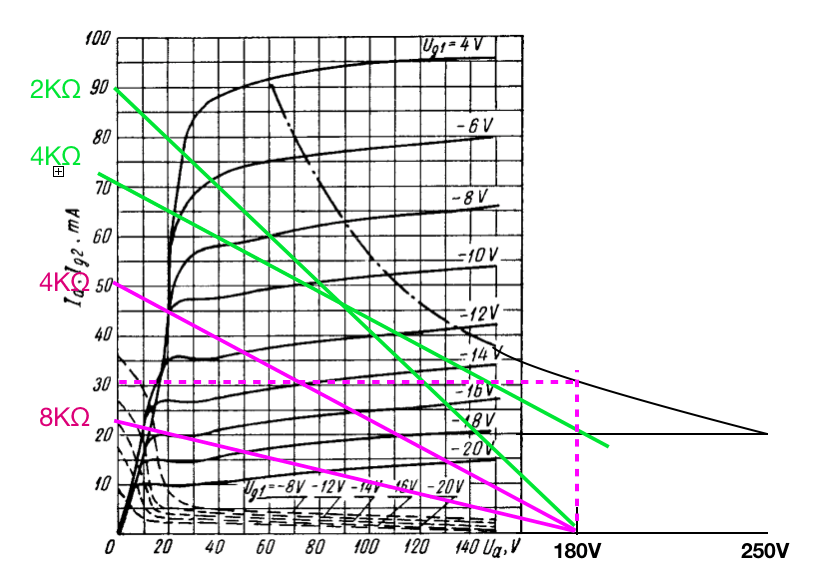

Hi guys,
I am dimensioning the output stage and have one doubt. When drawing the class A load line, I move the load line close to the max power curve. If I go really close to the curve I will operate in class A only. Is there a way to move up the class B line as well?
I've done some experiments. Please check the pictures attached.

Line transformers can be used for push pull, not much good for single ended. But you cannot use any line transformer, look here for info on what & how.Thanks for your reply.
Well, Thomas Hafemanm says that Line transformers are good enough for low power guitar amplifiers.
He has done many different amplifiers. Please check on YouTube. They are really awesome.🙂
Battery Powered Tube Amplifier : 4 Steps (with Pictures) - Instructables
Pedro
The Omnitronic mentioned by Kay pirinha is very suitable for PP. You could use an 8 ohm speaker to get 32k primary inductance. I think using a 4 ohm pc speaker is not the best way of saving money, a real guitar speaker is much more efficient and thus louder. The speaker will most often be by far the most expensive part of the project, that's the reality.
