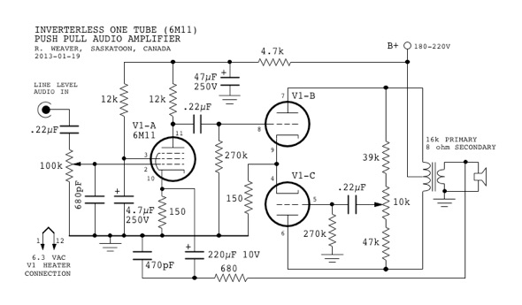

Hi guys,
I came across an approach for designing an inverterless push-pull amp that differs from the traditional one (post #112).
Instead of grounding the grid of one of the valves, the output (anode) of one will be fed into the grid of the other, making the signals actually out-of-phase.
Has anyone tried the approach before ? This one, should work as a "proper" pp output stage, where the traditional will only work in class A and give half the power.
Pedro
http://electronbunker.ca/eb/TubeAudio_01a.html

I have not tried this one yet, but would be something interesting to simulate.
On the other hand, this seems very much like the self-split approach. What happens in class B? Where is the signal coming from if the tube where the feedback comes from is in cut-off? I might be missing something, though.

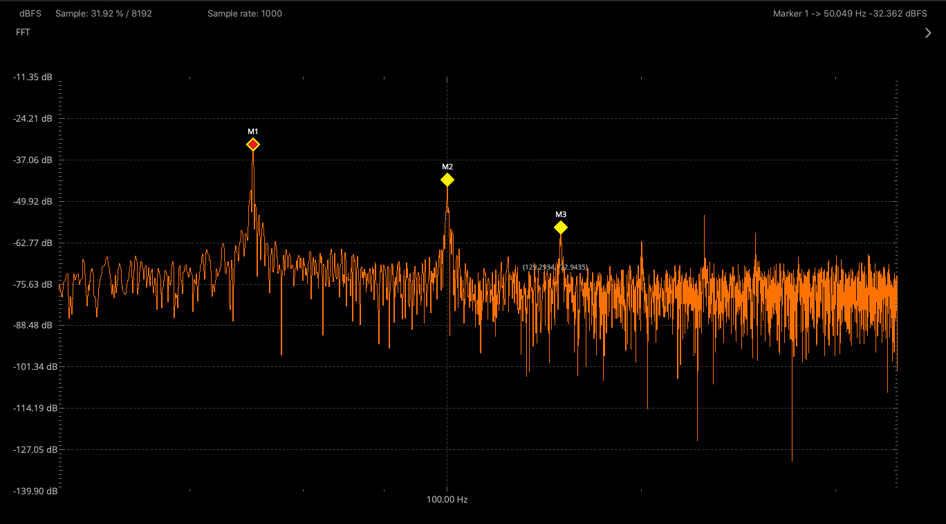

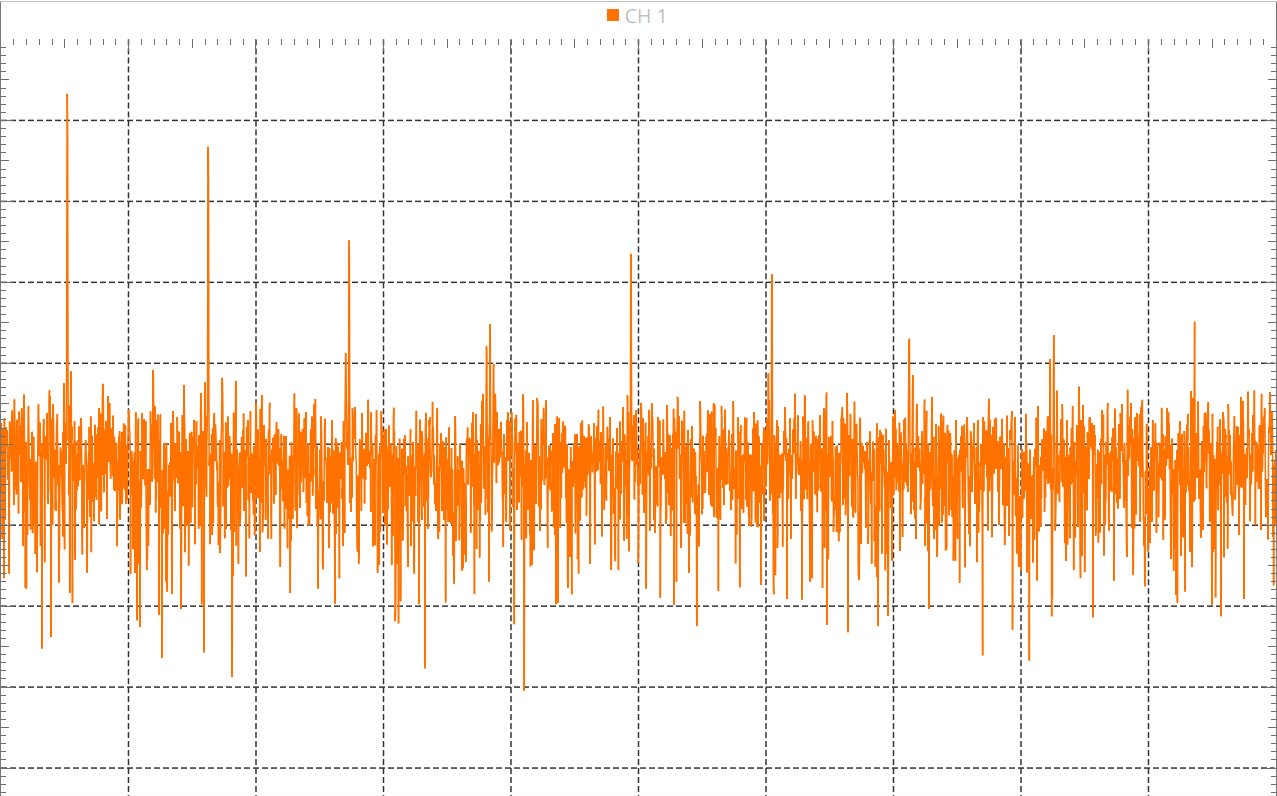

I have just connected the amp to a spectrum analyser and the reslt was 50Hz noise and many of its harmonics.
Please find, below screenshots and a file with the sound of 50Hz noise and, later, at max volume oscillation.
From my personal dropbox:
https://www.dropbox.com/scl/fi/gdl0...tion.mp3?rlkey=xv86p4re7cqkfr2wuu84us11n&dl=0
Pedro
