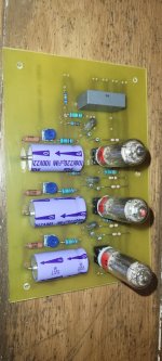

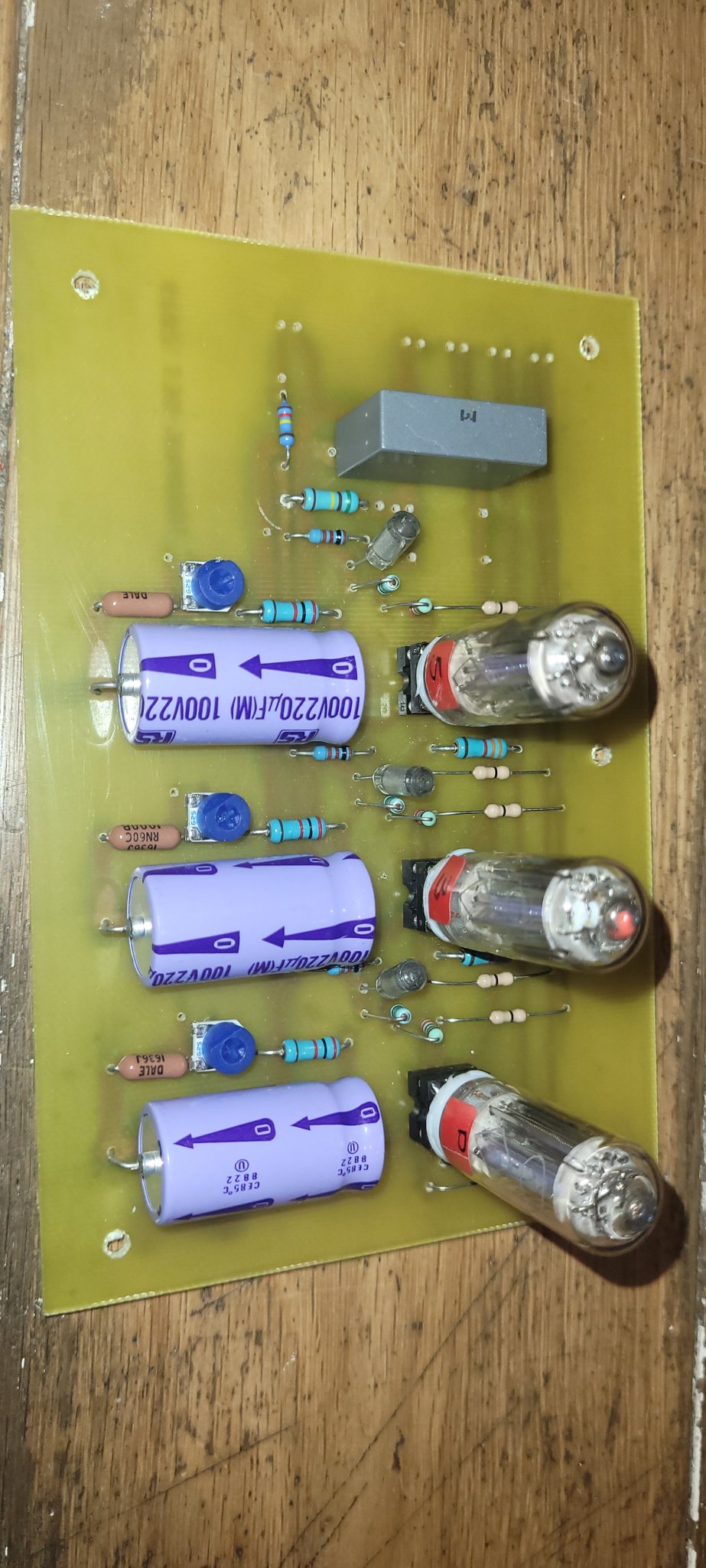

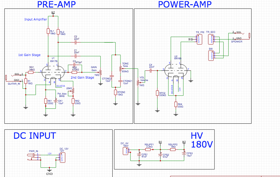

Hi guys,
I've finished the prototype and the amp is working. 🙂
Next version will have a buffer to drive the tone stack.
Pedro
Pedro
The amp is very quiet and only with the volume at 10, I can actually ear something that is reasonable.
I guess I will have to change the 6N16B in the pre-amp for a 6N17B.
And, as Thomas said, the tone stack sucks volume.
Maybe adding a buffer (another valve or a JFET), the tone stack would be properly driven.
Any thoughts on this?
Pedro

The signal coming from the tone control ist too low to drive the output stage properly. Remember that a self balancing, self inverting output pair requires double the signal level compared to just one tube, and triodes in general require high drive signals.
Best regards!
Best regards!
Hi,The best I could find are 100 V line transformers with a 0.625 W tap. I gave you some examples. This transforms to 16 kohms which might fit well enough. The CT is the 2.5 W tap.
Best regards!
Thanks.
And that was exactly what I've done.
Centre tap 2.5W and then Common and 0.625W to the extremes.
Pedro
Hi,Remember that a self balancing, self inverting output pair requires double the signal level compared to just one tube, and triodes in general require high drive signals.
Thanks for the reply.
Does the same apply to "normal" push-pull configuration with phase-inverter? Would this one be able to perform better, or would it be the same regarding power?
Pedro
Hi Pedro,
it depends on the PI. Basically, the finals' gain is as it can be expected from the operting point. The PI's gain depends on the design: With two triodes, it equals the first triode's in a Paraphase or Concertina, or it is half a triode's gain in the LTP.
With a dedicated PI output power will increase with fix biased finals, and it might increase with cathode biasing.
Best regards!
Best regards!

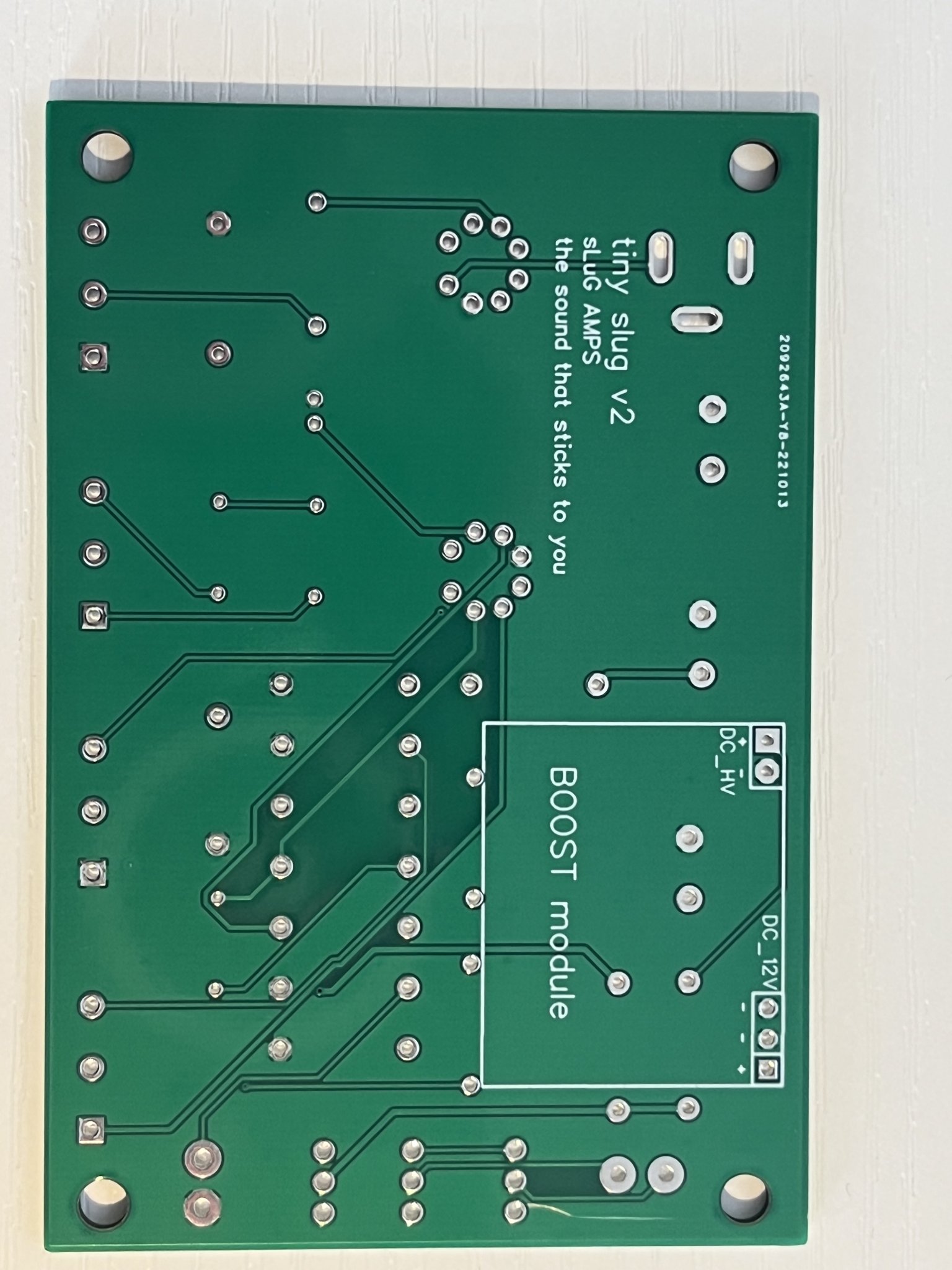

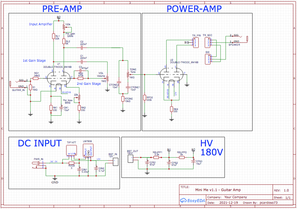

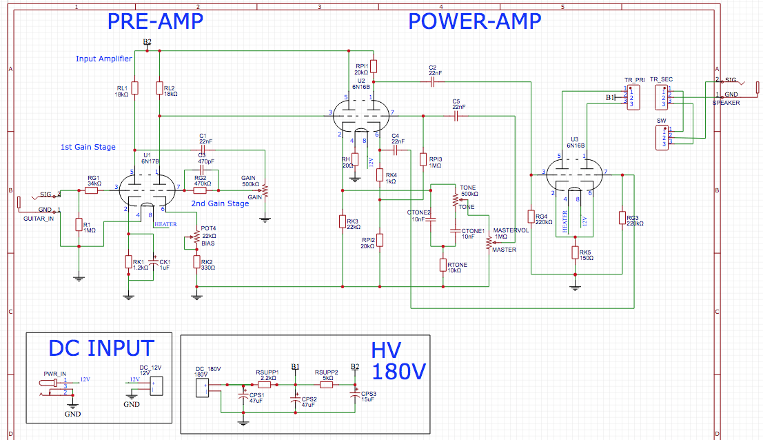

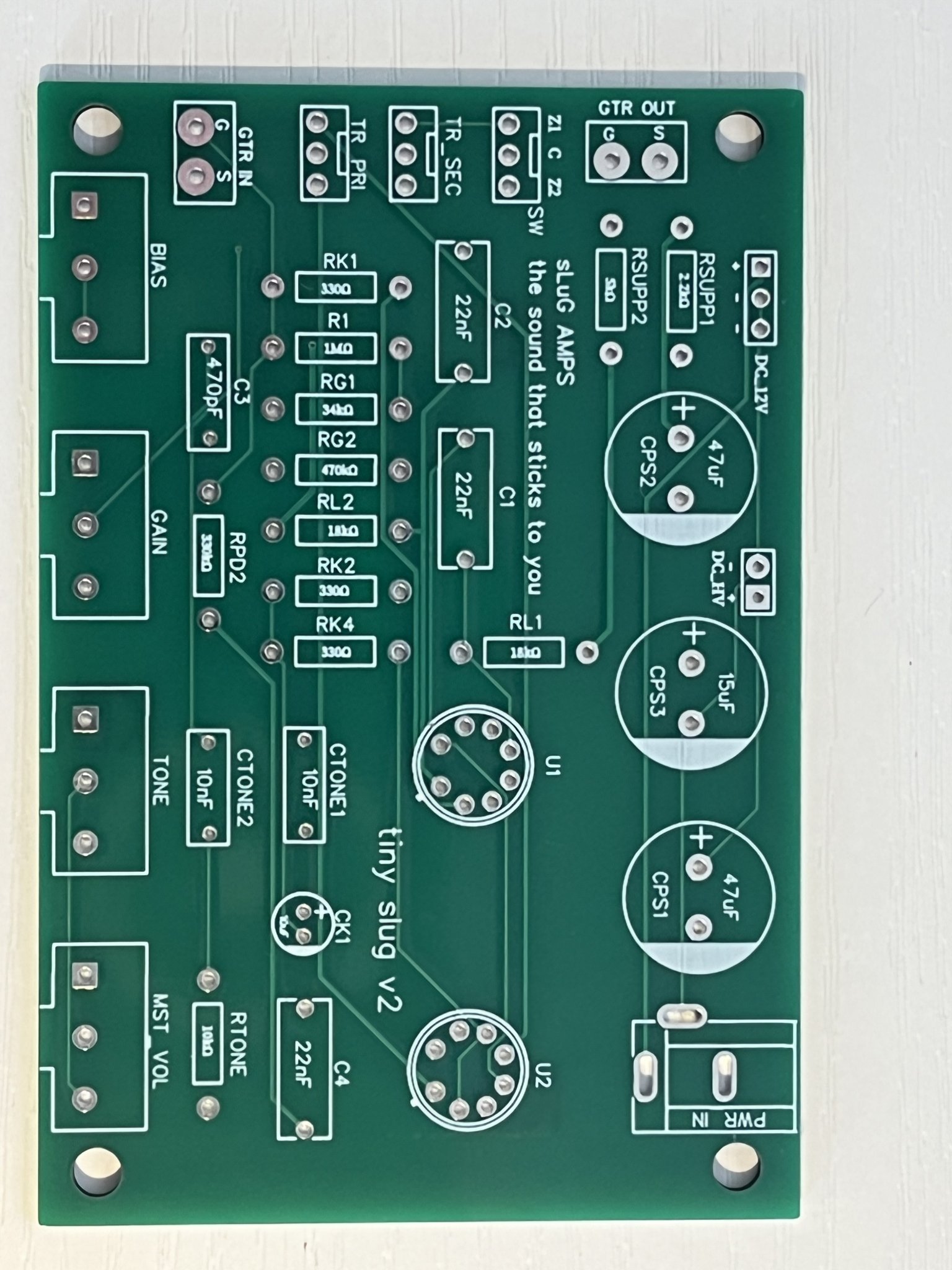

Hi guys,
Since last update, I have made 2 versions of the amp attached to this post.
I've called the amp "tiny Slug". I have another under development called "little Slug", which schematic is attached too. This one has a phase inverter and a buffer for the tone stack.
Please feel free to criticise my designs !
To be honest I would like to open my own company to do guitar amps, but I have a reliable full-time job that pays my bills. 🙂
Pedro
Pedro
