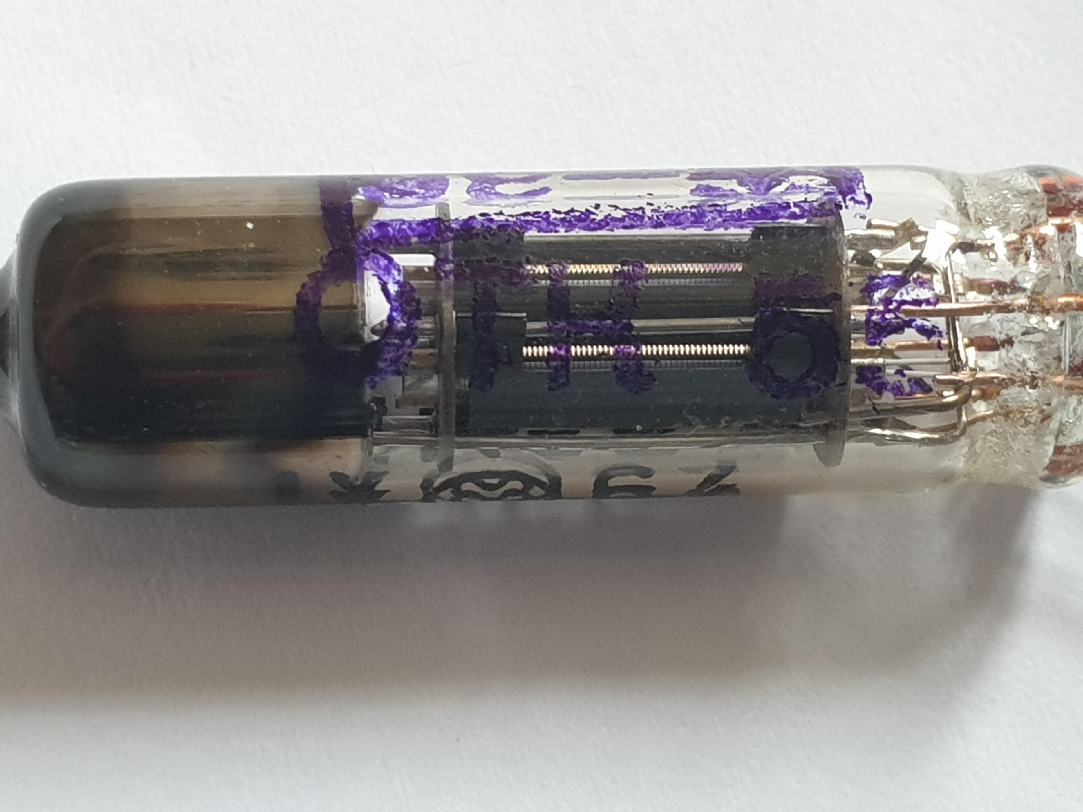

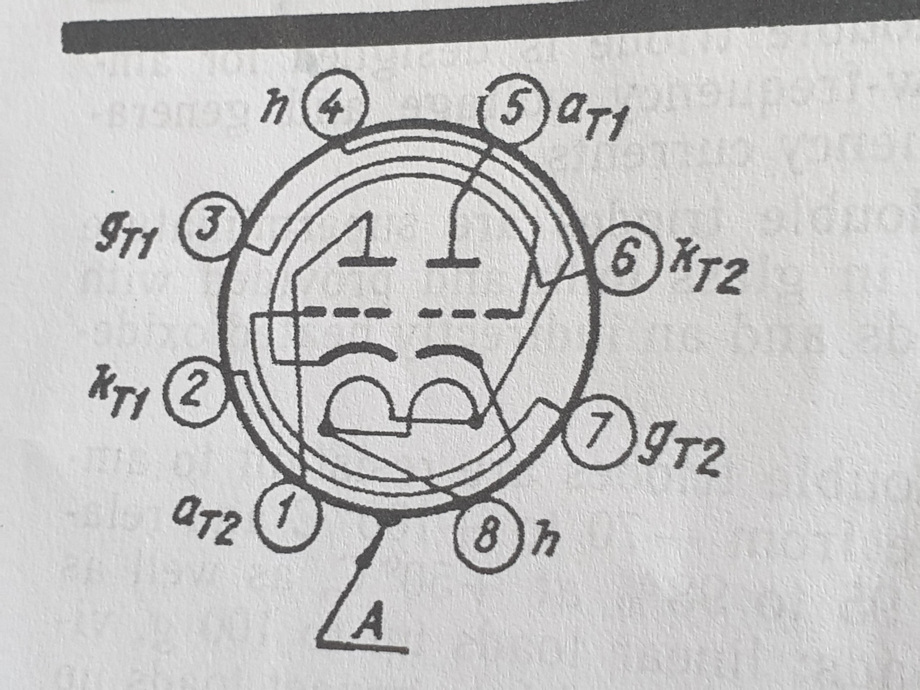

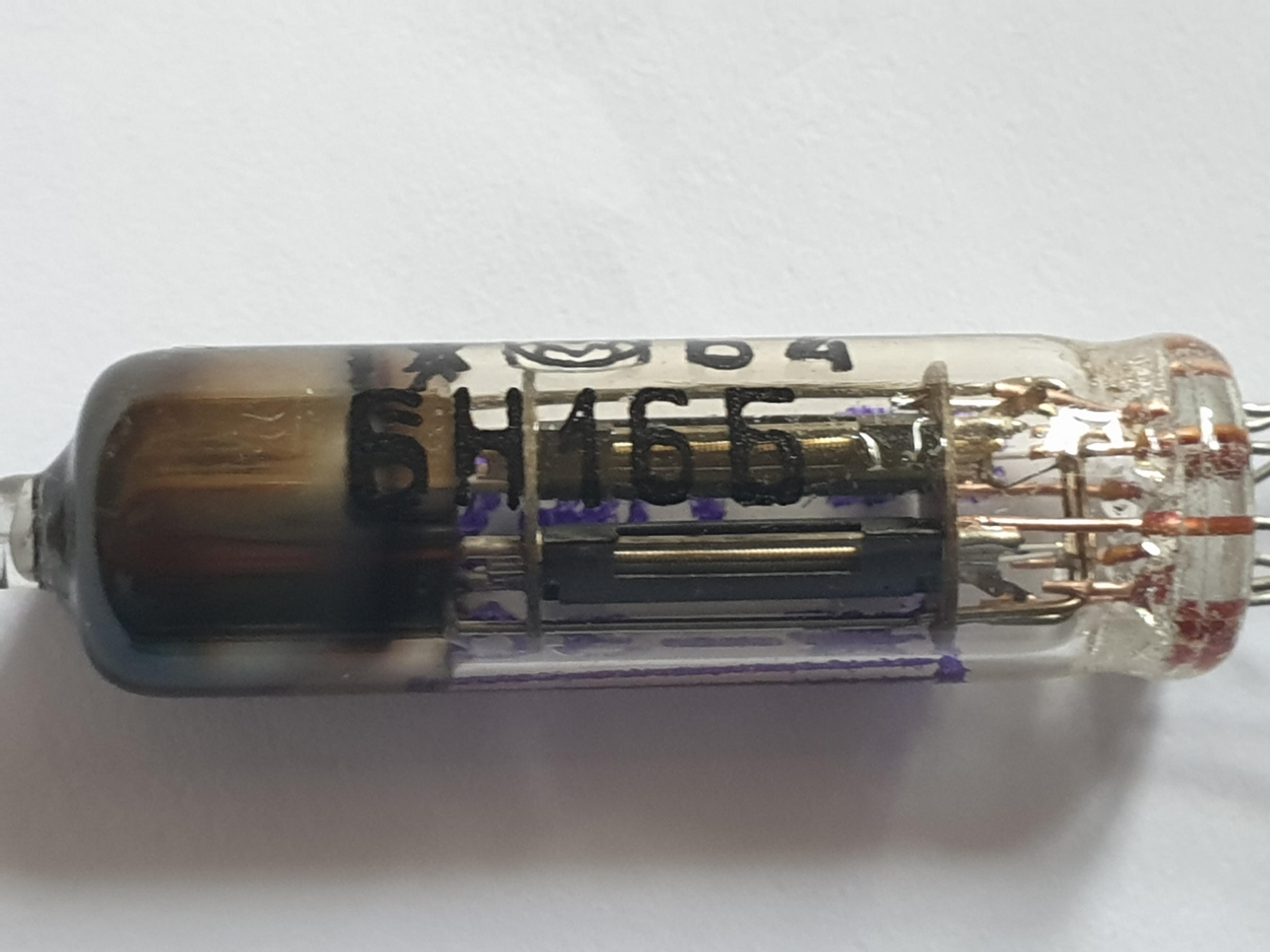

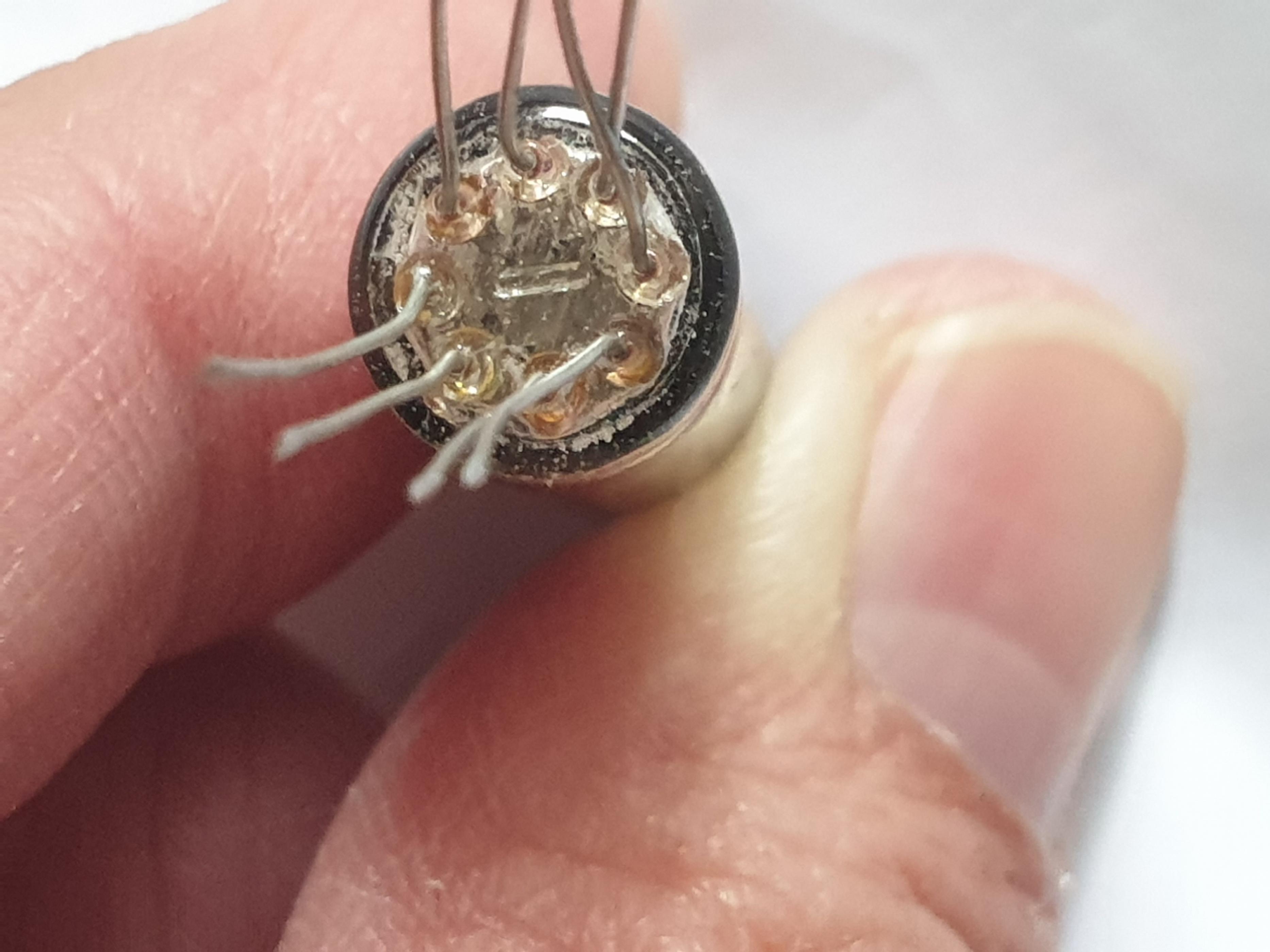

Hi
Can someone please help me finding the pinout for this tube?
I was expecting to see a mark of some kind, but I can't see one.
Please check the pictures attached.
Thanks,
Pedro
Thanks,
Pedro
Are the triodes dissimilar? If they aren't, identifying the pinout isn't that difficult: Both heater wires are arranged in opposition, and the electrode wire sequence exactly repeats.
