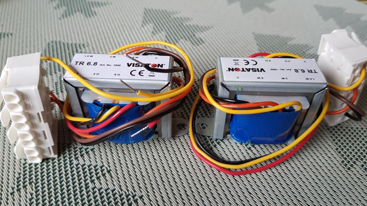

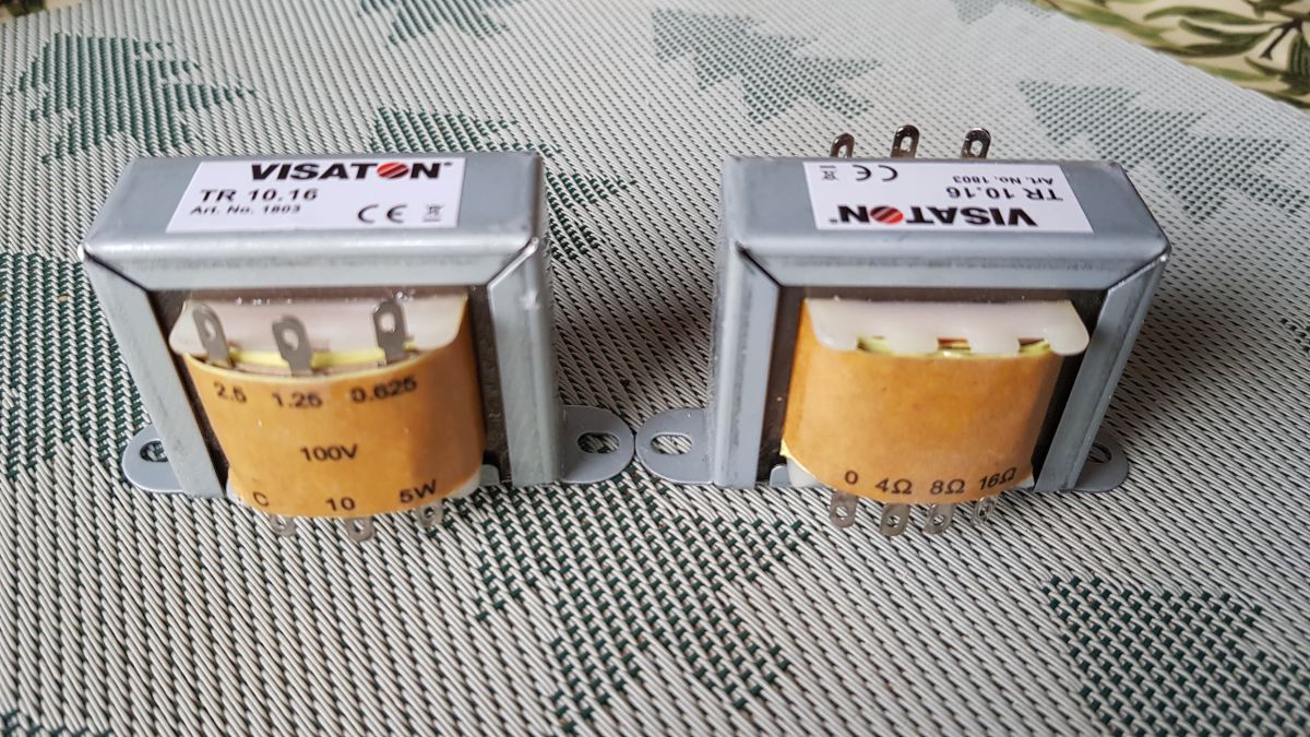

I've found out that here in Germany the cheapest soucrce for transormers like these is Security Check. This company has been bought out by Conrad electronic some decades ago, offers about the same, but is much cheaper than it's mother company.
I bought each a pair of the smallest Visaton line transformers, the TR 6.8 and the TR 10.16. Their lamination stacks measure about 40 x 32 x 17 mm for the 6 watts TR 6.8, and 48 x 40 x 17 mm for the 10 watts TR 10.16, respectively. The 6.8 transforms to a primary impedance of 8 kohms, the 10.16 to 16 kOhms. This one also has a secondary CT. Primary CT's are at 2.5 watts and 6 watts, respectively.
