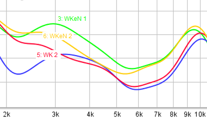

Hmmmm... the difference in response sensitivity already favors the WKeNabls (and WKeN2 is closer to WKeN1 than to WK2, for fair control). I was expecting audible differences not shown in frequency response (as I'm familiar with the effect of non-eNabl cone conditioning).

May be if the FR were made equal (or random) we can actually hear the difference? For example, we can do non-eNabl conditioning to improve sensitivity of the "pristine" driver.

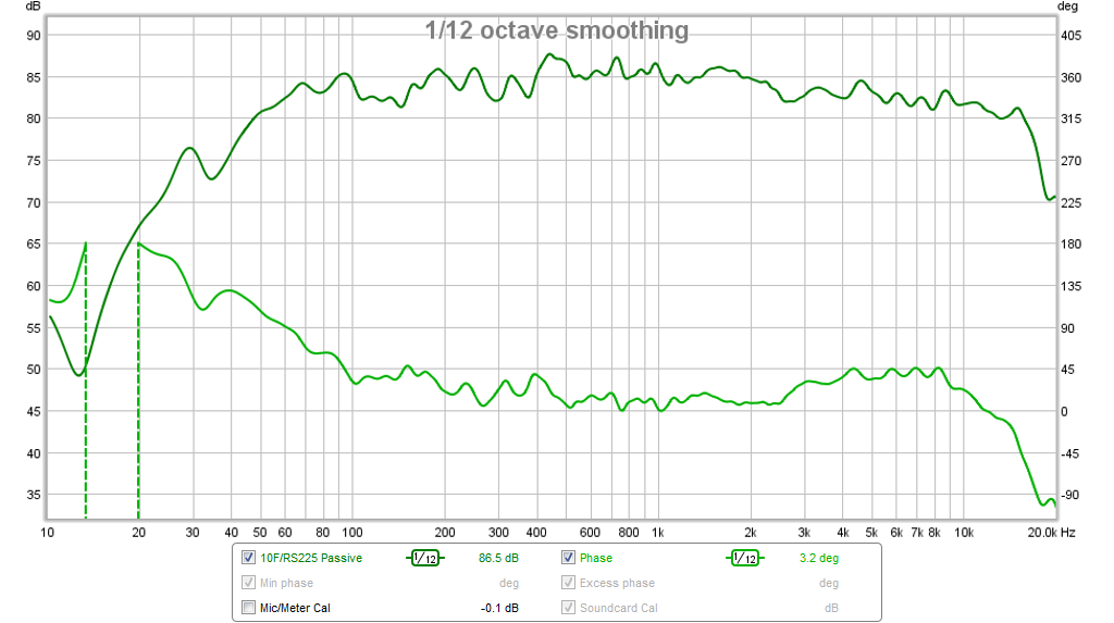

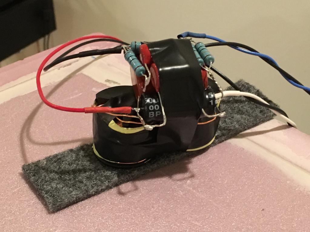

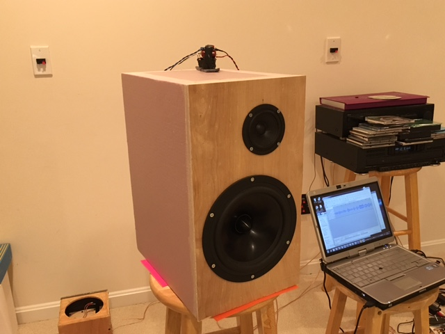

I made a new version of the XO using a bipolar electrolytic 50uF cap bypassed with 10uF MKT cap and 2.2uF MKP cap, and 1% metal thin film 2w resistors paralled for 4w rating. The XO was connected to my 10F/RS225 FAST boxes rather than the external Dagger. In order to get the drivers in phase I moved the mic on axis with the woofer and this put about a 3in delay between the tweeter and woofer. Because of this, the 10F is meausured at an approximate 30deg off-axis.
Here is a photo of the SPL and phase:
Here is a photo of the speaker with XO sitting on top. You can see how this is much smaller than the previous one:

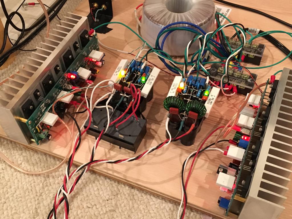

The amp just received dual CRCLC power supply (linear at 45v rails). When listening in stereo, the separate PSU's really open up the soundstage.
Here is measured Phase and SPL:

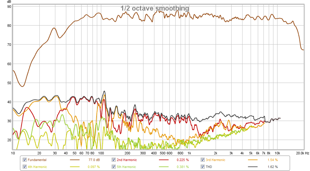

Here is measured Distortion:

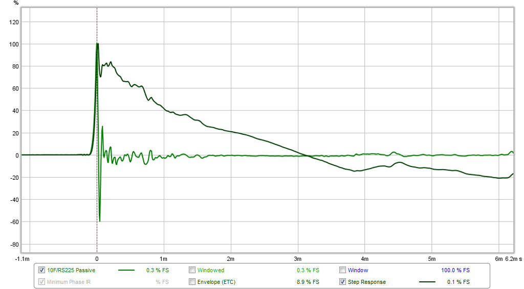

Here is the Measured Step and Impulse:
