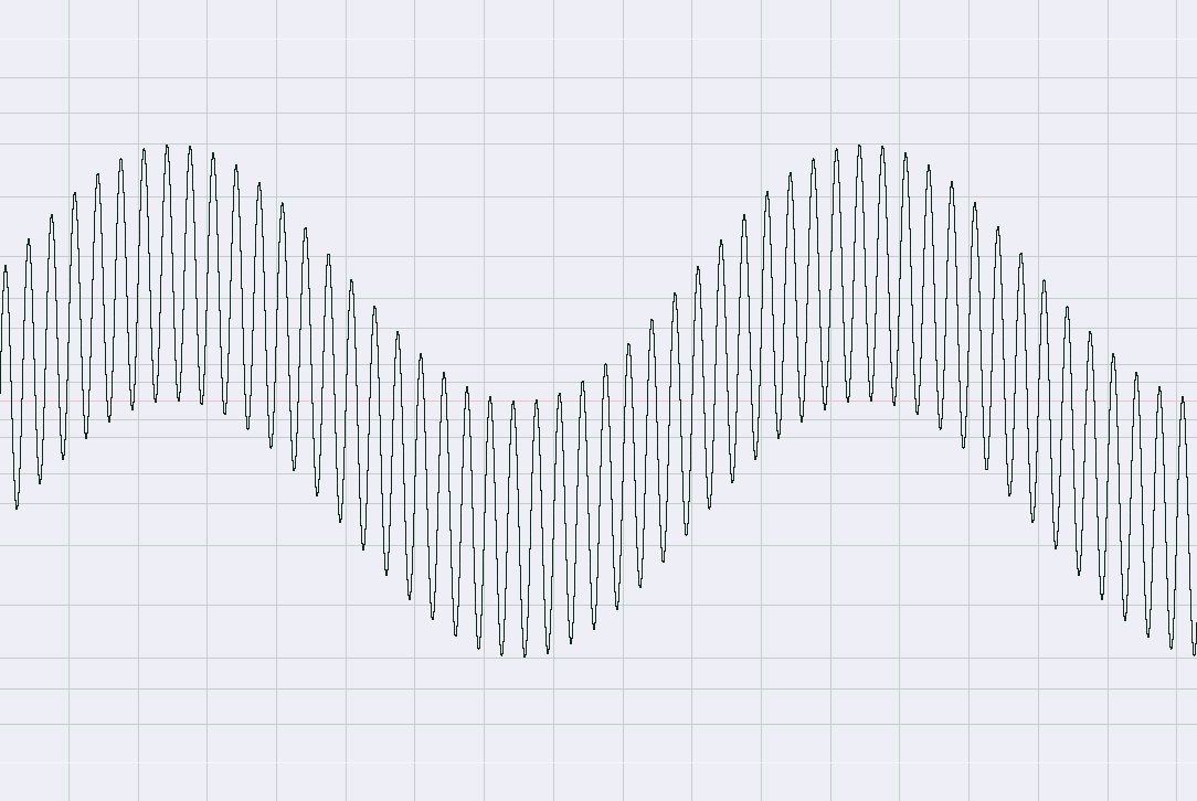

(Sine) Wave shape of a 100 Hz signal with a simultaneous 3 KHz Sine Wave:
attachment.php
Analysis of the above wave shows the 100 Hz and 3 KHz peaks:
attachment.php
See the similarity to freddi's graph? Only that graph shows the 'by products' when the cone is asked to do both of these tones simultaneously. The harmonic distortion.
If, to produce the 3000 Hz tone, the voice coil would only move relative to the magnet, what movement would create that simultaneous sound it is asked to do at 100 Hz? They can't take turns...
Just a quick test of 2 tones to show it's wave shape. Please let me know why the 3000 Hz tone shouldn't be considered as "riding on top" of that 100 Hz tone.

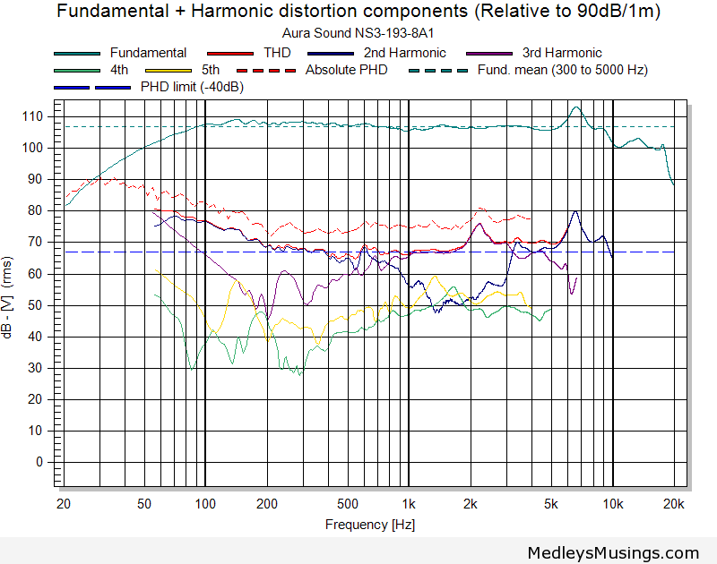

I'd dare to say in some full range drivers, distortion can attribute to the sound of that driver.
Normally it won't if distortion levels are down far enough, but just check some drivers out there (mainly metal cones) that exhibit a peak in 3rd order distortion. The shape of that 3rd order distortion can be found on the top end FR trace of that driver, creating a sense of "detail" that isn't present in the original piece of music played trough it.
An example of such a full range driver would be an Aurasound NS3:
attachment.php
Look at the shape of the 3rd order peak at 2.2 KHz (purple trace, partly hidden behind the red THD trace). Now look at the shape of the FR curve starting at ~6.5 KHz... try and compare the 2 shapes closely. So each time this driver is asked to play something at 2.2 KHz, it will alter (enhance) the tones it is asked to play around 6 KHz. This may "seem" to bring out extra detail, while actually it is a by-product of its level of 3rd order distortion.
Now if adding dots can bring that peak down, that would/could provide hearing more actual detail.
This is a case where for me, this driver would be considered to have too much distortion. And by far this isn't the only one showing behaviour like this.
This plot is borrowed from: http://medleysmusings.com/aura-sound-ns3-193-8a1/
