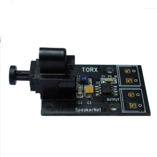

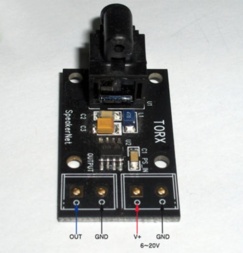

I also found this on ebay: (I would guess that regulator should run fine at less than 6V input, but I am not sure)
Listing Name: TOSLINK Optical Input to S/PDIF Module
Listing#: 330386501621
Price: $23.00
Optical Input Module for DAC
Specification:
• Optical Input to S/PDIF Output
• Low Noise&Low Drop Regulator
• Low Impedance Tantal and MLCC
• Power Input : Regulated or Unregulated DC 6~20V(MAX 40mA)
• Support up to 192KHz
• Output Voltage Level : 0.1 ~ 4V
• Low Jitter : < 0.033ns(@15dBm)
• Gold Plated PCB
• Size : 24x42x21(WxDxH :mm)

Hi PMI
The required PSU for this module is shown in first pic to be between 6-20 VDC.
DAC PSU is 5VDC...
Noted, thanks! Which is why I said this above: "(I would guess that regulator should run fine at less than 6V input)" Not knowing exactly what is on that little board, something one would have to test to be sure... 😀
If anyone happens to have more into, please chime in, thanks!
Hi
According 723 datasheet, if you change R1 to 1.15K and R2 to 6.04K then you will get 6V from DAC PSU, with 12V trafo. But this is J.P. and Subbu design ...
Thanks, although that is a bit like what we call "The tail wagging the Dog". If it comes to that, I think I should just put another reg. on a little piece of perf board... 😀
