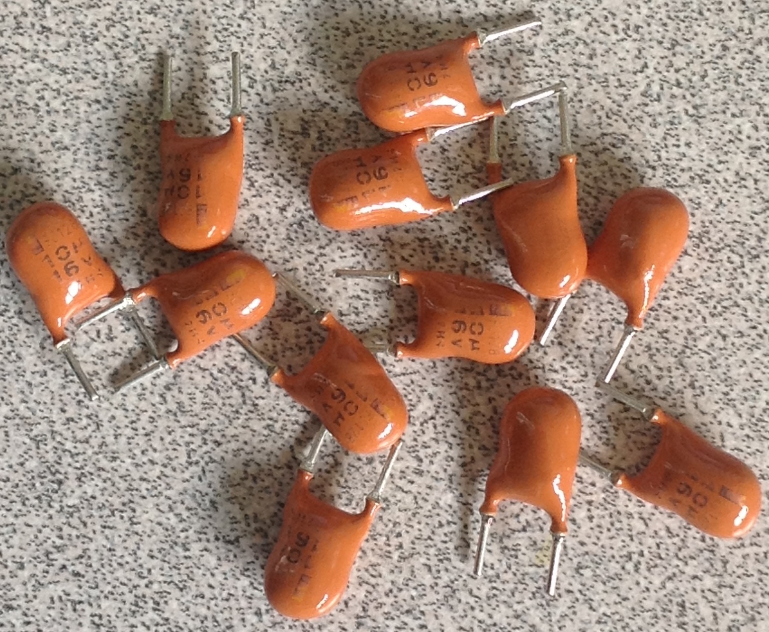

+ : I really like them soundwise. They are absolutely better than Panasonic FC IMO. They have dry electrolyte and won't dry out as normal electrolytic caps do so no need to replace them. They can have way larger reverse voltages than normal electrolytic caps so better suited for coupling purposes (see data sheet). In that aspect they behave a bit like BG NX bipolars. They're orange 🙂
- : They have 10 mm pitch and they're relatively large. One should also never bend their pins as the safety vent is at one of the pins and bending the pin right at the cap body will break the pin. Expensive, hard to find. Some series already out of production. Unknown so nobody seems to try them.
We used them as BG is rare now and prices are like the prices of bread in wartime. IMO it's absolutely ridiculous to have to pay 56 US $ for one (1) BG NX HiQ cap...

As reference, Newark order arrived today with the 10uf SAL RPM variety, the others are awaiting shipment from across the pond
Oh I am sorry, yes other values for the SAL RPM's as listed on the BOM. I also ordered some of the 68uF variety but they were not in stock with the US distributor so it said they were going to be sourced from the UK who was showing them as in stock.

I use 68 µF 6.3 V (older series 122) too for C22. SAL RPM is good stuff but I recall Lars Clausen having them going defective in his class D amps. Must have been the application (too much heat/voltage/current etc.). i haven't experienced any problem till now with them. I wish I could say the same for tantalum caps.
