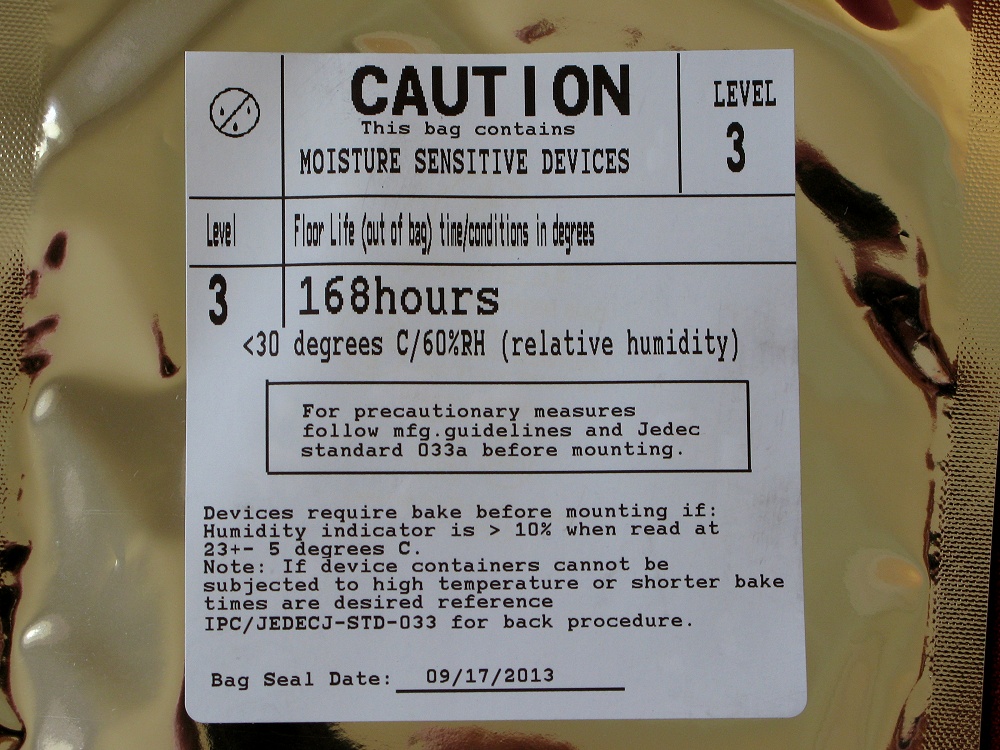

I noticed that the bag with the WM8804 transceivers comes with an interesting warning label. Something for other people to plan for, when ordering parts ahead of receiving the PCB. See pic below.
I've ordered and received the parts already and now waiting for pcb's.
What is to be planned for the people like me who order parts before pcb's ?
Unfortunately Mouser was out of stock of WM8804 and i need to buy it from Farnell at double the price of Mouser.
That is why I made the post. If yours comes in a sealed bag, leave it in until you need it. If not, put it into a sealed bag along with some dessicant (small bag of silica gel that often come with parts). I keep a few of those around for that reason. When the time comes to use them, I dry them out in the oven, let them cool, and pop them into a ziploc antistatic bag along with the parts.I've ordered and received the parts already and now waiting for pcb's.
What is to be planned for the people like me who order parts before pcb's?
Last I checked Newark (in the US) had only 12 of these left in stock, @$3.28 each. At least in Europe, they are more available.
