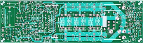

In place of Toshiba-s MJL21193/94 ? I have them home. Allso i have 1000u/100V good elcos, can i use them in place of 470u?
In place of mje350/340 how about C3503/A1381? Much better tr for VAS

corrected to3 version...
studio reference with to3 output transistors,pcb done by member d.veljkovic:

MJL21193/94 can be use instead Toshiba-s, 1000uF/100V instead 470uF/100V is OK. No need to change MJE350/340, MJE-s are in cascode with BC550/560. BC550/560 are VAS transistors and MJE350/340 are only voltage translater.
Regards
Many thanks for your advice, I will set more about 900mV in r10 instead fuse...I suggest set bias to 20-30mA per pair (600-900mV at 10R instead fuse). With 50mA per pair you have over 20W disipation per channel it's too high for your small heatsinks.

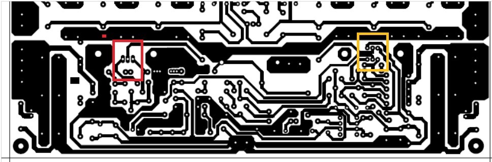

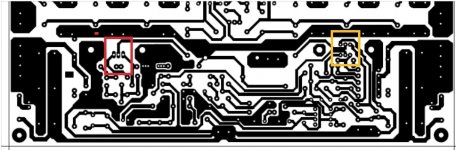

Is it possible to change the solder pads of Q7 and Q8 and make the same size of Q9 solder pads?
I did not draw it 😀
You've been asking Alex the same quastion before... I can only give you the same answer... it is not enough place in that area, unfortunately.
......nice but dual layer , could be done only in factory , not so easy for diy 🙄
I'm sure you could done this on single layer 🙂
Regards
