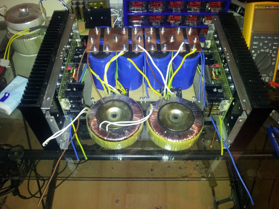

I will always wait for the results of the design of the PCB MM Alex, I like your design. I would not be as good as you are, I salute you.
With 6 pairs of outputs and TEF output stage SR200 can get over 600W/4R (+/-90V rail)

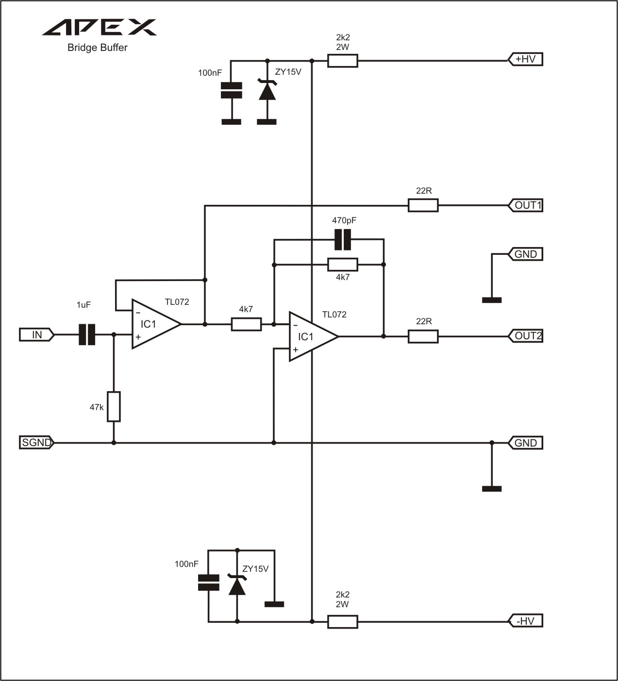

hello sir can any share amplifier bridging circuit

can I use 75-0-75vdc supply
Yes, just connect +/-75V to +/-HV
thank you sir . . . . can I use it for SR200
You can use it with any amp.

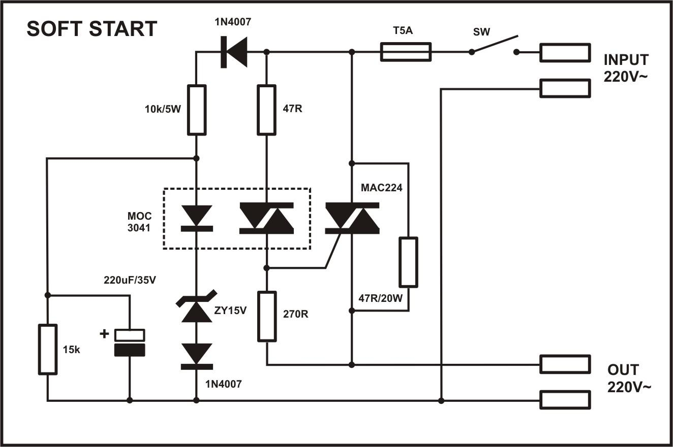

hello sir can you share soft start for transformer with layout for SR200
Hello Mr. Mile,
How many seconds delayed on this soft start cicuit?
Also MOC3063 can be replace instead of MOC3041?
I have few of this MOC3063 and i want to know if this can be use on this circuit.
Should a Zener be added in parallel with 220uF/35V to ensure it can never go over voltage?
Maybe 33V?
Maybe 33V?
Maybe 33V?
ZY15 is in parallel with 220uF and voltage on 220uF can't be over 17V.
Hello Mr. Mile,
Delay is about 1sec. MOC3041,42,43,61,62,63... can be use on this circuit.
Regards
Are you confirming that the MOC30xx allows the existing Zener to protect the electrolytic from overvoltage?ZY15 is in parallel with 220uF and voltage on 220uF can't be over 17V.
Regards
Thanks for the swift reply.
