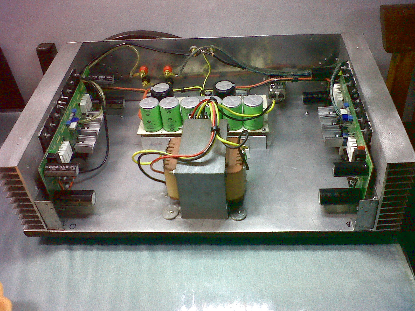

My Sr200 ...not 100% finished, still waiting for proper transformer ....
cool Man 🙂

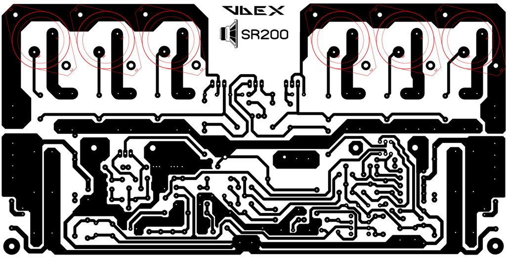

studio reference with to3 output transistors,pcb done by member d.veljkovic:
all better characteristics of to3 transistors are transfered to an amplifier it self,the basic pcb is from alex mm,his version 3.1.
What is the recommended TO-3 output transistors? good layout by the way
that is to be gratefull to alex mm and d.veljko! 🙂
recommended would be bipolar transistors with same or higher voltage,power and hFE. i believe that Mile-APEX could give a more specific list of transistors,i don´t have that experience to do so...
Nice amp with regulated PSU,
Nice work, I suggest to use MJE15024/15025,

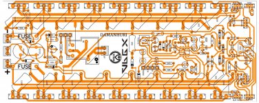

Thank you so much Mr. Mile Slavkovic...very good design you have...I still need your advice...
Best Regards
I suggest set bias to 20-30mA per pair (600-900mV at 10R instead fuse). With 50mA per pair you have over 20W disipation per channel it's too high for your small heatsinks.

nice PCB ,what is the out put power in (8ohm,4 ohm, if it can drive in 2ohm) this you'r new B50 pcb layout with 9 pair power transistor & what is the +/- DC v
