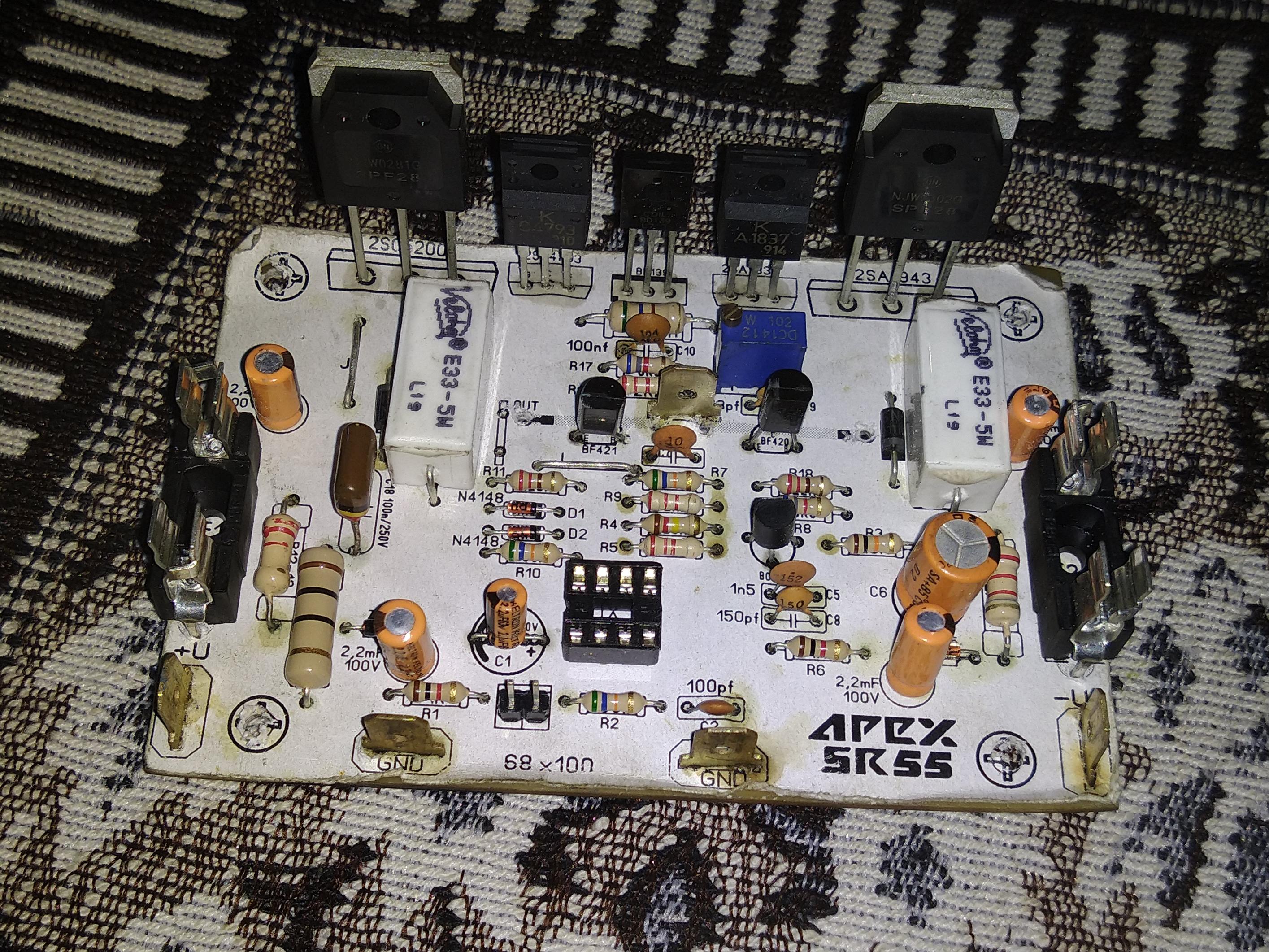

Apex sr200 white pcb .Thanks miles sir
Sunny make sure that this transistor leds are not touching the power rails uyyyy! dangerous
its not touch. its space 2 mm

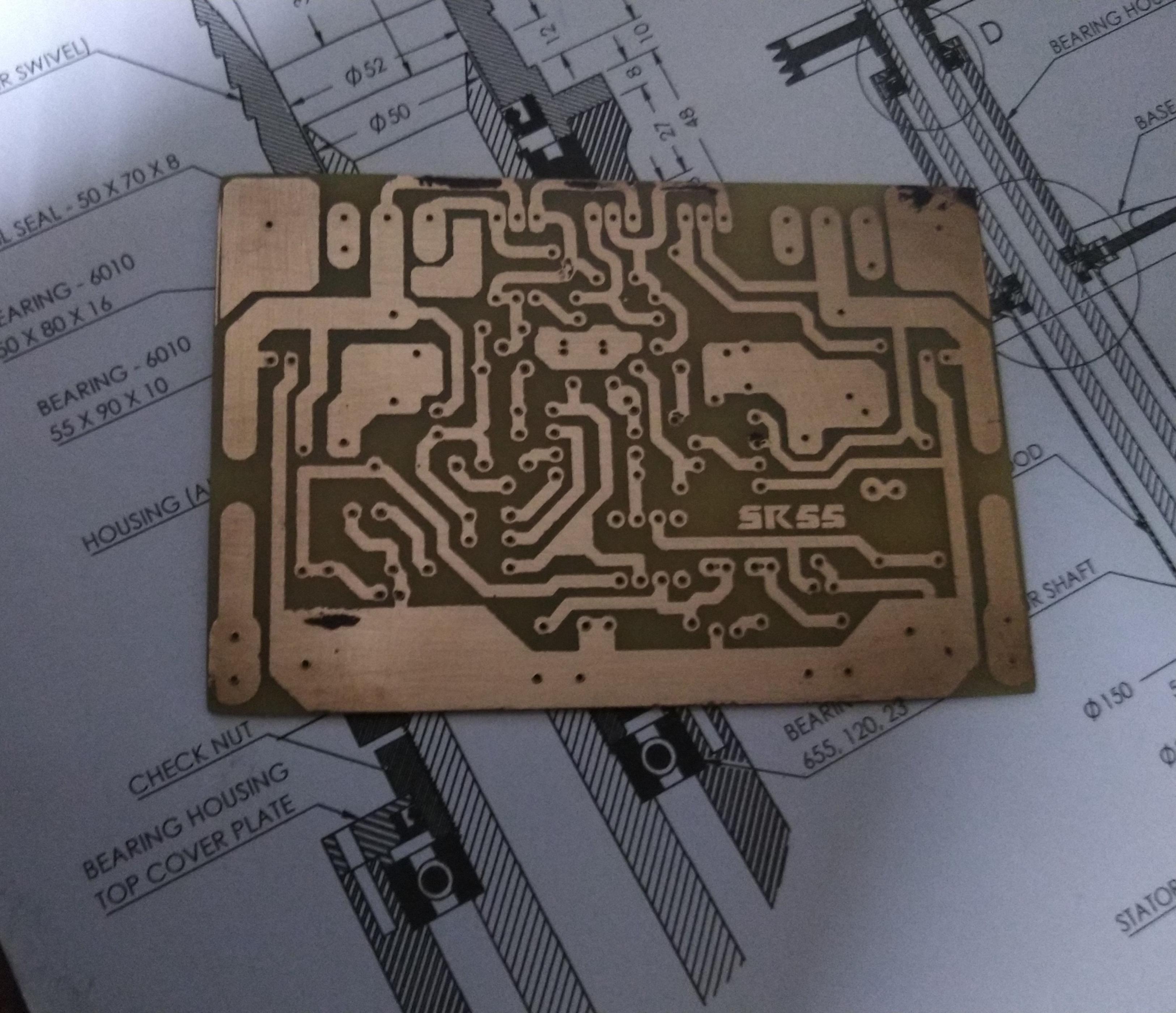

Apex SR55

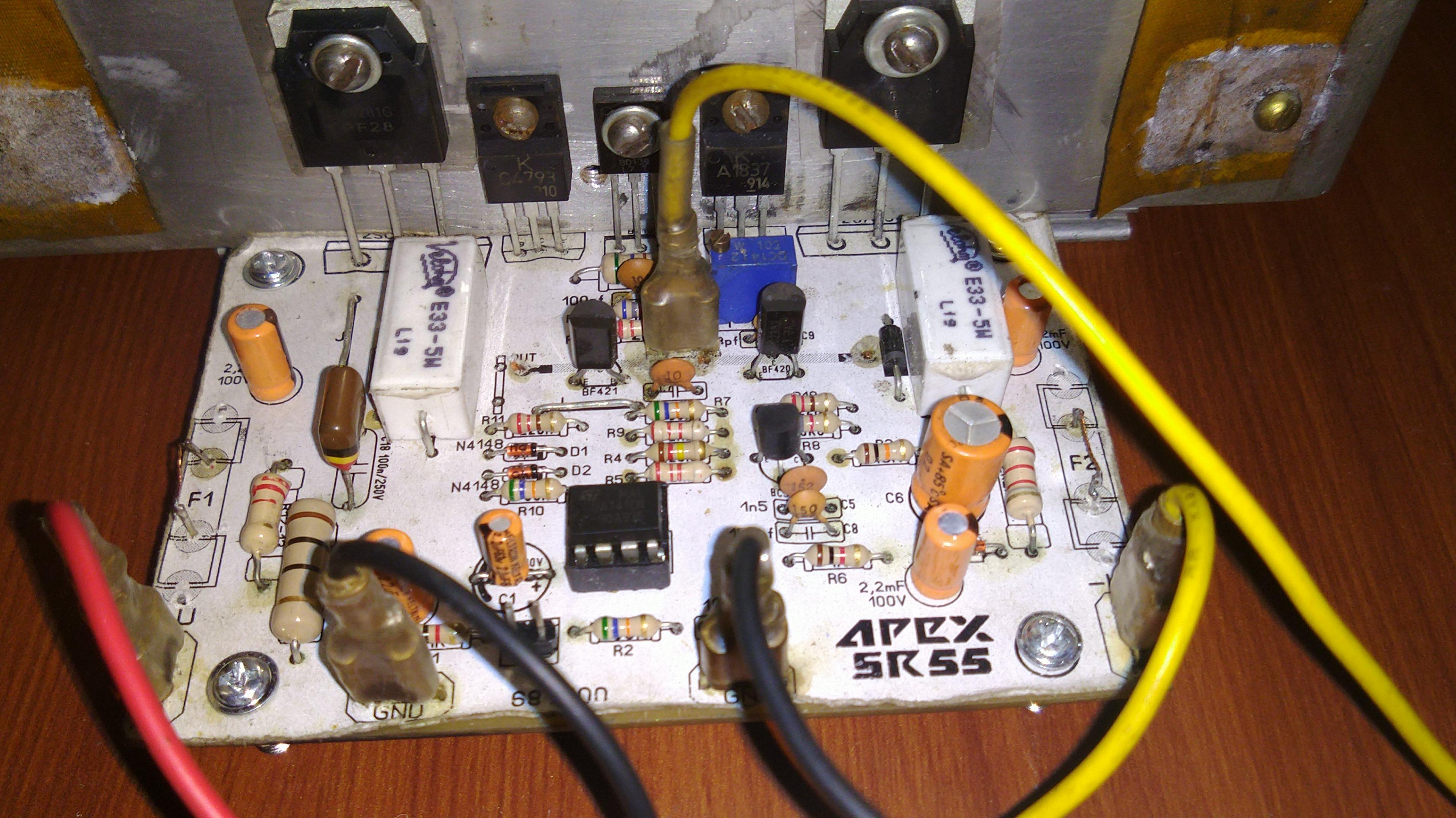

Finally SR55 complete, its working fine, sound very nice, every tone very clear. Operating volt +/-40v DC, bias 8.5mv, but DC little high from my expectation 20-30mv. is it ok?. Thanks Prasi, Gannaji help me on this PCB and special thanks Mr. Mile for this Amplifier.

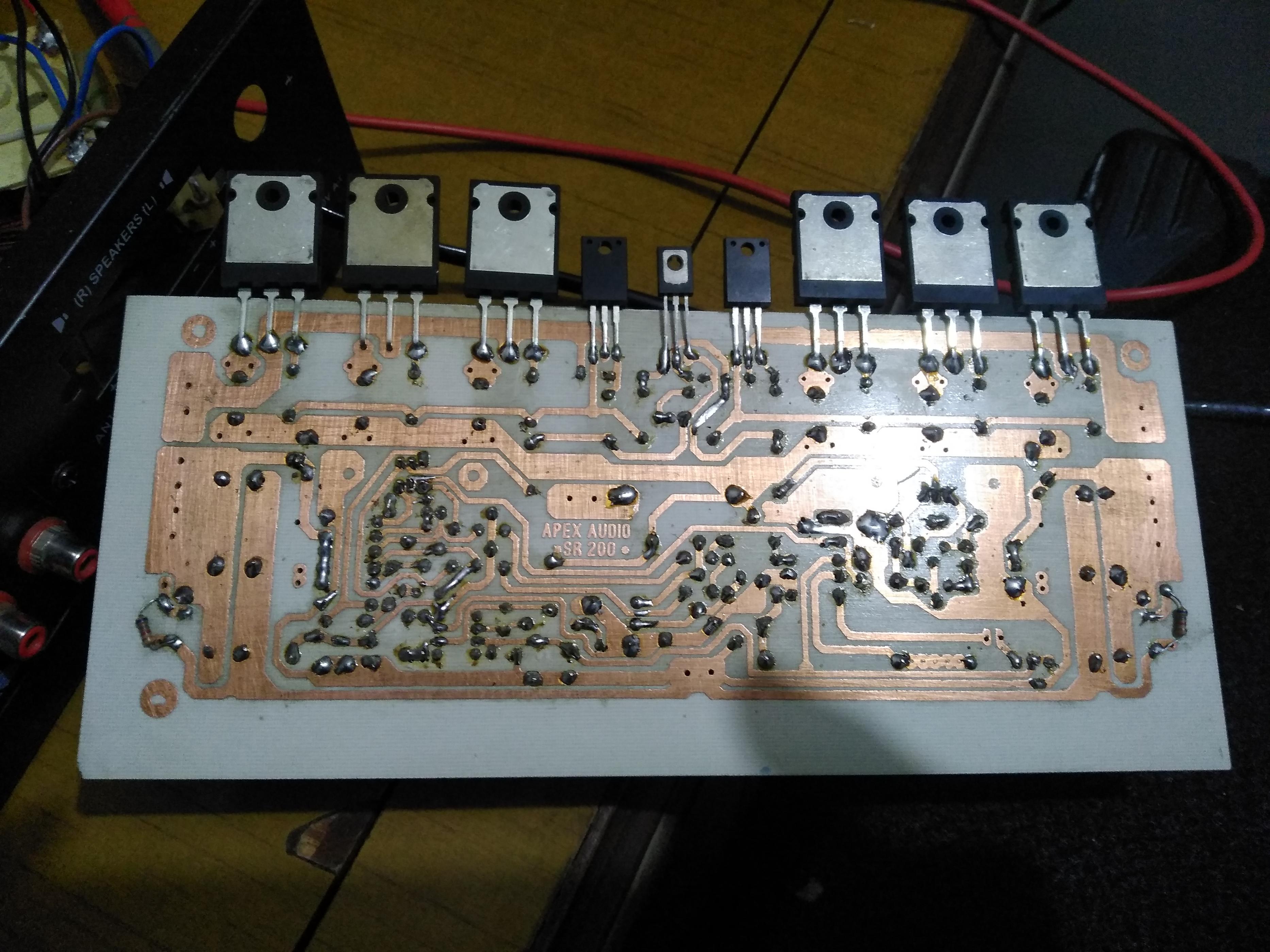

hi, to all experts here i want to ask if it is posible to use non-darlington pairs for SR20 like c5198,a1941 or TIP122,127 because i have those at hand and it was no use. my plan was to make an amp for my little 5" altec sub speaker and use it as full range to be used for my desktop

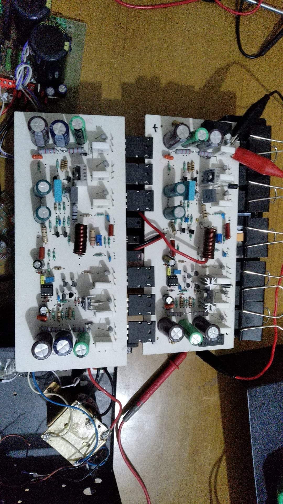

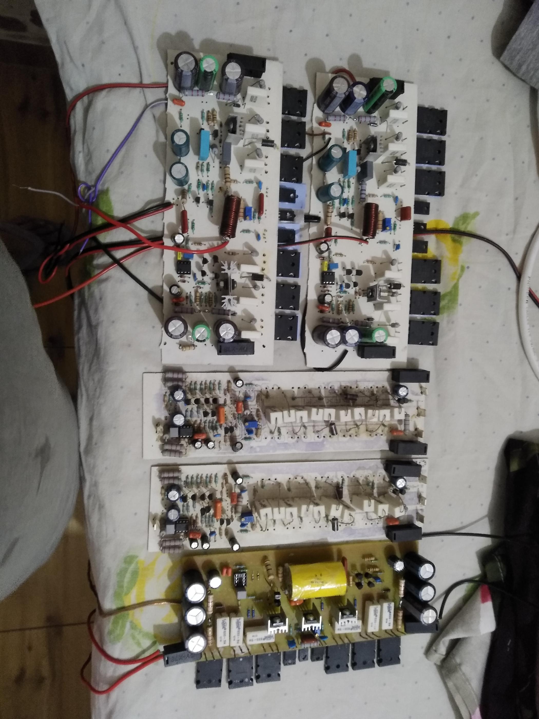

For those not aware of the sr200, why so many boards?
It's my favorite amplifire.
He built 5 channels of the same amplifier.
