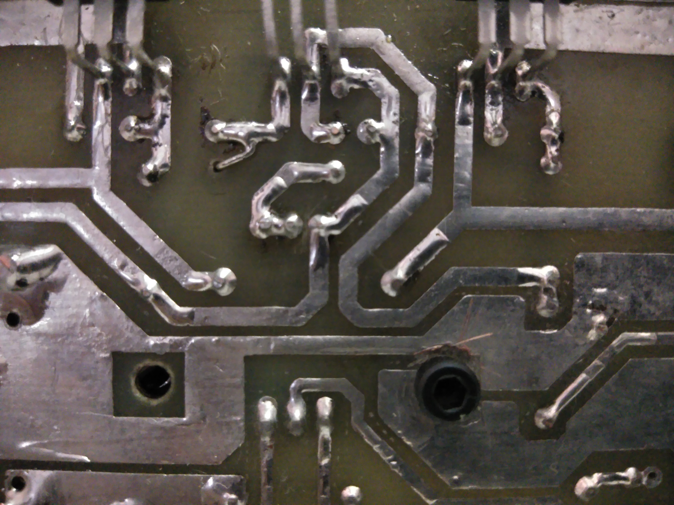

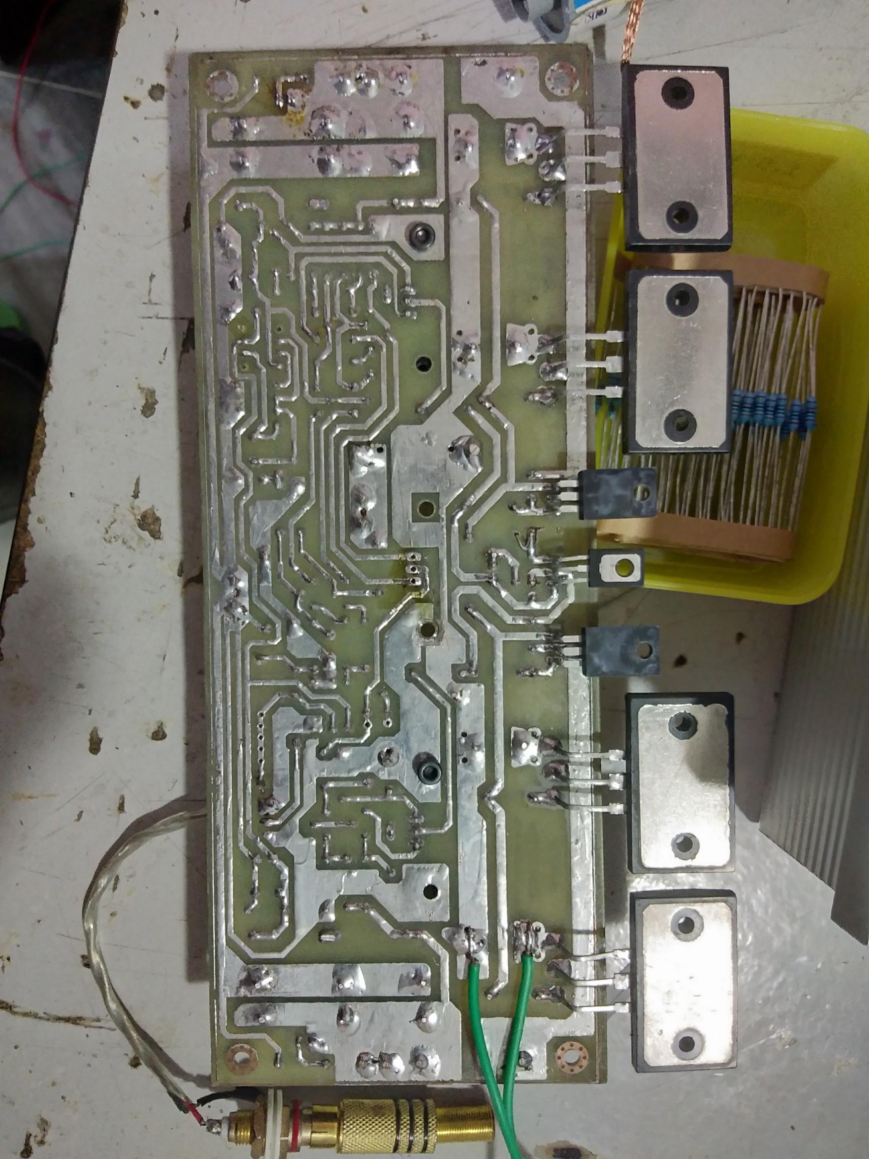

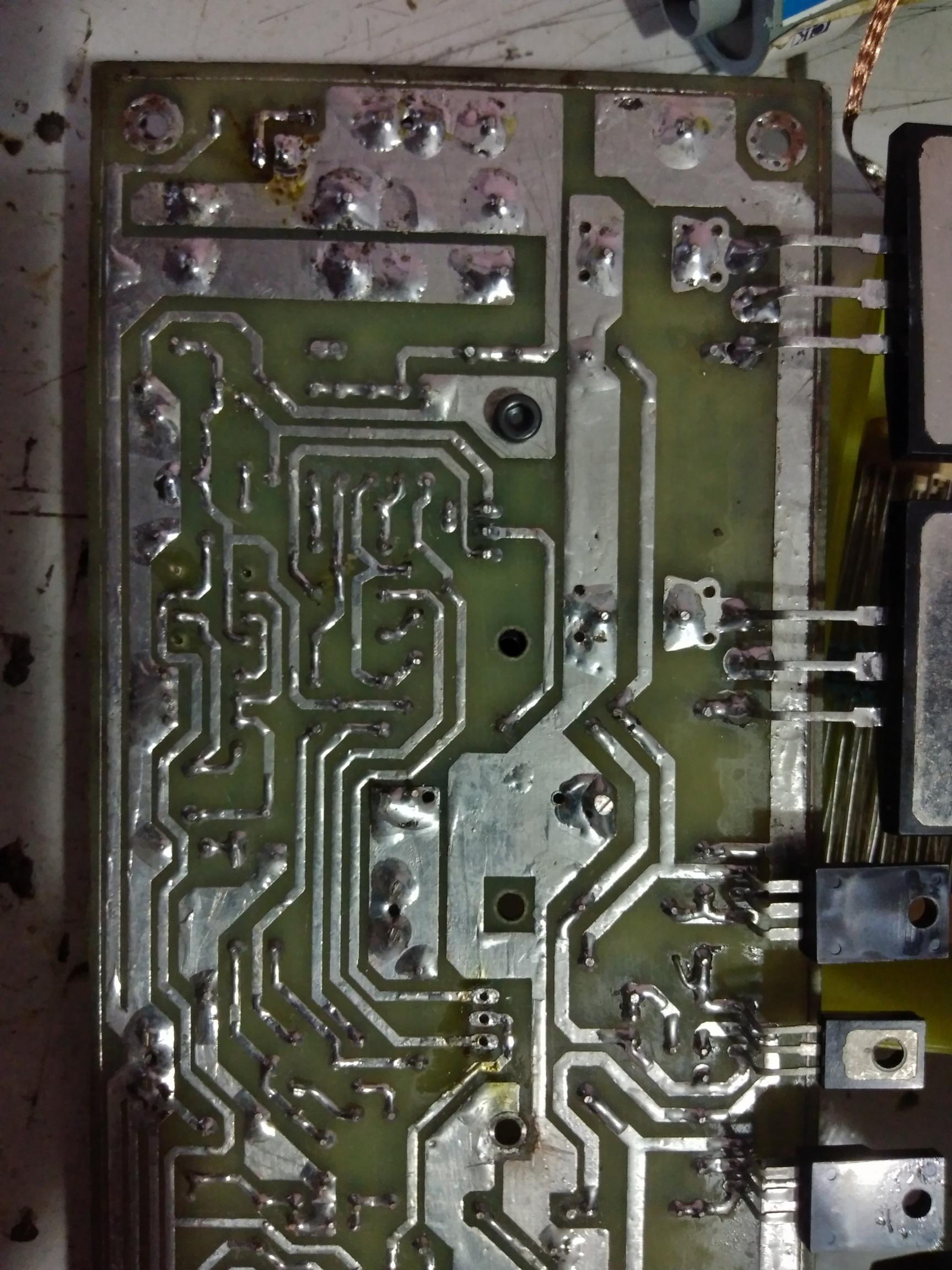

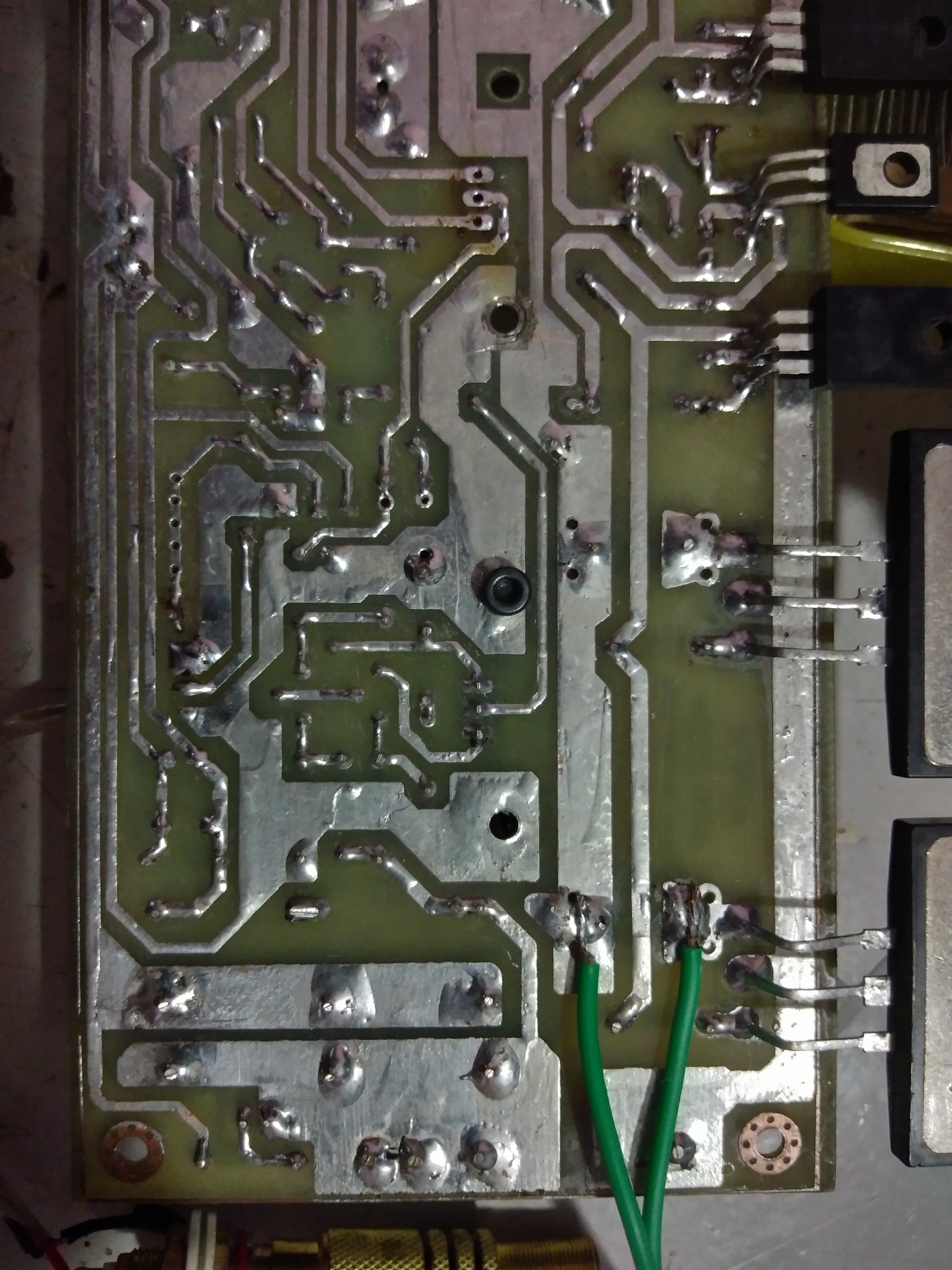

Today I powered on the PCB. It is working, but i am unable to set the Bais Voltage which is 20mv Across the 0.33/5watt resistors. I turn the trimmer ACW / CW (full both sides) but the bias voltage is not changing. The voltage across the 0.33/5W resistor i am getting is just 4 mV due to which the sound is not clear.
I am attaching the PCB which i am having.

I am testing this amp with bulb in series. I was doing trouble shoot. Now i gave a grid to speakers by touching the signal in and there was a good grid in the speakers but the bulb started to glow so i switched off the amp.
Now when speaker is not connected the bulb is not glowing. but with speaker connected the bulb is glowing. I am really getting mad. I am thinking to itch the PCB board again. This version was Sanken Transistors V 3.3 I dont think anyone has made the version 3.3 with sankens.

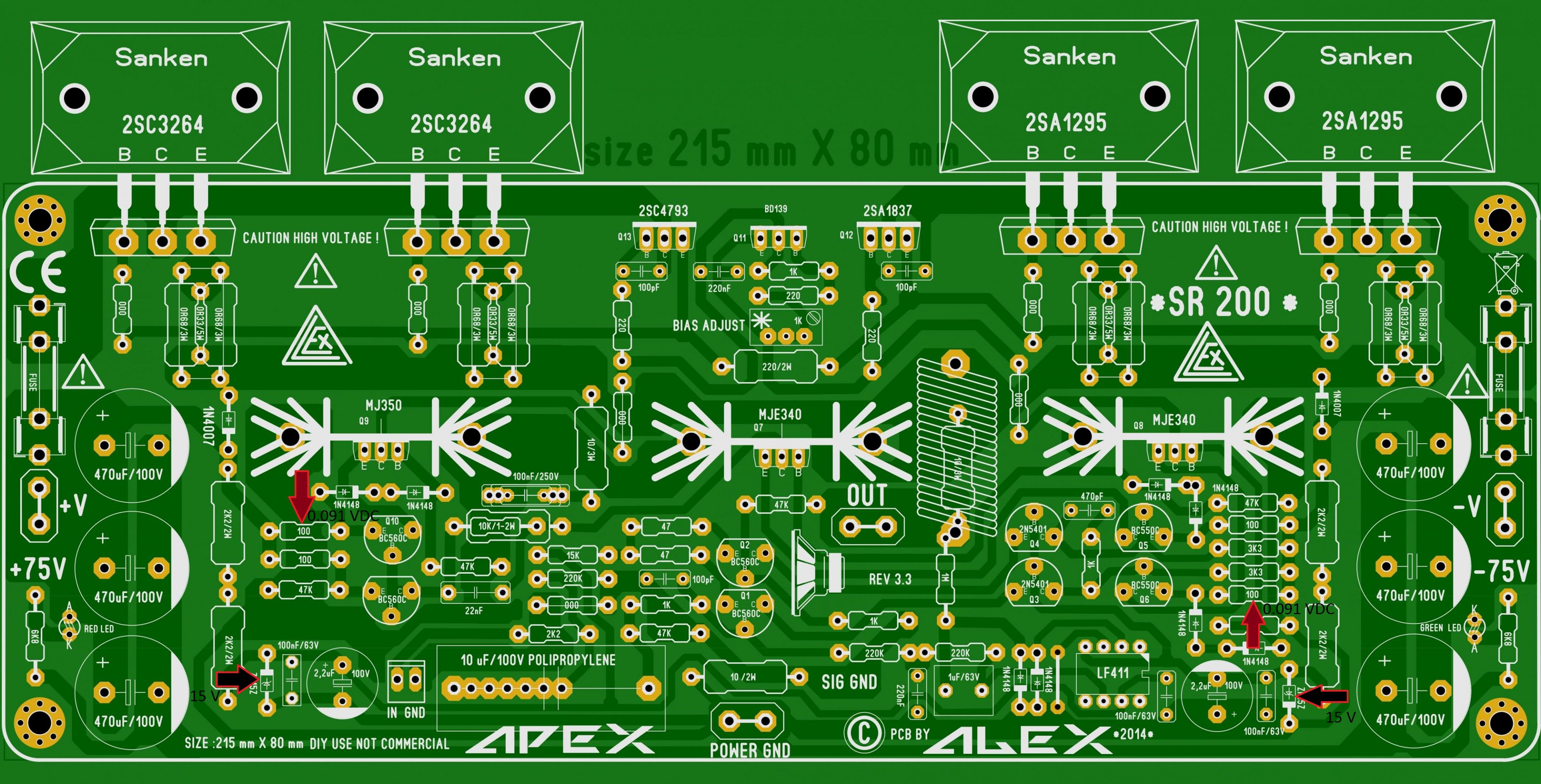

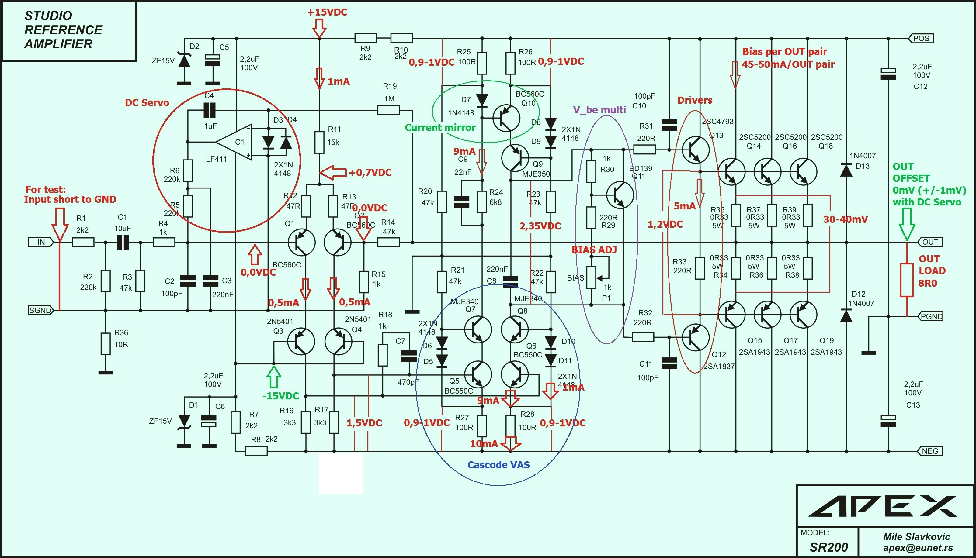

I am getting 0.091V Dc across these resistors. I am marking which resistors i measured in below image.
OK, that explains why you can't set the bias.
The VAS current is way too low. According to your measurement, you've got 0.091V/0.1K=0.91mA
Taking in account, around 1mA goes away through the diodes, you've got nothing left to drive the OPS. Correct voltage over R26, R28 would be some 0.6-0.7V (almost 10 times higher than you have now.
One more point - the fact the bulb starts glowing as soon as you connect the load tells me the amp starts oscillating with the load. But that may be caused by the issue mentioned above - too low VAS current and as a result no bias in the OPS.
