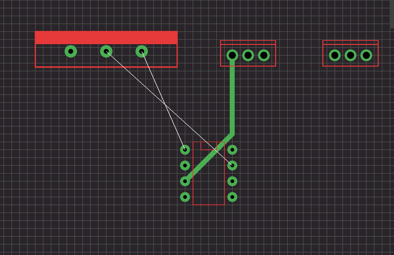

A sprint file is very difficult to check as every component and its connection is to be checked. Every thing in the schematic and only those should be exactly like that in the PCB.
This will be easy to check if you use a CAD program that helps in that check. Welcome to DipTrace !

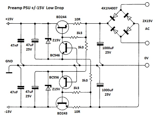

Hi Miles,
What components need to be change to regulate +-15v for preamp?
Hi Miles,

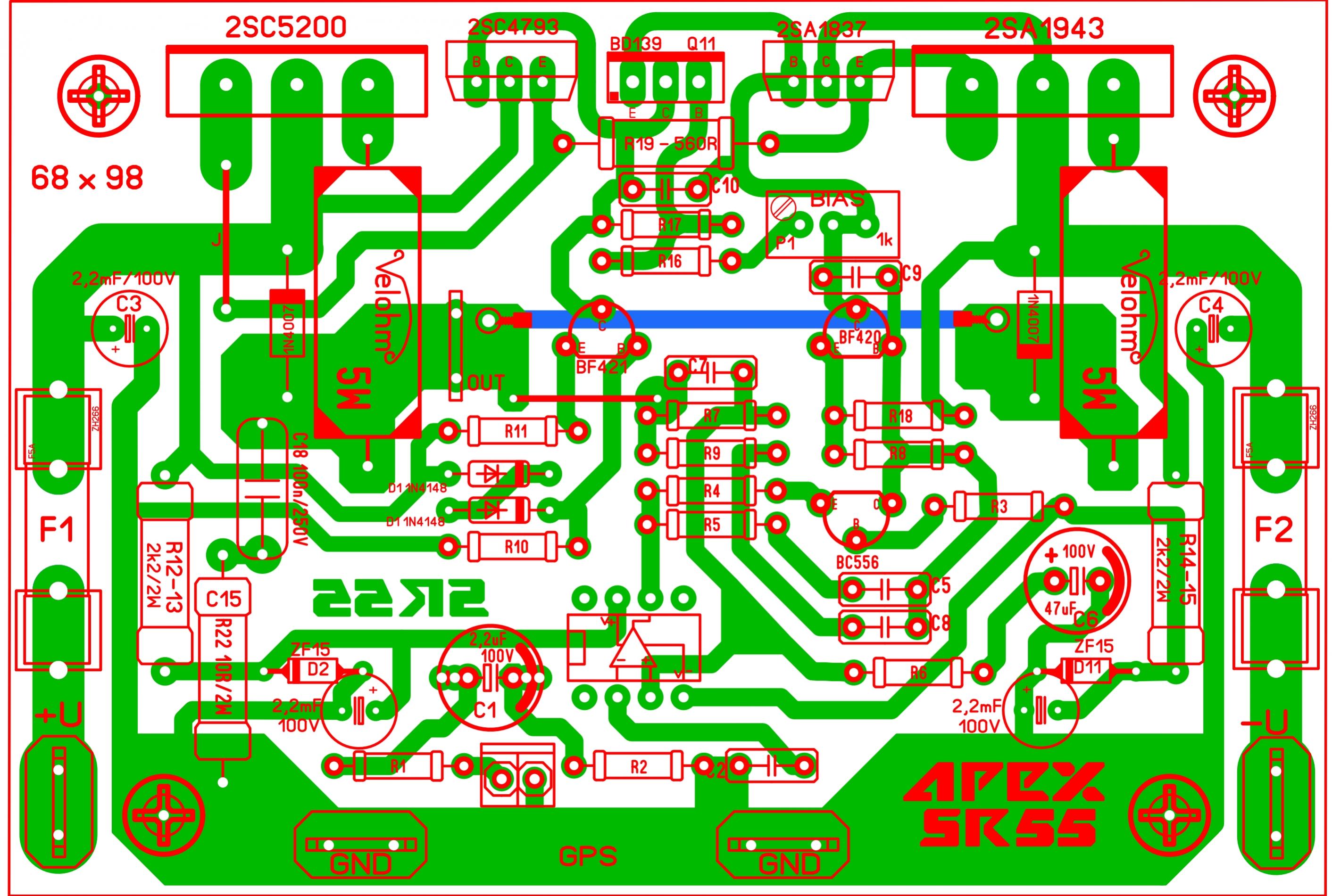

Hello Gannaji, I found few error on my last SR 55 PCB layout so i do some work on new SR55 layout. Please check this one. All track and connection as schematic.
Regards

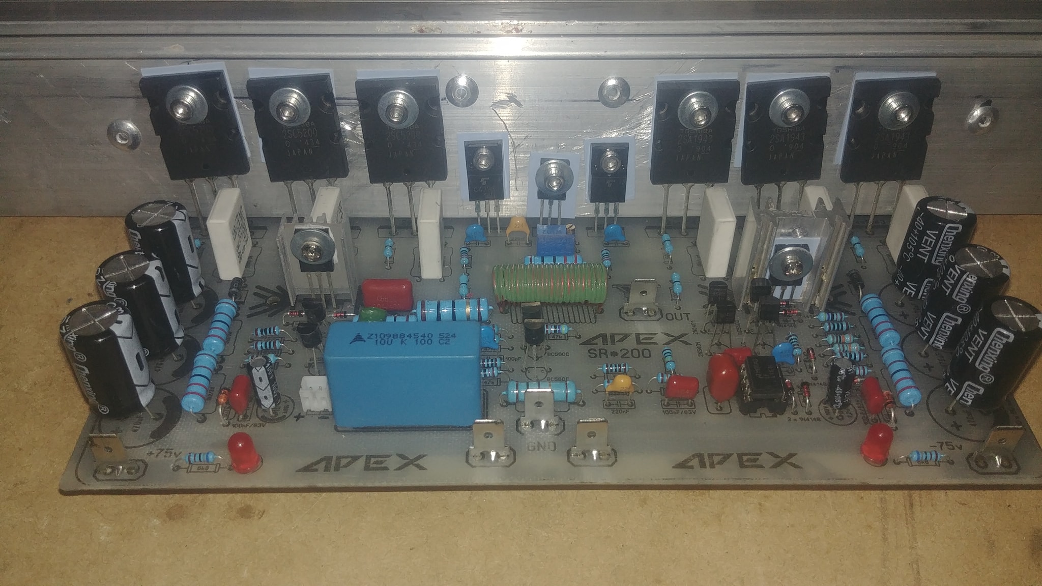

Tanks a lot for kind words , I'm glade to help you Apexaudio and viki_v2 . I have modified , an old PCB to fit Sanken output transistors . and PSU
Regards Alex .

SR200 Studio Ref Amp for large studio monitors.

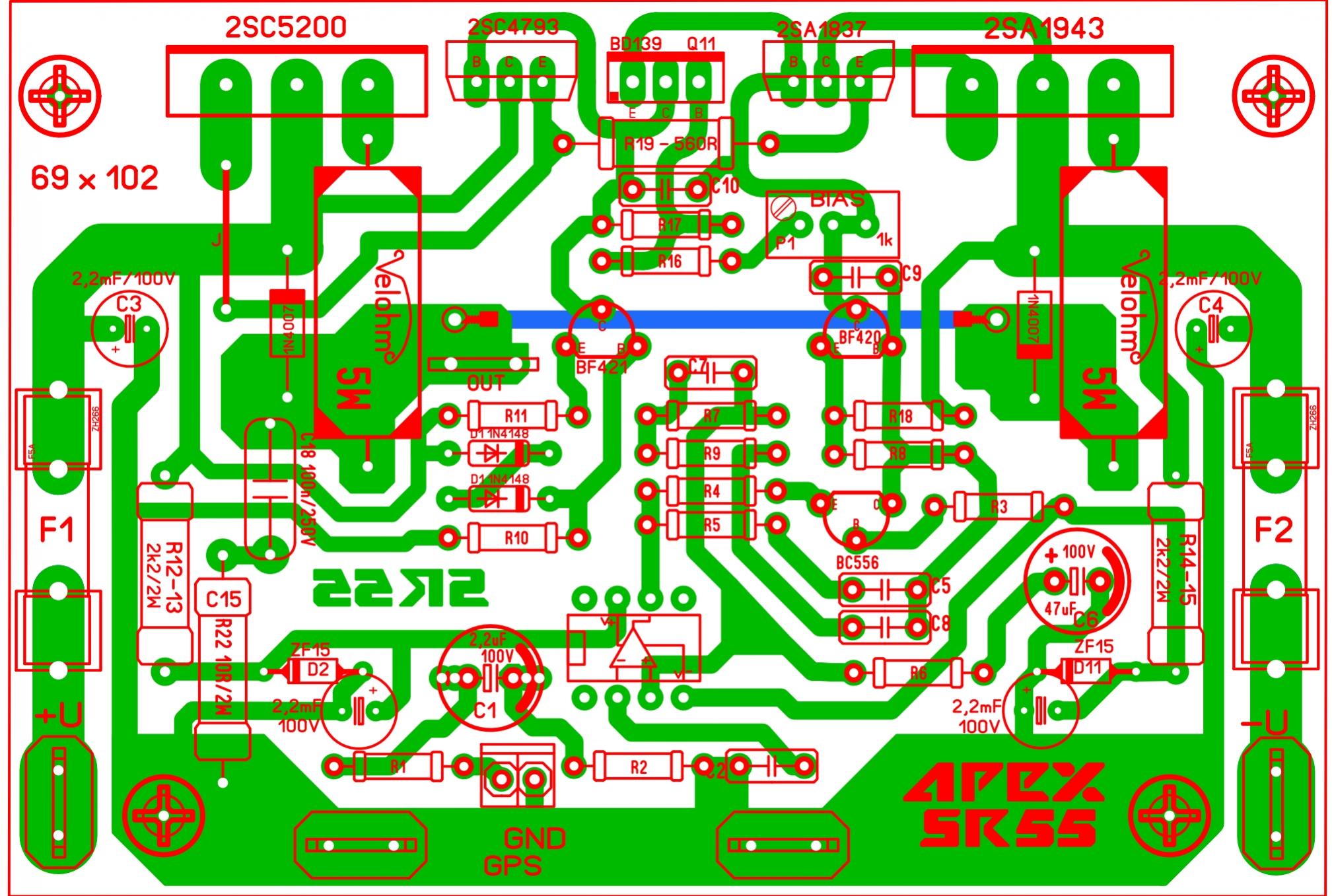

Regards
Regards
feedback take-off point is missing, i think....
Thanks Prasi, yes I missed the track. is that ok with jumper?
Regards
Jumper is ok.
But to make a point, such mistakes are easily possible with a program like sprint which doesnt have any connection to sch. So I use sprint only for copying layout if any.
So its really difficult / nearly impossible to check the layout connection by connection.
One more thing, I think Junction of C1/C2/R2 should be connected to pin 2 of opamp...
regards
prasi

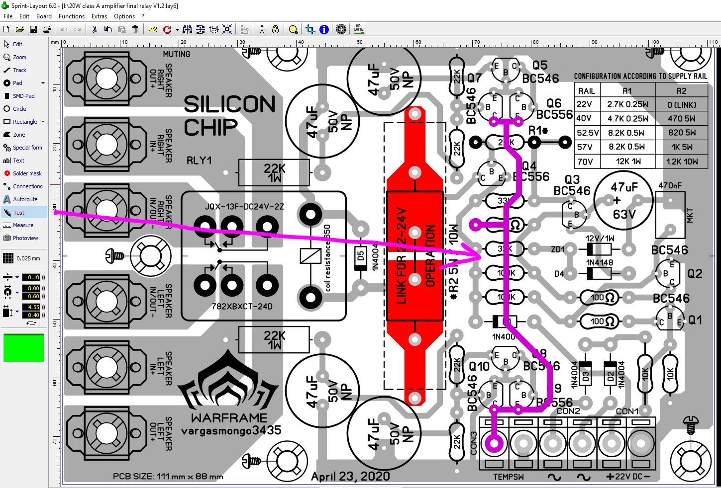

Diptrace and Eagle are very different than Sprint. Sprint is more of a drawing program. It does not relate to a schematic at all. It does have a test circuit though that will help check for troubles. You have to use through hole pads where you have jumpers to keep the circuit attached. I have tried to learn Eagle and Diptrace but so far not successfully.
I think Sprint also have connection mode as like schematic. I made few mistake in this layout, I don't use
Connection mode in SR55, therefore these mistake are normally for a unexperience person like me.
