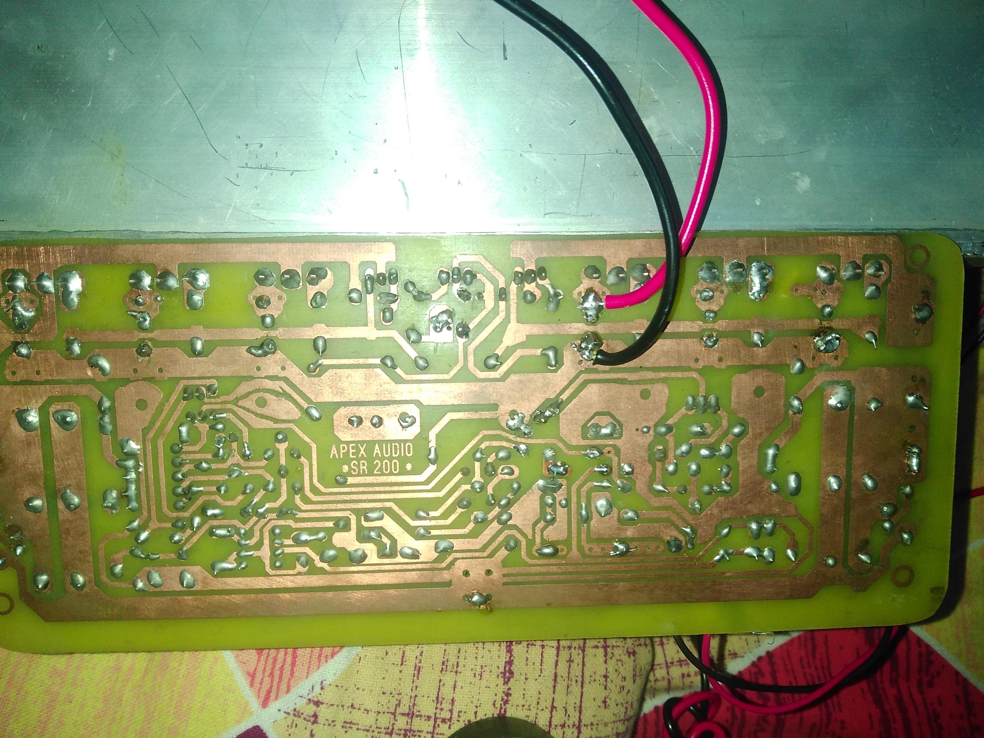

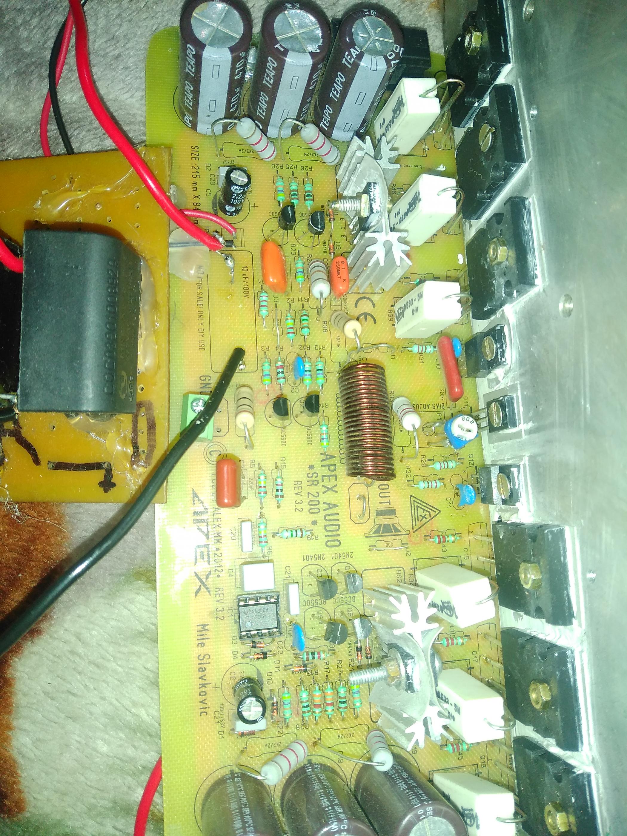

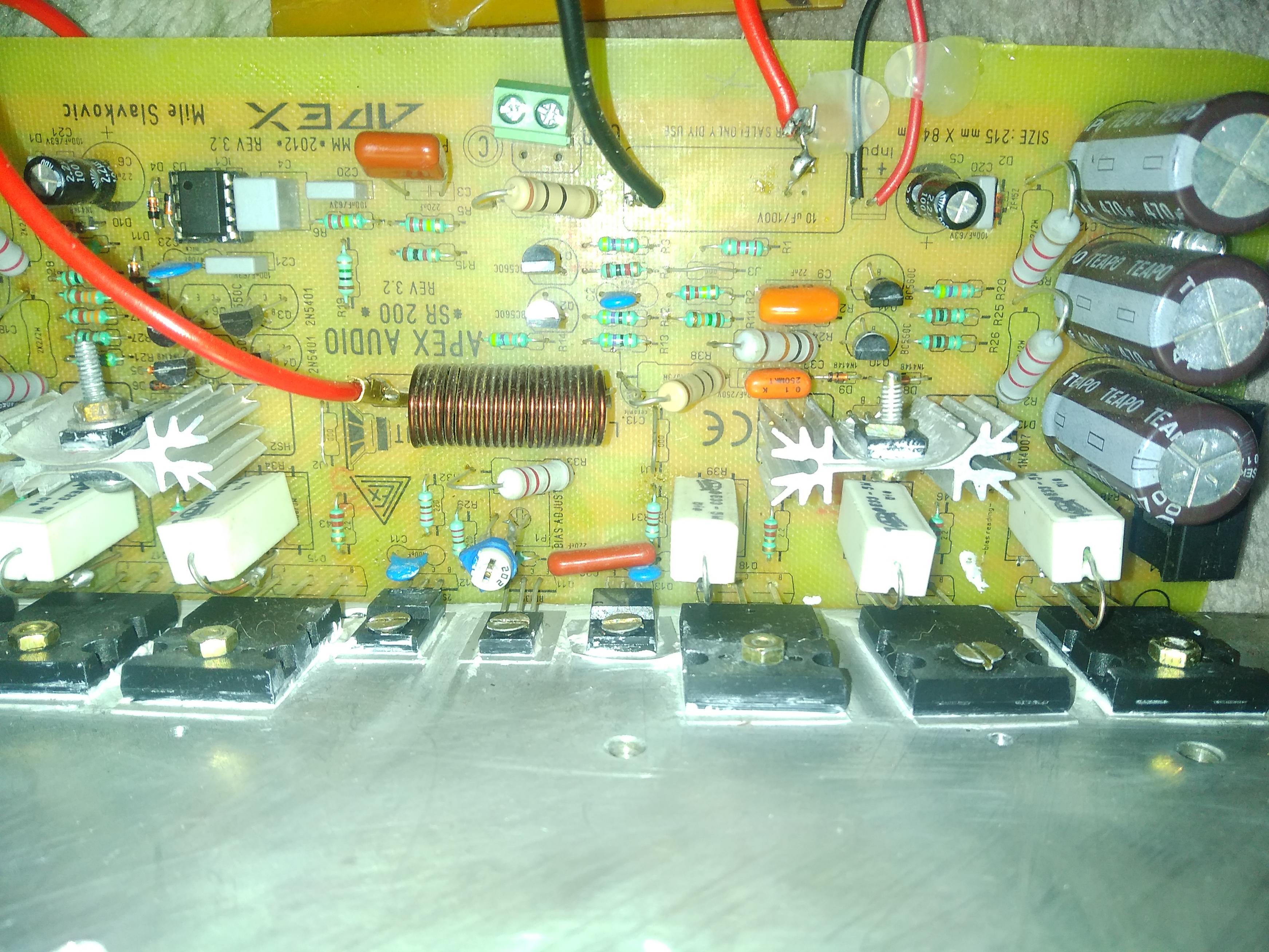

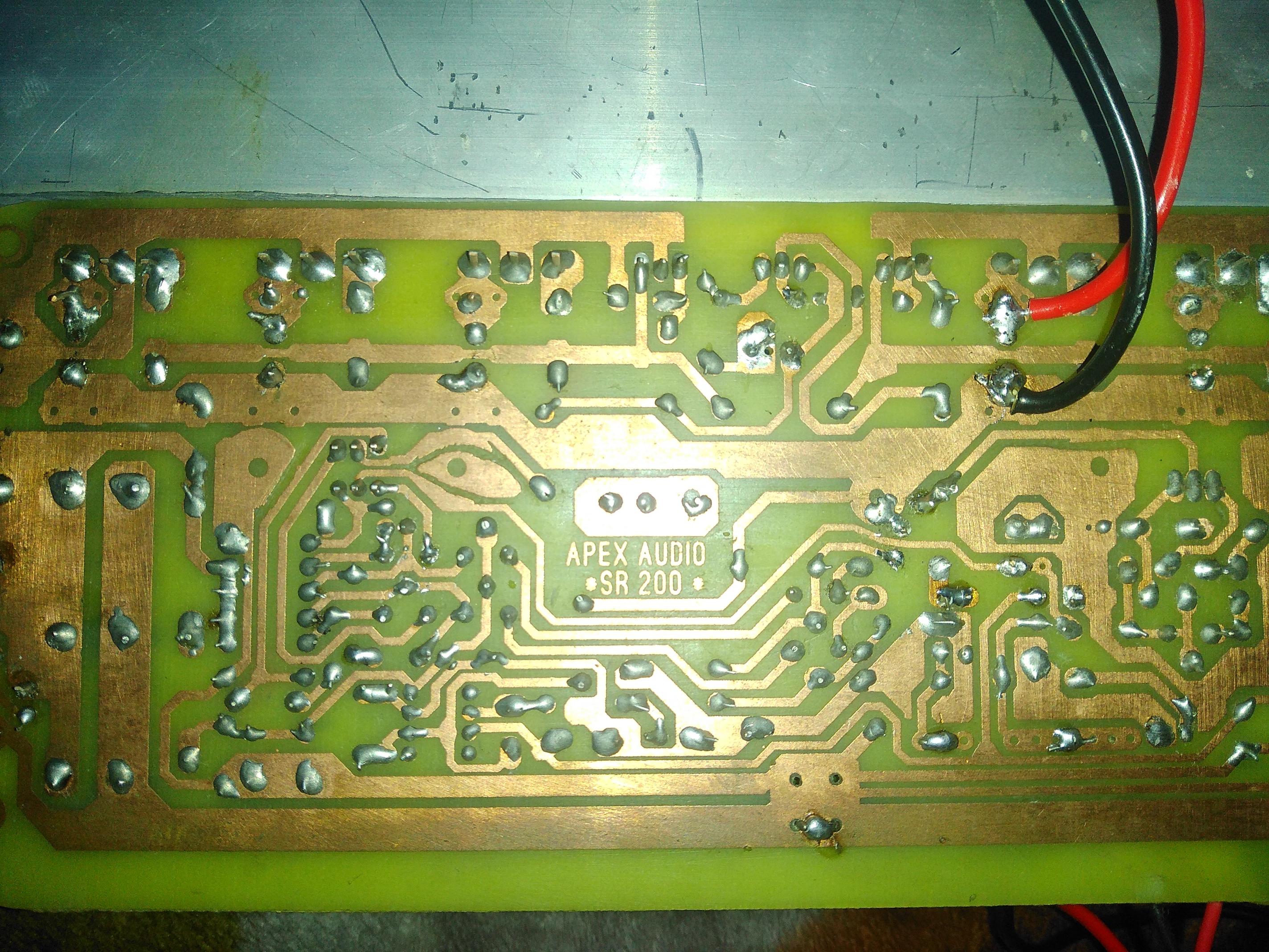

Greetings Sir my R23 24 is 47k .I set bais 26 MV.
Here is pictures

Here is pictures
OK, everything looks good to me.
If I understand correctly, the main concern is lack of bass at the output, right?
Assuming the PSU is powerful enough (some 400VA transformer for both channels or at least 2 x 200VA transformers for dual mono), the only thing that can cut the low frequencies is the DC blocking capacitor at the input.
As I can see, you're using a huge capacitor placed outside the board.
Can you test the amp with just very simple - like a small 10uF electrolytic?
