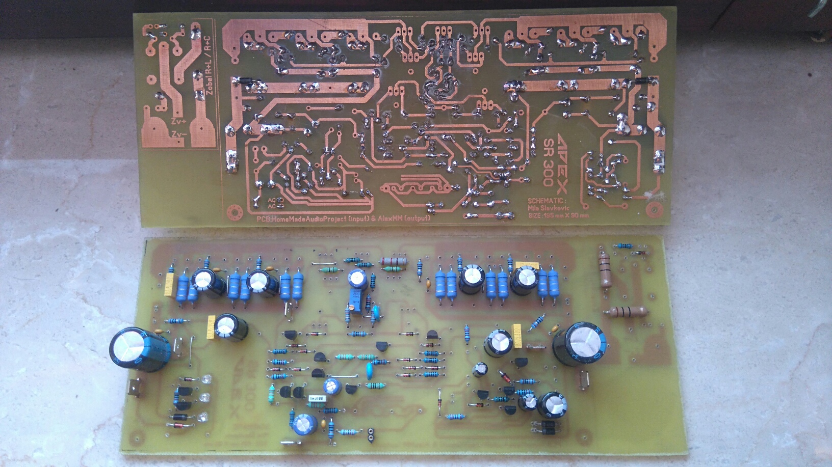

Hello guys today I am very upset.becouse my sr200 is not planning good .I try my best .after reading Dy form. When input is open then burrrrrrrrr sound coming. And feeling less bass.my bais is 26 MV both channel .I give 45 -0-45 ac it's make 63 -0-63 volt dc 8 amp supply.i using good quality capacitor.15000uf 80 volt.i done everything like attached input ground to power ground.but nothing working. Can any I any 1 help me . I spend to much �� on this and time too

Hi Sunny,post the schematic that is used.
Sunny, also - when you say "nothing works" - what do you mean exactly?
If I understand correctly - you have managed to have zero offsets and 26mV across the outputs' emitter resistors. Is that right?
Is the "brrrrrrrr" sound the only problem?
Schematic (as Thimios already mentioned) and some build photos will help a lot.

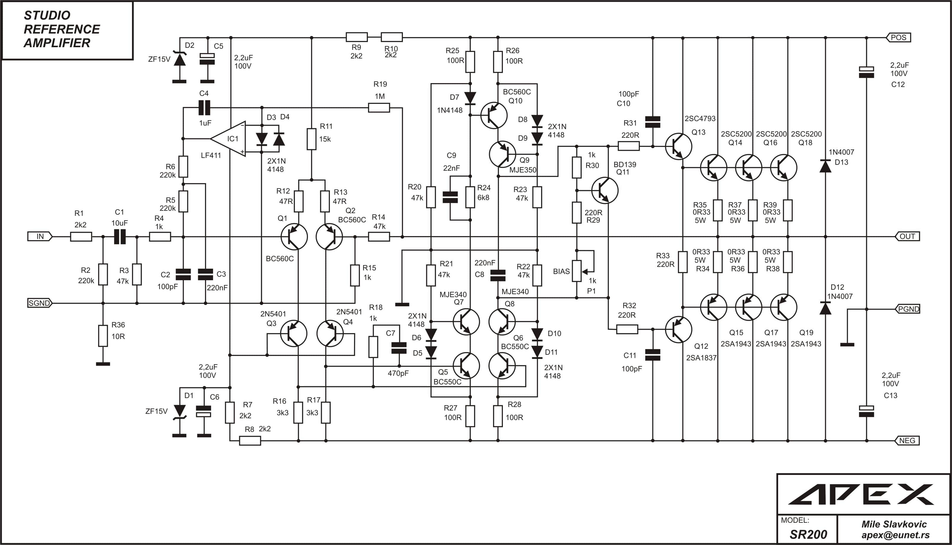

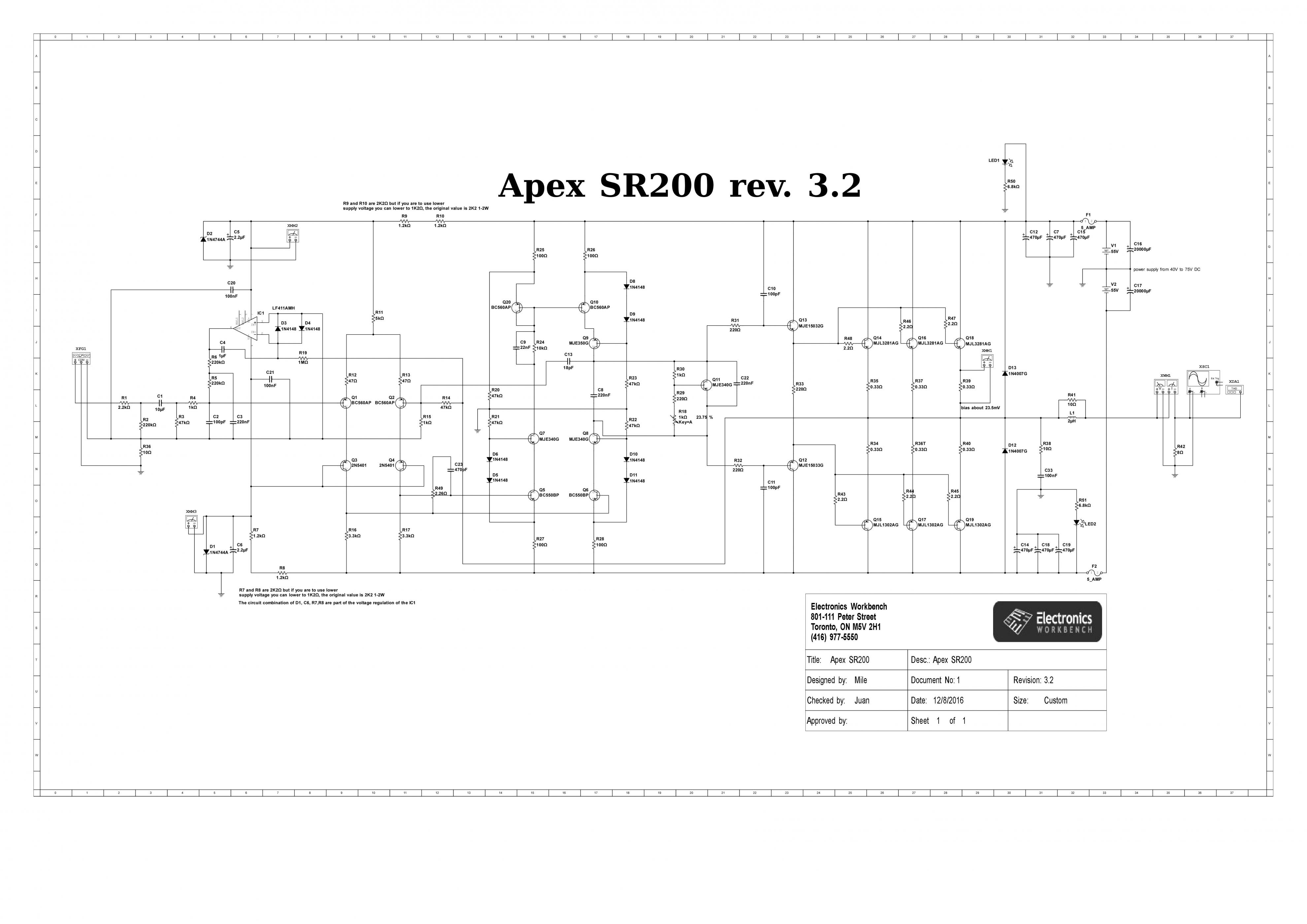

I see the symptoms of oscillation and I probably see the possible reason for it. Attached is the original schematic published by Apex. Note the values of R18 (compensation RC, 1K) and R11 (LTP tail current, 15K) - values on your schematic are different. I've got no sim file to test the parameters, but R11=5K, as stated on your schematic, leads to significantly higher LTP quiescent current, leading to much higher VAS current. Also, R18=2.26 ohm results in different compensation parameters, potentially leading to reduced stability. Is there some good reason for changing the original values?

that be my fault I see that he use the simulation file I did a long time ago I did those changes for me to try out but that create a problem to him I apologize for that "this is why I stop coping other people work" a margin of error is higher becuase of that I'm really sorry about that 🙁
Yes vzaichenko, few value are change in schematic and on board,
1. R18 1k same as original schematic
2. R11 8.2 k is lower from original 15k and bigger from jaun schematic 5k.
3.what about R24 10k (on sch. 6.8k) and 18pf capacitor
Now may be sunny can change the with original values.
Regards
Gurpreet
