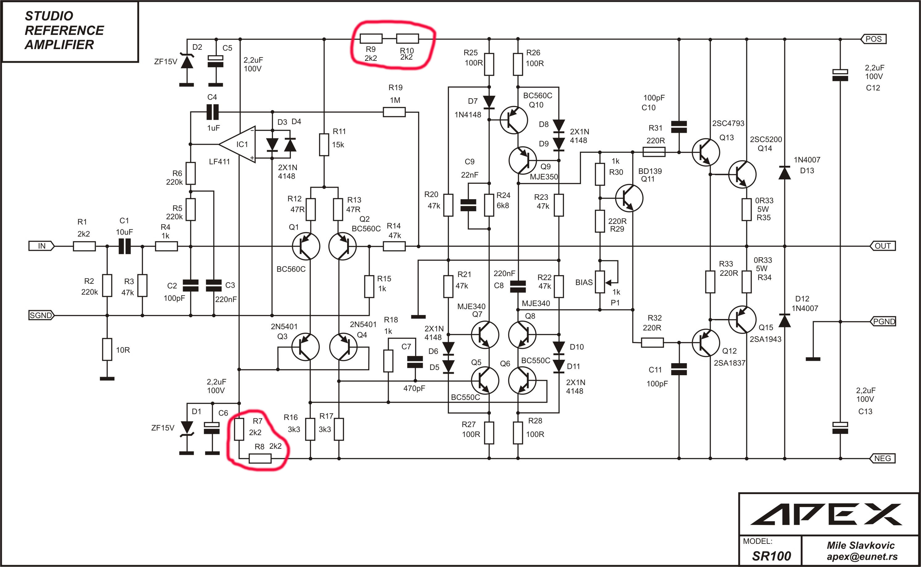

Use 1k/2Whi mr mile🙂

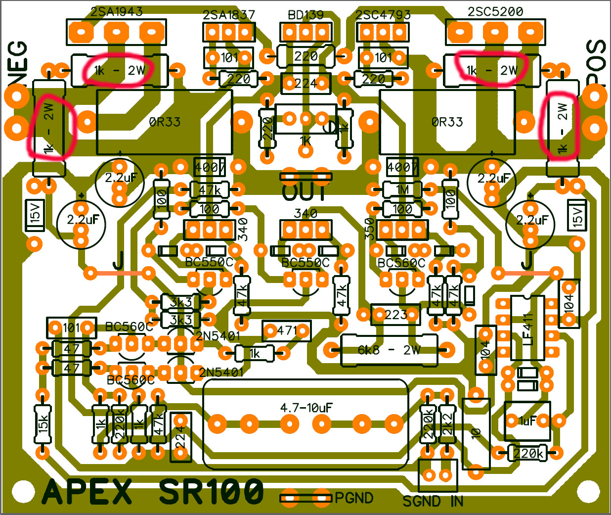

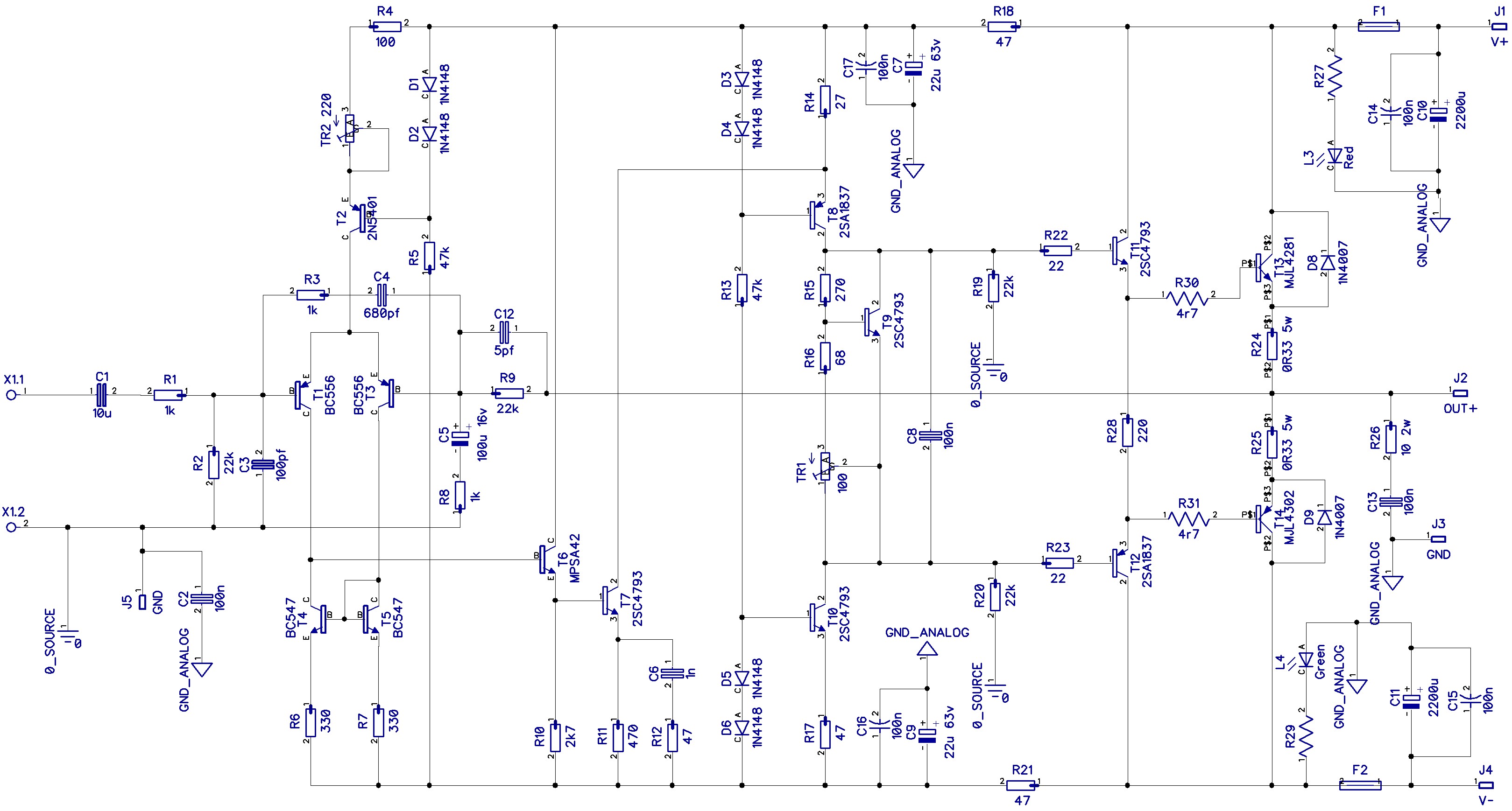

i want build sr100 ampli version john bali
he use 1k resistors instead 2.2k in his pcb
which one is correct?(2.2k or 1k?)
please attention to red circles in photos
my traffo is 2*33v ac

in sr100 can i use bc547 instead bc550 and bc557 instead bc560 without any problem??
which one regulated psu is Appropriate for my teraffo an sr100?

Use PSU10 pcb from post #1861 for stereo but with 8V2 zeners and 50V caps.You can use BC547/557.

i have 4cap 18000uf 71v.can i use instead 10000uf caps in psu10?Use PSU10 pcb from post #1861 for stereo but with 8V2 zeners and 50V caps.You can use BC547/557.
Regards
in my local city i dont found bd241/242.can i use tip31/32 instead them?
18000uF/71V and TIP31/32 is OK for PSU10.

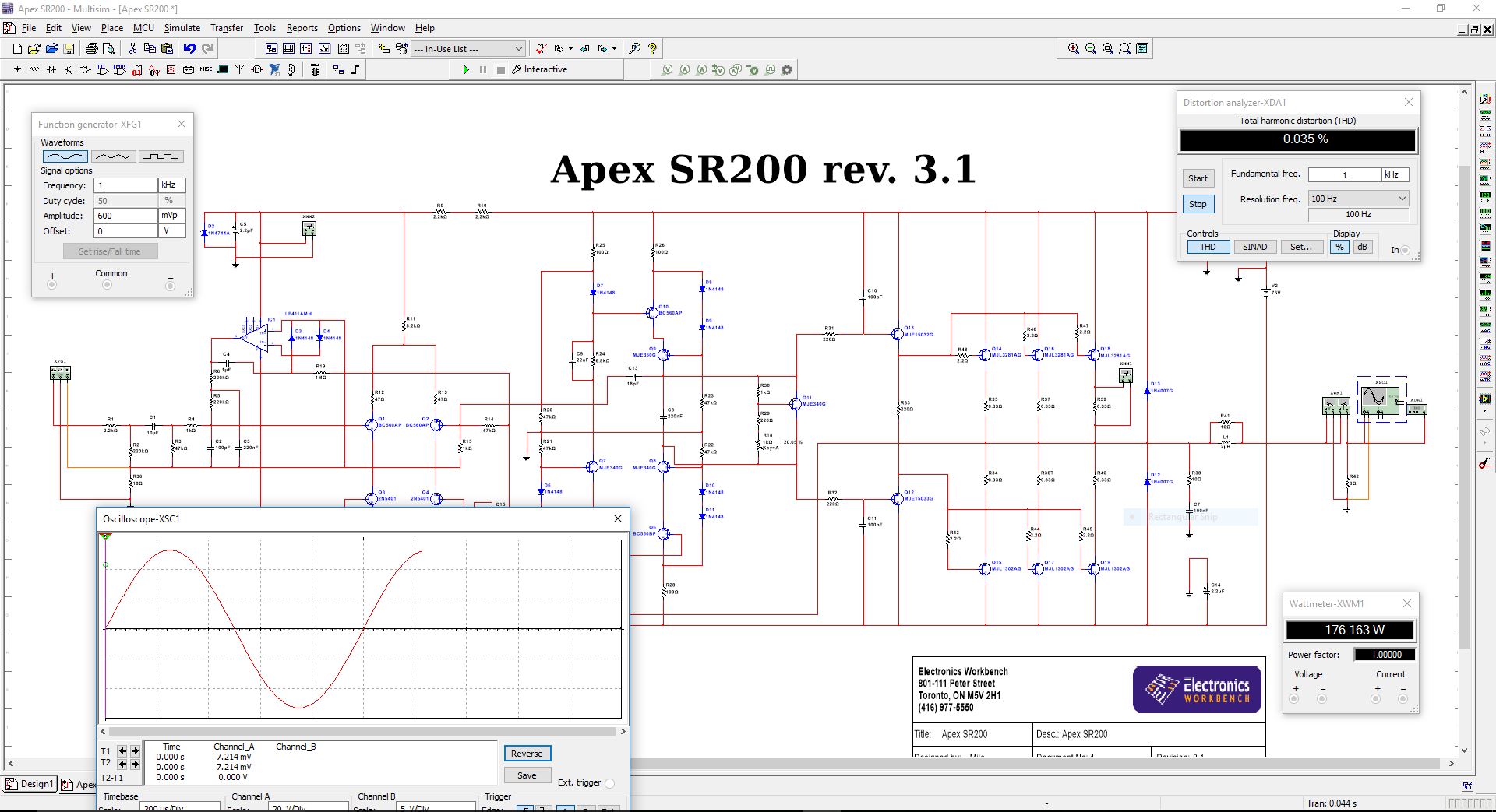

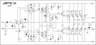

hello guys I'm studying the simulation of the Apex SR200 what is the latest schematic that has all tweaking I mean final schematic so far I simulated using this schematic

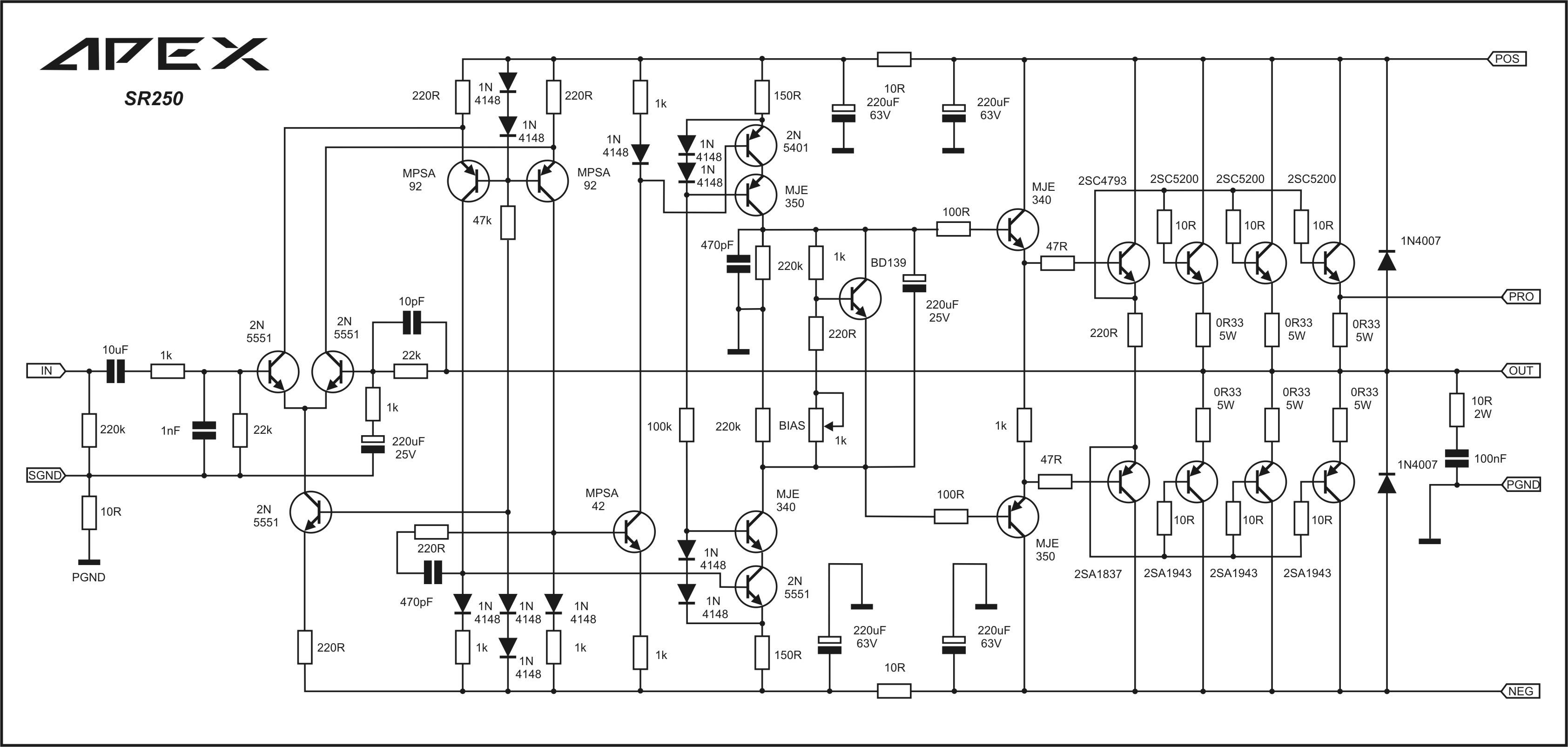

Go to SR250
Difference betwen b500 and SR250 please
Hi Apex !
Refer to POWER OUTPUT. What will be the difference betwen B500 with 4 pairs transistor and this SR250 with 4 pairs fo transistor too ?
1. Will they ( SR250 and B500) give the same power output ?
2. Will they give the same quality sounds ?

SR250 can work maximum with +/-60V DC rail, B500 with +/-80V DC. With same rail voltage power will be same but sound must be different. SR250 use folded cascode VFA topology, B500 use OP amp and CFA topology...
with 5 pairs final can i give +/- 90 Vdc with 10A for stereo ?SR250 can work maximum with +/-60V DC rail, B500 with +/-80V DC. With same rail voltage power will be same but sound must be different. SR250 use folded cascode VFA topology, B500 use OP amp and CFA topology...
Yes, but only with 8R load, there is SR800 for +/-90V
Ooo..noo.... how much should i give to load 4 ohm ? I often playing folk music with 4 ohm load...... i want use that kit for monitor florr .
Regards.
Regards.
Use +/-75V for 4R load.
