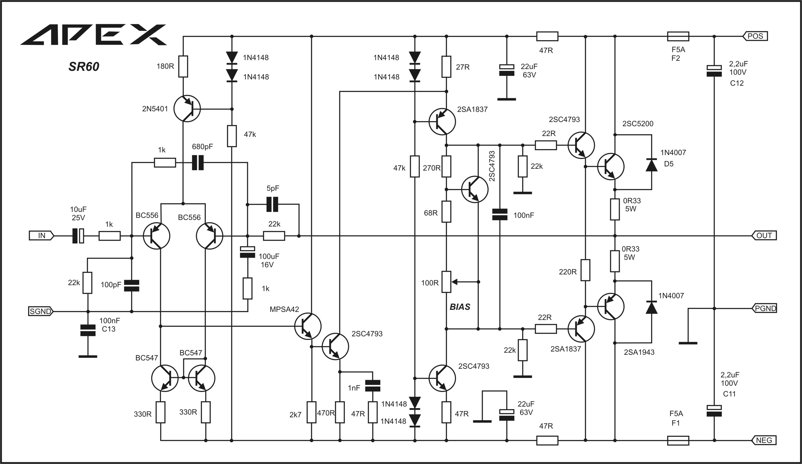

I attached B285 file. It is a commercial product from 80's with this topology. Good sounding in my personal opinion. Also attached my version of SR60
SDS/Ronaldo
Nice THD, is there DC offset on your SR60 simulation? Thank you for your contribution on this prototype.

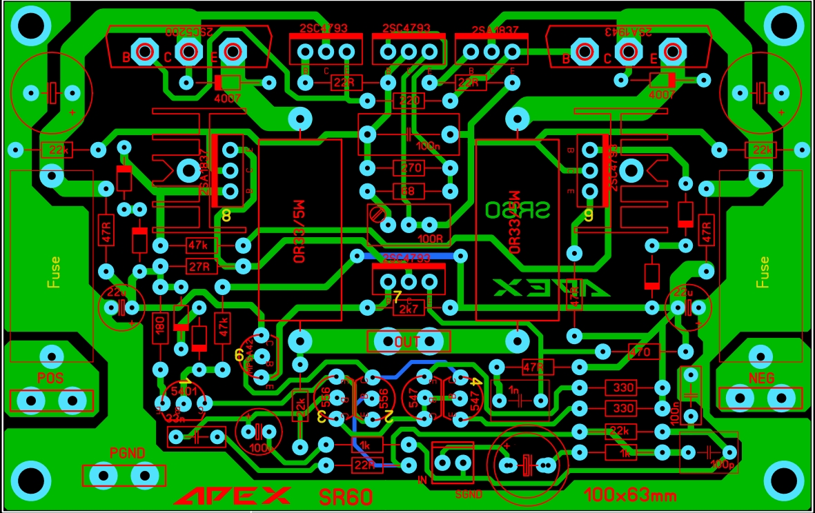

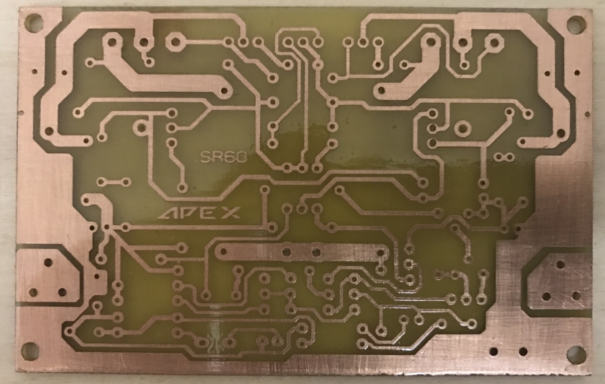

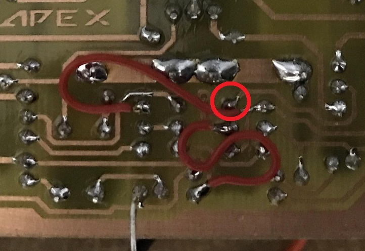

Hi Mile, thank you for your attention. I'm sure I have some error in it or I've mistaken the transistors. But I'll find it.
Here is a foto. The quality of the pcb is not so good - my printer is defective and I had to take another one ... Hard times 😉

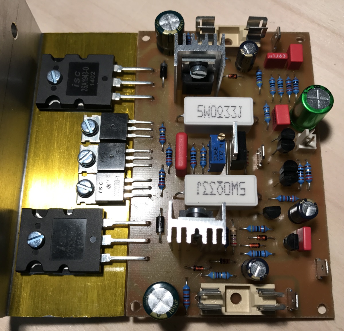

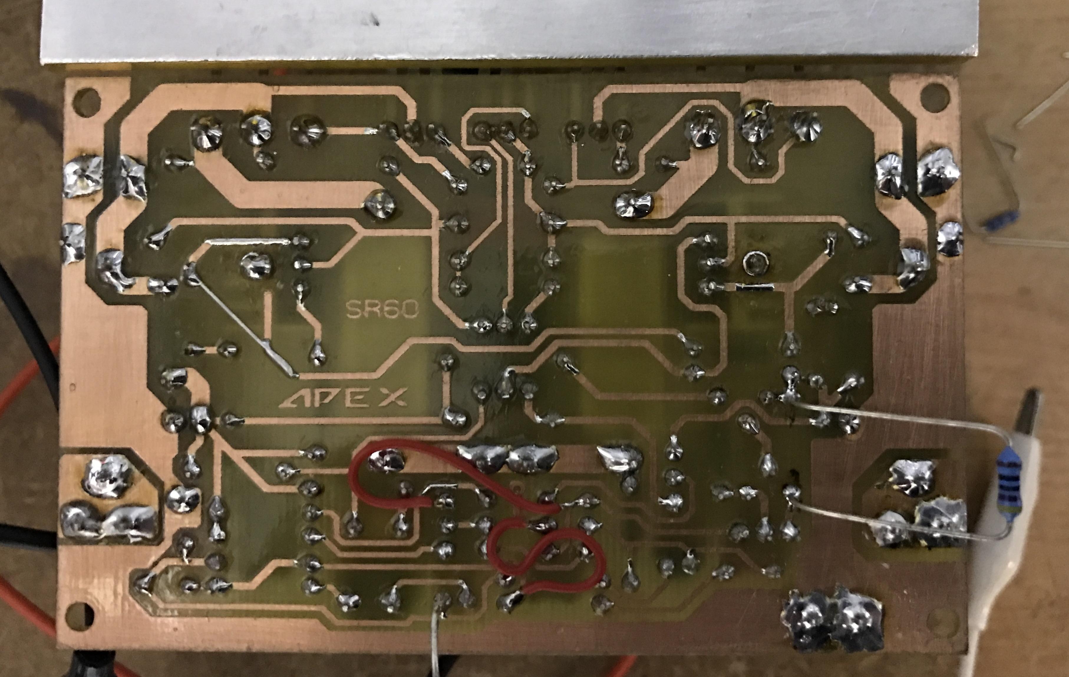

Well, here we are. After eliminating the error with the air wire the amplifier plays - and not bad. The offset is stable at 10mV. All components were very warm, so I went back from +-50V to + -40V. I think it also sounds better so. A very balanced and warm sound, completely unstrained. Maybe the heights could have a bit more transparency at the top. But this is completely subjective and I have not heard enough.
I would say the time to try the little amp is a good time!
The next days I will rework the layout (more distance between the transistors on the heat sink, a small heat sink for the 2SC4793 in the middle, a bit of cosmetics) and then build the second channel and upload the files.
Thanks to dobrivoje for finding the mismatch and to Mile for a new excellent amplifier.

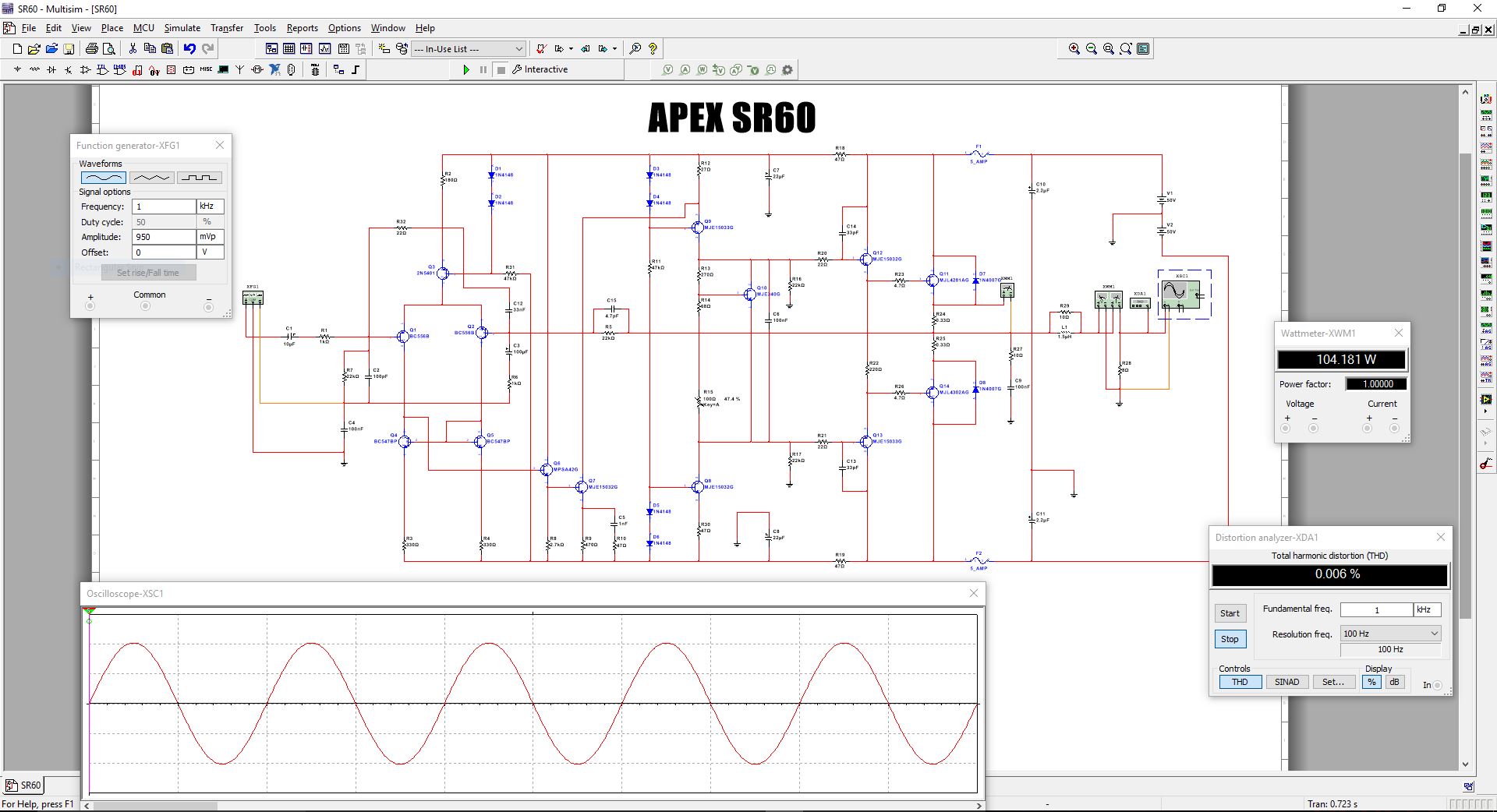

You can tweek compensation in simulation to get it stable...
I made the simulation and I did made a few mistakes on my own but mister Mile point out what I did wrong and after I fix my mistakes it works really well, 🙂 I add other stuff like base stoppers and coil and extras as usual, I adjusted to about 20mV single emitter resistor bias adj and a supply of 50V and it has really low THD according to the software results. I did the simulation as a normal use example simulation like you are using only 5W @1KHz sine wave to 8Ω load and THD is 0.001% sometimes 0.000% maximum power with 50V supply can reach about 100W "not going crazy" I mean not need to add more pair of power transistors I will build just as it is no changes 🙂
I'm getting old why I did not see that I made a wrong connection ? I need new glasses 😛
Regards
Juan

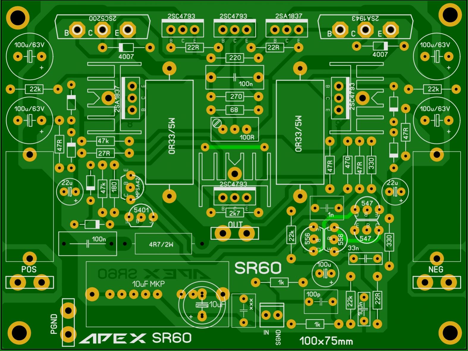

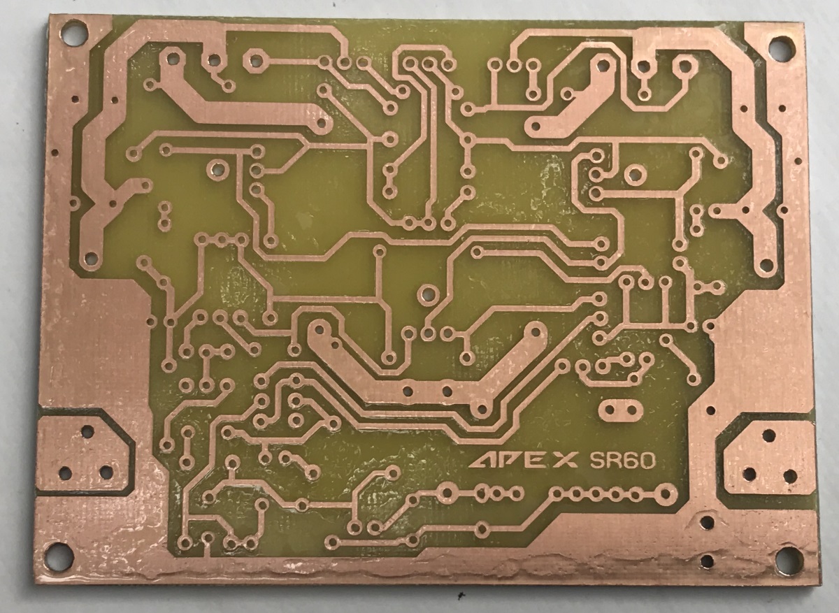

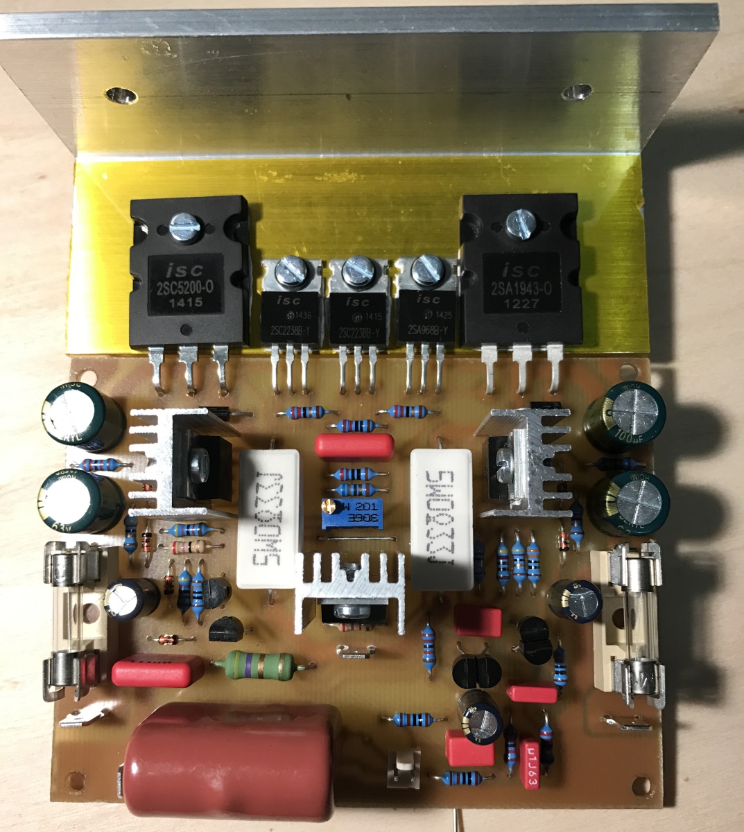

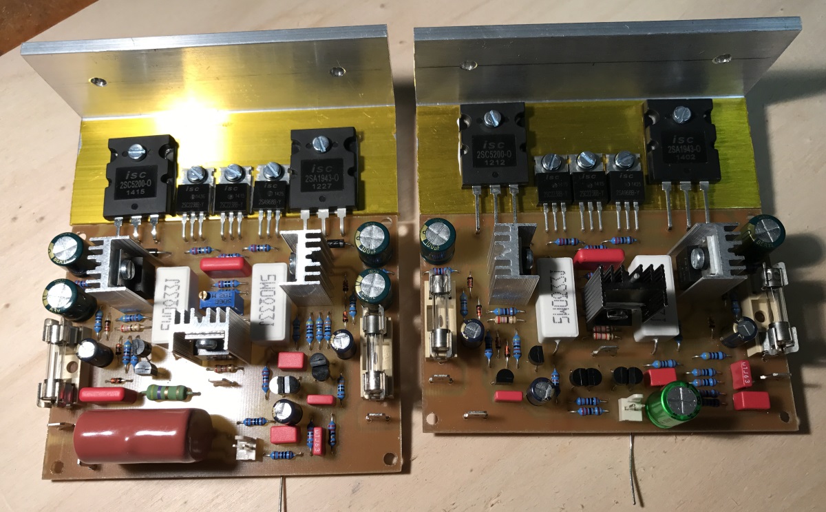

Hi, here is Part 2 of the SR60. Works from the first moment. Very nice sound.
Changes:
- Required heat sink
- Zobel
- Space for 10uF MKP input
- some corrections
The amplifier is definitely a recommendation.
Layout will be uploaded next day (on another PC).
regards Olaf
