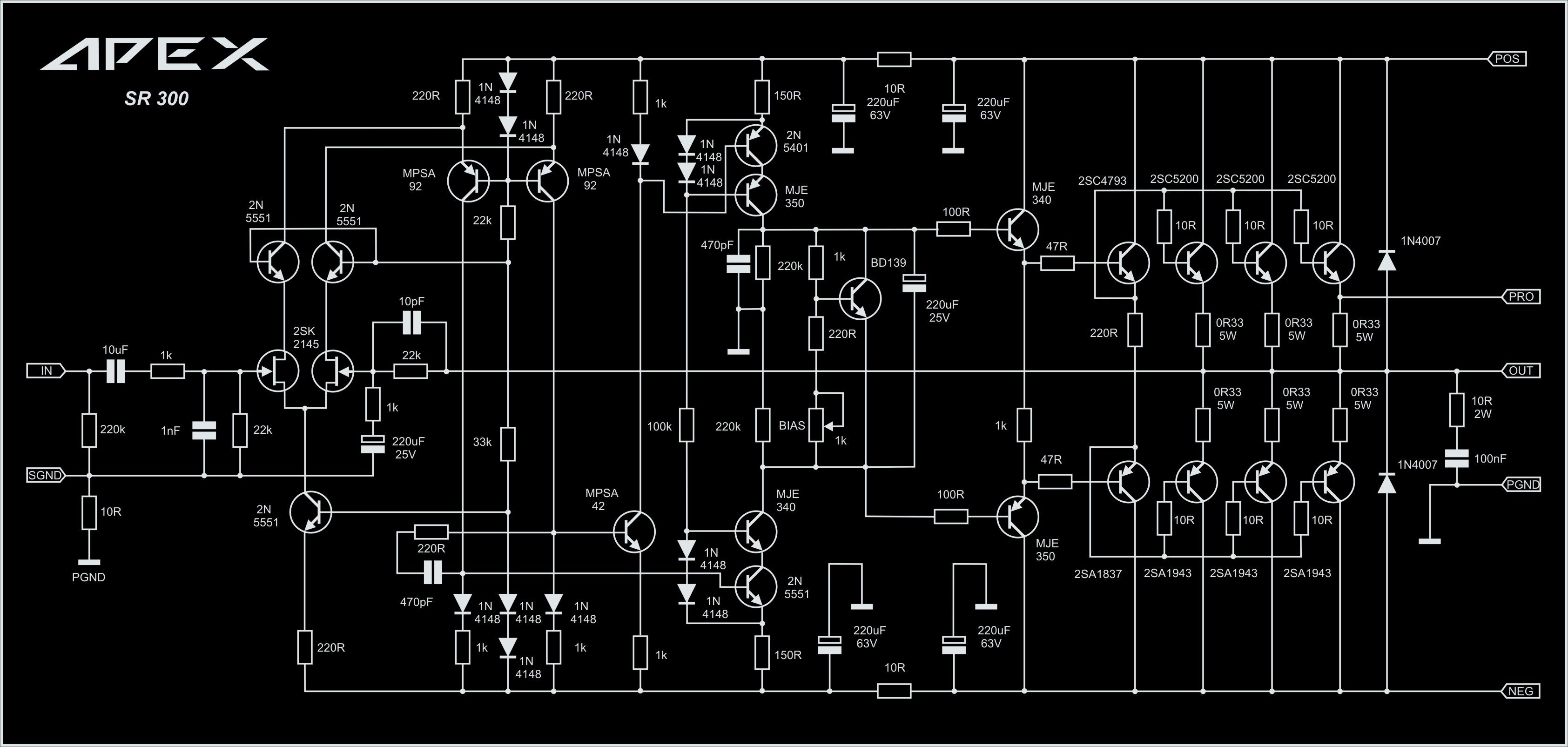

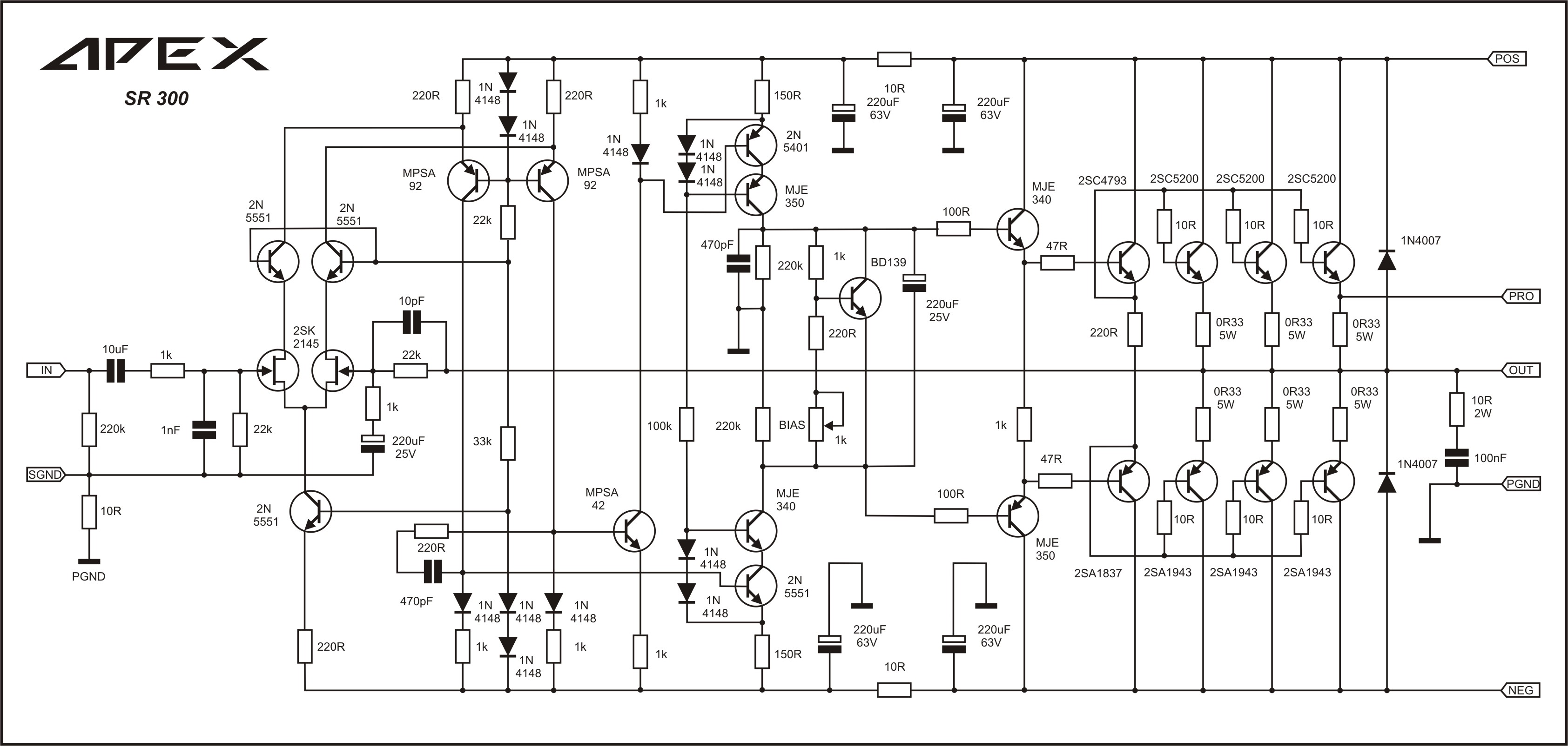

Oops! Would you please have a close look at the SR 250 schematics: Only three pairs of 2SA1943/SC2500 output devices here! Best regards!Hi Apex !
Refer to POWER OUTPUT. What will be the difference betwen B500 with 4 pairs transistor and this SR250 with 4 pairs fo transistor too ?
Yeah !! Y're right ! only three pairs of 1943/5200.
3pr of 1943/5200 gives a total Pmax of 900WYeah !! Y're right ! only three pairs of 1943/5200.
Since 1943/5200 have such poor high voltage SOA you need to divide by ~6 rather than by ~5 for more robust transistors to arrive at the maximum output power. i.e. ~150W for 3pr.
3pair of 2n3773, which are also 150W devices, can easily manage 180W and probably 200W reliably.

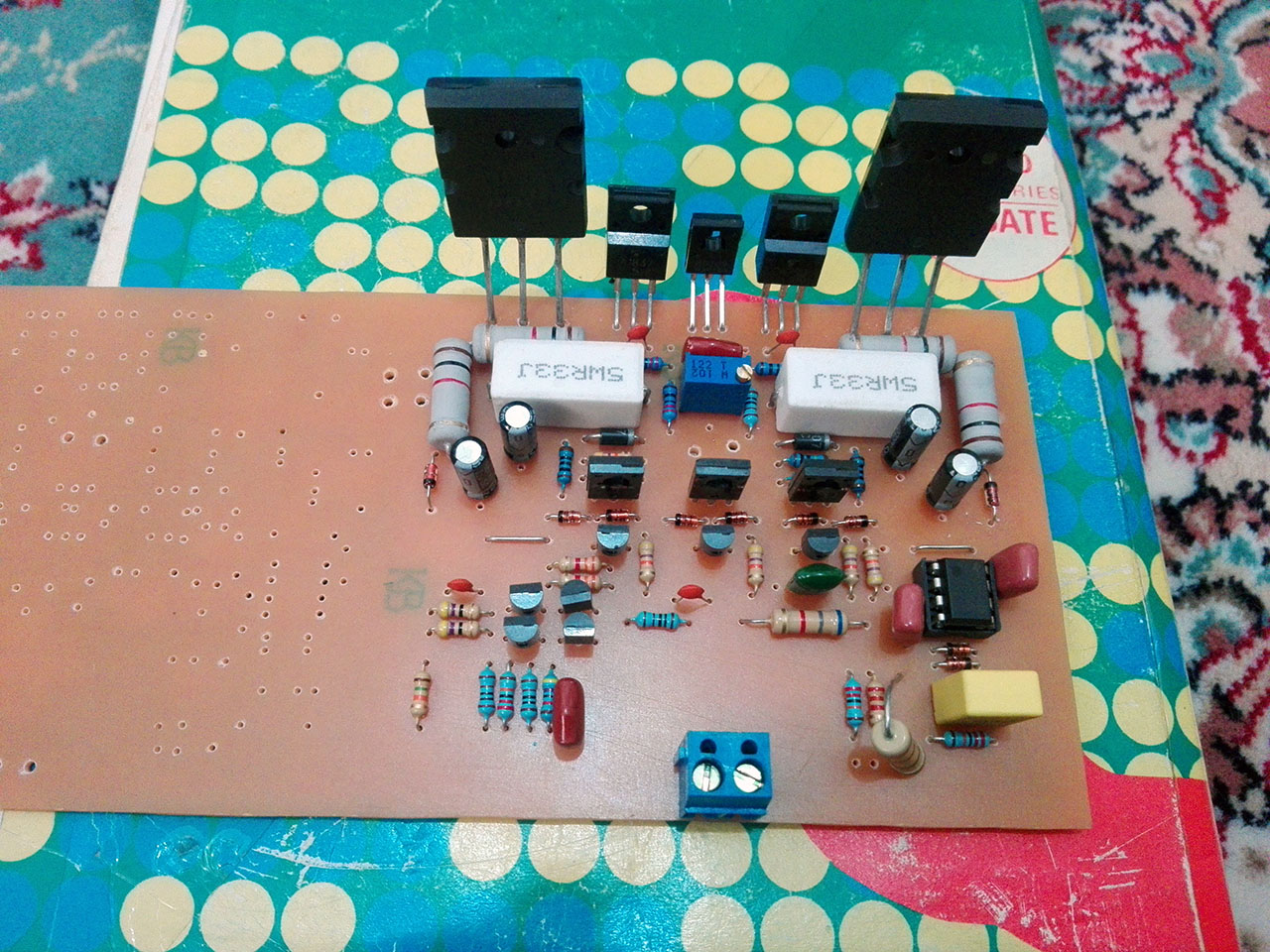

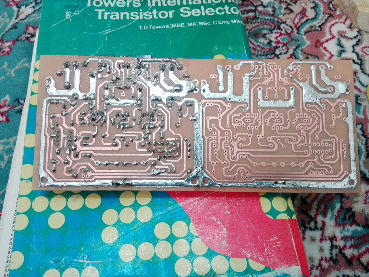

mr mile
finally i built sr100 today😛
my amplis is stereo but i built one ampli now
i will build second ampli tomorrow
i dont know how adjust bias voltaje by p1
please guide me
respectfully
Set 20mV on 0R33/5W resistor.
Regards
Regards
which one resistor mr??
resistor in right or left?
i dont have any voltage on resistor left???
please explain clearer to me🙁

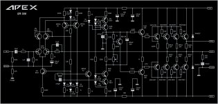

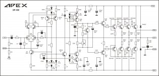

Dual FET input
This, nice schematic, deserve a decent layout ,don't you think ? 🙂
- Studio Reference Amplifier
