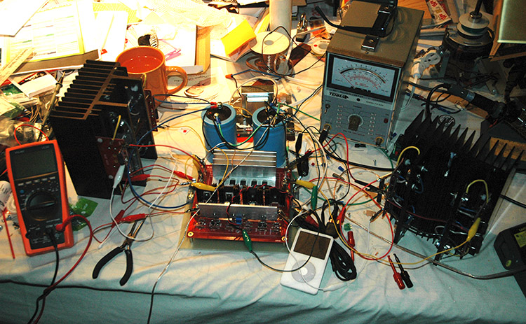

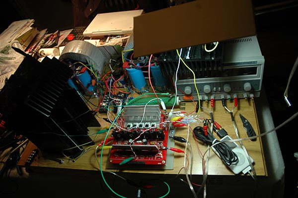

Well, here is for the effort. It's a mess but I fired up the main board and used it as a headphone/preamp with 20volts and 1.5A from variable power supply while hooked up to an iPod, Allman Bros' 'Eat a Peach'. Really nice. Sounding very aggressive, robust, with no noise. Next step is to hook it all up to can caps, output transistors and heat sinks. This will be my last 'STOLEN' bought project though. In the last year and a half, I have learn much and entered into a new world that I will never forget and thank all those you threw their kind help this way.

Nice work David! Glad to hear it is working okay. Finally you can enjoy the sound that this wonderfull amp conducts. Now it is time to mount everything into a nice cabinet 🙂

Yes. I am interested in the Goldmund clone. When I test the main board without connecting the outputs and play music with headphones to drivers pads 1 or 2 I get clean sounds with absolutely no noise. But when I connect outputs I get just a very little rush sound at speaker biased to 250mV. Now remember, I am using a DC variable power supply @ 20 to 30V/1.5 to 2amps. Maybe power supply I injecting noise. Will check with oscilloscope later. I came to believe that some of the criticisms are valid using bought clones. As I read other threads--such as MPP (My Personal Preamp) thread and especially the first KSA-100 thread, there were those who built the PCBs mainly with the intent to share their efforts only charging DIYers production cost and shipping. With this in mind, AndrewT is right....... So I just recently purchased some Pinkmouse KSA-50 PCBs for a later build (right now I am overwhelmed). But if it weren't for your technical abilities and willing to share, we (and the Asian vendor), would never have figured out Asian manufacture's print and physical mistake on the PCBs. But, like you said, for a retired guy who needed something to do during the winter and allow me to reminisce the old days in the Army's 11th Signal Battalion helping the radio repair tech (1973-75 in Germany.

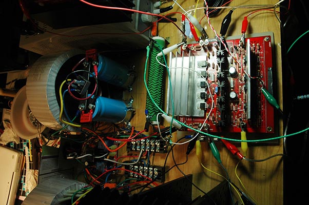

After insuring the mainboard behaves , I connected it to the output transistors/heat sinks. It sounds wonderful. I have never heard such warm, robust sounds with crisp cymbals in the background. It's only running on a 24cvt/2Amps transformer with 18000uf/75v caps with ~15vdc on rails. After I hook each channels to their PSU (40v/1kVA), I realize these transfos are very big and after hearing how this amp sounds with only ~15volts/2amps, I also realize I need maybe just 33 to 35volts. Then I will need to find a good DAC. I need to match analog lossless music to the analog capability of this class A amp.

OK. I am ready to fire up with full 40-0-40v, 1k transformers. 37,000uF/75v caps. Yes I know that is a lot, but that's all I have. Will use small bias and I read much on what to do to set bias (light bulb), but a haven't clue how to set feedback variable resistor. Help anyone?
The bulb tester is to protect against damage due to a mistake in the wiring.
Do not use the bulb tester during output bias setting.

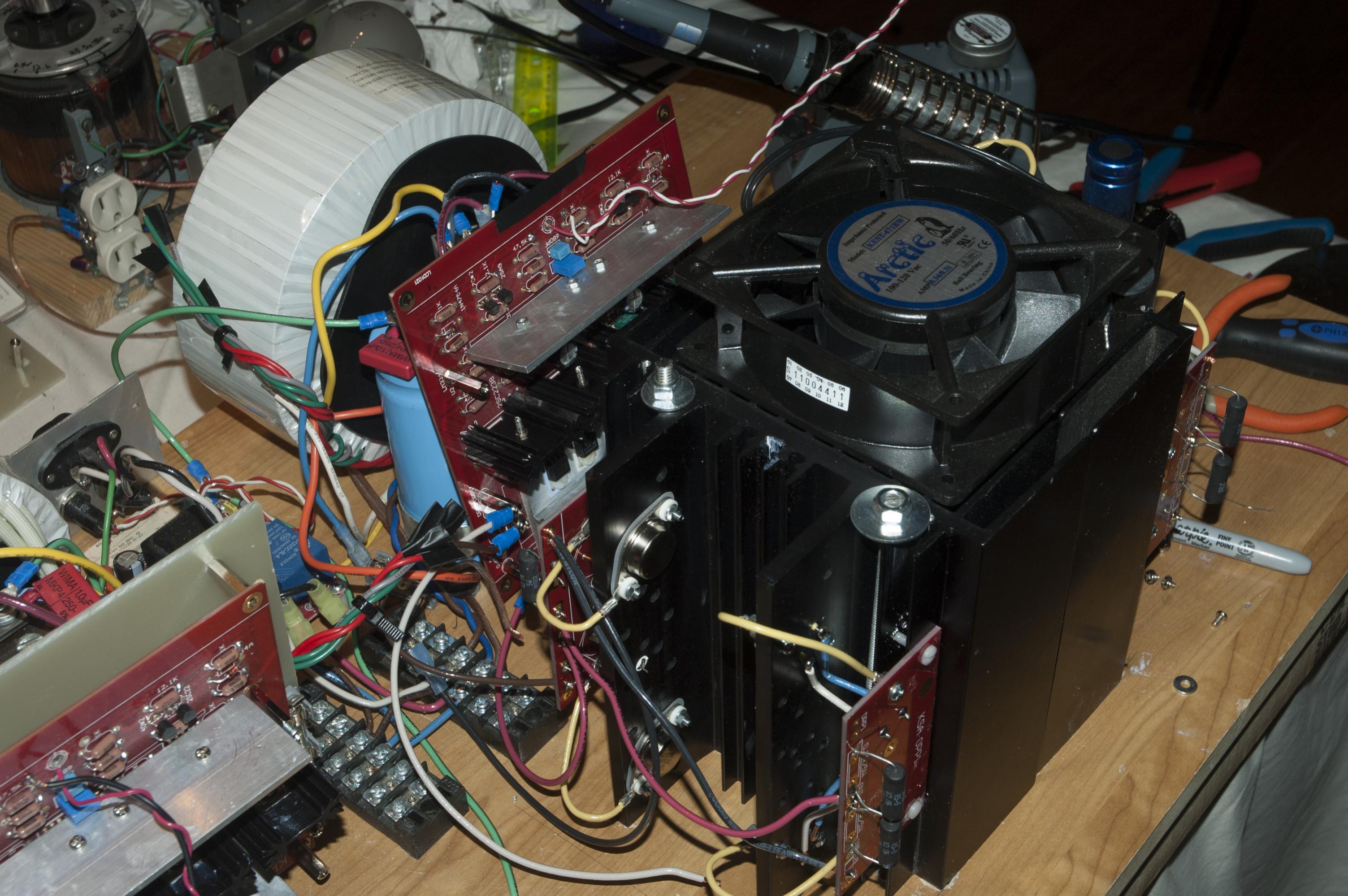

Okay. I made another step toward completion. I just need to adjust feedback. See the light bulb in the background? Fan will end up below. Thanks to Stuart for the heat sinks. Thanks Kaplaars for the inspiration.

Okay. I have wonderful music. More treble than bass at 350mV bias. Mark G. said he got "slammin'" bass way back then. Could I drop the value of the 1ohm emitter resistor to the .6ohm resistors Stuart gave me or should I wait until I get the bias up to +- 600 bias for the current value of .6 for 100w with 40V at rails? At 350mV, MJ15003/4 temps are at ~100degrees F or 37.7C. with fan or without somewhat. The 32/33 are at 84F. Today I will raise the bias to 425 and see how high the temps go and if the bass decides to go "slammin'.

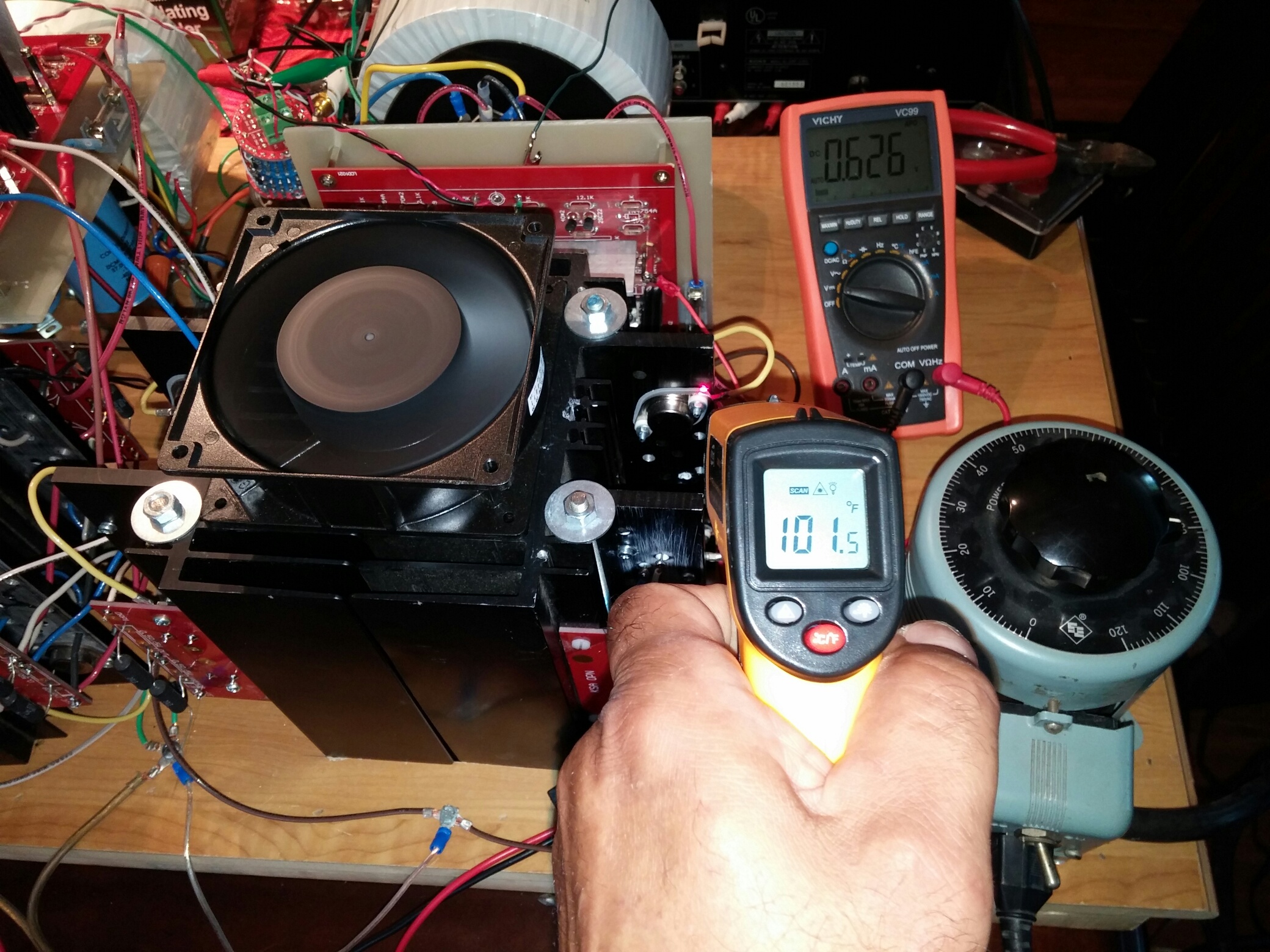

Working out the bias and DC offset. The adjustment was easy except I had to put in higher amperaged fuses--4amp to 5 amp fuses when I got to 630mV bias.
Stuart. I will start up the amp tomorrow without the variac and cross my fingers. The transfos are 40v for 56volts at the rails. Way to high, no? But I only have to worry about the temperatures generated by the high voltage, no? How high (max) of a T03 temperature can I be safe with with this high of a voltage at rail?

Well, I took the variac off and running amp with straight main line at 118volts. The bias edged up just a little. Trimmed it back to 630mV and trimmed DC at speakers to zero. Funny thing is that the MJ15003/4 for the right channel run at 101degrees F and the Left channel the TO3s run at 94F. Less current? I have, as of today, about 7 hours of burn-in time and already the bass is slowly maturing--very robust. I have been playing Joan Armatrading mainly because she works in a quiet studio to make sure there aren't foreign sounds being added. Clean as a whistle. Kaplaars. I been reading about the zobel network, and it says that the tweeter does not need it, only the woofer. That you can put it direct across the woofer's leads. "The Crossover Component Selection Guide, as with all crossover formulas, assumes that the crossover network is terminated with a purely resistive load, but a loudspeaker is not even close to being purely resistive! Due to voice coil inductance, the impedance is constantly rising with frequency. To remedy this, a simple capacitor and resistor impedance equalizer called a Zobel network is placed across the positive and negative leads of the woofer. The Zobel is not usually necessary with a tweeter network, so we will design one for our Morel woofer using this formula." I got this from PartsExpress.com at "Build your own loudspeakers" url is Resources - Build A Speaker. If you have 8ohm impedance woofers, you use 8 ohm resistor and then it give you a formula to figure what capacitance you need for the RC zobel network. Almost forgot, as I increase the bias to 630mV, it kept blowing the main slow-blow fuse (5amps). So I put a higher 7amps slow-blow fuse and it is holding it's own. I am using one soft-start for both channels and 2x110v cooling fans. How high amperage of a fuse can I use at the main before the soft-start? Thank you.
