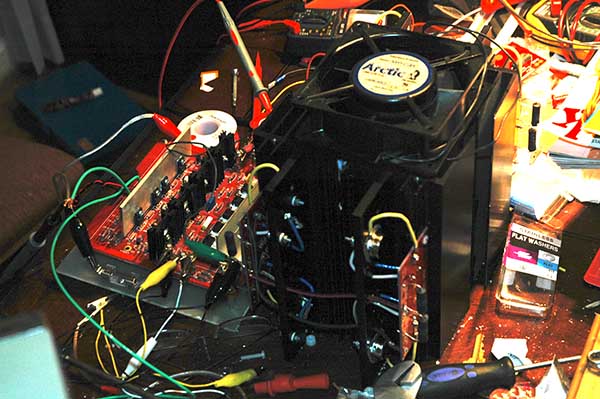

Hooked Up.
I was able to get back to work on the KSA-100 MKII. I have a photo of using ADCOMM GFA-555 heatsinks. I hooked up a benchtop PS +-
30v 4A to the Jim's Audio driver boards and output boards today and got got bias readings 3mv-6mv adjusting variable resistor VR2 with
10.2volts at the +Vc on the output board. But I have 16.3volts at -Ve with no Bias readings across all its 1ohm 5W emitter resistors at all. What could cause the voltage difference btw Vc and Ve? I read somewhere that the MJE15... transistor are for bias control. No? Should I take out neg side Bias controllers to test for breakdown? I hard wired the collectors from output transistors to output boards as I insulatated heatsinks from the collectors--I didn't want live heatsinks.
Also, I checked for dc offset by tieing both + and - outputs measuring dc voltage across the tie to ground (is this correct?) and get
4Vdc. This is terribly wrong, no? Variable resistor P1 is not adjusting the dc offset at all. I am now thinking I got myself into more than I can
chew.
