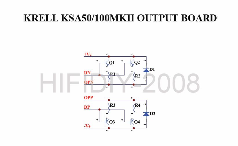

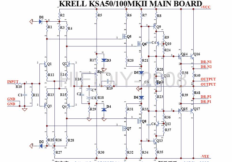

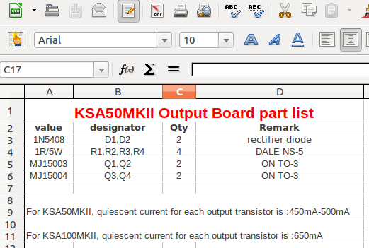

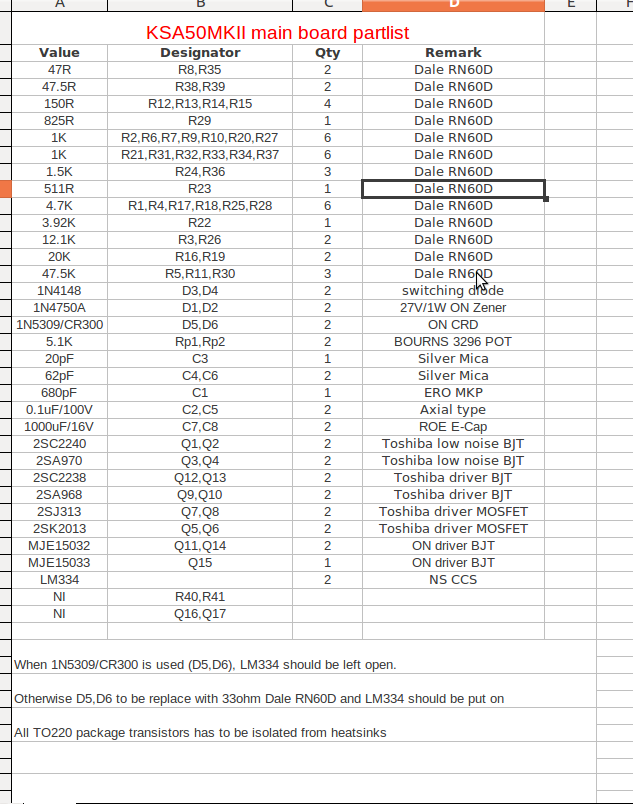

Hi all, thanks Spurite for the great information. Have you a circuit diagram of Jim's boards that you can post so that I can start getting components up together.
Thanks for your help
Alan.
You should have them, if you bought the boards from him.
Sorry Alibear. I thought you wanted something more than what MEGA-amp shows you what Jim's Audio provides either by email or through ebay messages. I reread my quote and it sounds I was a bit of an *** ****. I was on the train trying to find what Jim's Audio had to sent me to send to you on my cell phone. Sorry again.

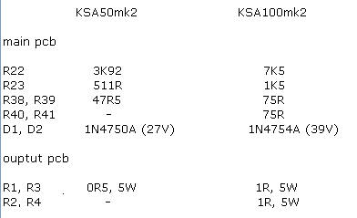

Btw., some component values differ between ksa50mk2 and ksa100mk2.
Hi all,Spurite, no need to apologise. I'm usually the first one to miss-read posts.
Mega-amp, thanks for the diagrams, I'm still waiting for Jim's.

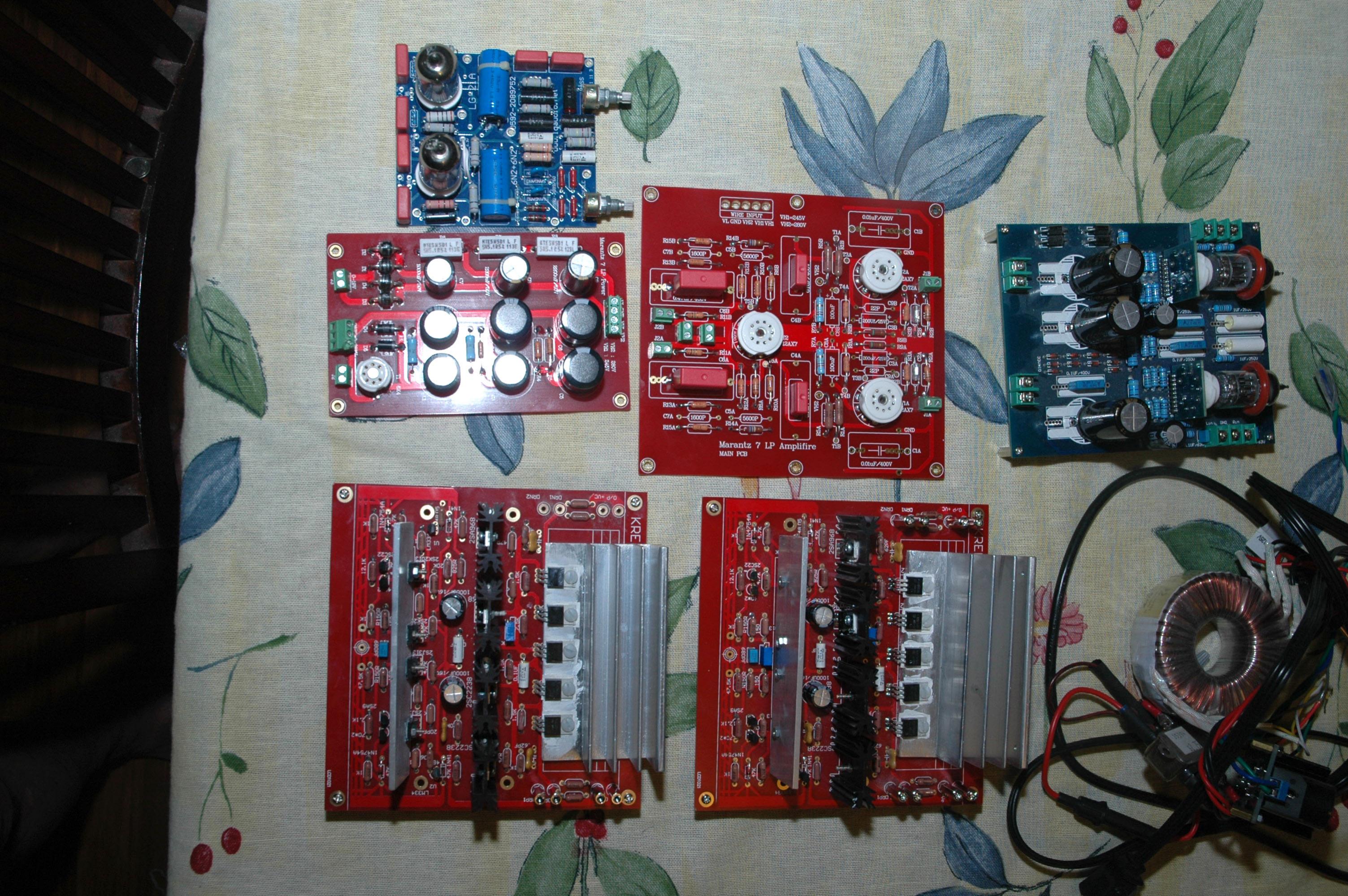

Still Workin'
I got some nylon screws and nuts, drilled out holes in these heatsinks, and had to resolder some of the trannies. Lifes a bitch the you die. What I mean, I don't like moving solder or its heat. This is what I mean when I say Jim's Audio's board are good ****. They take a beating and still ticking.

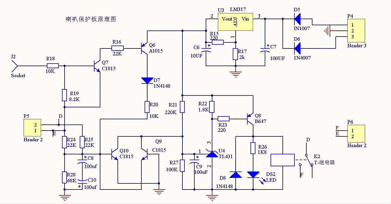

Neychi, do you have the speaker protection's schematic? I seem to have misplaced mine. I have the same speaker protection.David, I want to have all the heatsinks in the same color. That's why I will give them to the black anodizing.
Here it is 😉

If you do build the speaker protection, make it in such a way to be able to disconnect to try both ways and see if you can hear a difference

speaker protection.
I have a while yet to get to that point. Lots of summer activities, but I fully understand. Will try both ways and trace for noise. Thanks AVWERK very much.I should have said to pull the speaker wires.
