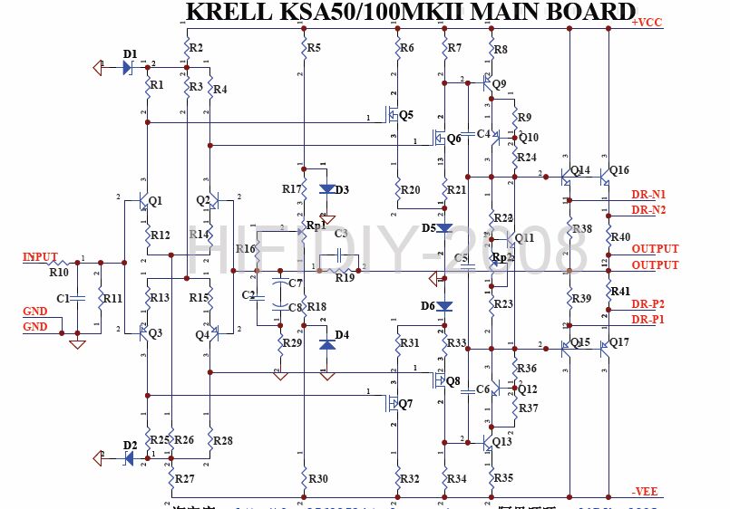

I picked up a pair of ksa50/ksa100mk2 boards off ebay from Jim's audio in hopes of building a ksa50mk2. In reading a few of the very long threads on this amplifier, I think I'm more confused as to which schematic jim's audio is following. Is this his own rendition? There seems to be many variations of this circuit, his seems to use mosfets before the drivers. To the people who have used his boards, did you build it exactly to his BOM?
@MEGA-amp: Jim's audio use exactly the same circuit as original ksa50/100mk2. There was several variations in production since 1980 to 1987 when production stops. The first versions of ksa50/100 were without mosfets, later version use them. Don't worry, amp works perfectly.
Btw., some of the components are obsolete so you have to find substitutions for them. Read this thread carfully and you will find all the answers😉

I think when you read through it you will find that D5 & D6 are NOT diodes.
They are current regulating diodes, or constant current sinks. A quite different component.
I see. I've found this: 1N5309 - AMERICAN POWER DEVICES - CURRENT REGULATOR DIODE, 600mW | Newark. A bit pricey, any cheaper alternatives?
jFET set as current sink/source.

In Jims BOM, his alternative is to replace D5/6 with 33R, and there are two positions to install LM334 adjustable current source. My thinking is that the LM334 would provide a less noisy regulation than using the crd option. I'm trying to get as close to original as possible, but if the crd option provides better performace, i'm all for it.
I used the LM334/33R. ONCE YOU GET PAST THE MISPRINTs AND THE NEEDED JUMPER on the main boards, WHICH IS POINTED OUT BY Kaplaars. He also advised to kill the potential contact (short) to a MJEs' heatsink. Just read this thread completely throughly and repeatedly.

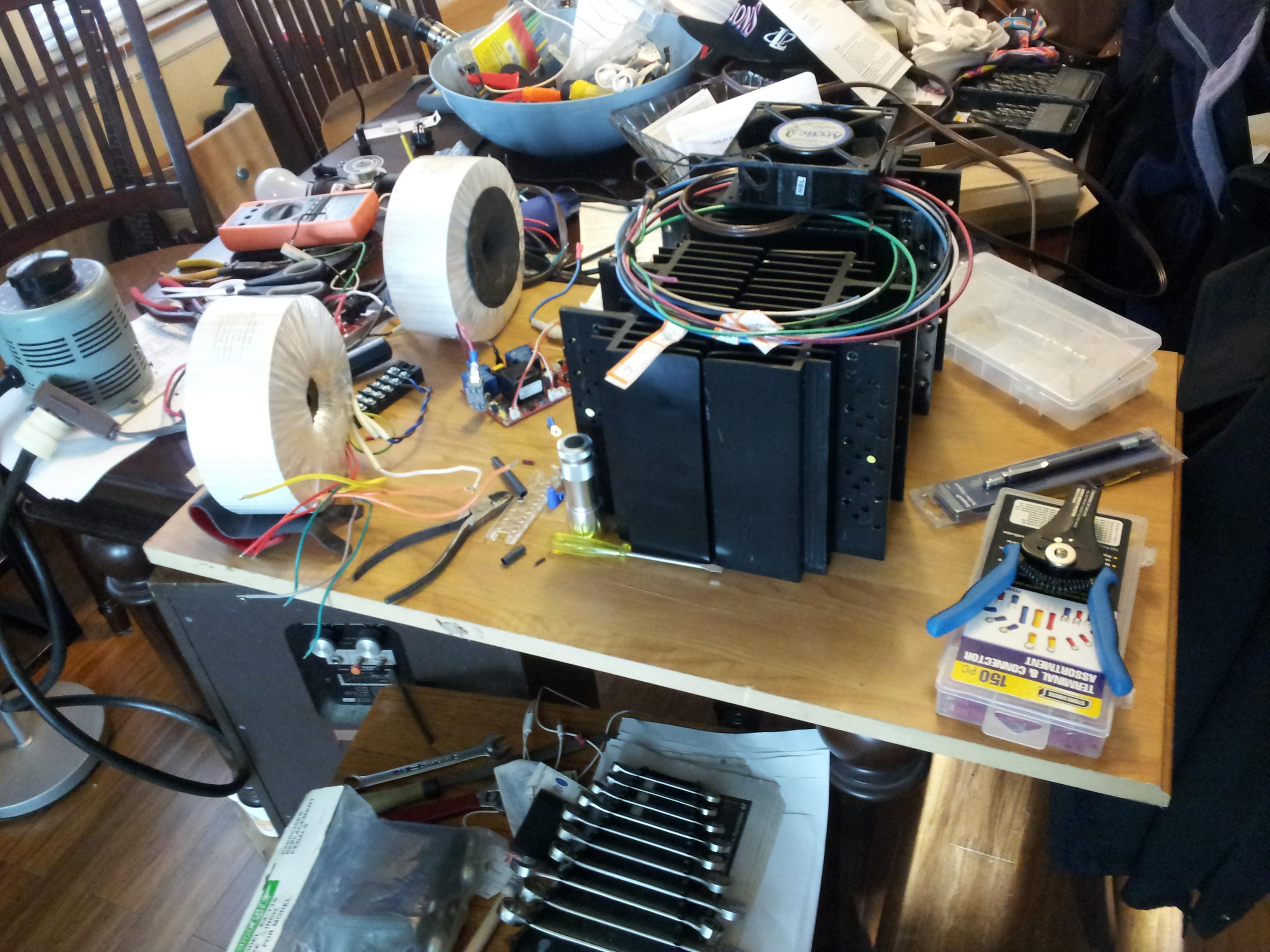

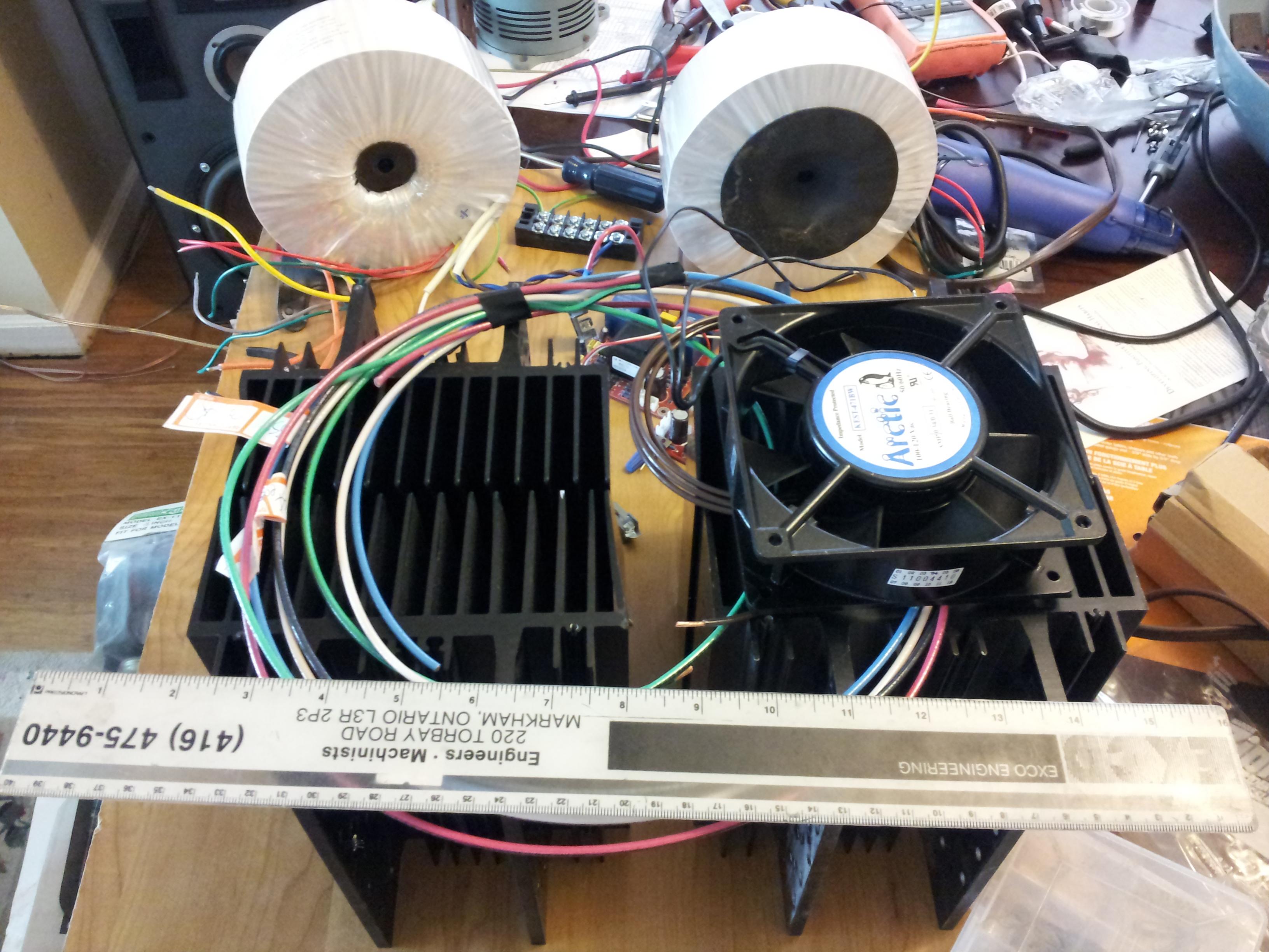

I found these fan type heatsinks on ebay although they seem to be a little too small lengthwise? ebay's starting bid is $99.00.
Aluminum Transistor Heat Sink Assembly | eBay The fans they use are Mouser Part #: 433-BP1202524H which are 120mm x 25mm x 120mm.
Thanks necdetyetisgen! :-D Maybe I will buy them too. I really like them.
Thanks Jozua and Dean!! :-D I will consider adding a base. Hope I can find the metals over here.
Hi David!
I would say they are indeed a bit too small to cope with the large amounth of heat generated by the KSA. I would say you will need at least 120 X 120 X 110 (=4.3 inch lenght) mm per channel, but I think even that is too small, unless you want to 1) dial bias down or 2) run the fans at full RPM. You will need a lot of metal for sufficient cooling. You could stack two of them onto each other per channel. I would also recommend 120 x 120 x 38 mm fans. They have larger blades and are capable of generating more static pressure (higher static air pressure is favorable since you need to push a lot of air through the tunnel coolers), so they can run more silent. You can also, with a fan adapter (120 mm to 140 mm), use 140 mm2 fans, like I do. They can run even more silent, while maintaining the same air flow. I am currently using tunnel coolers that are 120 X 120 X 150 mm. Have not tried them yet. I am overhauling my Audio Analyse A9 at the moment. But I will post some updates soon 🙂! Hope the new config will do.
Hi David!

I hope you are not referring to the tunnel coolers on Ebay Andrew. If so... good luck with keeping this beast beneath 55 degrees C using the tunnel coolers from Ebay going fully biassed ;-). In the old thread one can find that Fix used tunnel coolers that were even a bit larger and thicker. But even Fix experienced cooling problems. I faced the same problems (using even larger tunnels), but my configuration was not optimal. So that is maybe not representative.
Anyway the one on eBay is a poor copy of a proper tunnel cooler David. A waste of (a lot of) money if you would ask me. If you want to use tunnel coolers, you can contact Seifert in Germany. They offer very nice tunnel coolers, that are far more usable. But I am afraid shipping to the USA will be expensive :-(. See:
http://q04.digtion.de/qanportal/Uploads/seifert_punkte/pdfs/25[0].pdf
By the way, David, why not using the heatsinks from Adcom? They seem larger than the ones pointed out on Ebay, and would probaly do better. Just give it a try 🙂.
Yes, I am referring to the preceding post and it's link.I hope you are not referring to the tunnel coolers on Ebay Andrew. ........
Oh yes I am starting out with Adcom heatsinks. They are huge. Since they are square, I will create their own cooling compartment top to bottom. I am close to putting this beast together but the wife has me doing spring chores outside.
Ai Andrew, I would say that is a bad advice (no offence). I honestly think those are not capable to offer enough cooling capacity. Even when running the fans at full speed. The internal aluminum blades from the ones on eBay are realy thin, from what I can see in the protograph. Let alone the length which is rather small.
